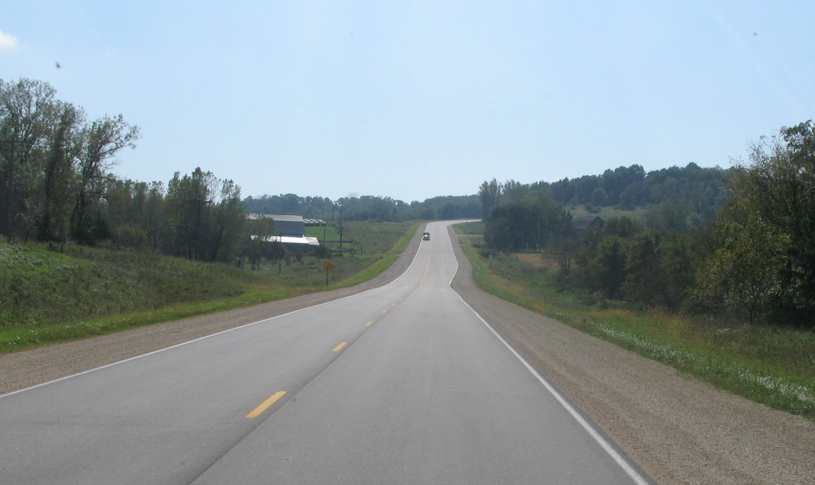

- Posts: 6553
Re: Trailer OR Drive?
Go for it!! Hilly in Iowa means going downhill then uphill. The area around Pella is full of small valleys not hill. You should be able to make the 15 mil trip in 45 minutes at 20mph.
- Attachments
- iowa.png (336.87 KiB) Viewed 2179 times
- Posts: 7401
Frank's picture reminds me of this shot I took in the mountainous NE part of Iowa.

Since several respondents have mentioned “hills”, another Model T driving rule of thumb is to consider using the same gear (you only have 2) descending a hill that you needed ascending it. More applicable to mountains tho. For a long steep decline I tightly clamp the low band onto the low drum. That way minimal band and drum wear occurs.
- Posts: 8479
You shouldn't need low gear on anything but steep hills. For most any driving over 17 to 20 MPH, advance the spark all the way. If the car is in fair to good condition, I'd drive it around 30 MPH up to about 35 MPH. If you go too slow, you may have to downshift more often than otherwise. The engine makes its maximum power around 35 MPH in high. In low gear, you're limited to about 8 MPH, so that's to be avoided out on the road, since there is no second gear.

That was one of my big fears....is that to much hill for the car? Good to know that it's not.

A Model T that is in reasonably good running order will go up any hill you are likely to encounter on any public road in high gear in most parts of the country. Exceptions may be found in mountainous areas. In several internet pictures, Marion County looks like flat to low rolling hills to me.
