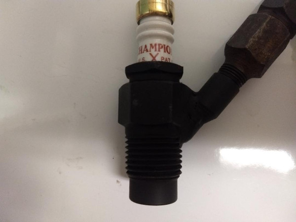

Remove the existing plug. Install the whistle. Put the old plug in the adapter. There is no special plug.
FWIW, I have tried to run these types of whistles in my different T's, all the motors developed a rough running like miss.
So off they went. I have gotten similar feedback from a few other guys.

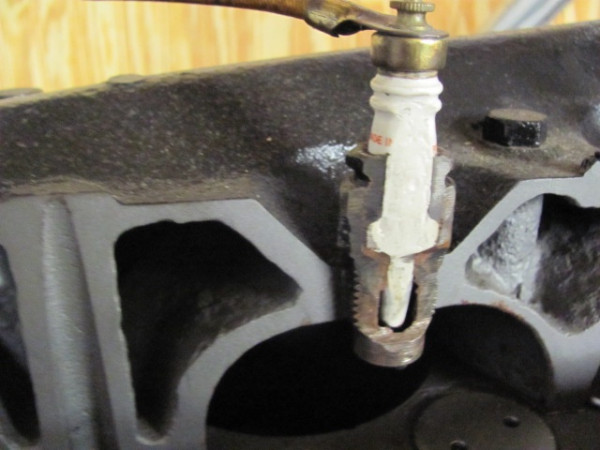

Haven't used an explosion whistle, and for that matter an 1/2" adapter in the cylinder head to install mm plugs.
IMO, it may be helpful to use a 'long reach' plug to get the electrode at least partially in the chamber.
Here is view of chamber with a standard reach plug.

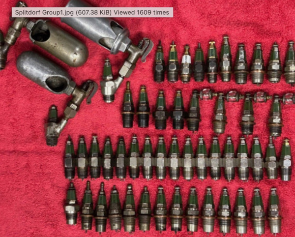

The explosion whistle might be best done with a long reach, like the pretty green Splitdorf early plugs, note this collection shows these plugs with explosion whistles.

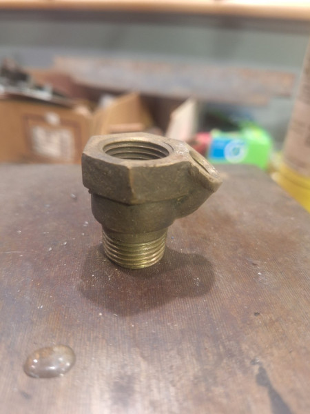

I had not seen the adapter before, but it looks like it is available from at least one of our regular dealers.

Willy, the plugs that were specifically altered for the whistles keep the spark inside the combustion chamber where it belongs, better than the adaptors that were later made. These plugs were mostly (if not all) Splitdorfs altered and sold by Buell to go with their whistles. They are pretty scarce but not impossible to find, I’ve been collecting plugs for three years now and have acquired four. Only one of which fits a T. They were made from the late teens to early twenties. Most of these old plugs will last forever though if treated with care, occasional cleaning, and a spark that isn’t so intense as to cause heavy wear to the electrode.
With a welder, drill and some tubing I imagine one wouldn’t be too hard to make out of a Champion X, if you had the patience.

Also, if you find usable Splitdorfs, they must be cleaned by hand with gasoline or some other solvent (I’ve found gasoline to work well, and it was frequently recommended for cleaning plugs during the period. Likely because it was on hand anywhere automobiles were and will cut the carbon.). DO NOT use conventional pneumatic spark plug cleaners on mica insulated plugs. The mica sheets are resistant to heat and do not crack or shatter as porcelain does, but the sheeting is thin, brittle and flaky to the touch, especially after excessive wear. These are tough old plugs and resist dropping/cracking (a big selling feature at the time), but the mica is like paper and a wire brush or grit from a pneumatic cleaner will ruin one.

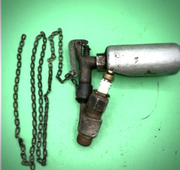

Just bought this on the ebays for $85 shipped…
The seller says the valve actuates, so I should be a leather washer away from functioning….

I just found one in my stash.
Yeah, that looks like the adapter..

I got the whistle adapter AND a 14mm plug adapter.
The longest reach 14mm plug I have found has just over 1" reach.
With the two adapters together the 1" reach just may be negated by the use of that second adapter.
I'm still going to buy a long reach 14mm plug. I'll swing by napa after work.
I will be plugging the whistle part of the adapter and comparing the stock plug and the 14mm plug and adapter for driveability.
I could machine the whistle adapter so the plug(s) sit closer to the combustion chamber, but I don't think it will be a significant amount.
adapter is 2" maybe I could trim it up to 1.5", I could trim up the 14mm adapter to sit flush within the whistle adapter, but still at best it would be 1.5" deep.
1” is the first mark/center
Second mark is how far I would be able to machine the adapter down. I could also remove the upper lip of the 14mm adapter and internally thread it to the whistle adapter.
Prototype/proof of concept. My answer to the unobtanium splitdorfs plug.
This will solve my & others rough running from the deep pocket of the brass adapter.
1/8" pipe adapter brazed to plug body.

speedytinc wrote:
Thu Aug 07, 2025 8:18 am
speedytinc wrote:
Mon Jul 28, 2025 11:50 am
"With a welder, drill and some tubing I imagine one wouldn’t be too hard to make out of a Champion X" Credit to Tadpole.
There is the solution.
Spark plugs with the outlet built in are quite rare & big $$. A matching set with one with the outlet built in, like the splitdorfs are mega $$$
Using the adapter pockets the spark making for poor running.
There is no deep reach plug that will extend the plug thru an adapter.
Take apart a new champion & weld in a pipe nipple @ the base & reassemble. Use the same champions for the other 3 cylinders.
Another project to my list.
I would be extremely interested in a step by step, with lots of pictures...
where and how are we drilling it?
Looks awesome!

Posts: 4802
First Name: john
Last Name: karvaly
Location: orange, ca
Re: Whistle spark plugs
Post by speedytinc » Thu Aug 07, 2025 2:55 pm
1/2" rod. Tapped 1/8 npt. Od cut down to .437. Thru drilled .156" Tapered lower section. Plug base clamped @ an angle. 3/8 end mill for the adapter piece to sit. Drilled .156 hole in plug base. Brazed together.
That ought to be enough info to reproduce.
Be careful to clear the base taper where the copper gasket sets.
