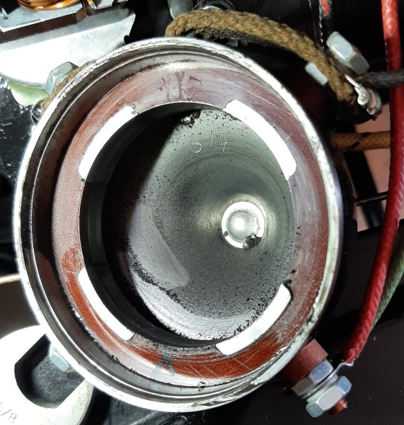

About 2+ years ago I installed a reproduction New Day timer assembly on my '26. Yesterday while wiping out the housing, I observed what you see in the attached photos. I was shocked. My best guess is there's only about 1000 miles since the timer install. Looking for opinions or any applicable advice.
Thank you,
Peter
Thank you,
Peter

Out of curiosity, what does the “race” look like in the timer body ?

There have been many discussions of New Day timers over the years, often with detailed pictures. You can spend a lot of time with Mister Google reading about these timers, but it all boils down to a couple of points. 1 There's New Day and there's New Day, sometimes excellent and sometimes miserable. Unsurprisingly, the miserable ones are reproductions. 2 In recent years the Tip Top Timer reproductions from Spokane have enjoyed a reputation for being excellent.
Even people who know their stuff can mess up, so it's possible you got a defective Tip Top brush. More likely, it's somebody else's repop. If you contact Mark, perhaps he can sort out your situation.

Though I did not photo the housing, it looks Ok in my opinion, smooth all the way around. I have cleaned it previously and there was quite a lot of "dust" which I just attributed to the brush and cap breaking in. I purchased a spare brush a while back which I installed today. I'll keep an eye on it. I do feel the brush in the replacement seems to slide in and out more freely than the former.
Peter

The timer in question came in a Tip Top box which I still have. The box has a date 1/13/2021. The replacement brush was purchased 2/13/2024. That's all minor info. I'm just going to keep a close eye on things.
Peter

Your brush is worn down to where the brush holder has rubbed/scraped the contact face. That grey stuff is ground phenolic.
For this to happen the brush is mounted too far out. The brush holder should not be able to contact the face.
You probably have too much forward cam thrust movement & a possibly thicker timing gear thickness from a non stock gear.
I would guess that as new, the timer body "danced" with each revolution. You would need to solve the issue(s) to run a new day.
Otherwise, a roller timer would work better for you, as it is not as particular to in & out location/movement of the roller.
New day timers dont work in every situation or fix other problems.

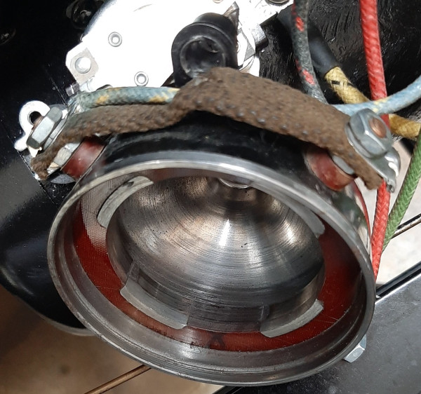

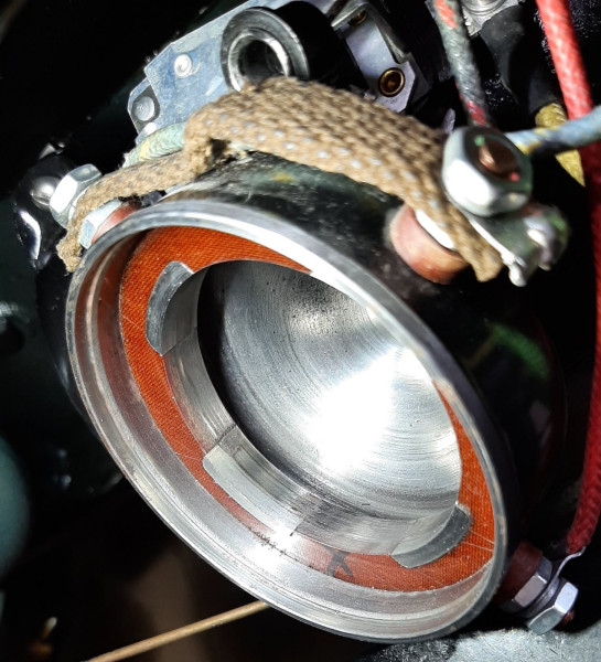

Tim, you posted “For what it's worth, one of the worst reproductions of a New Day is the "Best" - it really wears quickly. See how the plastic has been scraped out between the contacts. The debris piled up on the bottom edge is plastic.”
I assume you are referring to the marking on the original Snyder’s packaging: I bought this New Day timer from Snyder’s in 2005 and drove 500 miles with no troubles until the transmission broke and the car was laid up for years during the repairs/restoration.
These are pics of that timer and brush as removed from the car: My timer shows no appreciable wear after just 500 miles, but after reading about how the “S” marked units were prone to failure, I bought a TW timer, which is working fine.

Eric,
Snyders may have sold the "Best" but I don't think they made it. I will admit some ignorance of it's history.
If you look at the picture of your "S" cap you can see the beginnings of plastic being pushed up over the contacts and on the face of the brush. Look back at my picture of a Tip-Top with 5400 miles on it. The contact margins are clean.
Below is a picture of a "S" cap showing more plastic migration.
I've also included a photo of an original and "S" cap viewed from the side. See what I mean about the "S" being taller?
Perhaps I should explain that I don't consider myself an expert on the New Day timer or any other. I'm simply sharing my experience and research...you can draw your own conclusions.

Tim, you are the New Day timer expert in my book.
I now see the beginnings of the plastic being displaced on my timer, and that on a unit with so few miles on it! Makes me glad I popped for the TW timer.
I appreciate your observations and sharing your experience.

My engine is still in break-in stage, so running is constantly improving. I just cleaned the dust out of my TW timer, and I could swear the idle is smoother now.
Here is the timer cleaned up: As you can see, the brush has been running right at the forward edge of the timer. I removed 1mm from the back of the brush holder so it is closer to the engine now and while it is not completely centered on the segments, it is now more centered.
Don't know how important it is to have the brush completely centered on the segments?

I have no idea either re having the brush centered completely on the segments but lets face it, it can't hurt. Was a good idea to shave the brush holder down a bit. Some seem to need it, others don't. Critical to long brush wear is definitely a well tuned set of coils.Eric Sole wrote: ↑Sat Aug 30, 2025 6:37 amThanks for your info on the TW timer. The brush wear comparison is interesting.
And yes, it no doubt runs a bit smoother after cleaning, I've seldom noticed it "telling me" it's time to clean it, I just clean it at every oil change, in fact I'm going to do that to mine this morning as I changed the oil the other day and didn't have time. It's still been running smooth as silk....as always.
