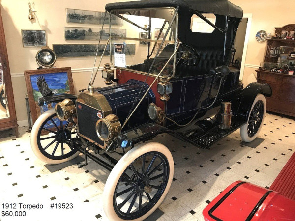

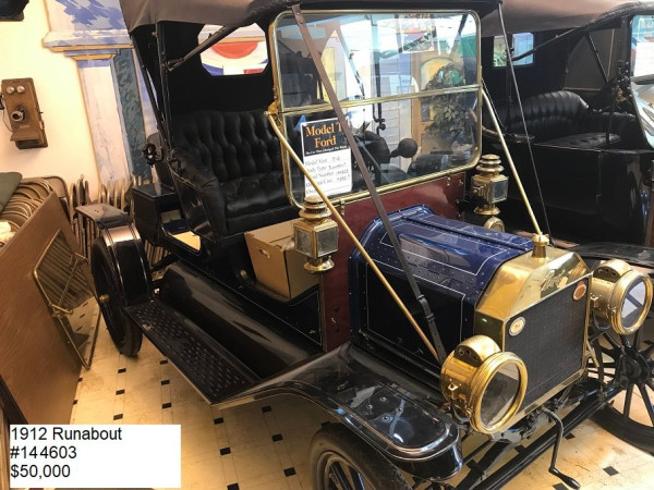

It looks a little like this illustration.
Re: 1913 runabout body
Just some views to compare with the '11 and '12 Torpedo.

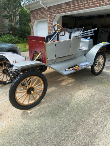

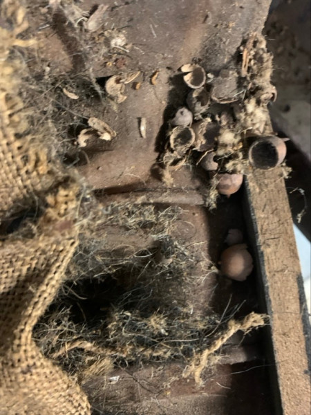

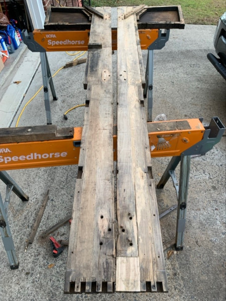

michaelb2296
- Posts: 243
- Joined: Tue Sep 13, 2022 4:01 pm
- First Name: Michael
- Last Name: Bunner
- * REQUIRED* Type and Year of Model Ts owned: 1912 Torpedo Roadster 1917 Smith Form-a-Truck
- Location: Cary, NC
I purchases this from Don probably around Nov. 2022.
I tore it down to almost bare wood. Told the furry varmint to scat Then tried to tackle the rot. Lots of rot! I would advise
Not to power wash old wood…
it will remove the wood
Very quickly!
The bottom 2”’s of the seat sheet metal needed replaced and the wood frame was in very bad shape!
It’s taken me 3 years to get everything i need for this vehicle and i’m still lacking one front fender iron for it. And, people have been very generous with helping me get it all together.
Progress isnt instantaneous even if you throw money at it!
I’ve searched for parts in country and out of country to get to this point.

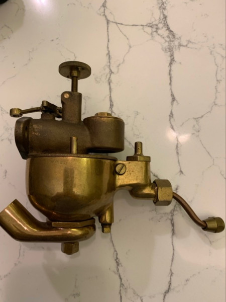

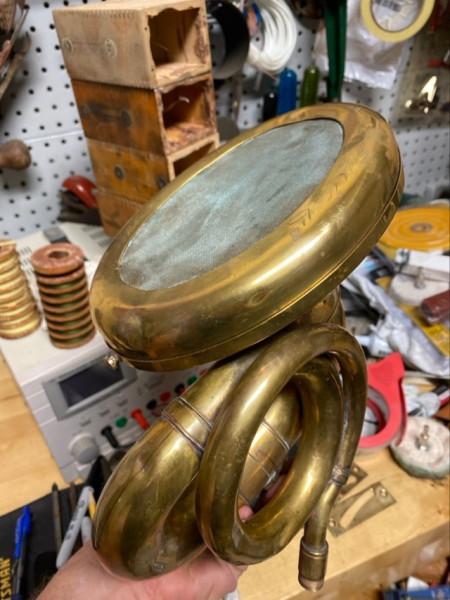

michaelb2296
- Posts: 243
- Last Name: Bunner
I’ve restored the coil box and coils.
I’ve polished brass and sat on the shelf or in
A box for the future. I bought 8 side step irons just to get 4 good ones…
And, no those arent the four good ones. I’ve soldered , welded, primed just about everything. And even purchased some rare items for it.

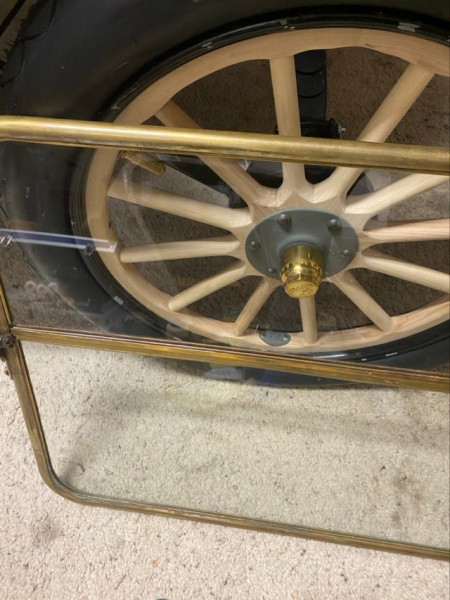

michaelb2296
- Posts: 243
- Last Name: Bunner
There is still much more to do!
I’ve gotten worthless parts, good parts, great parts,
And a whole lot more…
But one thing that is consistent is all the people who have tried to help me get to this point!
I took that back to the glass shop and said NOPE! They
Did fix it!
All Vendors have been extremely helpful.
Did fix it!

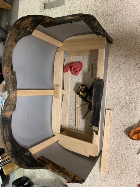

And, so im getting very close… but still lots more to do!
michaelb2296
- Posts: 243
- Last Name: Bunner
I originally thought this was a typical 1912 until i put the
Firewall on. I found out quickly that this wasnt a later
1912 but rather a late 1911. So, i purchased a Dec 1911 motor for it. Bought a scat crank and am in the process of rebuilding it. A good man from Colorado repoured the mains and the rods and now it’s just a matter of time! Speaking of which, Time-Saver????? Nope. Hours and hours of take it apart, clean, add oil time-saver, tighten back up then redo over and over…. Not saving much time…

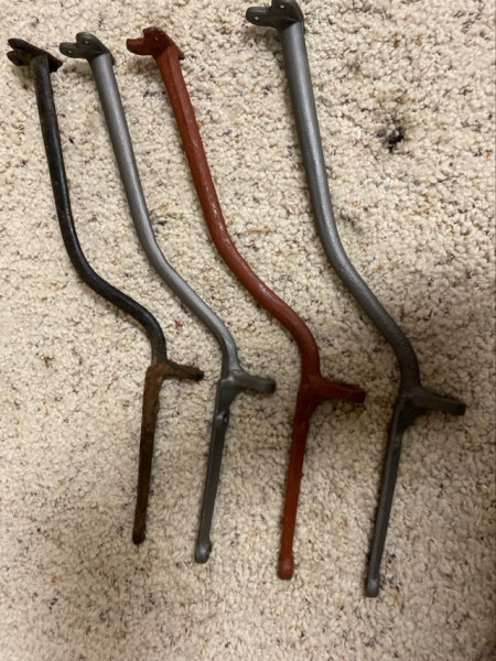

The item pictured in big2bird's Aug. 10th post, titled "Coupe Gizmo?", looks a lot like the metal items on the upper outer corners of the wood dash.
michaelb2296
- Posts: 243
- Last Name: Bunner
Absolutely George! I will continue with those fenders which were available in 1912. And as a man in SC said he likes the round ones for his commercial roadster, i like these for my Torpedo!
Pat, The gizmo’s in Dons’ earlier post were windshield adjusters, if that is what you are referring to? I had them powder coated just in case i drive it and find it too hot on a sunny day without some air movement. I havent installed them yet. If you’re referring to the brass sidelamp brackets, well i had 3 types to choose from and liked them the most! The more brass the merrier!

Here are two fully restored Model T's available for the price shown in the picture. Both are award winners. Budget your find to bring its restoration in par with these. The subtract from the ones for sale to determine what the find is worth.
Headlights $2,000 ?
Sidelights $ ?
Radiator $1,800
Tires $2,000 - $4,500
Fenders $1.700
Carbide Generator & parts $2,000
Paint per gallon $
Wood Spoke wheels & Rims $
Brass Windshield/parts $1,000
Top Bows & Material $
Engine Rebuild $
Seat Restoration $
etc
Headlights $2,000 ?
Sidelights $ ?
Radiator $1,800
Fenders $1.700
Paint per gallon $
Engine Rebuild $
Seat Restoration $
etc

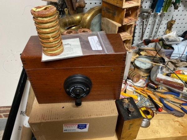

Finishing up the “timesaver”engine build…. Everything is GREAT until you torque it all down!
