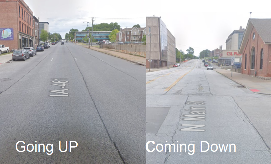

Norman, and others who think the repro Rockies not holding in reverse is not a big issue and you will have time to react, have probably never been in that situation. Now I will say we have a KC Warford trans. It was part of the problem, but not all.
We were climbing a average hill on blacktop. Nothing really very steep. I was in Warford overdrive and was shifting to Warford 2. I missed the shift and was stuck in the cross over from 3 to 2 for just a second maybe 2 seconds. But it was enough to stall out and start to roll back. So I was in a true freewheeling neutral. Now I have many years and many miles in a T. I always thought I could grab the emergency brake handle and stop the car rolling back with the large drum 26-27 style lined drums. I even practiced it a few times and felt confident I could safely stop the car in the event of rolling back. But the 2 or 3 seconds I wasted messing with the gear shift and only one hand on the steering wheel allowed the car to roll back and as T's do in reverse the wheels turned violently hard left causing the car to U-turn backwards and off the side of the road, and then slide sideways about 30 foot till we reached the bottom of the slope causing the tires to dig in and flip the car over. We were lucky and no serious injuries. There were 2 more Model T's behind us. Their owners helped us, and stayed with us till the State Trooper and wrecker arrived. While waiting I asked the other T owners to think about how long it was from the time I stalled out till we were upside down in the ditch. After thinking awhile one said 7 seconds, the other said 9 seconds and I said 8 seconds. But in reality the first 3 seconds sealed the fate of the event. Yes, if I had grabbed the emergency brake handle I may have stopped the whole event from ever happening. But after that first 3 seconds, there was nothing I could do. Even if I was younger and still in my 20s, I probably could not react fast enough. So unless you have " cat like" reflexes, do not count on the emergency brakes saving you. Sometimes "maybe", most of the times "not".

Having been a professional driver for 25 years for one of the top two freight carriers, they categorize accidents as preventable / nonpreventable, regardless of legal fault. A very small percentage are nonpreventable. You avoid accidents by being fully aware of your surroundings, your vehicles limitations and not fully depending on the other drivers for your safety.
"Worried about the driver in front stopping suddenly". Why are you following so close?
I have no problem with people doing whatever they want to their own car. For some, it's easier to modify your car than to modify your habits.

Re: Disc brakes
You don't always go up the hill first. I've had the experience (before I got disc brakes) of going down a steep hill in low, from level land to a stream crossing. The engine was whining, the car still accelerating while I pumped the tranny brake trying to slow it down without locking the wheels. I can't think that was good for the transmission. In similar conditions I might still use low gear, but with the disc brakes I can control the speed and keep it from going too fast without abusing the internal brake drum.
