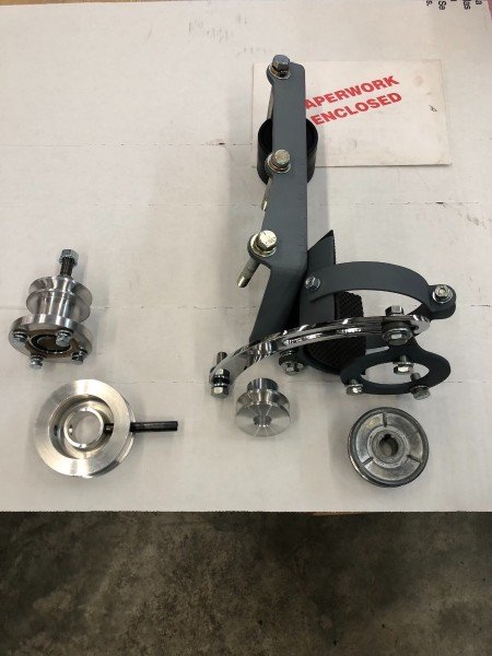

Can anyone tell me where to source these bolt on generator "kits" for non-generator cars?

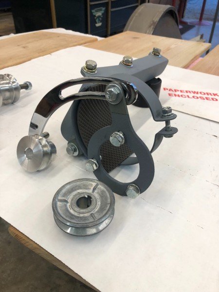

I understand wanting to use a generator for period correctness but I'm stumped on the ratio that setup will turn the generator. A T generator
is driven @ 150% of crank speed & that appears to be 100% or less? Jeff can you get a T generator to put out enough @ the reduced speed?

To hang that much bracketry on an early motor just to stay with a T generator, is puzzling to me. Would it not be just as effective to mount a later alternator. It has inbuilt mountings,is way more easily adjusted, and likely cheaper than a working T generator, at the same time being somewhat easier to maintain.
I do not like modern add-ons generally, especially alternators in place of generators on cars that have same. However, what is proposed is a departure from original, so it may as well be a neat and tidy departure.

I'm not sure what those gear ratios are on those pulleys. Max output of a T gen is 100watts. P=VI, so 100w/6v=16.667 amps. I always recommend charge rates of 3-5A, so if it was a reduced speed, it would charge, yes. If you notice how the gen acts when a T is idling, there is very little if any charge. But it doesn't take much more RPM to"kick in" and charge at 3-5a.Craig Leach wrote: ↑Tue Aug 19, 2025 11:14 pm? Jeff can you get a T generator to put out enough @ the reduced speed?
Craig.
I'm sure someone has measured and graphed a T generator's current output to RPM.
Those parts in those pics I posted were also sent to me several years ago by Henry K. Lee. I used them to build a generator test stand. It works very well made and works quite well, so I'd have no issues installing it on a car.
Jeff
