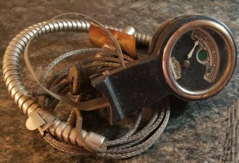

Red liquid is a colored alcohol. Don’t know the exact composition. Perhaps a Boyce patent document. (Radiator neck mounted MotoMeter.)
MotoMeter remote steering column mount temperature gauge does work off a gas. This is why a picture is worth a “thousand words” to minimize confusion over terminology.
OP is probably referring to one like this below.

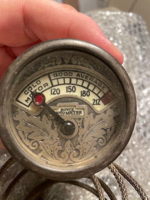

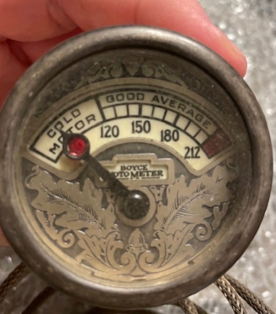

Sorry fellas, it is an original Boyce MotoMeter brand water temp gauge that goes on the dashboard or steering column. It has a tube that runs from the sensor to the gauge. Here is a picture.
Williamson’s is not in California, so I don’t think that is the issue.

That type of temperature gage uses a capillary type tube. Apparently, the tube has cracked or broken somehow and allowed the pressurized gas to escape rendering the gage unless.
I owned a 1931 Chevrolet back when I was young and it had a capillary type of temperature sensing temperature gage.
The small tube is under internal pressure and has a chemical of unknown composition to me. As the temperature raises, the indicator moves accordingly.
I would try and see if a similar internal mechanism including the tube be located and swapped into your gage.

That is one of the nicest looking Boyce MotoMeter remote temperature gauges I’ve seen, especially the embossed oak leaf scroll motifs. No wonder you would like to get it repaired. Best of luck in finding a repair source.Reno Speedster wrote: ↑Tue Aug 19, 2025 7:52 pmSorry fellas, it is an original Boyce MotoMeter brand water temp gauge that goes on the dashboard or steering column. It has a tube that runs from the sensor to the gauge. Here is a picture.

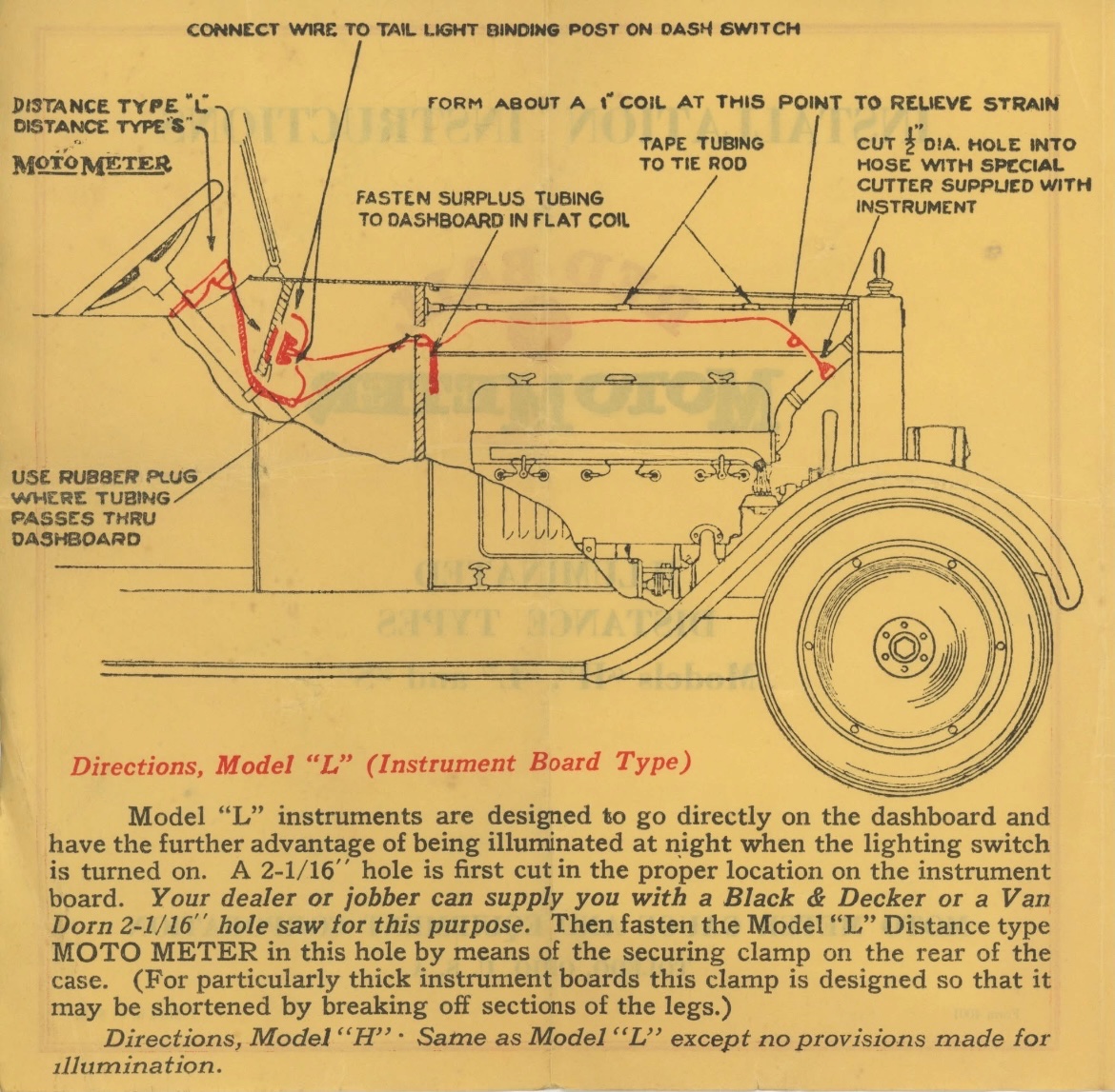

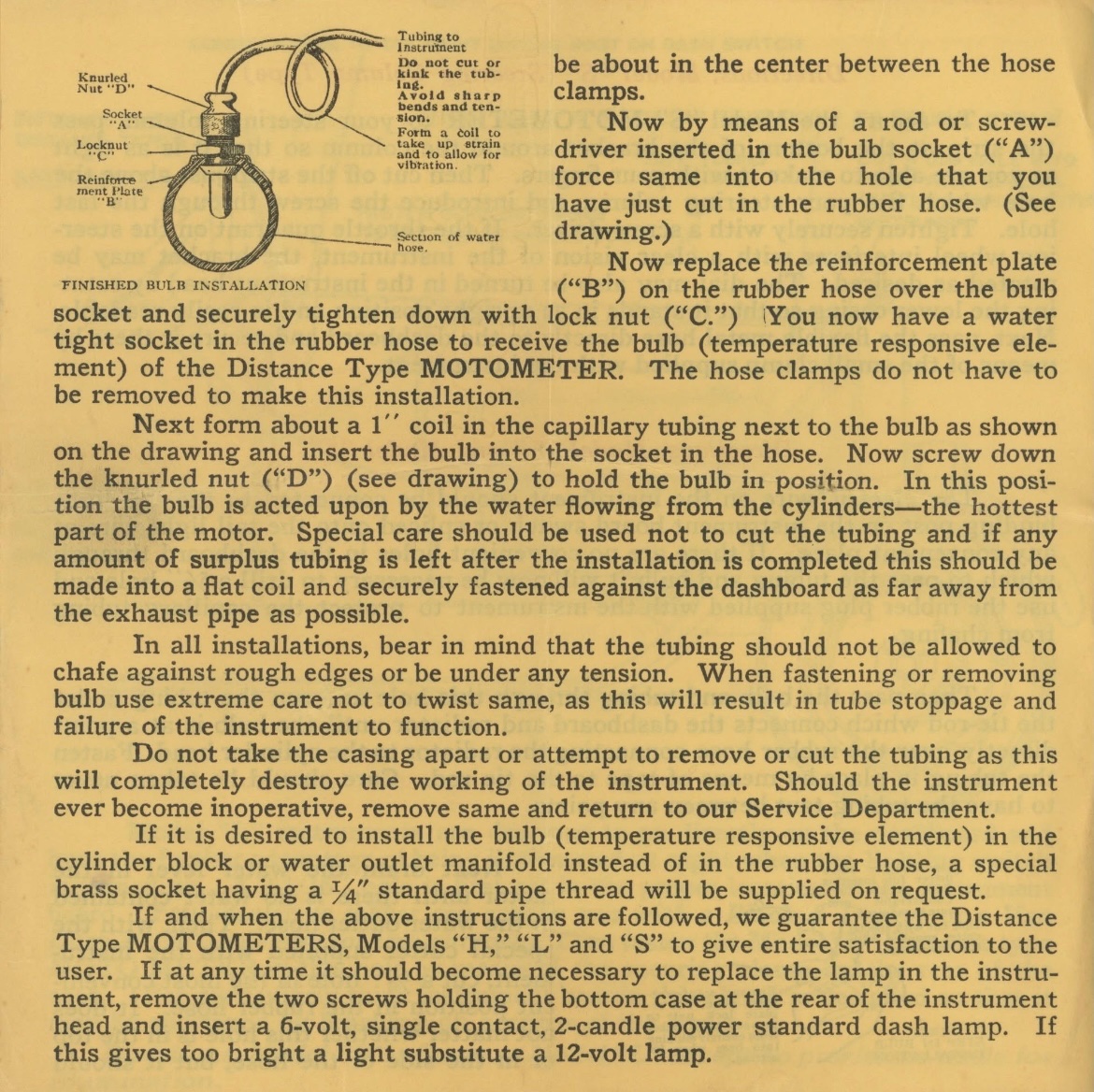

Did find instructions for that meter.
