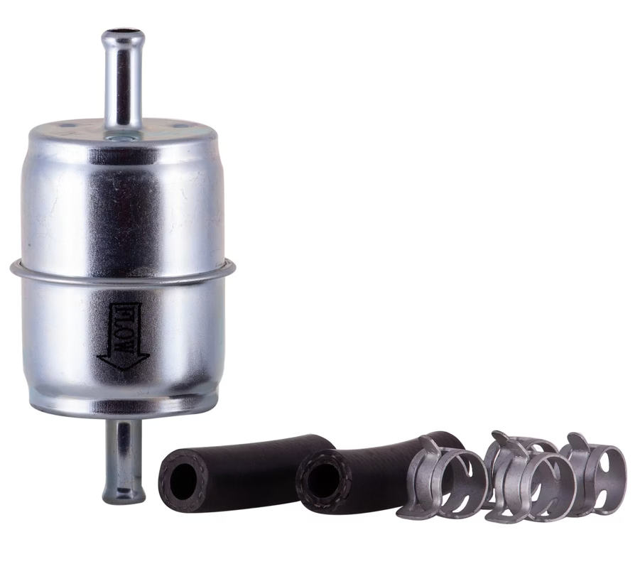

Don’t use an automotive type in line filter. What I’ve always used on my T’s is a lawnmower in line filter. Most of them are gravity feed like the T. It’s not the same as a pump type auto fuel system. Never had a problem using them.

I've come across a filter that looks like what you posted... it would work, but if you ended up with some trash/sediment in the tank there would be no way to drain it out easily right?... at least not something as easy as turning a petcock valve or removing a bowl.

Re: Sediment bowl/bulb vs modern fuel filter
In some cases, the pleated paper filters can become restricted from traces of moisture in the fuel even when there is no dirt present. It's not uncommon for ethanol gas to be slightly hydrated, and any gasoline can absorb a very small amount of moisture. The paper element will trap and hold the moisture, which makes it less permeable to gasoline. This can happen when no free water is present.
The only external in line fuel filter I have had excellent luck with is the Mr. Gasket Clearview filter. It is not a paper filter so no or very little restriction. They are available for 1/4, 5/16, and 3/8 fuel line. It is a clear glass filter so you can see if there is crud in the filter. You can also take it apart to clean it or replace the filter element. I believe there are now knock offs of this filter as well. Link to show you the basic filter:
https://www.google.com/search?client=fi ... uel+filter
I also use VW fuel filter screens inside the tank. If interested in how I do it leave a comment and I can post explanation as well as photos.
Terry
Terry
True, it’s a little more effort. Sediment would collect around the neck of the filter screen and just sit at the bottom of the tank. Cleaning it out means draining the tank and removing the fitting. The loctite sealant isn’t permanent so that’s not a huge issue. Fortunately the gas here seems pretty clean and I’ve seen very little for the past two years since the screen has been installed.fireheadman wrote: ↑Sun Aug 24, 2025 11:03 amI've come across a filter that looks like what you posted... it would work, but if you ended up with some trash/sediment in the tank there would be no way to drain it out easily right?... at least not something as easy as turning a petcock valve or removing a bowl.
