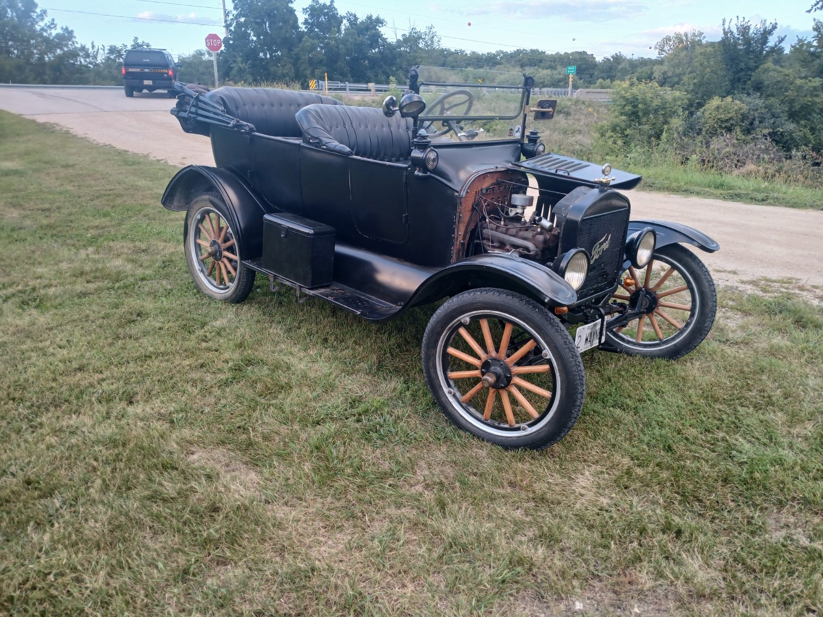

I turned onto the highway off of river road, drove over the bridge and waited for oncoming traffic of 2 motorcycles and a few other cars.
The road makes.a jog over the bridge and that's all I wanted to do...
This is more or less exhactly where I was when I was hit. Note the guardrail on the right and he could only get over so far, or didn't have time to, I don't know. I was in my lane.
This was the view behind me, plenty of straight road to see me, no curves. The sun was setting but still 2 hours of good daylight left. But 'he didn't see me."
My turn signal was on and I had a slow moving vehicle sign...

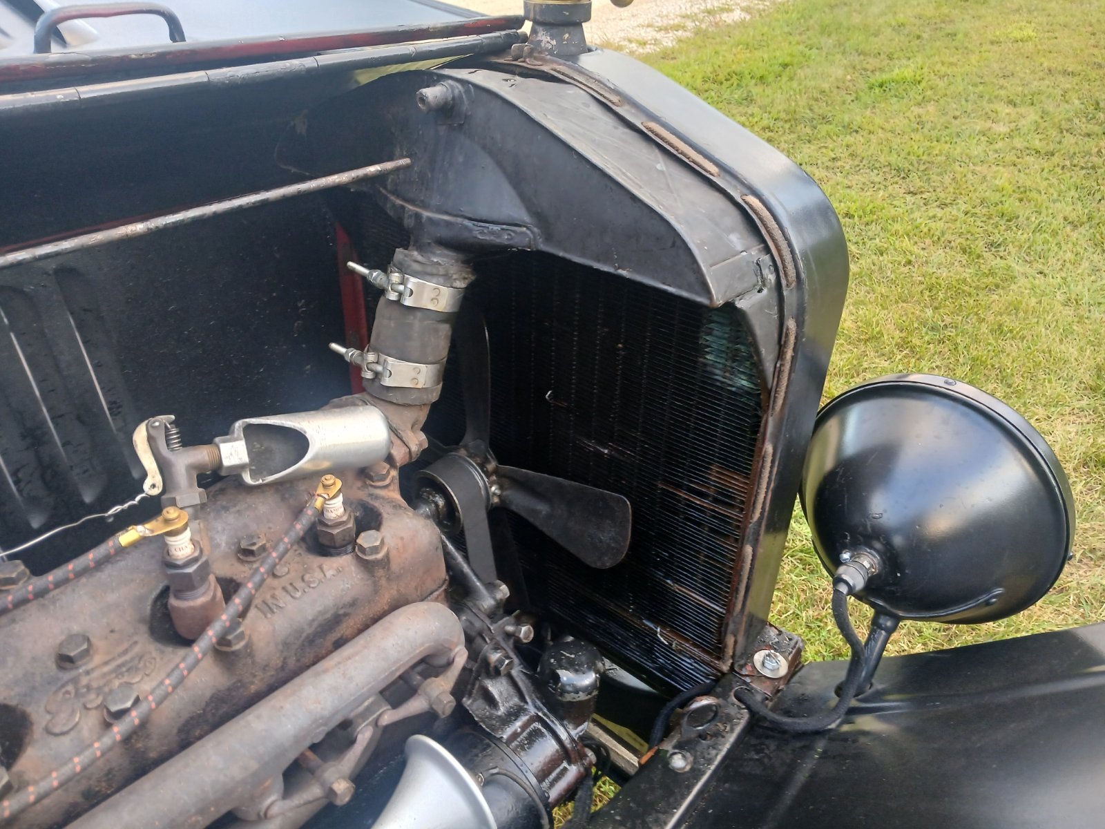

It's odd that the radiator stay rod disconnected from the radiator. I wonder if it only had a thread or two holding it. The radiator appears to be OK.

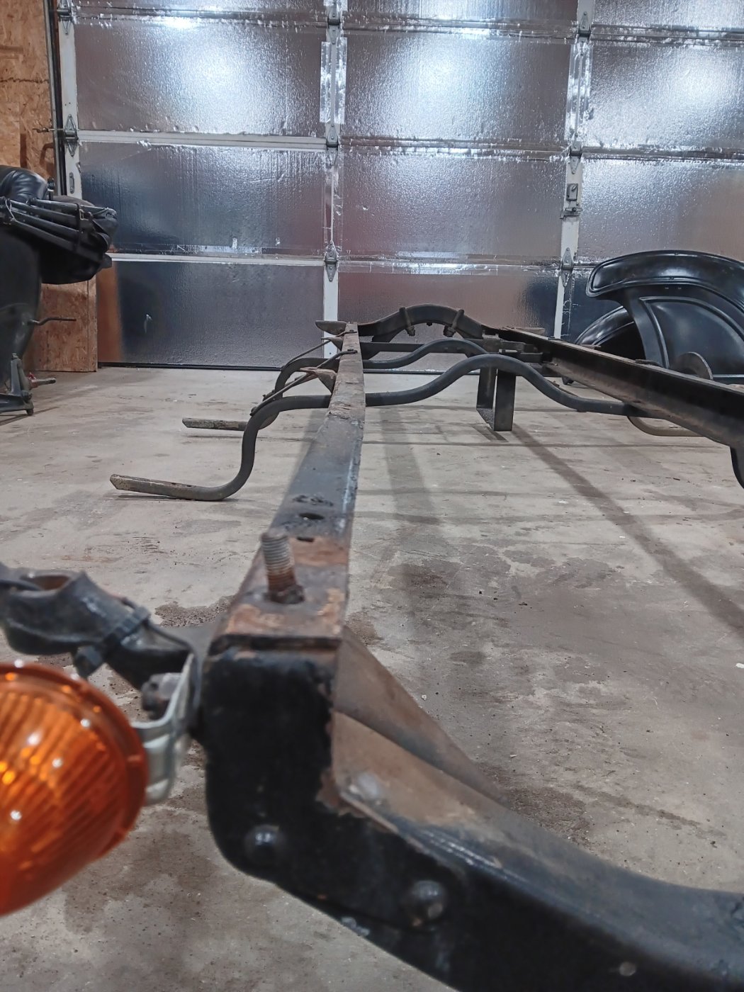

Last year we rebuilt my motor and it was 0.058 out of line. I suggest you pull that engine and measure everything. I am sure there are enough people on this forum that will help you rebuild your car, or supply parts that you might need. Let us know.

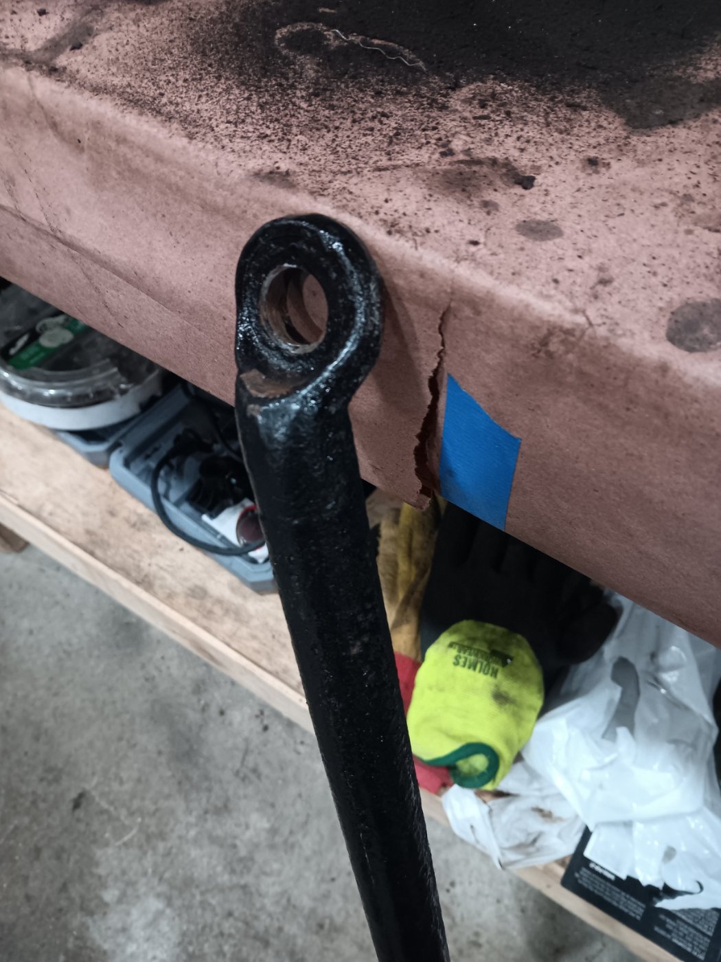

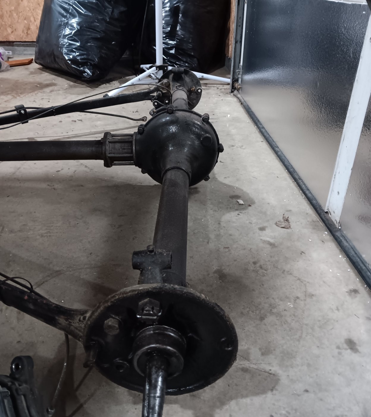

As for the car, that's another story. It doesn't look too bad first glance, but there's a good chance it may be totaled. Either way, I want to keep my T though. The insurance adjuster comes tomorrow, so that promises to be fun. We did some rough measuring on the rear axle and with the wheels as straight as possible, there is about a foot difference between hubcap to hubcap on each side. Not a good sign...
The right radius rod is pretty bent up and the wheel is warped about an inch. As for the rest of the drivetrain, I don't know. The body damage seems relatively negligible, other than the right quarter panel and fender.
Currently, I feel good and am waiting to get an appointment so I can get back to work and resume my normal life.

I've wondered the same. I can't tell that many threads have actually been pulled out or not. Unfortunately I don't have a very recent picture of the engine bay with that rod in the picture, so there is that chance.

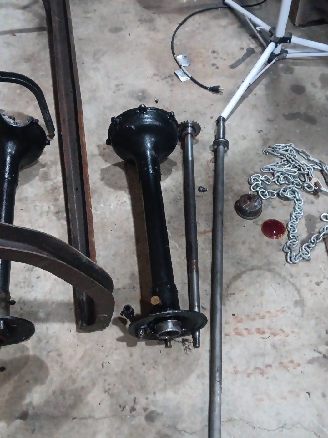

If the radius rod is bent, the driveshaft is probably bent, and maybe the axle housing. I'd look for trouble around the rear engine mounts and u joint housing. If the frame is not bent severely, it can be straightened. It may not be bent at all. You might want to take the rear radius rod loose where it attaches near the u joint, then sight down the driveshaft housing to see if it is straight. Looking through the wheel spokes across the rear axle housing should reveal whether it is severely bent or not.

Before this goes to doom and gloom, let's step back and take a breath. There have been a lot of worst case scenarios put forth here, but the T rarely has survived a century without accumulating a few dents and scratches. The T ain't all that fragile. I would go over the car with a fine-tooth comb, then proceed from there. The bent radius rod could be a sign that there is further damage elsewhere, but it could be that the damage doesn't extend beyond he rod. I couldn't tell from the photos, but is there any significant body damage beyond the fender? I would replace the radius rod, get the radiator back where it belongs, then take a short test-drive to see if anything else rears it's ugly head. If you start taking major components apart, you are almost sure to find other stuff that needs some love and work. The driver of the car that hit you isn't responsible for parts that were pretty much used up; you could find yourself with a pile of bills that you will have to pay. The insurance company and the body shop are required to return the car to pre-crash condition. Nothing more. I know of a story where a then-modern car was hit from behind, which destroyed the rear bumper and the Wall Drug sticker that was on it. The customer wanted the Wall Drug sticker, and the insurance company had to pay for it.

A foot difference between the two sides of hubcaps to hubcaps length. That is wheel base. Something is bent somewhere.
Maybe need get Bob from Bendin with Bendon to look at it??
- Posts: 7167
Re: My model t accident
Re the radiator to firewall stay, it should be locked at the casting on the radiator. This stops the rod '"working" under vibration while the car is in operation.Otherwise, the thread can be seriously compromised.
Hope this helps, everyone.

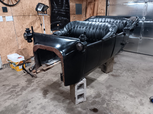

UPDATE

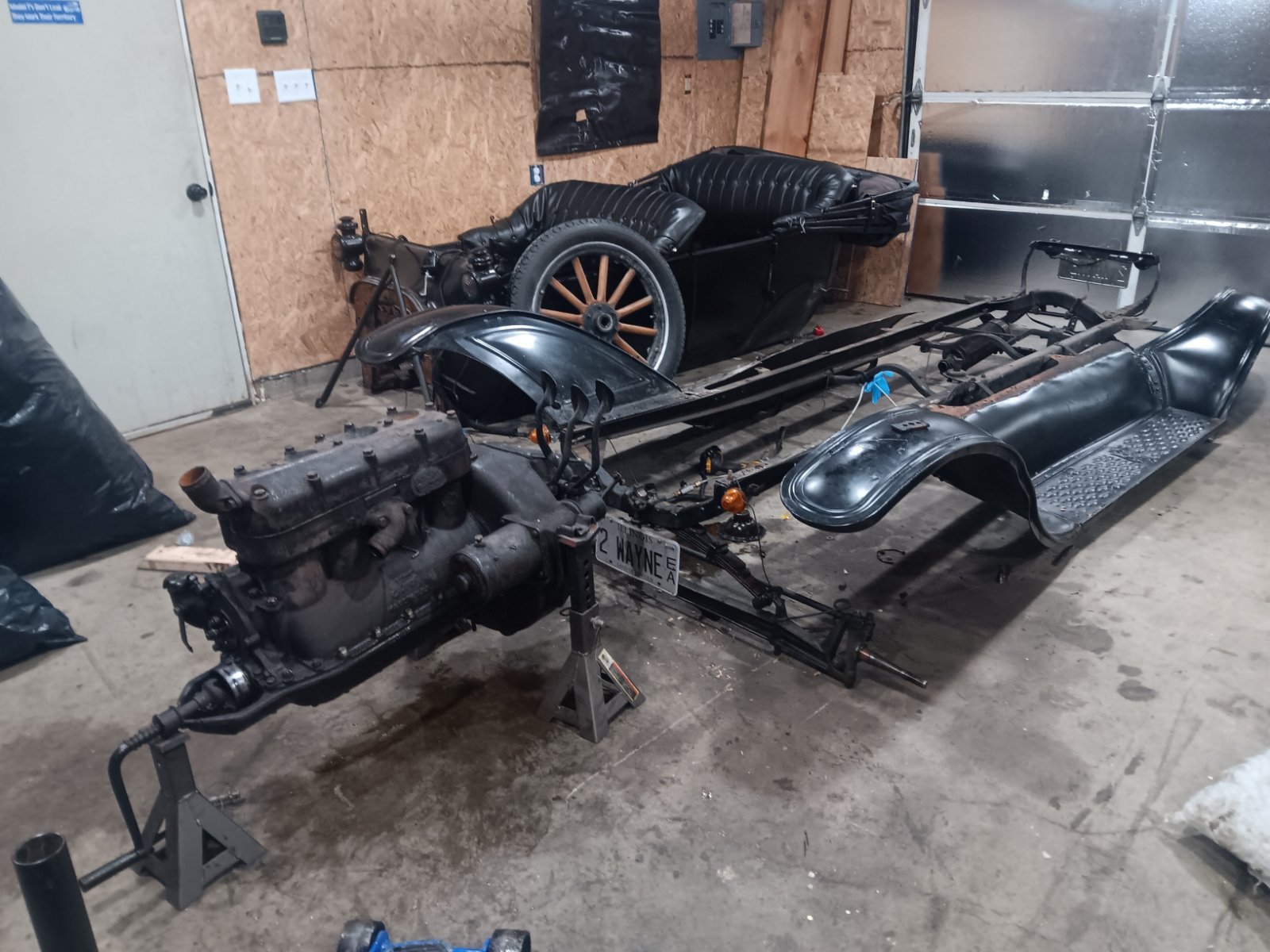

I figured I would post an update after my accident. It's been about 4 months since I got hit. Since then, Insurance has come through and I have torn the car down to start repairing it. I got checked out by a doctor a few days after, and got the all clear. I had a little whiplash for about a day and a half, but it went away on its own.
I had the car looked at by a local T club member and antique car restoration business owner. I submitted it to insurance. And they rounded it UP of all things... Insurance totaled the car, as I figured they would. I had a buyback of $1500 for the T, and after other expenses, it came back to what I had the car insured for. For those curious, I have country companies. They aren't the cheapest around, but when I needed them, they were there. I didn't have to talk through one single automated voice, and they paid me before they went after the other insurance company.

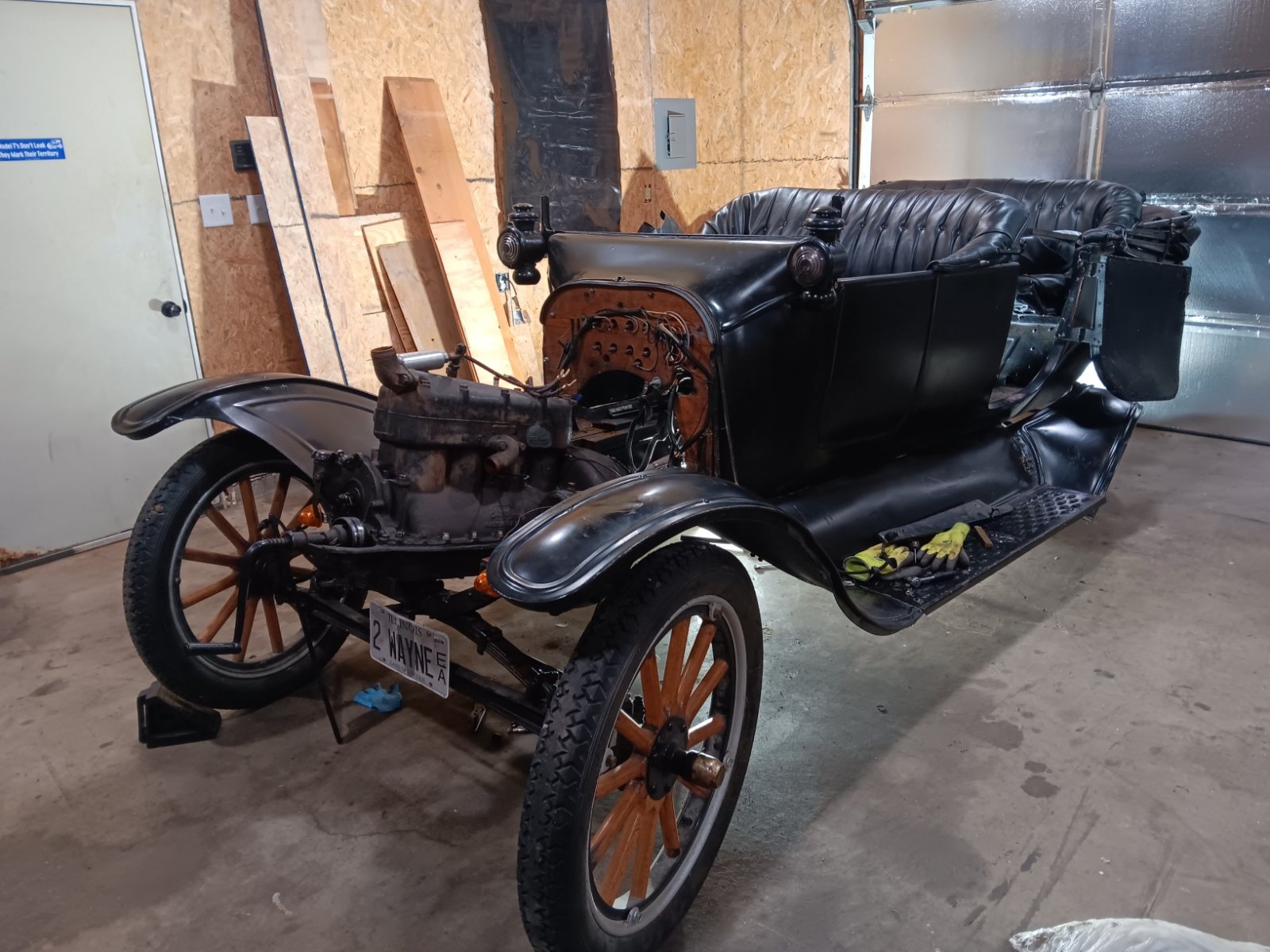

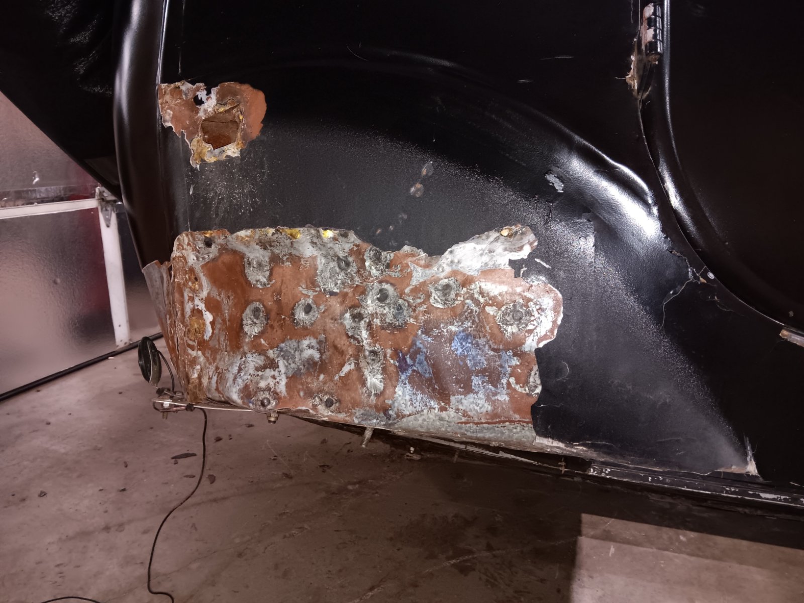

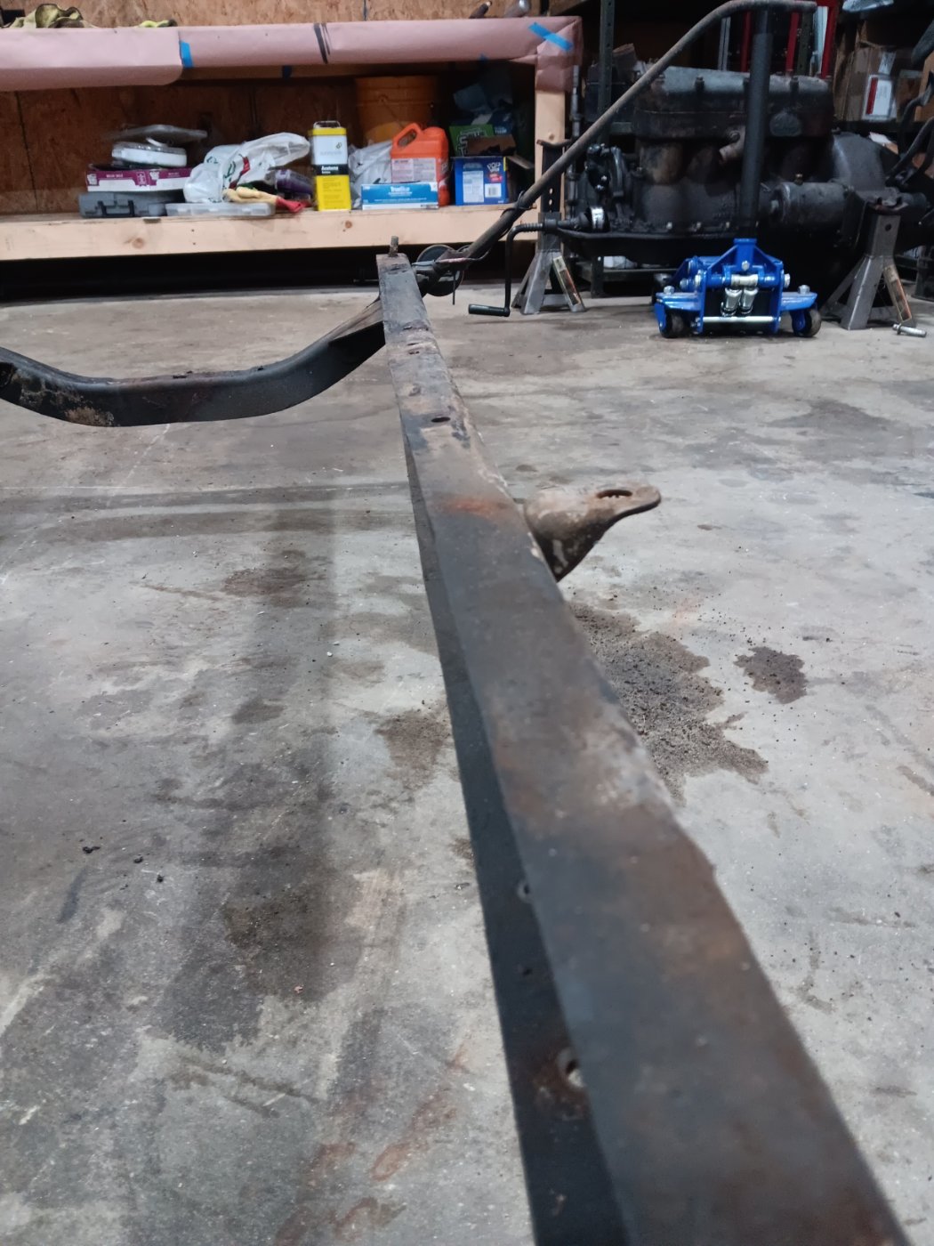

As for the car, it didn't look too bad, but I've torn down the whole car just the same. This car has seen it's fair share of adventures, to put it lightly. It is FULL of bondo and galvanized steel paneling. I knew it was cobbled together, but I didn't think it was as bad as it is, until I pulled it apart to really look. I started by pulling the rear end, which in hindsight wasn't the brightest thing to start with, but oh well. I pulled the motor, fenders, and the body and front axle too. The frame was tweaked multiple ways, and the accident only tweaked it more. The rails are racked about 1/2 inch, likely from the accident, however there's a lot more wrong with it than just that. I've got a better frame to put under it, and will likely use that. The right frame rail is bent 3 different ways. Its pushed in from the side about a 1/4 inch, bent where the engine ears sit and twisted longitudanly. I had an idea it was messed up when I put the motor in and saw it almost rubbed on one side of the e-brake crossbar and had an inch on the other side. The car tracked straight and didn't pull at all, so I left it.

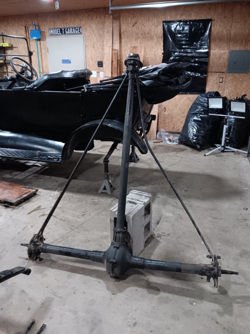

The rear axle took the brunt of the hit, and bent the housing and likely the axle. I'll probably never know, as I pulled the axle apart and the right side will probably never come apart. The housing is too bent to let the axle out and the inner hyatt bearing got cockeyed. Good thing its a standard T housing. The radius rod got bent, but the driveshaft looks ok, although it's getting a look through as well. The front axle should be ok, and the motor is getting replaced regardless. It was only temporary to begin with.
The body is going to be my first taste of bodywork, although it is going to be kind of unique. What's left of the ford steel is there, is all bent and pitted. A lot the quarter panel body beads are totally bondo. Without becoming a total coachbuilder, it will be patched back up and painted. I'm not ready to take on a project of that magnitude, and I do want to keep at least something from my old car. The right rear fedner bracket was bent. I pulled it out and straightened it. The right rear fenter should be able to get straightened, and I'm replacing the tire carrier. There's a few other small things, some accident related and some not.
At this rate, I'll have a restored car, if I want one or not...

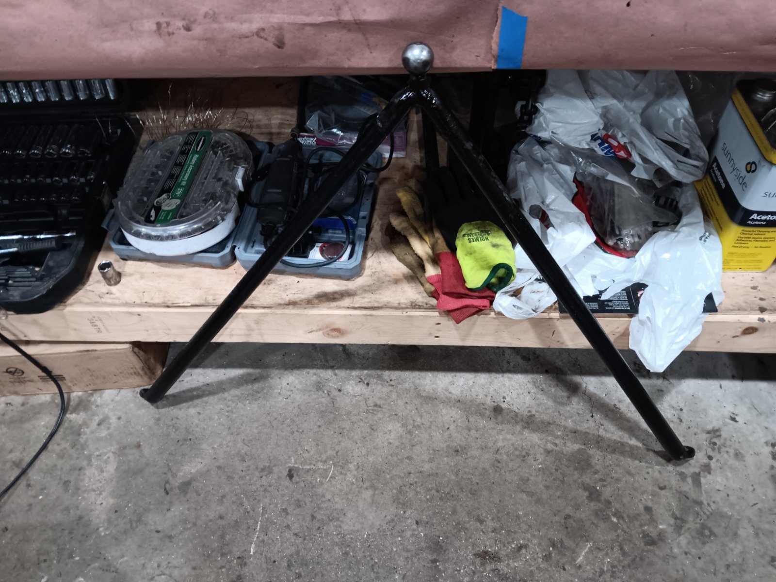

A few more pictures.
Someday I will probably replace the body. I have the body from my pickup project that will probably be used. It's sort of disheartening to.see the state of the metal. It's either this, or galvanized patches throughout.
Either way, I am happy to be Ok, and the car will be fixed. It does make you realize the dangers of driving a T on modern roads.
Be safe,
Happy T'ing
Austin
