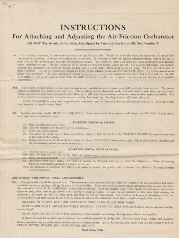

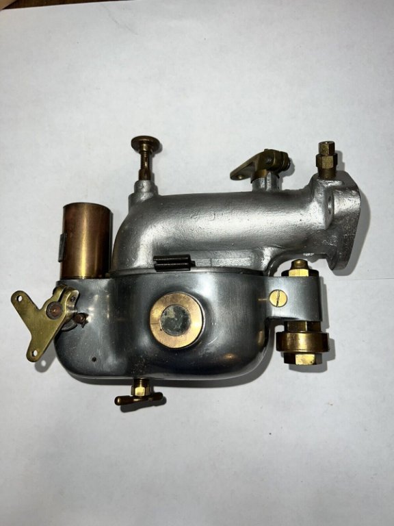

Does anyone in here know how to adjust one of these? I've been scouring the web on these things and have found a bunch of old adverts for them but i can't find a manual or anything about where the adjustments are. the mixture screw seem pretty obvious, but is it a set it and forget thing because there looks like a jam nut/wing nut on there to lock it in place. I picked one up on ebay that looks to be really nice for a reasonable price. I found this old thread on here https://www.mtfca.com/discus/messages/8 ... 1261676994 but was no real adjustment tips. and it kind of veered off course like happens frequently in our hobby! any help would be appreciated.

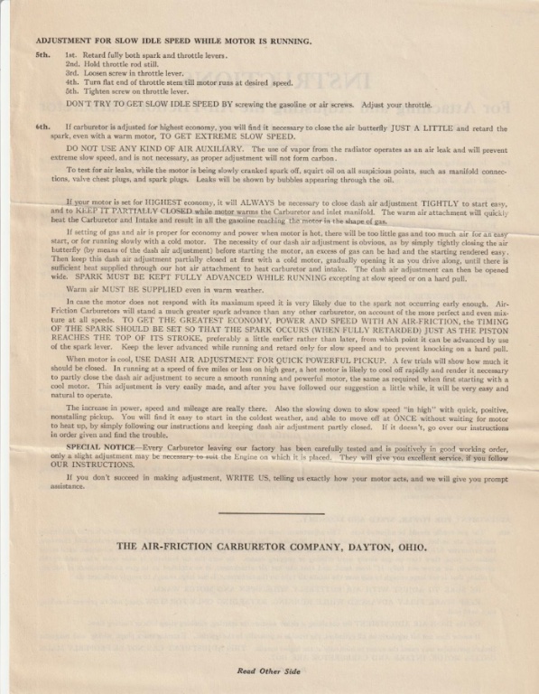

Jay Busico posted these scans of the manual for the Air Friction back in the Accessory of the Day threads.

Ah yes, that's what I was looking for, thanks! And Scott, that's about where I thought I was gonna end up. Just trial and error. Basically I bought this carb because, well I can't afford a Stromberg, and because the old nh is just so crude and we have a lot of hill where I live and I was hoping something with a little more adjustment may help a little. Not sure that it will but it's worth a shot. I can't climb anything with that nh unless I'm in low. And I've completely rebuilt the engine, bored, high compression pistons, adjustable tappets, basically everything but the balanced crank (which I also can't afford) but it's such a dog. Runs fine on flat ground but these hills are just too much for it. I've tried different nh's even, thinking maybe I have a passage locked or something but they all act the same. Makes no sense to me and I've built engines half my life. It's got me stumped for sure so the only thing I could figure is maybe those nh carbs are just so crude they can't handle steep hills.

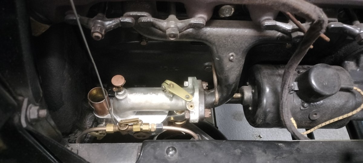

Thought I would give an update, I got the carb on and adjusted it. It definitely has made a difference. For one, when you start it cold just a brief choke and it instantly fires up and absolutely no sputtering until it's warm enough to smooth out. Just a smooth idle out of the gate. It's never done that. I'm not sure about all the claims air-friction made about power
but it definitely will pull better up the hills. It's a bit more responsive as well. Anyway, it is an improvement none the less. But I suspect Scott is right, that the nh I had probably did not have the correct parts inside. That pic is before I got the linkage all straightened out. It definitely is built like a tank. Brass levers and insides. I'm happy with it.
