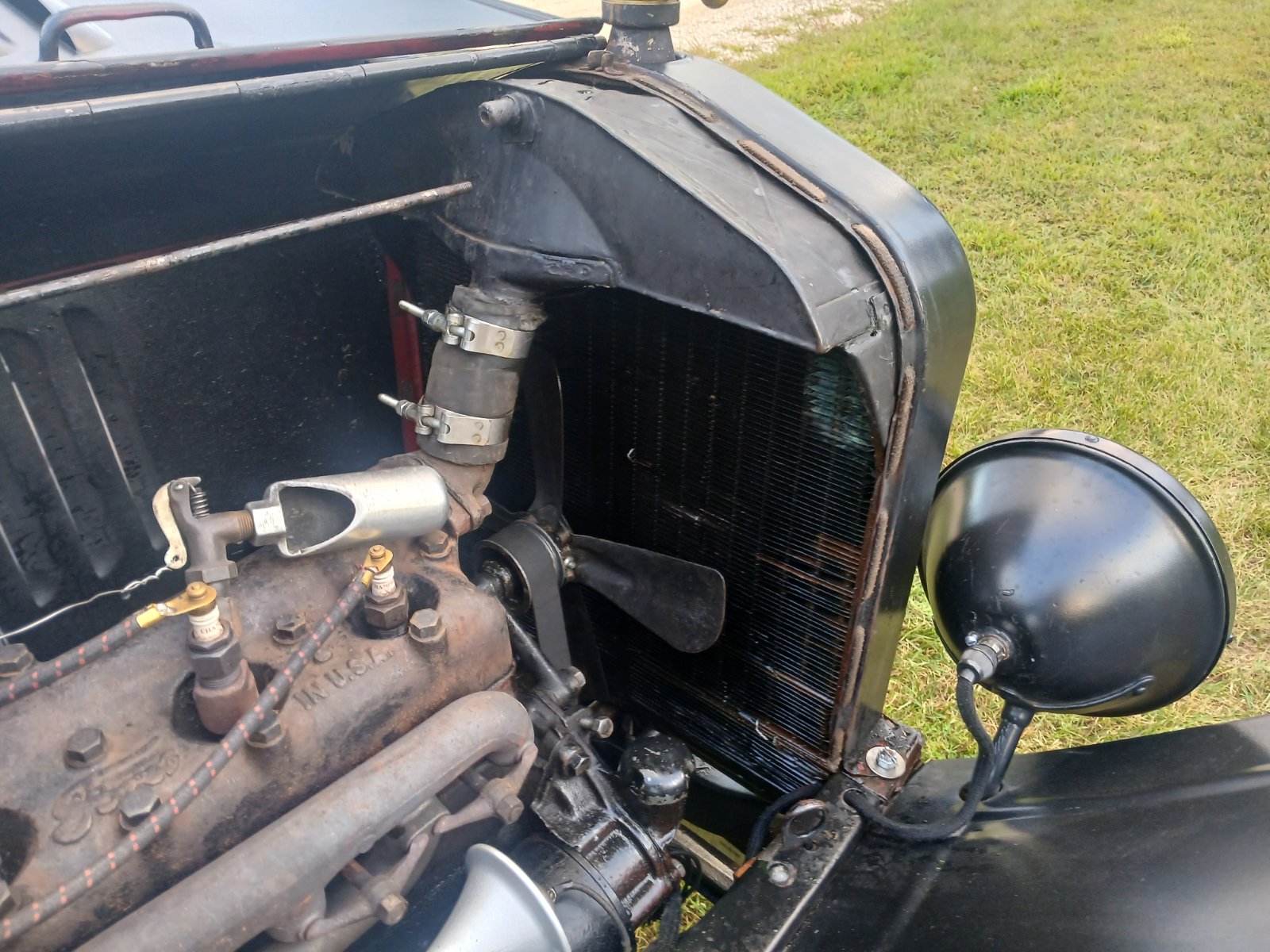

It's odd that the radiator stay rod disconnected from the radiator. I wonder if it only had a thread or two holding it. The radiator appears to be OK.
I've wondered the same. I can't tell that many threads have actually been pulled out or not. Unfortunately I don't have a very recent picture of the engine bay with that rod in the picture, so there is that chance.

I use a jamb nut on that rod. That way it can't loosen up.

If the radius rod is bent, the driveshaft is probably bent, and maybe the axle housing. I'd look for trouble around the rear engine mounts and u joint housing. If the frame is not bent severely, it can be straightened. It may not be bent at all. You might want to take the rear radius rod loose where it attaches near the u joint, then sight down the driveshaft housing to see if it is straight. Looking through the wheel spokes across the rear axle housing should reveal whether it is severely bent or not.

If the drivetrain has that damage, the engine & transmission also has severe damage. I’ve had a good deal of experience working on T’s professionally and have had the chance to see some “hidden damage” from events less severe than yours.
If you take your engine fully apart, YOU WILL find that your drive plate, transmission shaft flange, crankshaft flange, & pan are bent at the very minimum. In a high quality rebuild the rotating parts would be scraped, not reused. Many other parts could be damaged beyond “quality”. A replacement engine & trans could be $6,000 to $14,000 depending upon quality. Make sure your insurance estimator knows that.

Re the radiator to firewall stay, it should be locked at the casting on the radiator. This stops the rod '"working" under vibration while the car is in operation.Otherwise, the thread can be seriously compromised.
Hope this helps, everyone.

UPDATE
I figured I would post an update after my accident. It's been about 4 months since I got hit. Since then, Insurance has come through and I have torn the car down to start repairing it. I got checked out by a doctor a few days after, and got the all clear. I had a little whiplash for about a day and a half, but it went away on its own.
I had the car looked at by a local T club member and antique car restoration business owner. I submitted it to insurance. And they rounded it UP of all things... Insurance totaled the car, as I figured they would. I had a buyback of $1500 for the T, and after other expenses, it came back to what I had the car insured for. For those curious, I have country companies. They aren't the cheapest around, but when I needed them, they were there. I didn't have to talk through one single automated voice, and they paid me before they went after the other insurance company.
As for the car, it didn't look too bad, but I've torn down the whole car just the same. This car has seen it's fair share of adventures, to put it lightly. It is FULL of bondo and galvanized steel paneling. I knew it was cobbled together, but I didn't think it was as bad as it is, until I pulled it apart to really look. I started by pulling the rear end, which in hindsight wasn't the brightest thing to start with, but oh well. I pulled the motor, fenders, and the body and front axle too. The frame was tweaked multiple ways, and the accident only tweaked it more. The rails are racked about 1/2 inch, likely from the accident, however there's a lot more wrong with it than just that. I've got a better frame to put under it, and will likely use that. The right frame rail is bent 3 different ways. Its pushed in from the side about a 1/4 inch, bent where the engine ears sit and twisted longitudanly. I had an idea it was messed up when I put the motor in and saw it almost rubbed on one side of the e-brake crossbar and had an inch on the other side. The car tracked straight and didn't pull at all, so I left it.
The rear axle took the brunt of the hit, and bent the housing and likely the axle. I'll probably never know, as I pulled the axle apart and the right side will probably never come apart. The housing is too bent to let the axle out and the inner hyatt bearing got cockeyed. Good thing its a standard T housing. The radius rod got bent, but the driveshaft looks ok, although it's getting a look through as well. The front axle should be ok, and the motor is getting replaced regardless. It was only temporary to begin with.
The body is going to be my first taste of bodywork, although it is going to be kind of unique. What's left of the ford steel is there, is all bent and pitted. A lot the quarter panel body beads are totally bondo. Without becoming a total coachbuilder, it will be patched back up and painted. I'm not ready to take on a project of that magnitude, and I do want to keep at least something from my old car. The right rear fedner bracket was bent. I pulled it out and straightened it. The right rear fenter should be able to get straightened, and I'm replacing the tire carrier. There's a few other small things, some accident related and some not.
At this rate, I'll have a restored car, if I want one or not...

A few more pictures.
Someday I will probably replace the body. I have the body from my pickup project that will probably be used. It's sort of disheartening to.see the state of the metal. It's either this, or galvanized patches throughout.
Either way, I am happy to be Ok, and the car will be fixed. It does make you realize the dangers of driving a T on modern roads.
