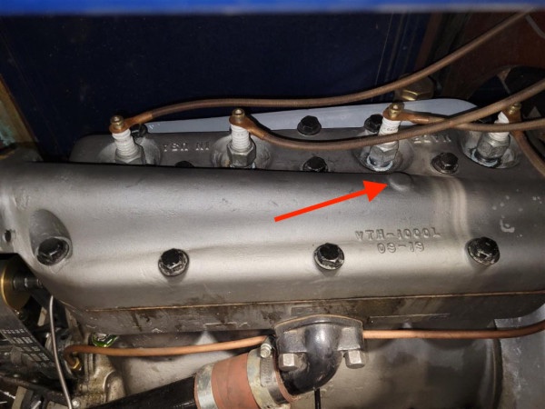

Post by TRDxB2 » Mon Sep 15, 2025 9:06 am
Not sure if this is an identifier for a READER head. Read posting viewtopic.php?t=37773

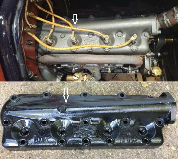

Previous forum discussions on the Reeder head. Believe they were made in High and Low styles.
And that round casting sprue on top is an identifier.

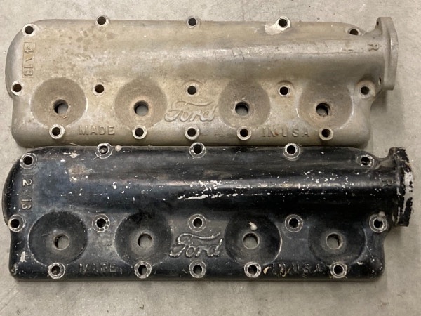

Another one was identified as “Ron Genson”made, has "R' on the top of the water outlet neck.
Correction:
Reply on name spelling:
“I saw your post for aluminum heads. It was Rod Genson who made the heads at the Palmer Foundry in Mass.”
Kevin Prus
