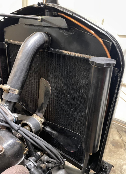

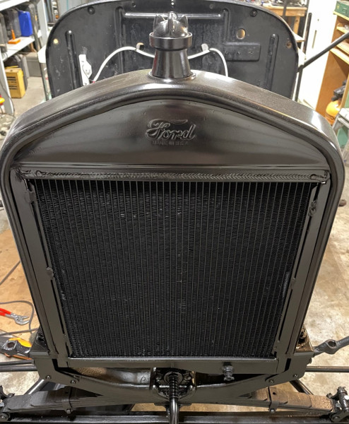

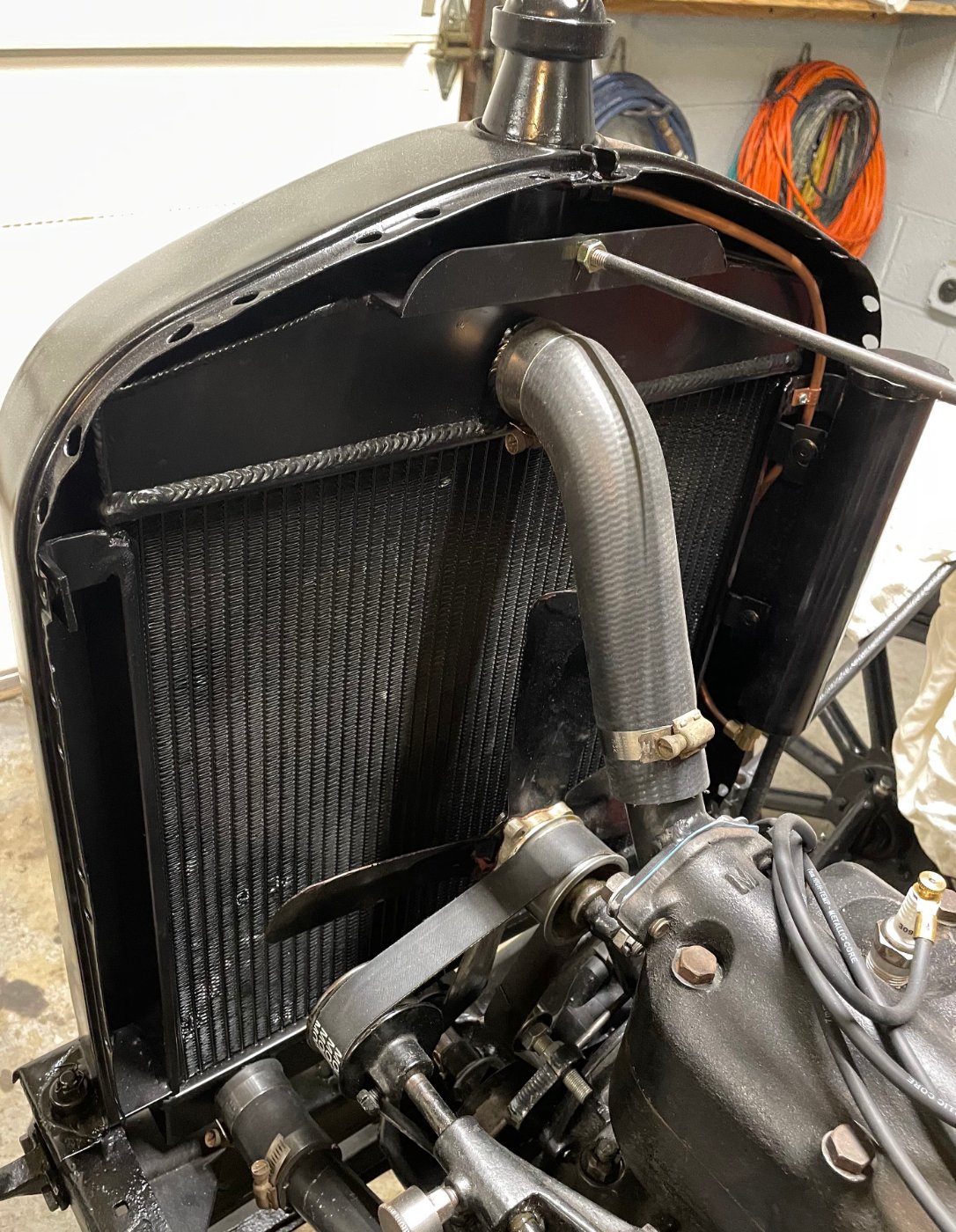

My TT radiator had more JB weld on it than Brass and was leaking like a sieve. It was totally shot. A brassworks rad would be nice but honestly I don't have the money right now. I needed to buy four tires and replace every bushing, kingpin etc to get this thing moving so a period correct rad will have to wait. This is what I came up with for a temporary radiator for my TT. Nothing original needs to be modified so when I can afford to get a brassworks, I will. In the mean time I'm driving this thing as I continue working on it. Total cost was $250 in materials. I realize that not everyone can tig weld themselves so there would certainly be more cost if you had to pay a welder. I started with a $190 Chinese aluminum radiator for a Jeep CJ3. The filler neck was cut off and the hole filled in. A new tube of aluminum was welded in the center for the original fill neck top to mount on. The stock brackets were cut off the side of the rad and new bottom mounting tabs were welded on. A cross piece was welded on the top to attach the upper radiator rod to. A new rod had to be made as the stock one is now too short. Tabs were also welded on to hold an overflow tank. I chose to make a new steel water outlet because the new setup is 1-1/2". I'm using a water pump for now so there is plenty of circulation. I've been on several drives now and had it up to temperature and everything seems to be working quite well and staying cool. If I were to do it again I would use a slightly larger overflow tank. I used a 2" ($26) and probably should have gone with the 3" version for slightly more capacity. I got a 1-1/2" molded radiator hose from Napa ($24) to cut up and use. Some paint and we have a temporary working solution.

Neat solution.

Very nice job!
Do you have a tall or short radiator?

It’s a 24 high hood.

Hi Jason,
I doff my hat to you. I tried this with a Speedway T bucket radiator but gave up because of the labor involved in making it fit in a low shell.
It would have been a pretty EZ operation for a tall
The Speedway radiator has a large tank, it's a two core but the cores are 1" long making
it = to a three or four core. both inlet & outlet need to be move & they sell aluminum hose connectors in 1 3/4" & 2" that can be cut & welded
in place but a curved hose will be needed on top like you did. Or make the inlet to line up correctly? They have a fitting on the bottom of the
top tank that can be used for a over flow using a pass threw compression fitting. They have aluminum T style neck ( is a dummy that can be
drilled out to use as a fill.) You would have to make a rod mount also. I gave up & returned it to Speedway rather than spend hours making the
bottom tank clear the crossmember & pan nose. I ended up making a radiator from a brass forklift radiator. Saved about $1,100.

I did a ton of research into which rad to use that would fit well and require the minimum amount of work. I looked at pretty much every aluminum aftermarket radiator that is made for cars, trucks, tractors, machinery, etc. I read all the old posts on here as well before deciding on this particular rad. Labor hours wasn’t too bad actually. I did a lot of planning, measuring and sketching before actually starting construction.

Jason how many rows does the radiator have?

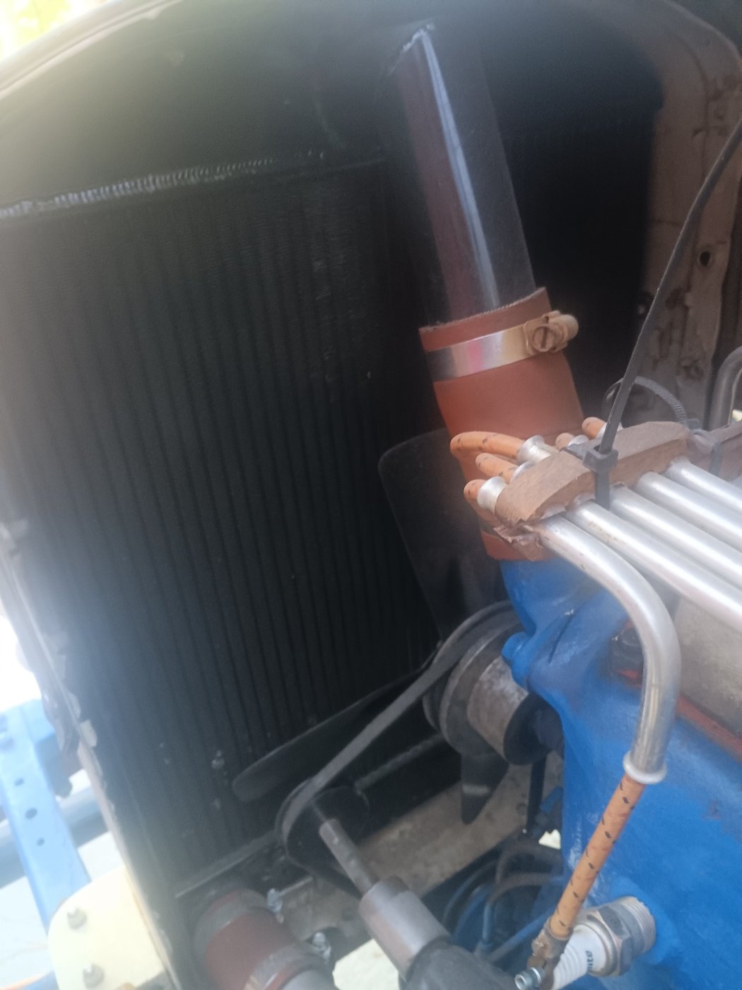

I did the same with my speedster. Biggest problem was they painted the radiator with aluminum paint but advertised it as "natural" mine was listed as a 32 lowboy if memory serves. It was fit into a cut down Minneapolis Moline radiator shell so might work for a low radiator?

Three rows.
My criteria was 1. Must have inlet in outlet in correct position already. 2. Must fit within frame. 3. Only modifications would need to be in non water contact areas. (no cutting into internal areas of rad) 4. Look OK from 10' away
https://www.amazon.com/dp/B09QZPSVXD

I went to the radiator shop that advertised doing everything. Told them I was looking for an economical option. Thought was take an aluminum core weld the inlet, outlet and fill on and be done. First it was "we will need to cnc the filler neck" i informed them that was unnecessary as 2 inch aluminum pipe works fine as it isn't threaded. Their quote $1500 needless to say I took the radiator back.
$219 bought a cheap new one on ebay. I cut/ground the cubes then found a welder that invested an hour for 150 as mines not setup. Exactly what I asked the radiator shop to do, but for $1000 less.

God bless you guys that can afford to write a check for anything & pay someone to do the work. You should be proud of yourselves I Shure am.
Unfortunately $2,000 may be our whole years budget & having to spend that on a radiator is some what discouraging.
Craig.
T cores & they would need $600 - $800 for a core & $200-$300 to install ( this would be a core with the steel plate ) Flat tube only. This would be
a re-core not a new radiator. Modern cores don't have the plate! so a shop re-core is not as good as a new Brassworks.
Looking for alternatives to save money is a need for some of us so we can enjoy the hobby. T's are not my only passion in the automotive hobby
I also like Hot Rods & am working on a T bucket ( made the body myself with some repaired T parts not suitable for restoration or not altered in
anyway ) Also a 1966 GMC pickup. Both will use repurposed radiators that can be purchased new for under $200. I'm one of those guys that does
95% of the work myself on a budget so I can afford to play, And enjoy building them as much as if not more than driving them.
Craig.

Not to steal Jason's thread or ingenuity, but if you're going in this direction, here's another cheaper solution with all parts needed ( less taxes and shipping ) for ONLY $184.40 ! The radiator to begin with is a 24-27 Ford T street rod radiator from RADIATOR CLUB. It is a 3 row, flat tube, aluminum radiator made to the dimensions of an original 24-27 T radiator and will fit under an original tall shell. It even has tabs on the side to mount on a Model T frame. Next, is an aluminum filler neck which accommodates an original T radiator cap from DILLON RADIATOR. It will need to be welded on the top tank in the position to match the shell filler neck opening. As this radiator is pressurized, it has a pressure cap filler which can be left if pressurization is desired, or removed and filled shut if the top neck was made functional. The outlet on the bottom tank is on the driver's side as the original, but the inlet is on the passengers side. it will have to be removed and the hole filled. A new provision for a radiator support rod will have to be welded on to the tank but that design is up to you. The new aluminum inlet ( from SPEEDWAY MOTORS ) will need to be welded to the center of the top tank, and that completes your radiator for $184.40 for parts. Welding labor (if you can't do it yourself), taxes on parts, and shipping on some parts (some may offer free shipping) is all the extra expense to finish. If your building a "driver", and NOT a show car or truck, this is a heck of a lot more affordable than a new brass radiator.
I forgot to mention, all these items ca be found on EBAY, so you don't have to go web surfing.
