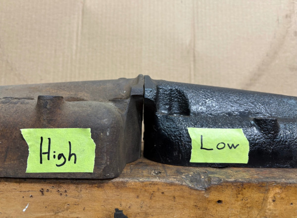

Here is a side by side comparison. The low head has been milled at some point in the past. Just as Wayne said, there really is no difference in the mounting position of the outlet.

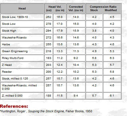

A shaved head and the overbores typical today would probably get you about the same compression increase. Modern rings would probably help gain some compression pressure by reason of better sealing over a wider operating range. Modern oil might help a little, too. Back in the day, many Ts ran with heavy carbon deposits, and some may have achieved pretty good compression pressures at lower operating speeds.
- Posts: 6373
Re: Low Head on a 26-27
Not much difference in the later stock heads 4.0 vs 3.8.
- Attachments
- compression ratios.png (105.87 KiB) Viewed 198 times
