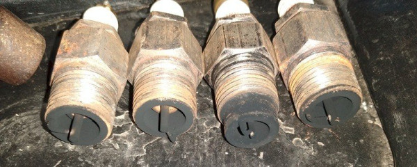

I planned on doing a compression test and pulled the plugs: I found carbon fouled plugs, gapped to .025"
The Manual says 30/1000" or 1/32" (.03125")
Champion X says .025"
Somehow the lean-rich mixture was set to 6 turns open.
The compression gauge itself, does not hold pressure any more. So I plan on replacing it. My understanding is that opening the gap will help reduce carbon fouling and that I should gap the plugs to how they work on my T. I set the mixture to 3 turns open and changed the spark plug gap to .031", then reassembled everything that was undone. I probably won't be able to test it again until Thursday night.

Vern,.. It doesn’t appear to me that your spark plug gap is the cause for your stated T poor performance. Judging by the ‘business end’ photo of the spark plugs, they’re WAY TOO SOOTY’. May I assume they became that way by your stated 6 open revolutions of the fuel/air needle ? Even the adjusted 3 open turns of that mixture needle might be a tad rich. Try 1 1/2 open and adjust it by ear….

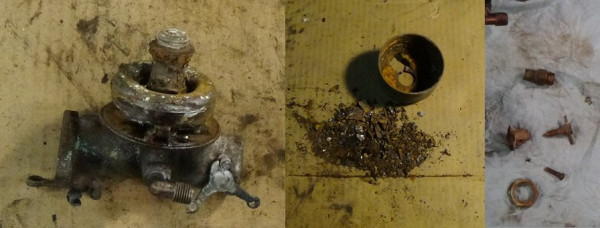

Never saw evidence of a vaporizer. It came with this Kingston L4. I thought the tag on the back side said "NH" so I purchased a replacement Holly NH and replaced the parts in it some years ago. Yes, the air/fuel needle on top. OK will open to 1-1/8 to 1-1/2 turns instead.

A plug gap of .026 to .032 is fine. A smaller gap may give easier starting with a weak magneto. Your plugs show that the engine is running WAY TOO RICH and the plugs are heavily soot-fouled. Clean the plugs thoroughly and set the gaps to .028. Make sure the float level in the carburetor is correct, then seat the adjustment needle gently, and then open it one full turn. Start the engine, set the throttle for about 600 RPM and advance the timing about halfway. Drive away. After a two to 3 minutes, adjust the carburetor about 1/8 to 1/4 turn leaner. Advance the timing as the situation demands. Under most conditions, you should be able to shift to high at 6 to 8 MPH, and stay in high from then on unless you have to stop. The car will not lurch or buck when shifted to high if it is running as it should and the shift is handled as it should be.
