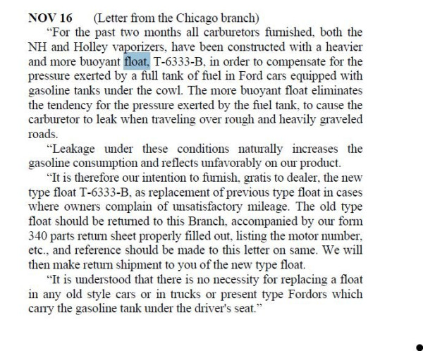

Posts: 6583
Re: Factory *spark gap* Low vs. High head
Post by Scott_Conger » Sun Sep 28, 2025 11:11 am
the larger float came about to solve rich running on rough roads. I think our driving environments are such that the smaller float suffices fine in most circumstances. Most people don't know/care/need the thicker float, but when it is needed, it is needed. I suspect that the Oregon folks who do a lot of off-roading in "T"s either have, or could use the extra large float, for instance.
Additionally, the improperly designed float valves sold by most vendors have such a tiny through-hole that this naturally reduces the effective head pressure gained by cowl mounted tanks and thereby naturally reduces the need for the extra buoyancy the larger float gives. This is primarily why most folks with Improved Fords don't see a need for the thicker floats...they are already suffering from restricted fuel flow in the first place.
Edit: attachment added -

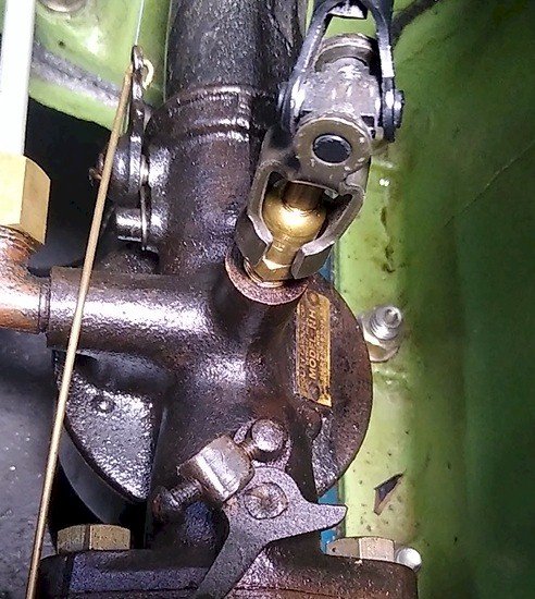

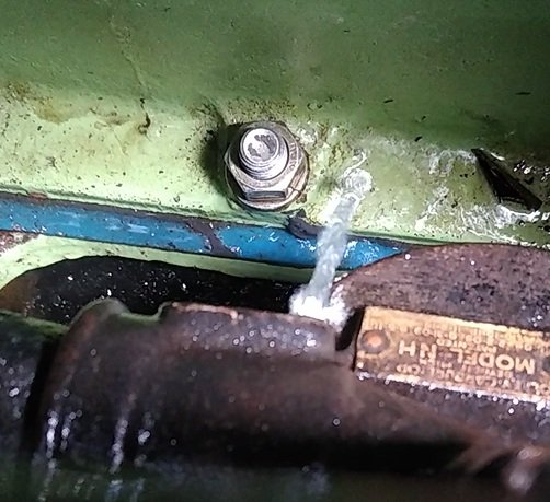

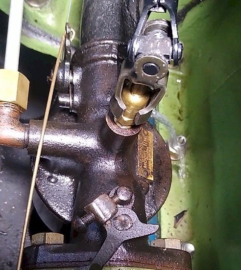

Post by varmint » Sun Sep 28, 2025 10:09 pm
Before I take anything apart, I allowed the carburetor to dry and then ran two short videos while I opened the sediment valve. Here is before and after photos:

Posts: 5294
Post by RajoRacer » Sun Sep 28, 2025 11:50 pm
Thanks Scott - that is informational !
Posts: 6583
Post by Scott_Conger » Mon Sep 29, 2025 9:31 am
Steve
you're welcome.
I try to be careful to limit my advice to things that I have actually done/experienced, or are linked to historical documentation
Speculation is a area covered by plenty of others ;)

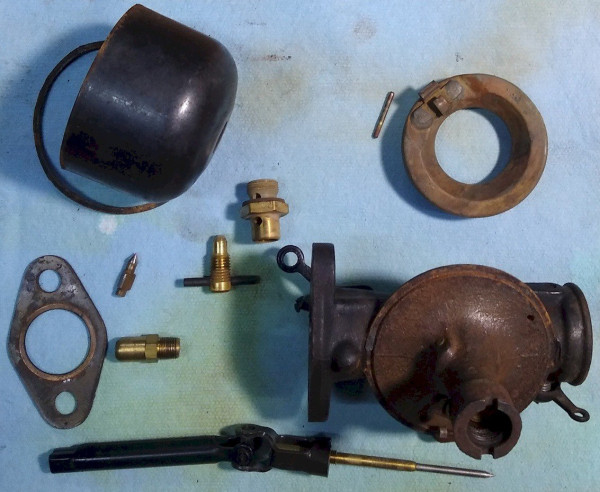

What I found tonight:
Cleaned out the sediment bowl - found a little debris.
Cleaned out the carb bowl - found a little debris.
Does not have the larger T-6333-B.
Float needle seems to be almost buried above the surface.
Tang on float was not making contact with needle anymore.
Vern (Vieux Carre)

Post by varmint » Tue Sep 30, 2025 10:24 am
In case someone missed it, the carburetor has a "NH" tag on it yet there is what appears to be a "G" steel needle. I checked my email receipts from years ago and packing lists. All I see if stuff purchased for "NH" but I don't even see that part number listed in my records anywhere. So, I think it must have come with the Holly, and that is why it was sold to begin with. Maybe I'm wrong, that this is the correct part but I certainly knew next to nothing back then. Anyway, I ordered the 6210 and 6212 this morning, and gaskets.
