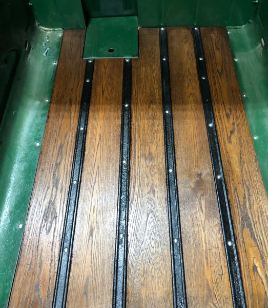

I have a 26 pickup and can't figure out why the crossmember cover plate is proud of the bed boards. The crossmember is up against the cover now so you can't move the cover lower. Are the body blocks incorrect?

That 'hump plate' should be mounted with the flanges under the bed wood. Suppose the wood blocks are misplaced, can't seem to see in the photos.

unfortunately, I can't mount it with the flanges under the bed wood. The crossmember is already up against the hump plate. bocks? Do you mean blocks?
What blocks are you referring to?

Everything looks right but it does not add up... I am starting to think your floor boards are too thick, that would bring the cover plate lower and therefore closer to the frame. Please measure the thickness of the floorboards and report back.

My thoughts also, something doesn't seem to add up. I thought about the board thickness but everything else lines up. (see the pics). The boards measure 3/4".

Just another observation from your photo. The crosssmember on your pickup is the earlier version without the flanges for reinforcement. But both have the same curve.
Believe you have enough space under the crossmember and the bed to place the hump place flush with the bed wood.
There is only a little space anyway between the hump plate and the top of the crossmember.
That is why Ford used the hump plate, otherwise the bed boards would ride on the very top of the radius of the crossmember, making fit difficult.
Could just be the former owner didn't know the flanges of the hump plate mount to the underside of the bed boards.
Nope that's the issue I have.
DanTreace wrote:
Sun Sep 28, 2025 9:59 am
No room. Maybe I need new body blocks but the few I have seen in person sit the same as mine. Things don't add up, but I'm sure we'll get to the bottom of it.

Well looked again and see now the bed wood isn't like stock install. Yours has 6 metal bed strips or cleats. The factory is 4. The curved metal bed sides hold the edges of the outer boards. These use carriage bolts thru the curved bed sides.
So that may be the problem.
Here is the factory install of the bed boards and using only 4 bed strips. 2 short and 2 long.
