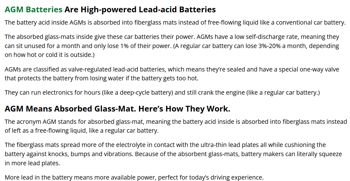

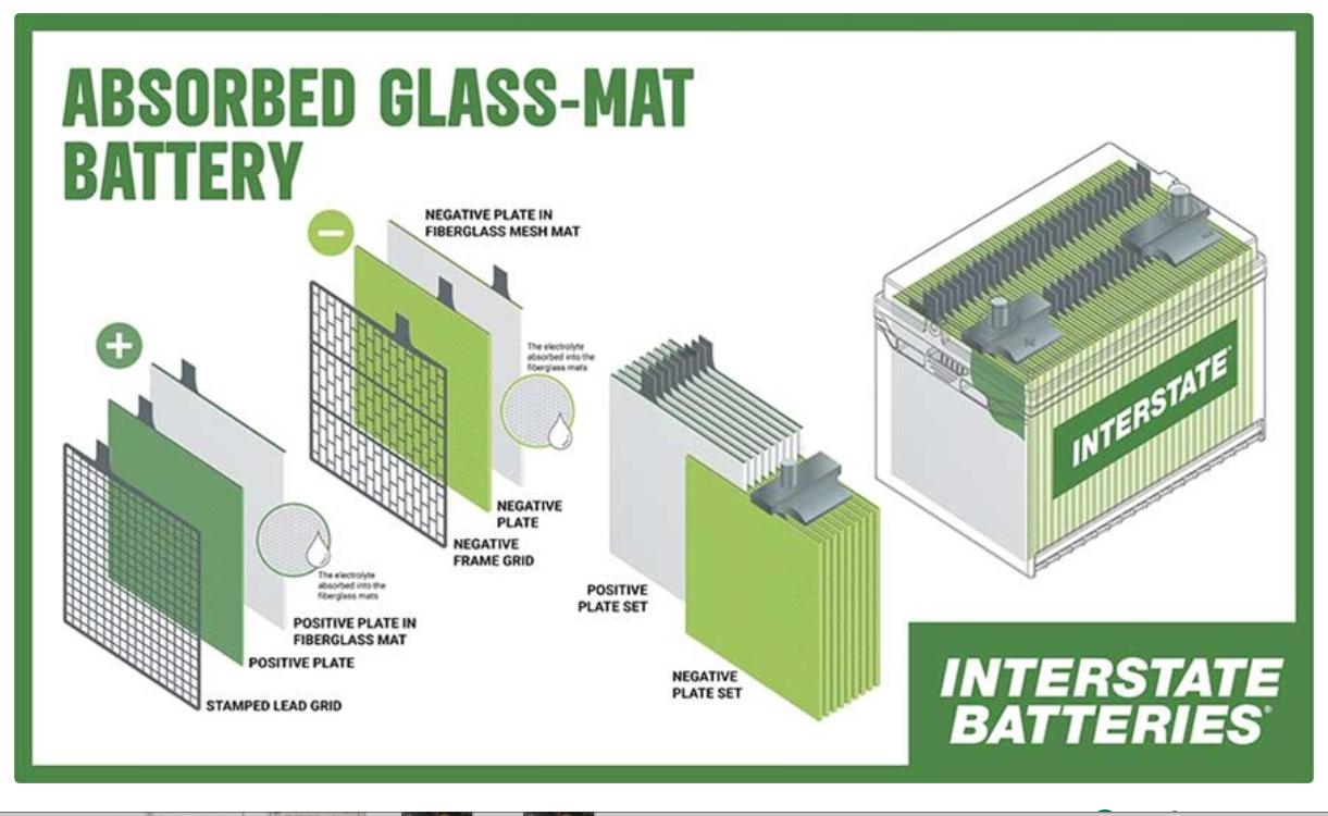

What is a AGM battery?
Mark Nunn
Posts: 1288
Last Name: Nunn
Location: Bennington, NE
Re: Battery
Post by Mark Nunn » Fri Oct 03, 2025 4:27 pm
Original Smith wrote:
Fri Oct 03, 2025 1:30 pm
Absorbed Glass Mat.
Posts: 6553
Re: Battery
Post by TRDxB2 » Fri Oct 03, 2025 7:03 pm
https://www.interstatebatteries.com/blo ... gm-battery
