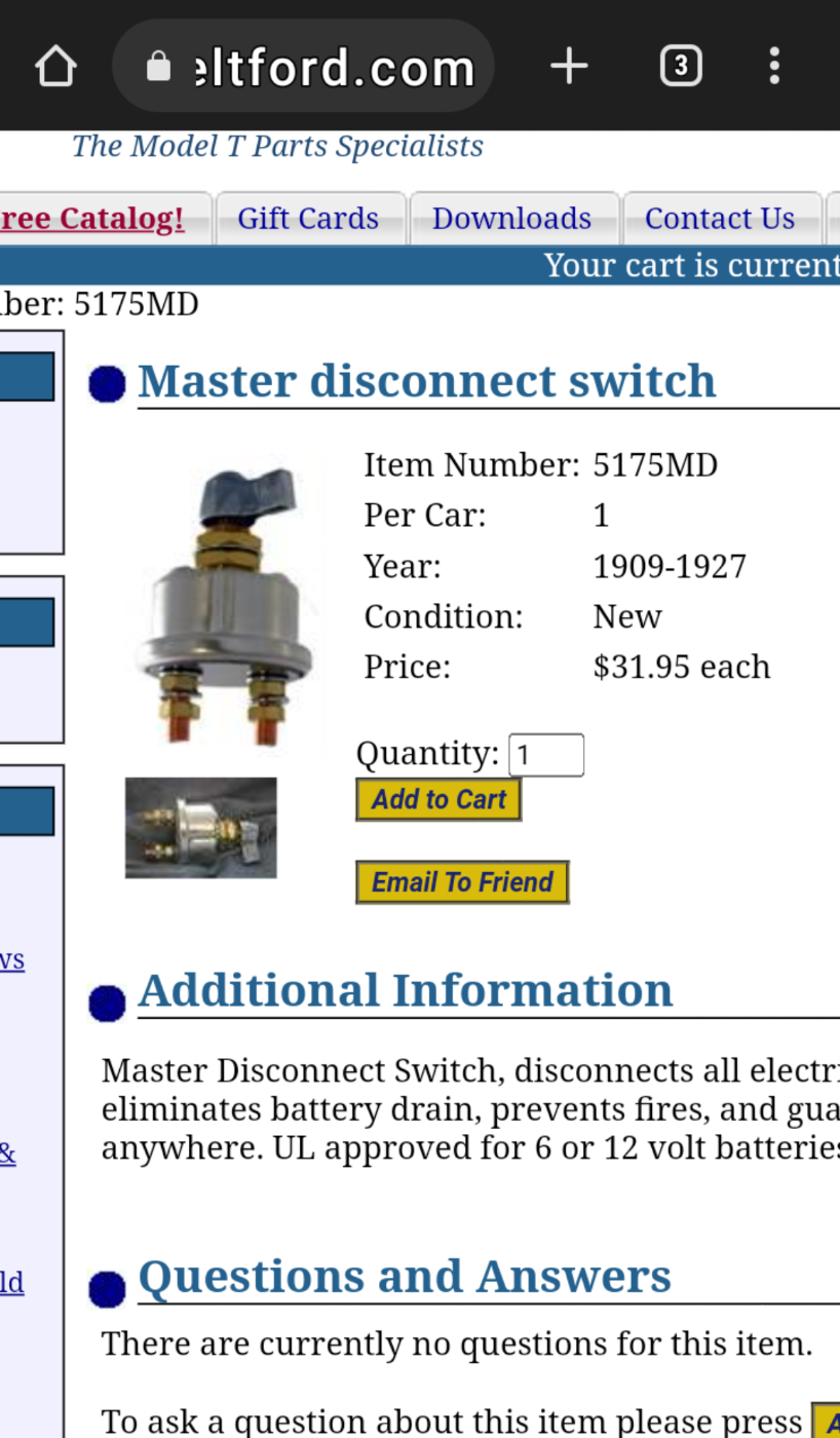

Are currently available battery cutoff switches really good enough to carry the high amp loads of a 6V system?
What size are the terminal studs? 3/8"?
A fellow member has burned out/melted a few. Are there cheap/lite weight units to avoid?
Are there preferred styles? Is the Langs unit adequate & reliable?

John, I can vouch for the Harbor Freight switches. I've used mine on 6volt systems for a couple of years now and have had NO problems with either one.
I am unable to find an amperage spec. on the Harbor Freight unit, but similar units are rated at 300 amps.

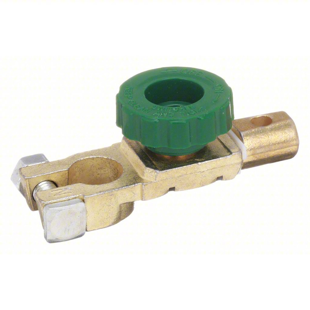

NOTE TO ALL: DO NOT BUY OR USE THE BATTERY POST TYPE SWITCHES. I have extensive experience with both types. They both break or corrode and become useless quickly. NOT WORTH THE MONEY.

I've had this switch in my car for 3 years. Hearty and reliable. Hasn't let me down.Just get crafty as to where you want to hide it.[/size]

My '27 Runabout came with a battery post cutoff switch, that was probably installed in the '90s. I've had the car 5 years and the switch is still perfectly functional and is not broken or corroded. Getting to the knob through the battery access panel at the front of the trunk is fairly inconvenient, but there is nothing inherently bad in the design or construction of the switch itself. Your milage may vary. ;)

use this and hope it doesn't back off or vibrate loose while engine is running.... no ground makes your generator produce "The magic smoke...." use the one i posted from LANG'S and put it within reach of the driver, so you can shut power down quickly and safely without having to pull over, get out, and access the battery....
Use this one!

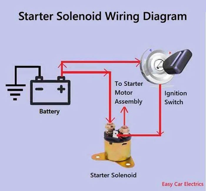

Post by Steve Jelf » Fri Oct 03, 2025 6:50 pm
Obviously, some like it and some don't. I'll leave it to the rest of you to sort out the pros and cons. If you decide in favor, here's some guidance.

This depicts what I use. But I use the switch to cut all power to the battery. The battery remains grounded whether switch on or off.
