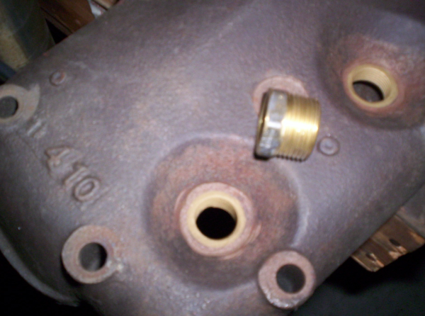

Kerry
- Posts: 1462
- Last Name: van Ekeren
Re: Helicoil or just swap out head?
Not a hard repair, done several over the years.
- Posts: 1206
- First Name: Adrian
- Last Name: Whiteman
Neat job on the inserts - nice.
It is a cost benefit decision. Anything can be done, how much do you want to spend?
Having another head right there to use suggests go with the swap out.
- Posts: 5170
Very clean fix.
If you have the capability, thats a great way to replace the threads.
