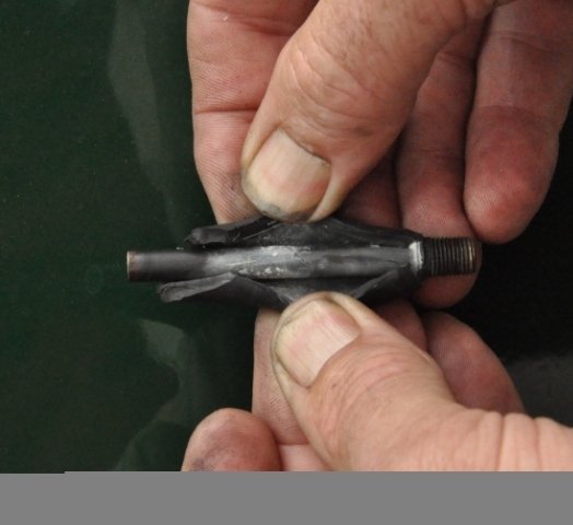

This is a common problem the tube valve stems are rubbish, the stems are not capable of dealing with the 60psi pressure .
Here is a photo of one cut open to show what the problem is.
Note there is no contact with the rubber except at the very end where the rubber is vulcanised to the metal stem by only about a millimeter of rubber. The white stuff is powder, it can go right up to the end of the metal stem.

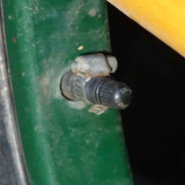

On the road use a piece of wire, wrap it around the stem and twist it which will squeese the rubber tightly stopping the leak. Or use a small screw clamp for rubber hose to clamp the rubber.
When at home, get the correct metal valve stems and install them.
I had this problem when driving to Richmond for the 2008 centenial, I has soft wire in the tool box which I used until I went to an auto store and purchased the screw clamps. I still have one tire with the hose clamp on the valve stem now. So 14 years and the valve stem is still not leaking.
