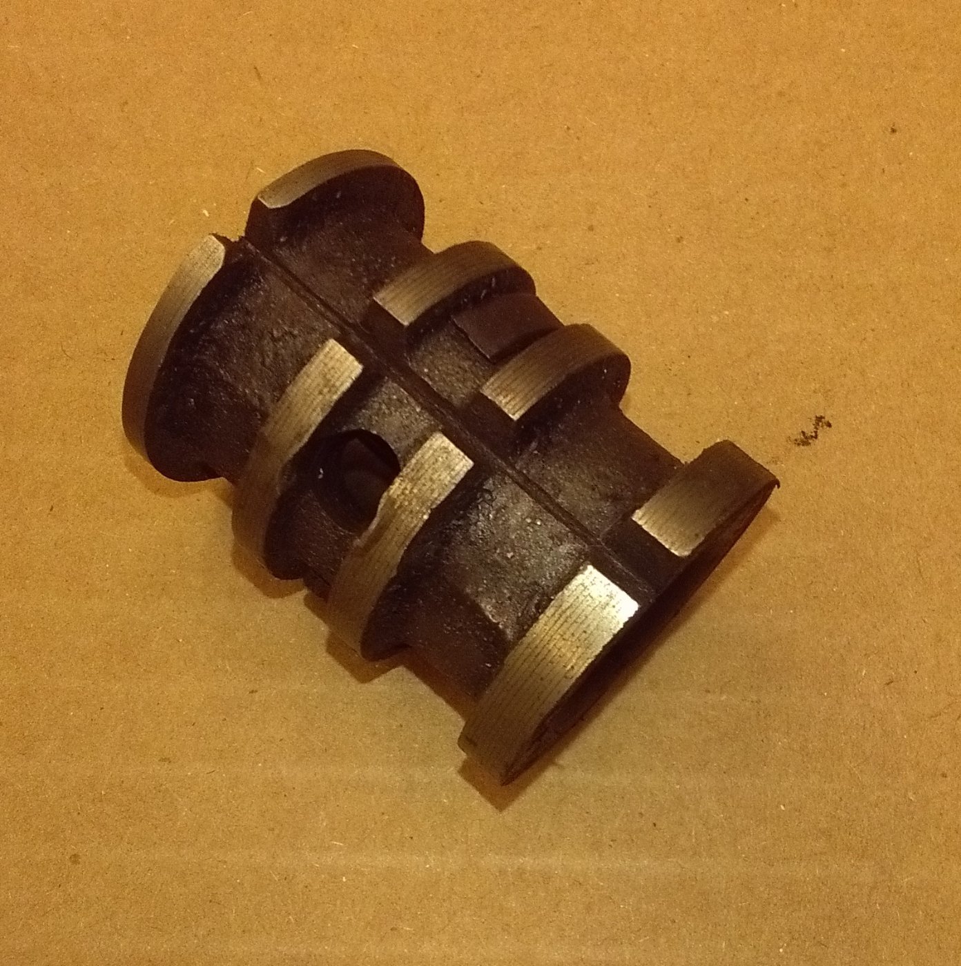

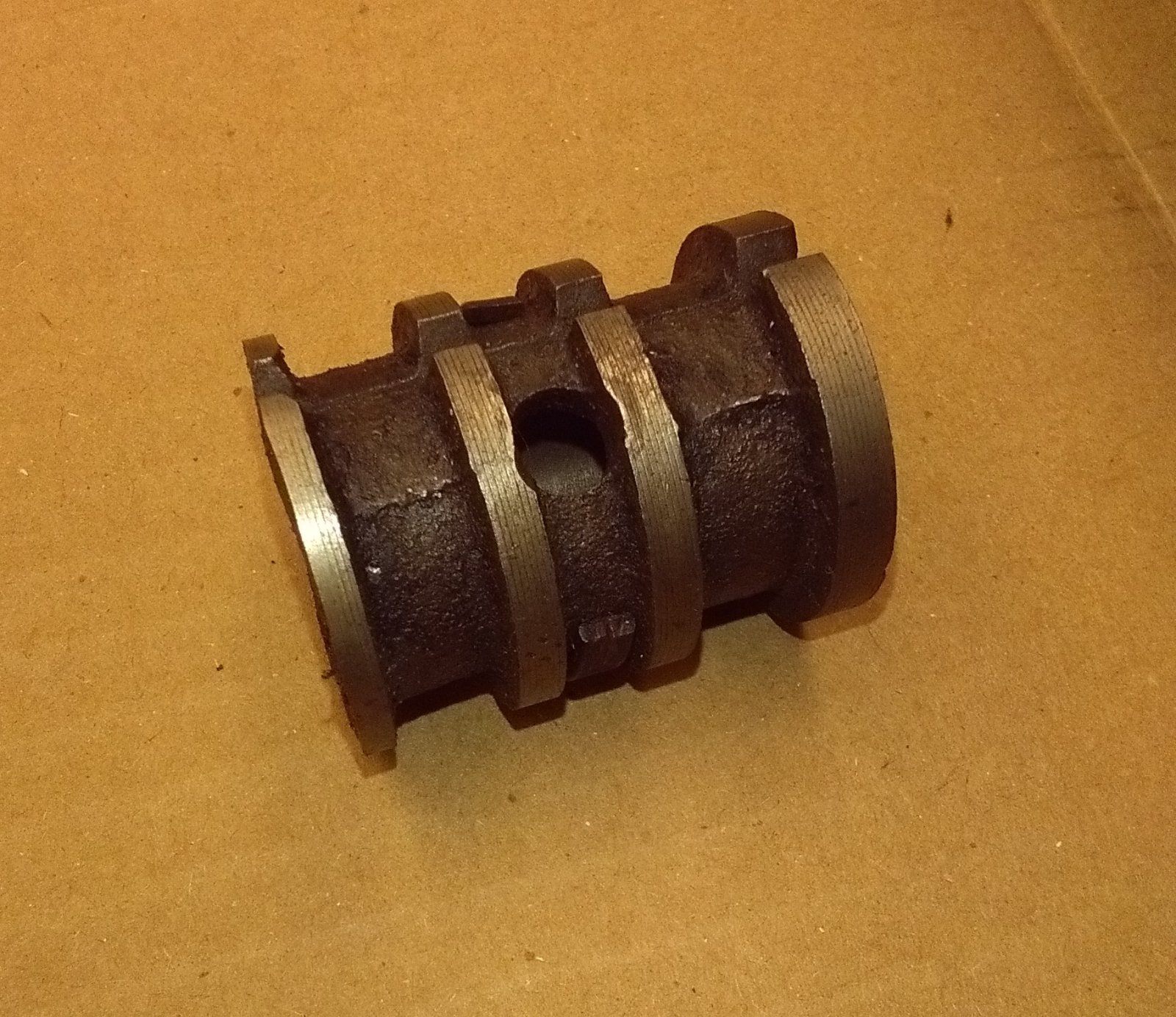

I will try to dig out an example of the style that John refers to above. On Edit- here are a few pictures of the true early cam bearing. This bearing has had the rear side ground off at some point (on the left in the pictures) so it appears shorter with the notch removed. This is the only example I had. The clip was still used in the center groove to hold the shells together.

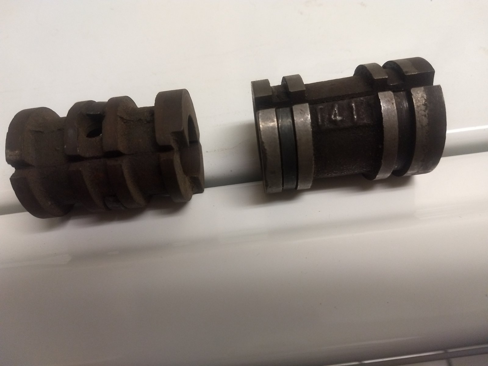

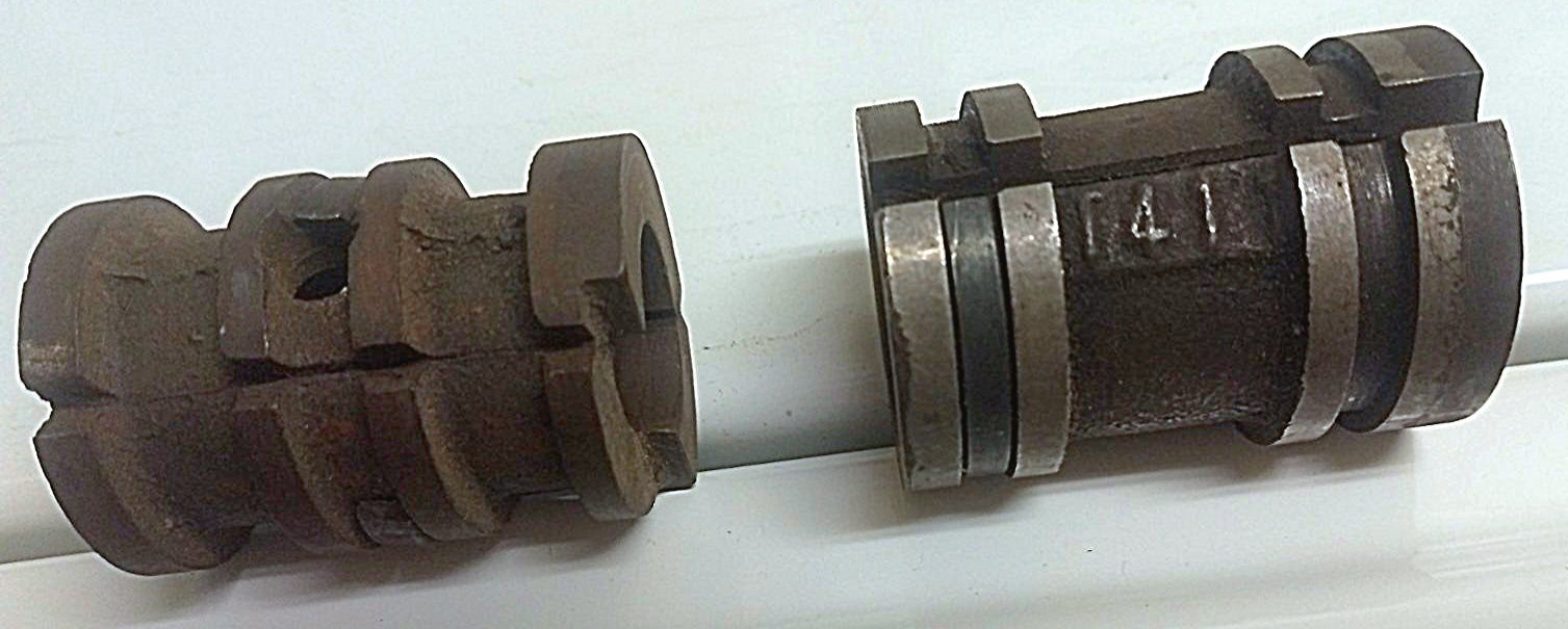

I found 2 early cam bearings. The one on the left is like Dans. (not as clean)
The one on the right, I suspect is earlier.
You can see the part # in raised cast. T41 or T411.
Note there is 2 ring groves. One on each end. Only one ring installed.
Maybe some of the guys that work/have worked on early motors can tell us the correct years they were used.
RVA23T

Felt like the pic needed some help

Re: 1909 Camshaft Bearings...
Eric, you're correct, I'm drawing the 1909 Short Block for the Water Pump engine. After I make the Short Block, I'll draw the complete Engine Assembly, with the Transmission and the Water Pump assemblies. I'm doing this in a 2 page format mainly because there is just too much going on and into the engine, to be able to show it with any degree of detail on just one page (which is why it's got to be either two "A" size 8 1/2 x 11 or one "B" size 11 x 17 fold out...not sure which I'm going to do yet, still pondering it some...I hate fold-outs). I decided to start with the earliest Model T engine and work my way through to the later models.
Now those two bearings, are they both fronts or is one of them a middle? If it's not a middle bearing, would the middle bearing be like these but just a bit longer with those thin ribs and not like the later one which are a bit thicker. Also would they have two clips or just one like on later models?....I think what I'm going to do is draw both of those, put them in the drawing and let you guys tell me which one is correct, because I really don't know and I'd hate to go with my best guess, so I'll defer to you folks who may have either seen, worked on or have one of these cars or engines.
As for the PDF, problem with that is it's a copy of a copy of a copy (no detail, can't see anything but mud, but I do know about the notch, which I think is on the cam lobe side. The notch is for gathering oil to lubricate the bearing on the shaft, there's another on the rear bushing that does the same thing). If they wanted you to be able to copy it they would've printed off at 60 to 85 line screen, not 125 or 150 LS which is why they use higher LS, because it forces one to buy another copy of or loan out your copy of the book, most folks in the "Technical Information and Manuals" biz, want to sell their works not give it away for free. And I'm no different either, I give my work away for free true, but those are Vendor Part Numbers. but I'm intending to sell a book that covers the complete chassis from 1909-1927 for the cars and 1918-1927 for the truck. The difference will be that the book will not only have the Vendor Part Numbers like my drawings have now, but also the Ford Factory Numbers with Change Dates as well. So if you want to pay a visit to the Ford Archives, you can research every bloody part of the Model T car or truck there. Because the Librarians there, file the drawings by Ford Factory Numbers, not the Vendor Part Numbers.

Martynn- the one I posted the picture of was a front bearing. The non-modified end has a large radius on the bore on one end as do the later front bearings. This radius was necessary to allow clearance for the radius on the front cam journal adjacent to the flange. Too bad the one I have has been modified on the rear side......
