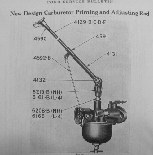

Re: Could use your help - '27 coupe w/ Holley NH

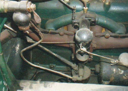

Here is how it is done for the NH according to the Ford Service Manual.

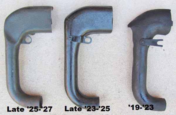

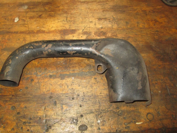

Ford supplied a "special" hot air pipe with indentation for the swivel top carburetors so as to not have that interference issue.

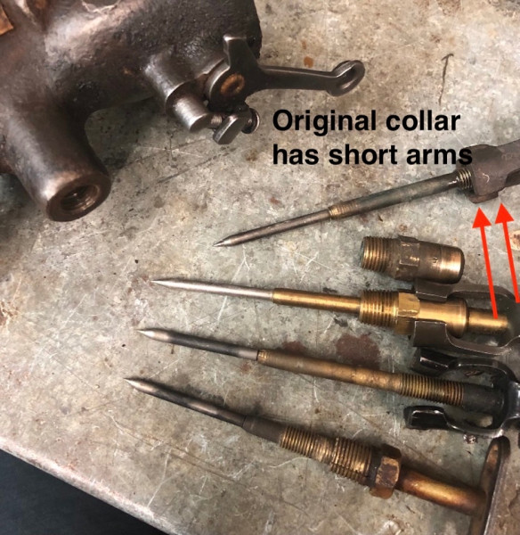

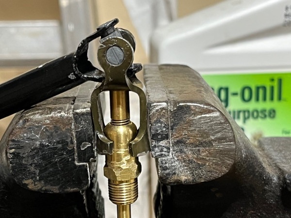

For the repro needle valve, that replacement has longer arms or fingers than the originals (provides the tension on the round barrel to keep the needle valve in correct spot) can interfere with the hex portion and prevent full seating of the needle.
My fix is to cutaway a portion of those arms (neat job no, but results are right
)...... just another thing with repro parts. Cut back the arms improves function, be sure to crimp the arms just a bit to get the proper tension to prevent drift.

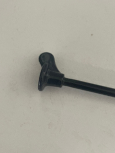

Obviously, the previous owner put this in without using the correct part. Two issues, the knob at the top is not removable to allow me to cut the rod and replace the knob so I am ordering one from the parts suppliers that now love me! Photo is attached. The rod is 28 7/8 inch long.
I found a Model A repair manual in the car after we got it, so obviously this part might have been for a Model A.
The second issue is that the first hole in the rod is 4 3/8 inch from the tip which puts the gizmo that the choke connection attaches to which puts it in the center of the manifold. I need to either replace the whole thing with a new rod or drill new holes, cut to the right length and put a new knob on the top.
PS - the square portion of the rod is only 1 7/8-inch long.

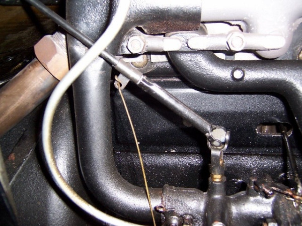

Vaporizer rod shown in this photo, choke arm higher.
NH rod with choke arm lower on the rod. Rod shown is the vendor version, sometimes needs a bit of tweaking to the square shaft to slide easily in the square tubing. Filing a little. The goal is a nice fit, but keep from rattling too, the square end long enough to slide up for full choke movement, but not too far that the end of the rod pulls out of the square tubing.
