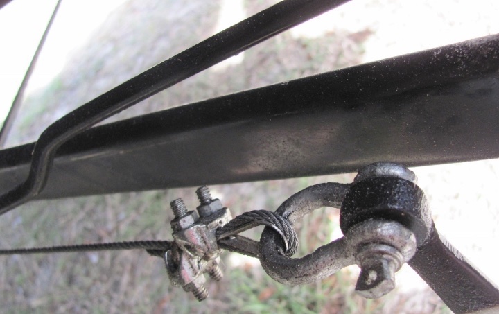

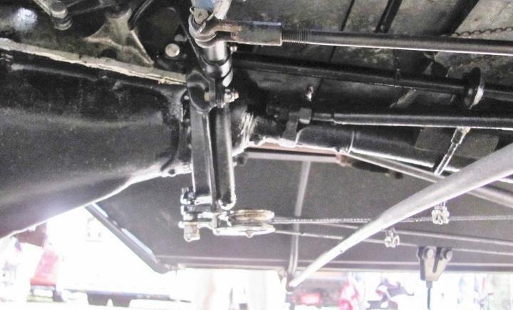

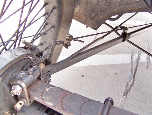

Some photos of other's installs.
100_9403 (500x379).jpg (118.33 KiB) Viewed 511 times
