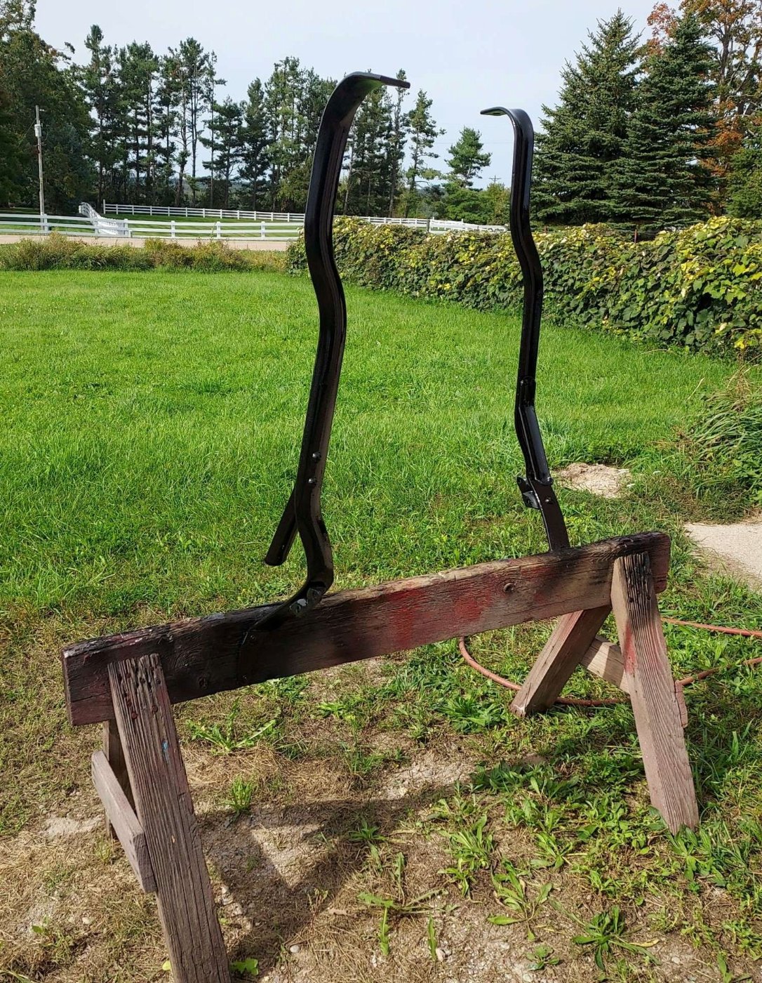

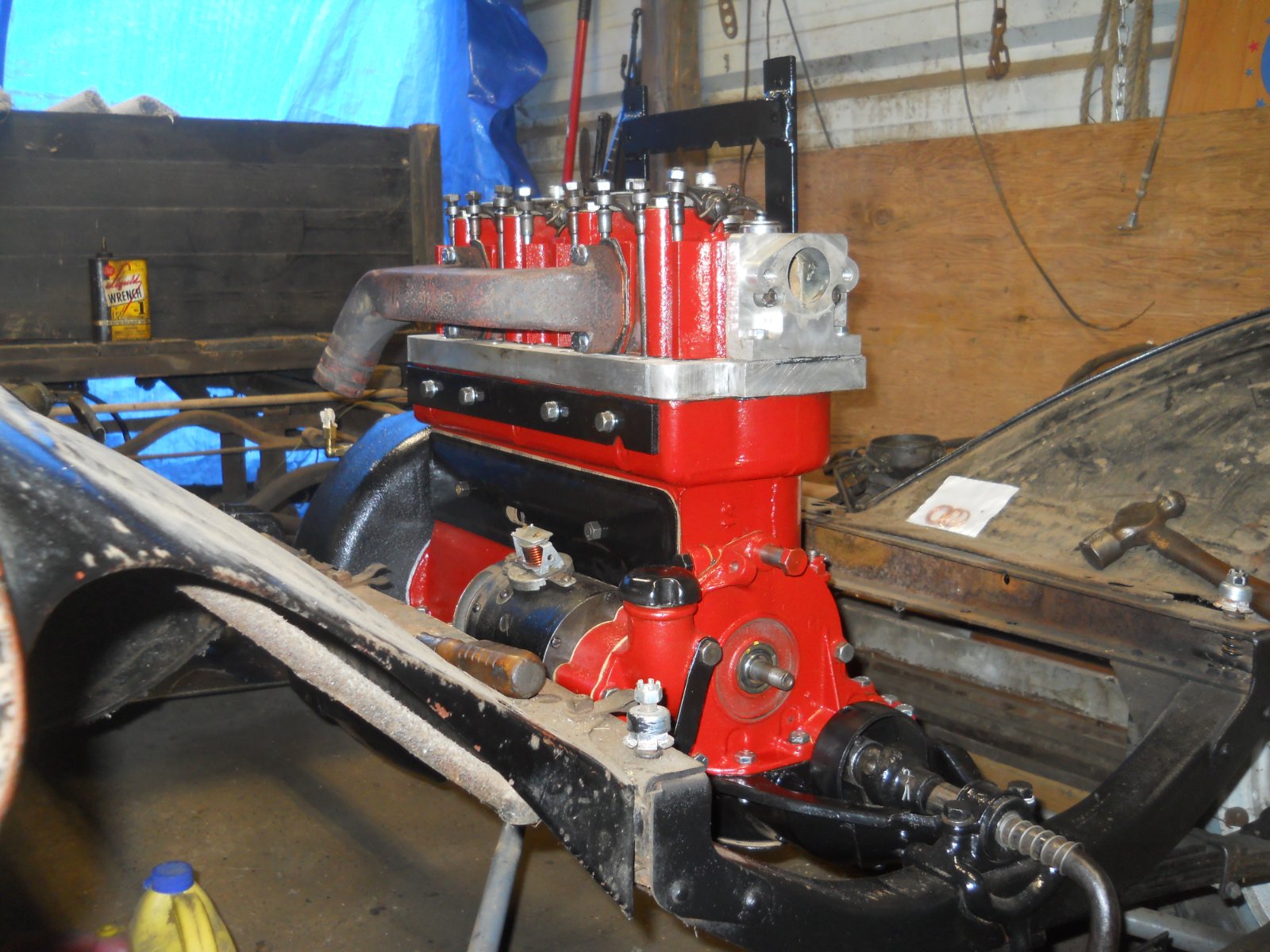

Took advantage of the summer like weather here in northern Michigan to sandblast and paint 26-27 Ford accessory rear bumper brackets.

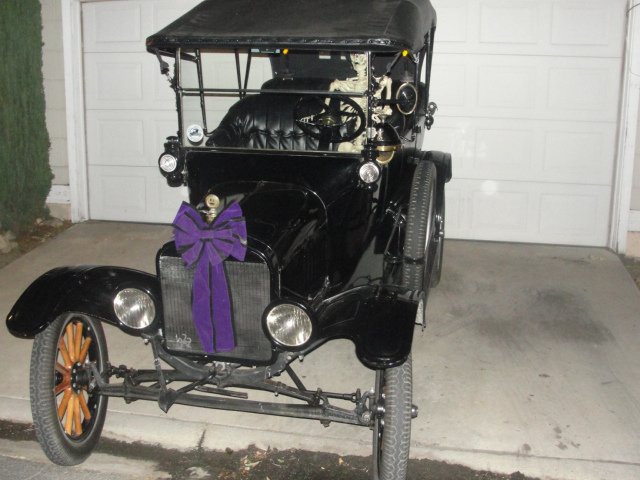

I finished rebuilding my rear axle, now to stuff it back under the car before Hallows
Kids (and some grownups too) like to sit inside with "Mr. Boneypants" and let either their parents or friends take their picture.
Fun never quits!

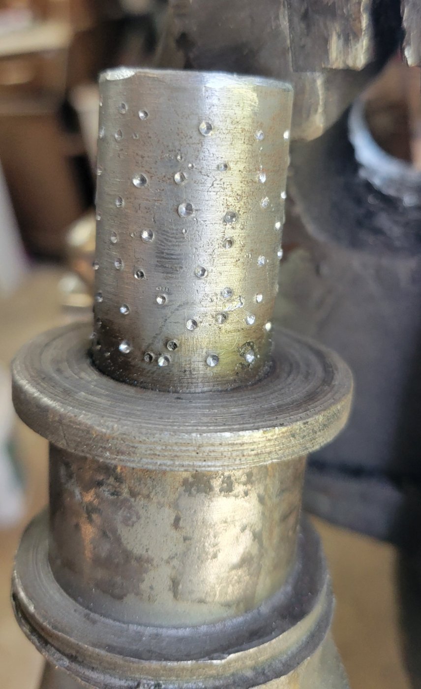

I had replaced the starting crank bushing on my 1915 a few years ago, but it creeps forward and has to be tapped back into place.
I pulled it most of the way out and added a Dutch knurl to it. I'll mix up a little JB weld to the outside of the bushing before pulling it back in.
Keith

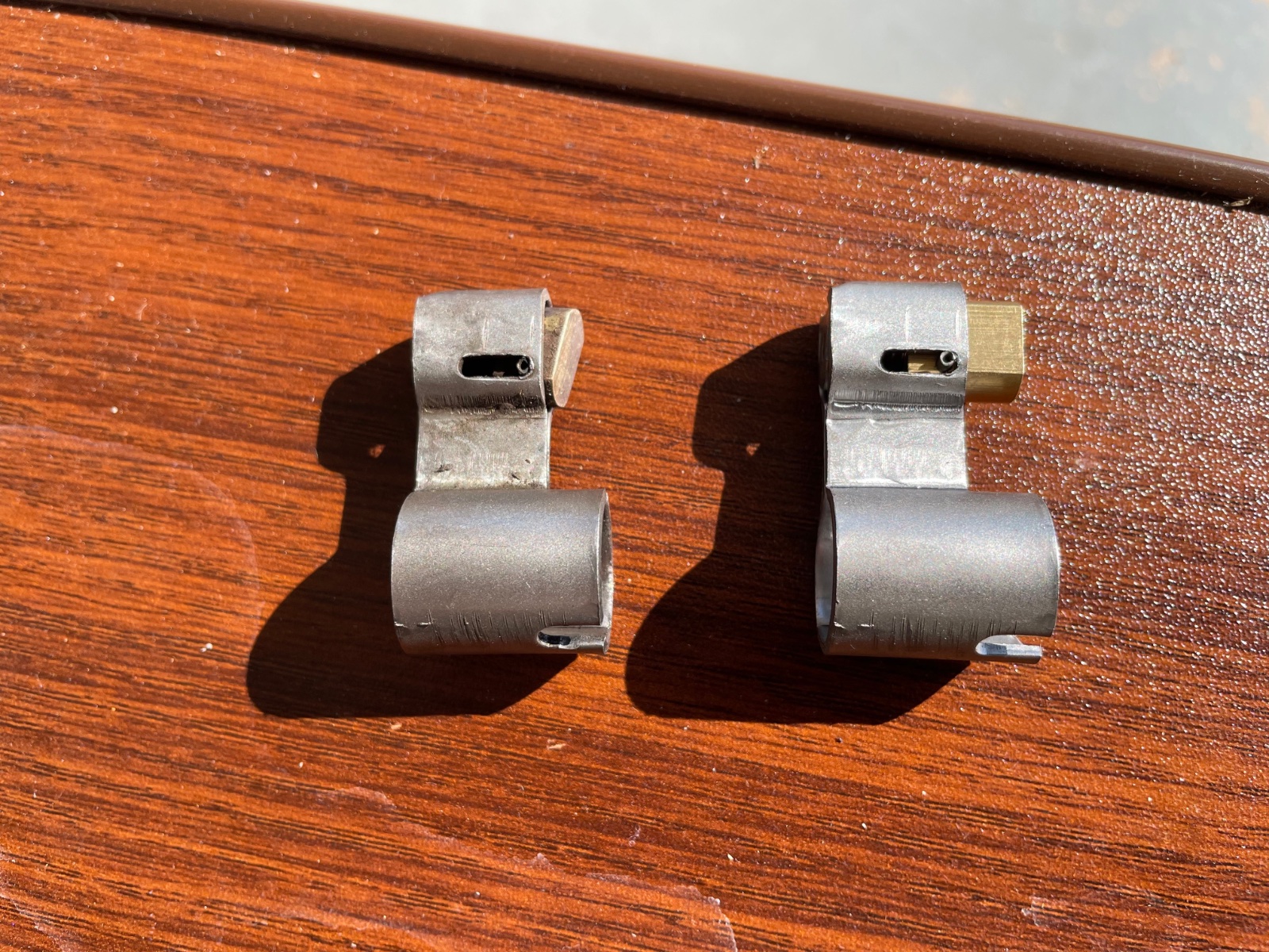

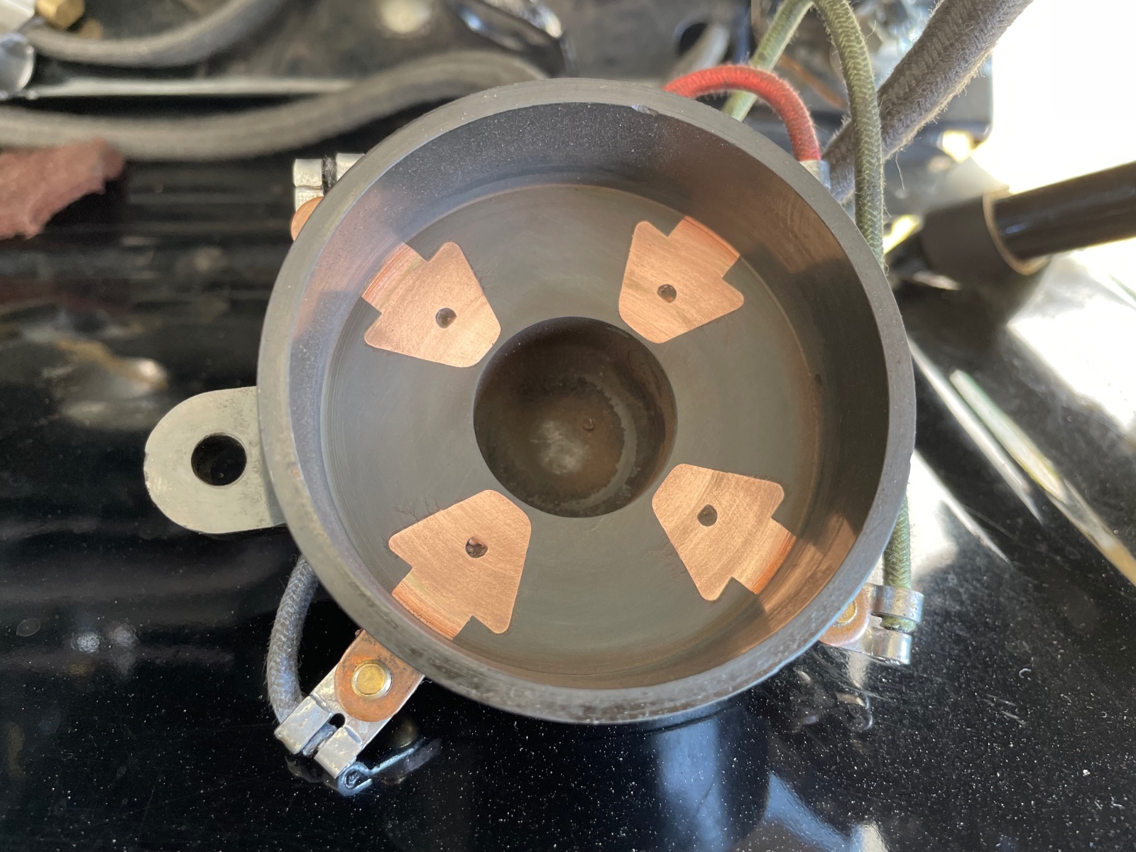

Re-adjusted the shape of the carb throttle rod (pull rod) to get full quadrant and carb throttle range. Wasn't getting the carb throttle more than 3/4 of WOT before and was completely closed with about 5°left on the quadrant. I am sure it will be picking up at least 1/2 HP from the adjustment...I better hold on!
Sorry all it has a dizzy.....for now. Checked the condition of the cap, rotor and points, re-adjusted the points to 0.017". I do have the original timer setup and seven coils in questionable condition. So am considering converting it back once I have gone through all the running gear to make it a good driver.
This winters plan is all about running gear, (replaced the front wheel bearings already and checked wear on front end parts). My plan is to go through (rebuild) the rear axle, drive shaft and add Rocky Mountain brakes. Basically make it safe, reliable and drivable so I can drive it more, just as my Grandfather would want me too.
Cheers from NH.
Cheers from NH.

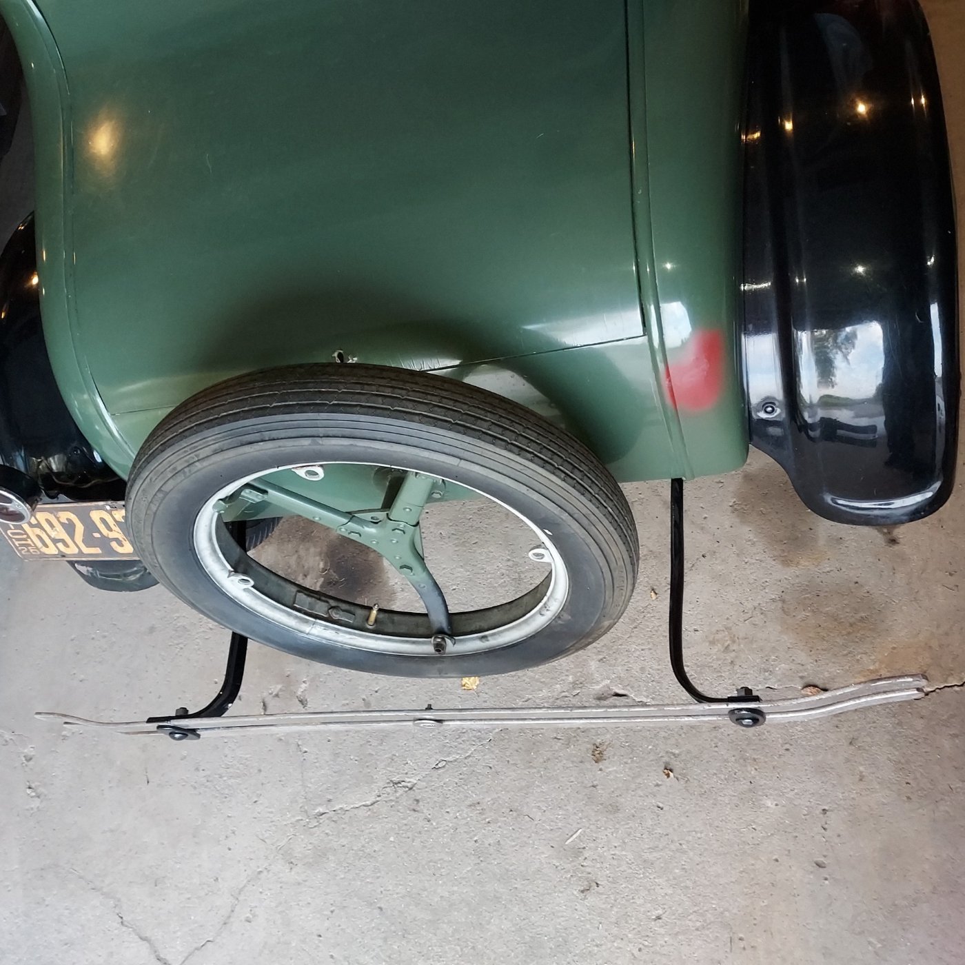

Installed the rear bumpers on my 26 coupe. The Ford bumpers are a real quality product, the bumper bracket holes lined right up with the preexisting holes in the frame. I thought the bumpers sticking so far out would block access to the trunk but there is plenty of room to stand between the bumpers and the body. It is a well thought out design. If I ever do it again though I will be sure to clean the soot off the right rear axle first.

Humbled, l love that color green on your coupe. If you don’t mind could you tell me what color or formula it is in case l ever get around to painting my 26 coupe. Thanks Tim

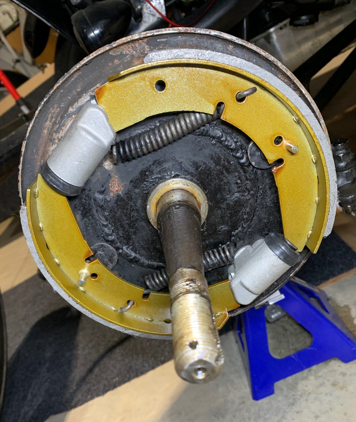

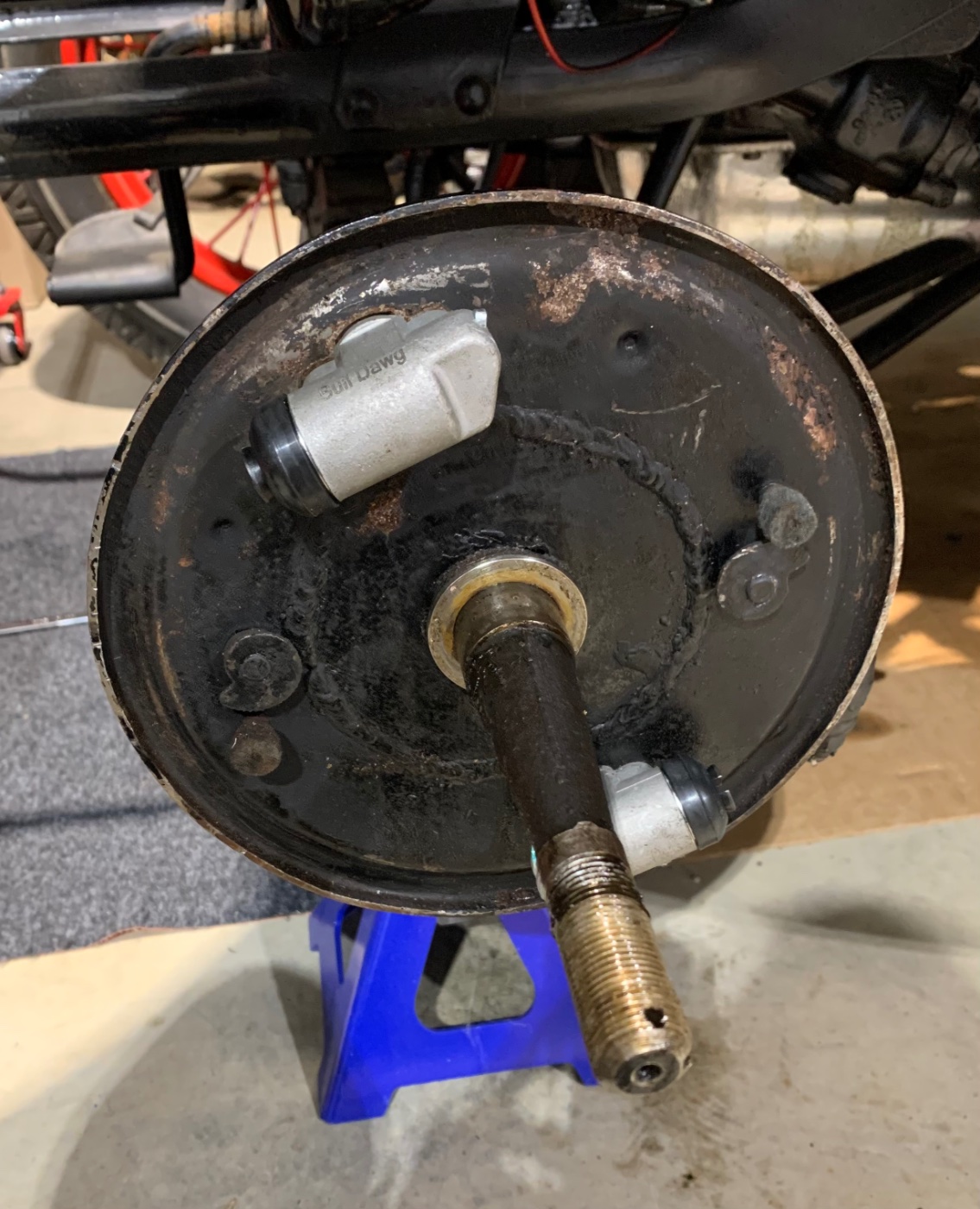

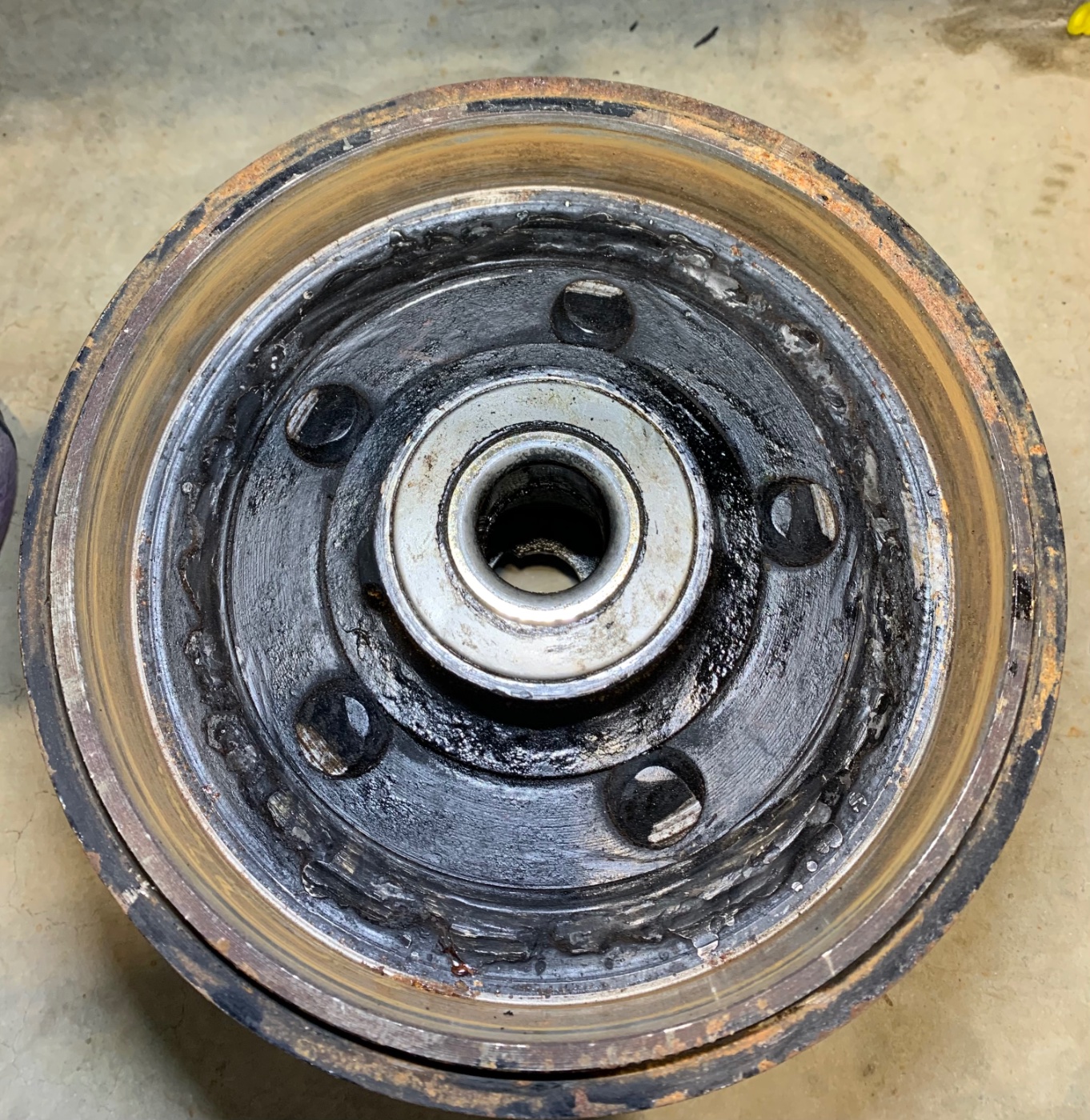

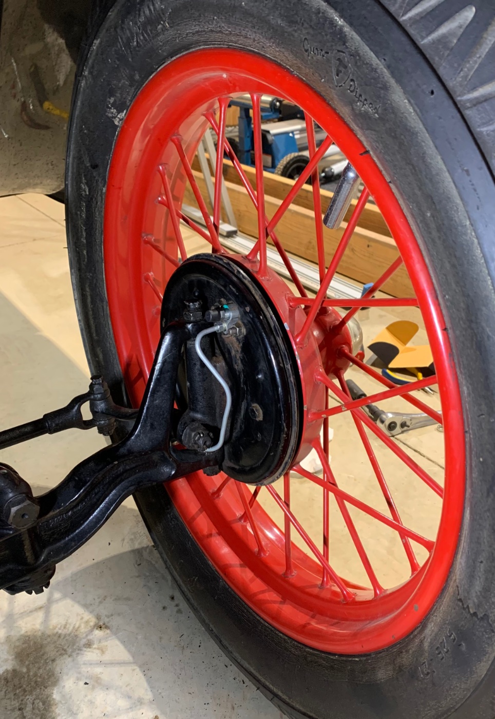

Finally starting the restoration of the “aftermarket” brake system on my ‘27 runabout.
the front brakes aren’t very visible.
“early” metropolitan nash backing plate welded to the spindle.
matching 8” metropolitan nash drum welded to the wire wheel T hub.
new brake shoes and wheel cylinders.
wheel back on with new steel jumper line connecting the wheel cylinders.
more pics to come as I work my way back through the system to the 11” GM rear brakes (early ‘60s).
Keep crankin’
Eric
Keep crankin’
Eric

Tim,
I painted my coupe Kewanee Green IM-519. It is a Model A Ford color. It is what Les Henry listed as the correct color in the 1965 "Model T Ford Restoration Handbook" for "Channel Green".

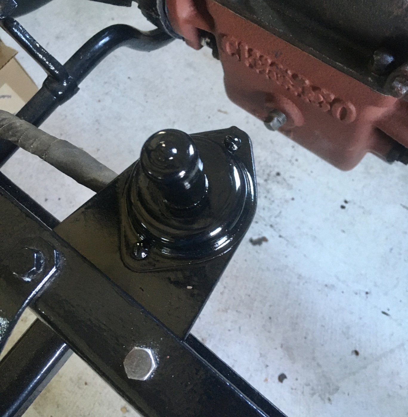

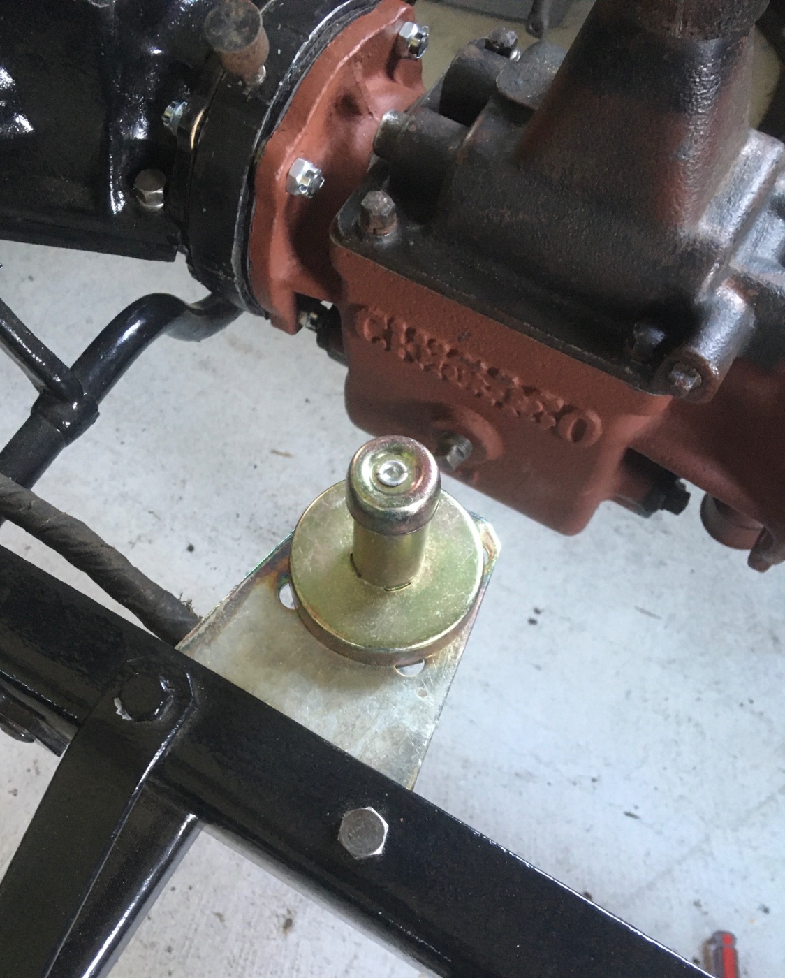

Installed battery cut off switch, installed solenoid on starter circuit,and reworked starter cables and installed dual ground cables.
Starter still turns slow so next starter comes off. With the floorboards out the bbendix will be a lot easier to get at. Next I will take it apart and check it over and look for one of the starters I have stored and have not seen in several years. It is always so handy to have parts stored here,there and everywhere but at least I Have some parts.

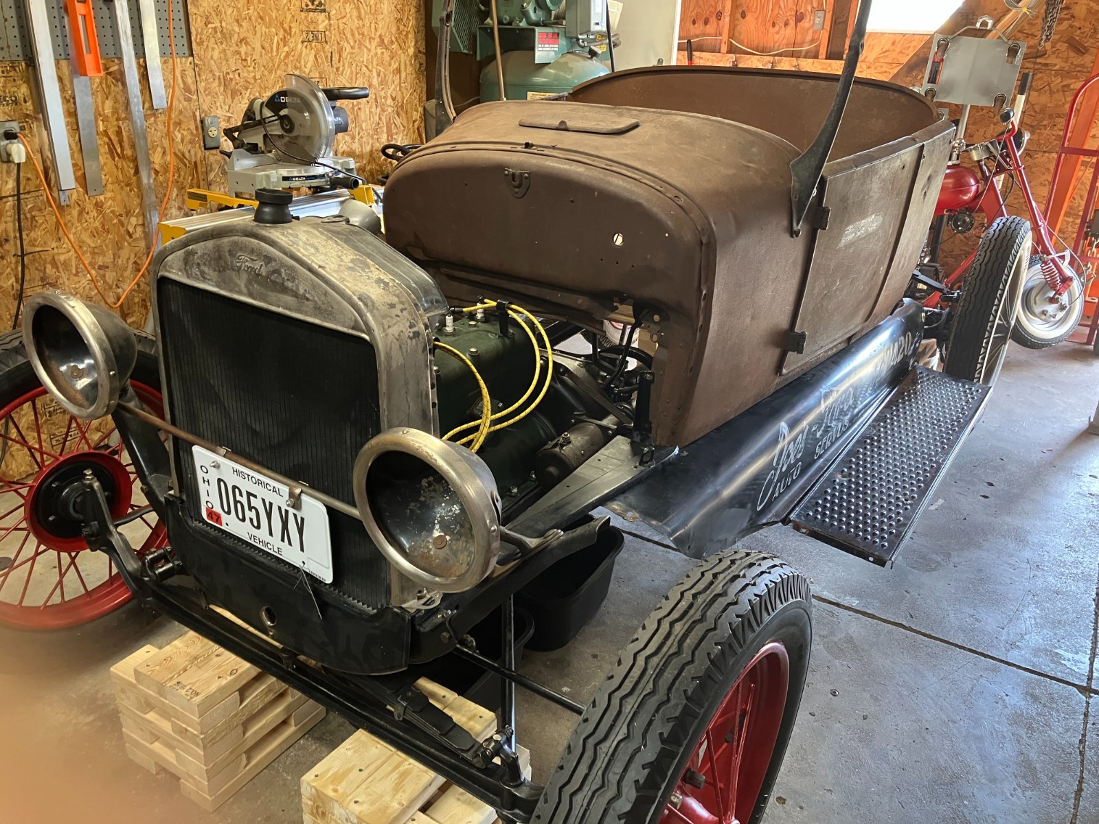

Bit the bullet and converted the Roadster to 12V:
step 1- Replaced the bulbs with 12V
step 2- Installed modified starter for 12V
step 3- Made my own diode cutout *yes very basic diode only to mimic the original cutout.
step 4- swapped in a 12V battery
Done.
Starter cranks with much more energy and coils buzz brightly!
That was easy!
