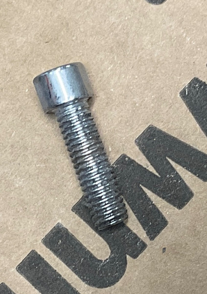

They are fussy, eh? I got tired of continued fail at epoxy floor paint so went with Race-Trac wall to wall open grid...it loves to find small items and they disappear quickly! My trick? Take an old microwave apart and removed the magnet...those are naturally so strong that its like a Laurel & Hardy movie when you put it to work and it wants to jump to your bench vice as you walk by!
Sounds as though you have it thought out. That said...maybe look up old threads. The late Ralph Ricks swore by using (I think) a metric M6 socket head cap screw for his bendix covers and then a long Allen key. He claimed the TPI was close enough that it made up fine...never tried it myself....

The last time I had the hogs head off I re-tapped mine to 1/4-20 and use allen head screws.

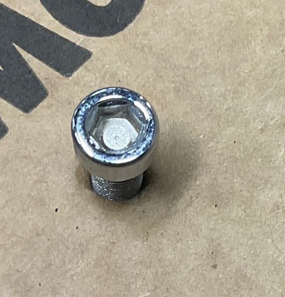

Copied Ralphs suggestion back when it came up, it worked fine. Allen wrench holds the screws and makes it easy to snake them in.
Several months ago I was going to get another set and decided to get some for friends as well. I got 50 of the metric screws and 12 long allen wrenchs from Amazon for about $20. Kept a couple sets for myself and passed the rest out to friends.
