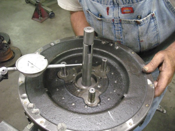

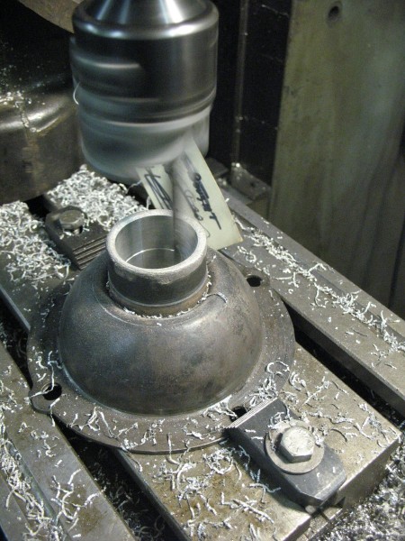

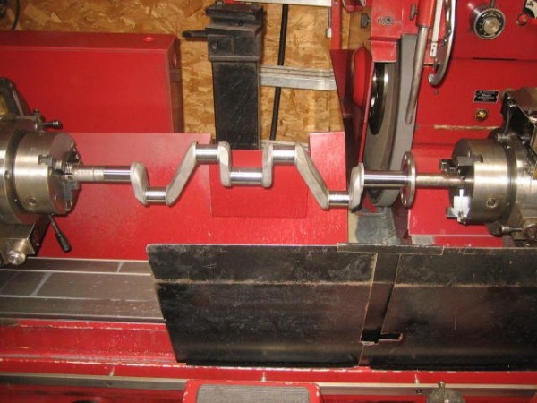

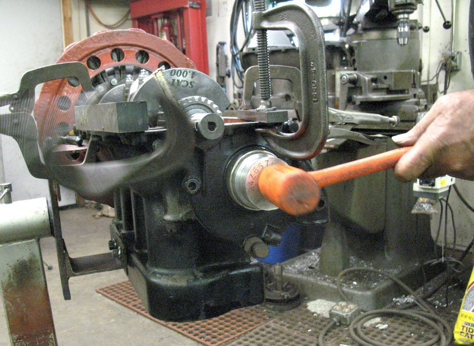

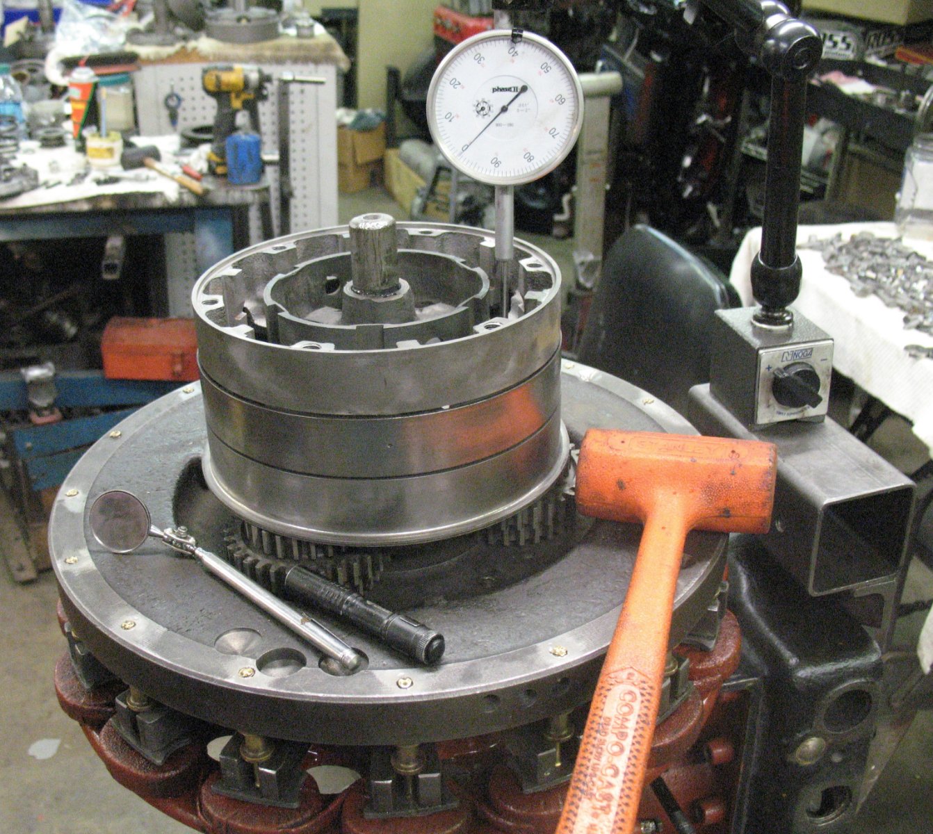

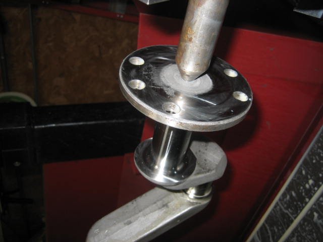

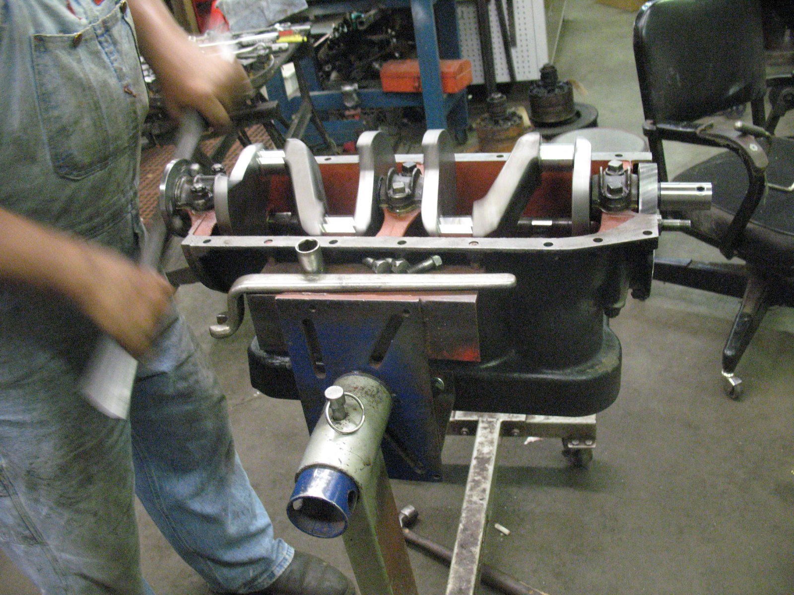

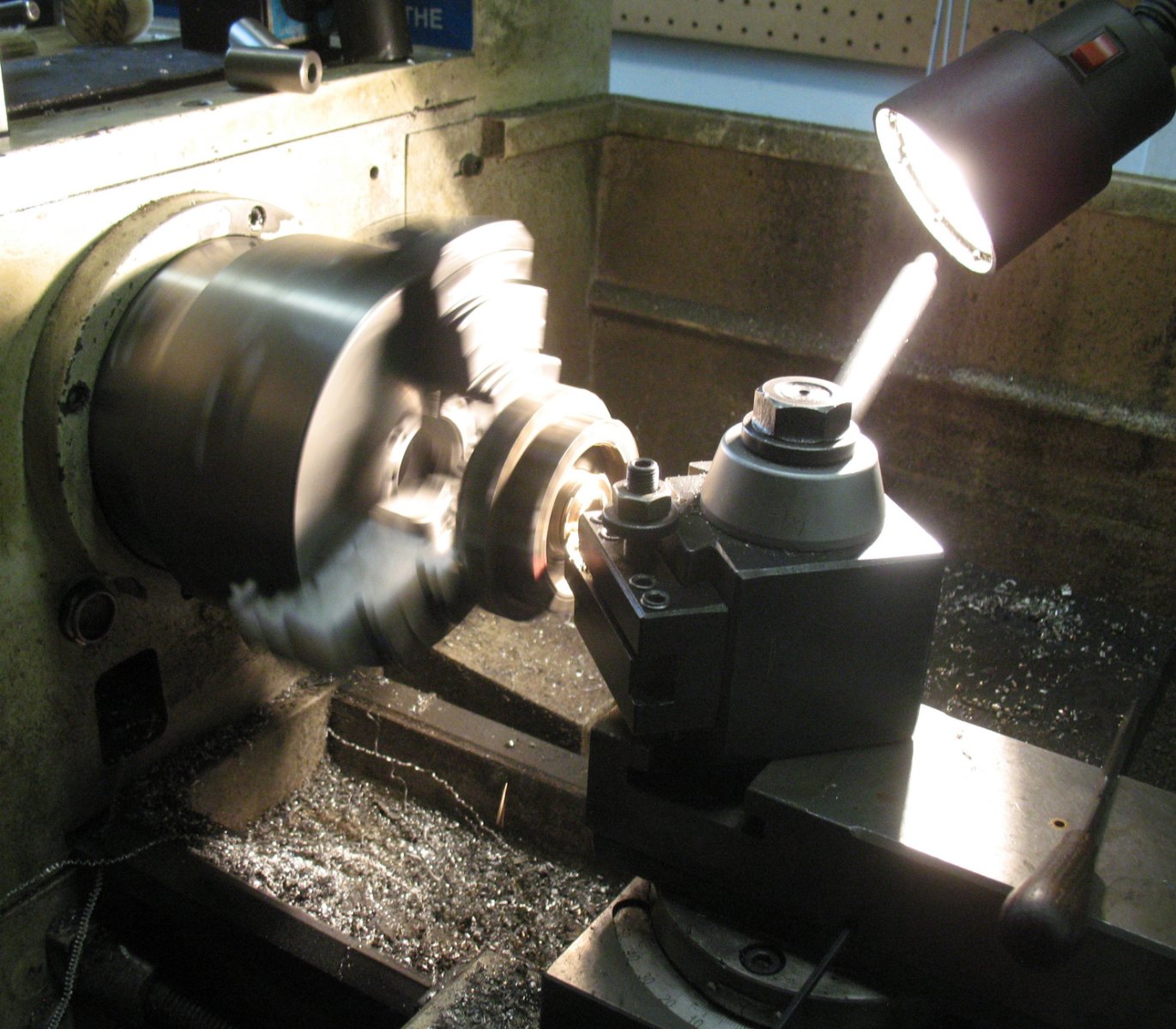

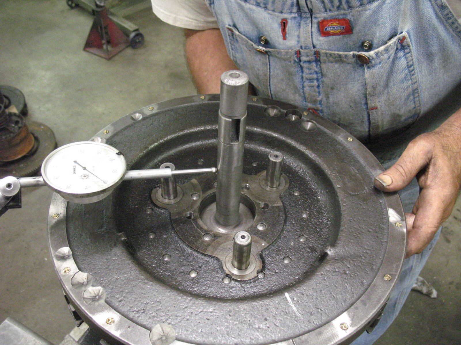

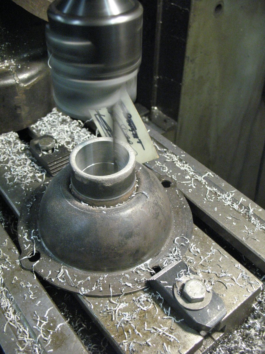

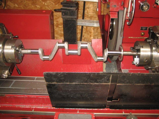

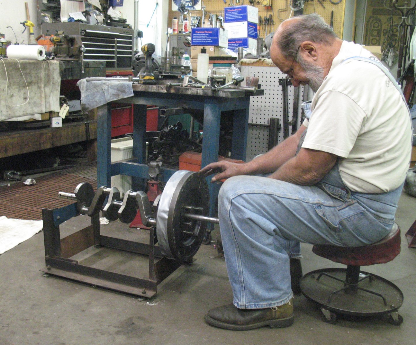

OK, I'll kick it off this time. I spent the first day of the month in Tulsa for a work day in Mike Bender's shop.
The main shaft was a mighty tight fit, so it went in the lathe for a little shave.
We fought runout for quite a while, but we finally got it under .001".

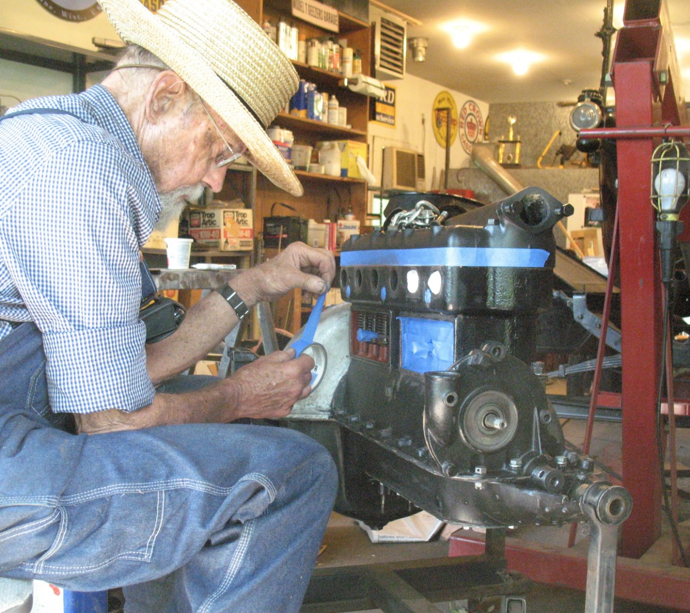

Balancing. The duct tape keeps shavings off the magnets.
Topic author - Posts: 7398
Re: What have you done to your Model T in July?

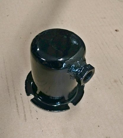

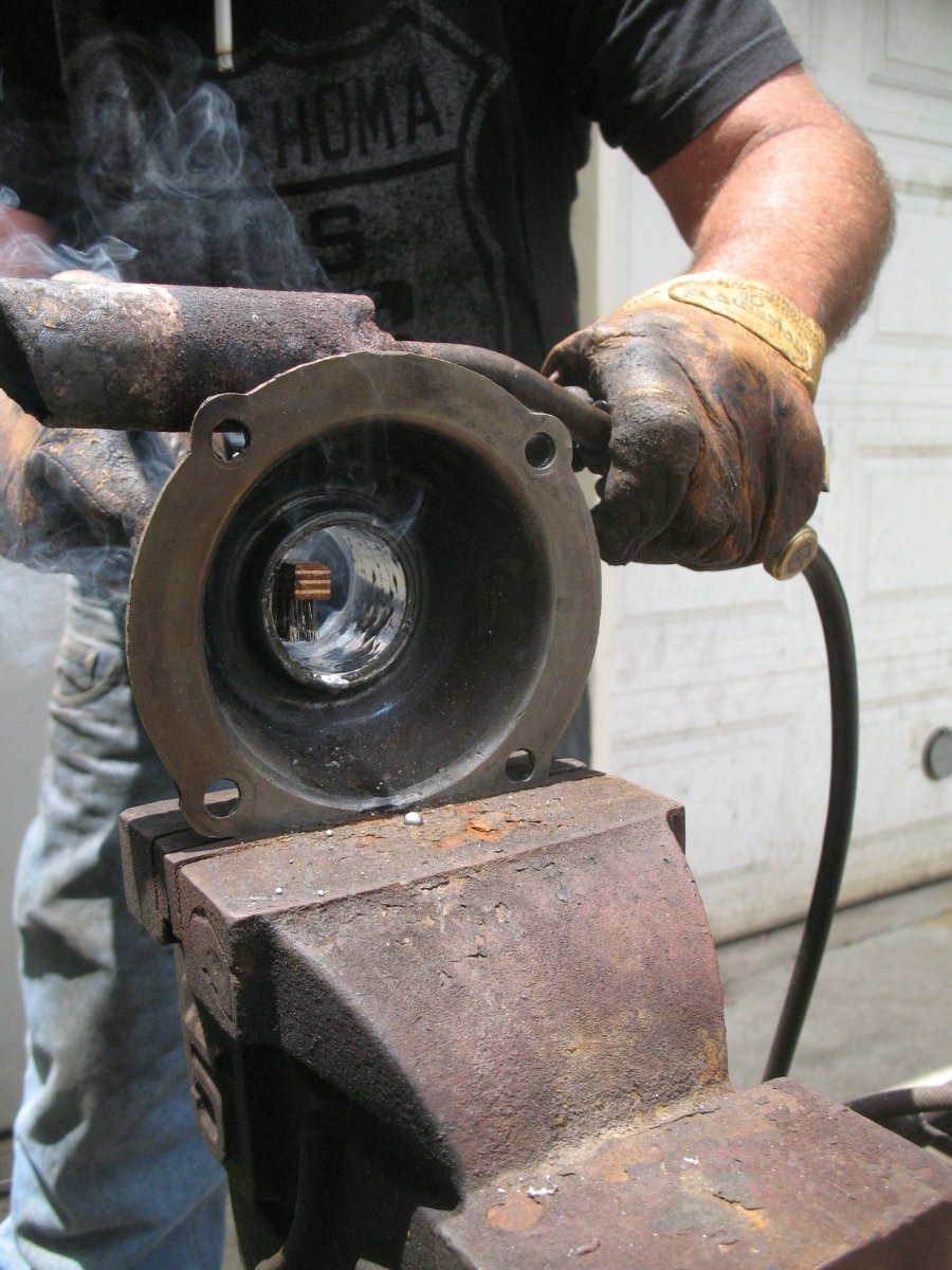

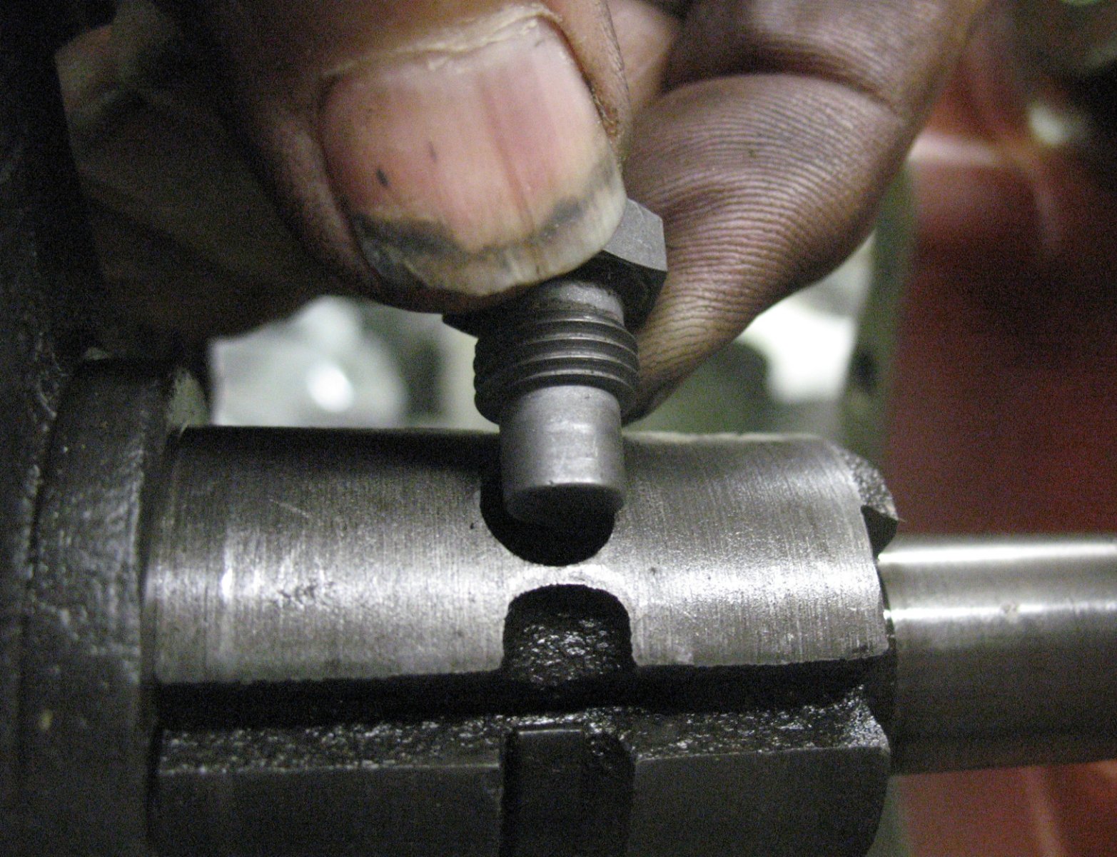

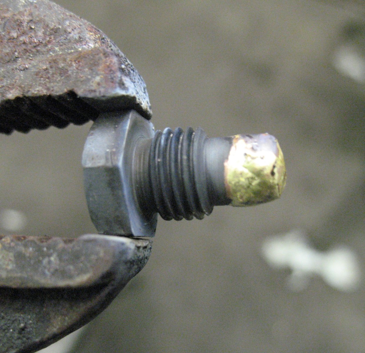

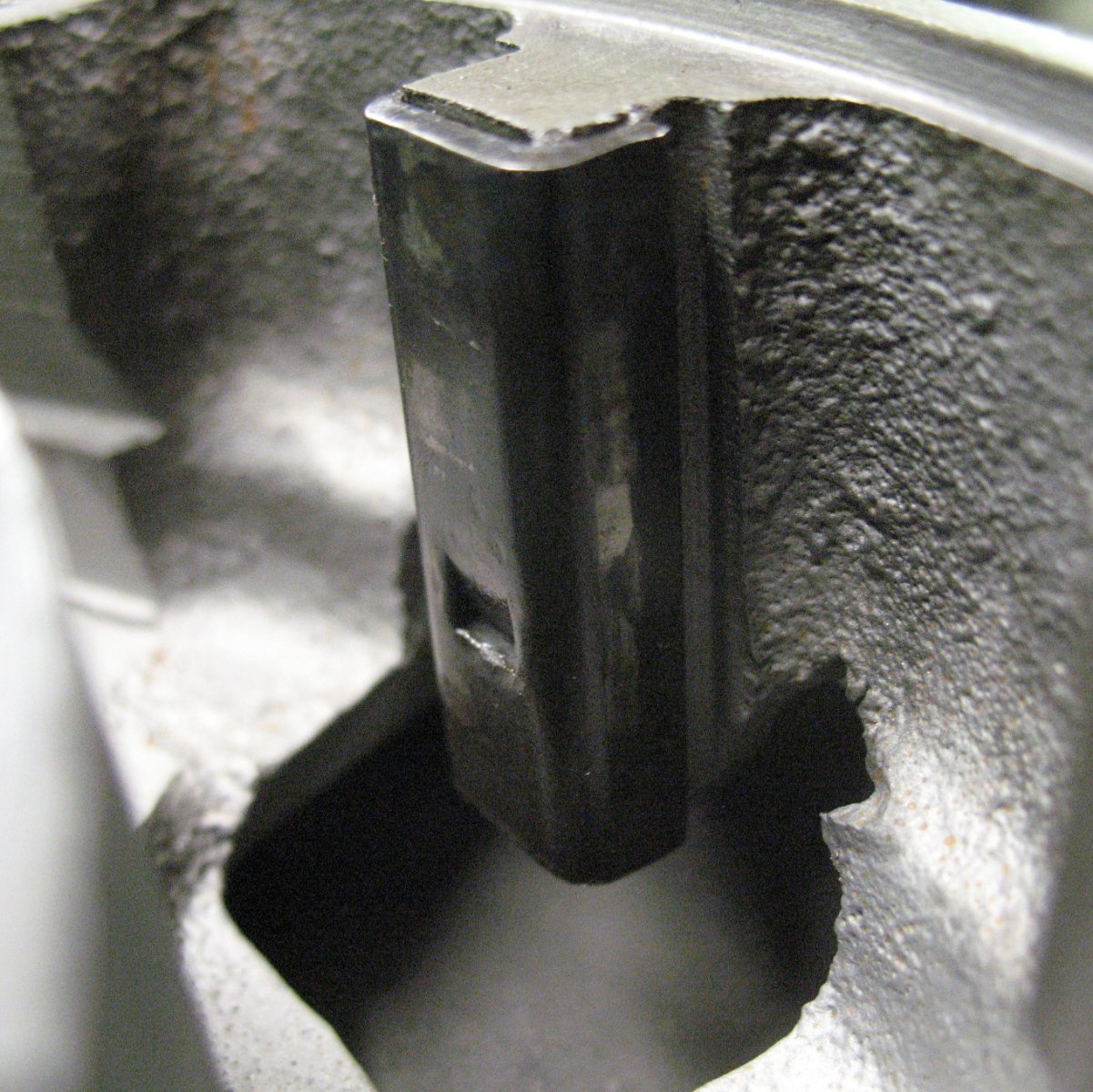

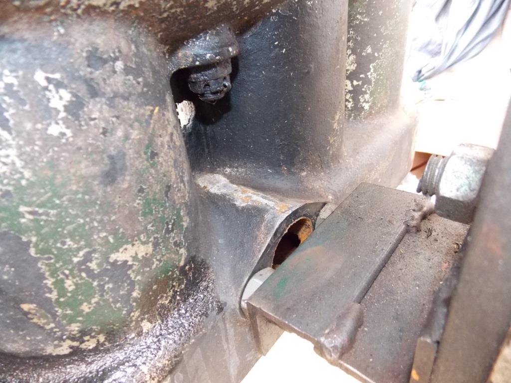

Excessive cam shaft end play revealed that this hole in the bearing is oversized.
The cure was to build up the bolt with a little brass.
After this got a turn in the lathe it was a perfect fit. No more back & forth shaft.

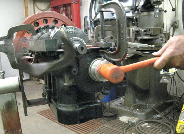

Using Timesaver to fit the bearings.
I'll go back for another session tomorrow. I hope to have this car back together soon.

Nice little series, Steve & Mike
Sean Butler
Huntington Beach, CA
- Posts: 5489

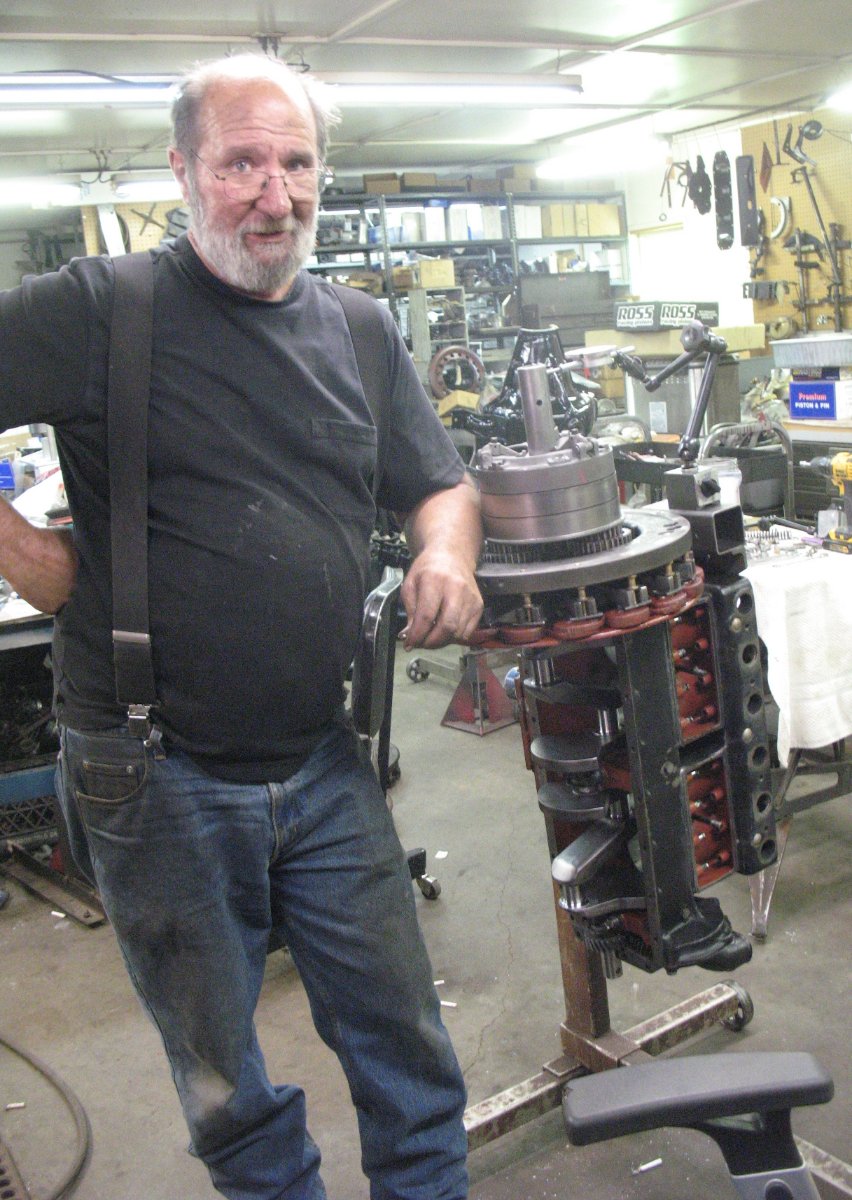

You are very fortunate to have someone so close by with that knowledge !!!
Nice crankshaft, Steve.
That's for sure. Videos are nice, but nothing beats working with the actual guy with the right tools.

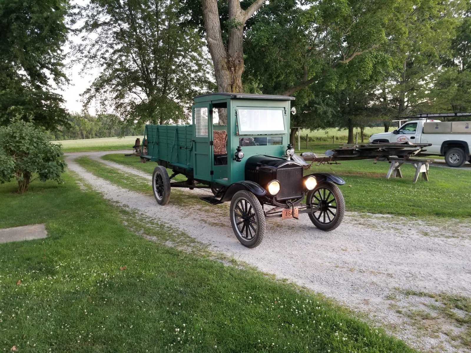

July 1st, drove the TT. July second, drove it some more. Guess what I'm doing tomorrow?

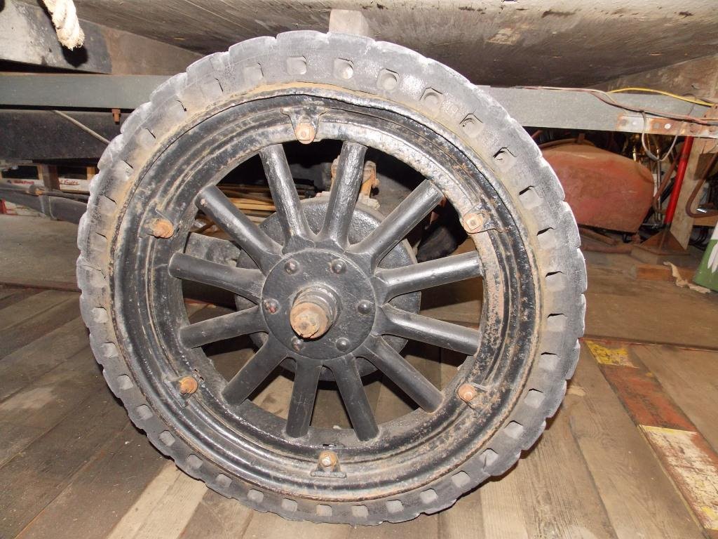

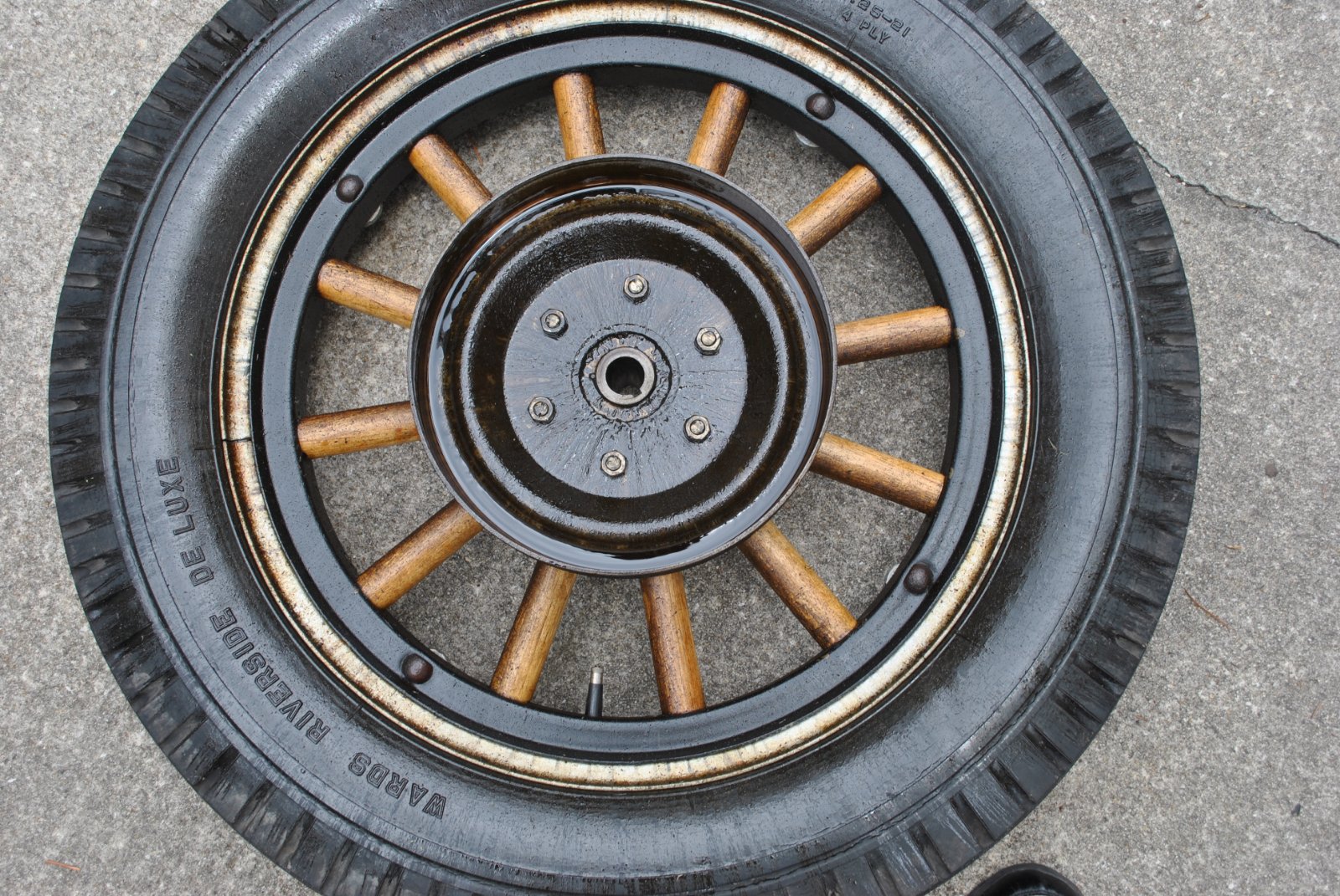

I learned something today. A flat tyre does not mean a puncture. It may just mean that when you check the pressures and top them up, the valve core didn't quite seat properly! Oh well, a bit of tyre fitting bit of practice doesn't go astray.

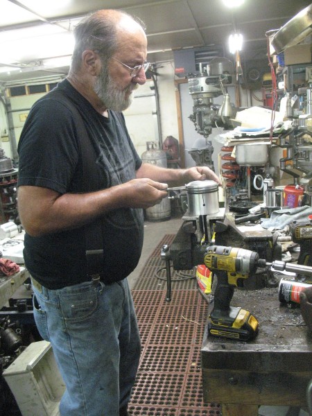

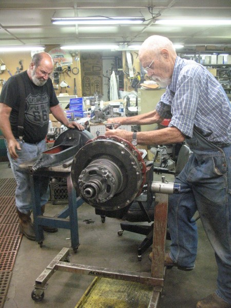

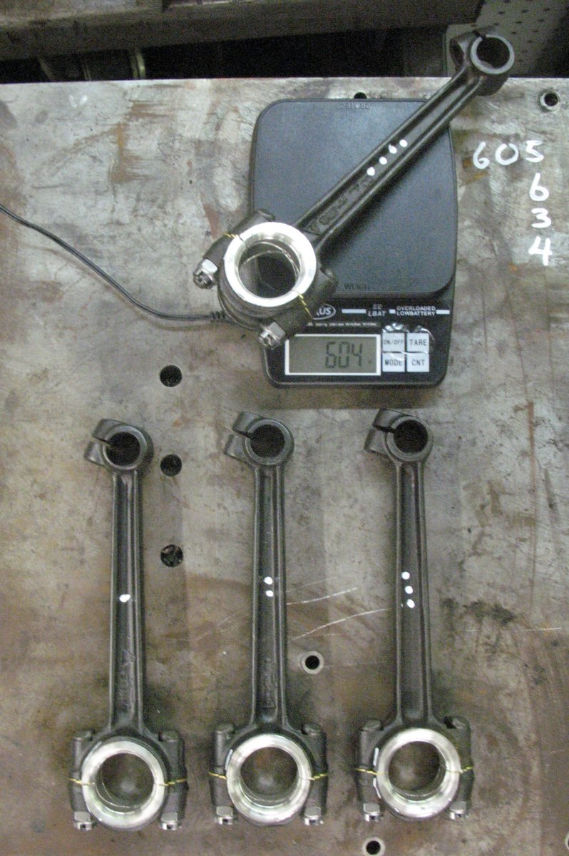

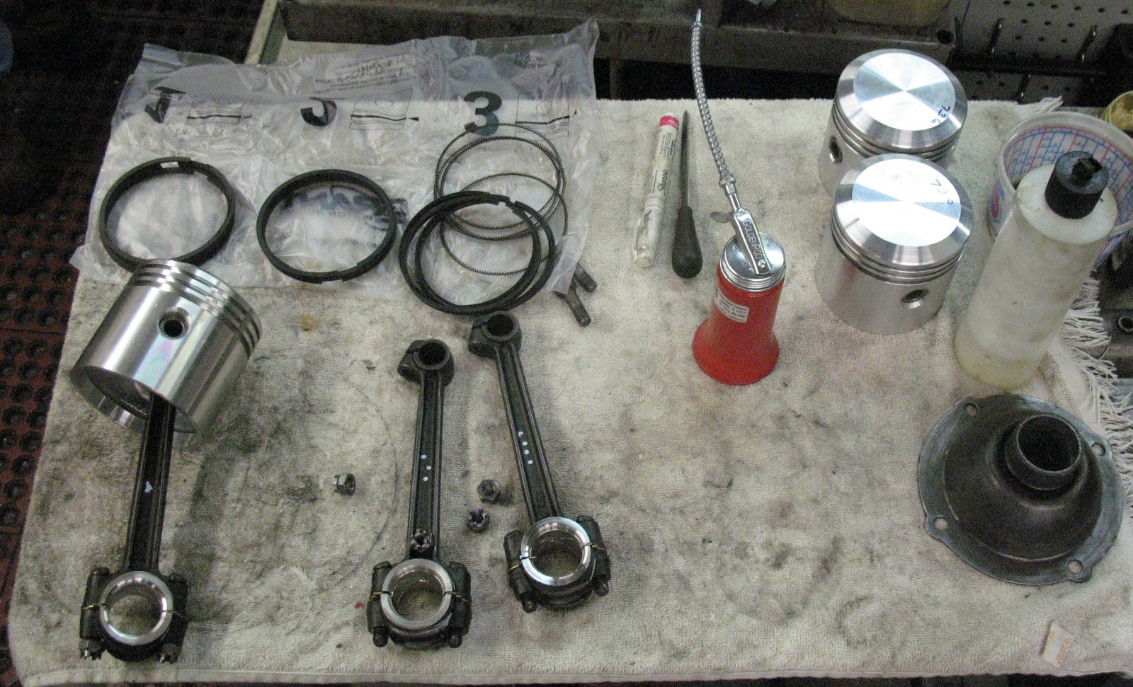

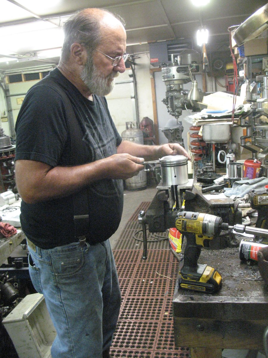

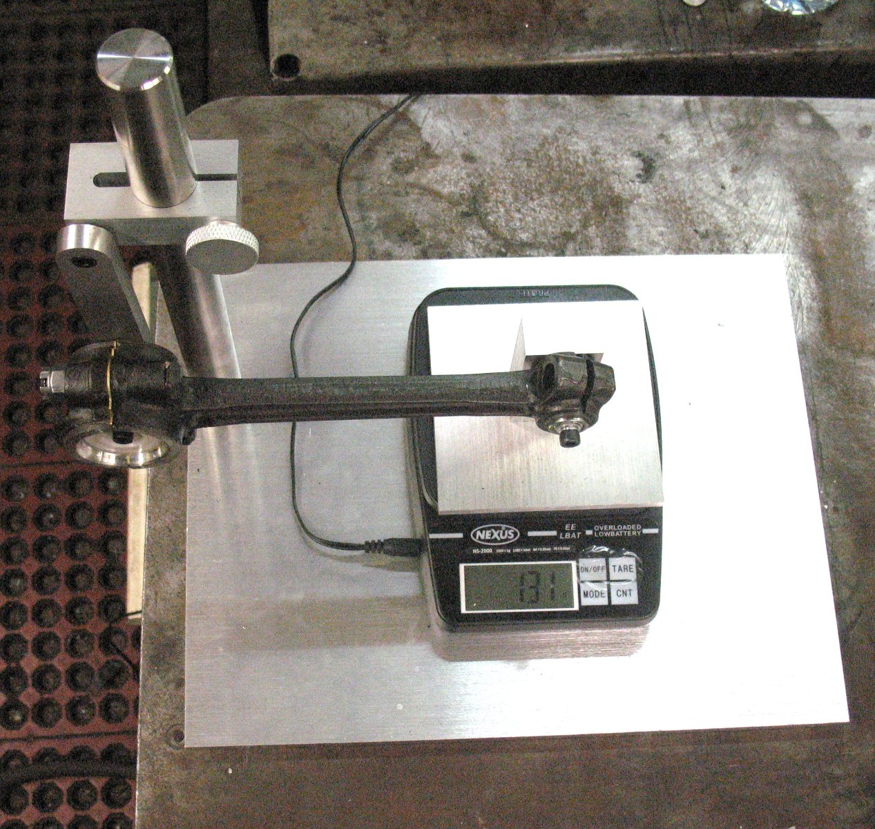

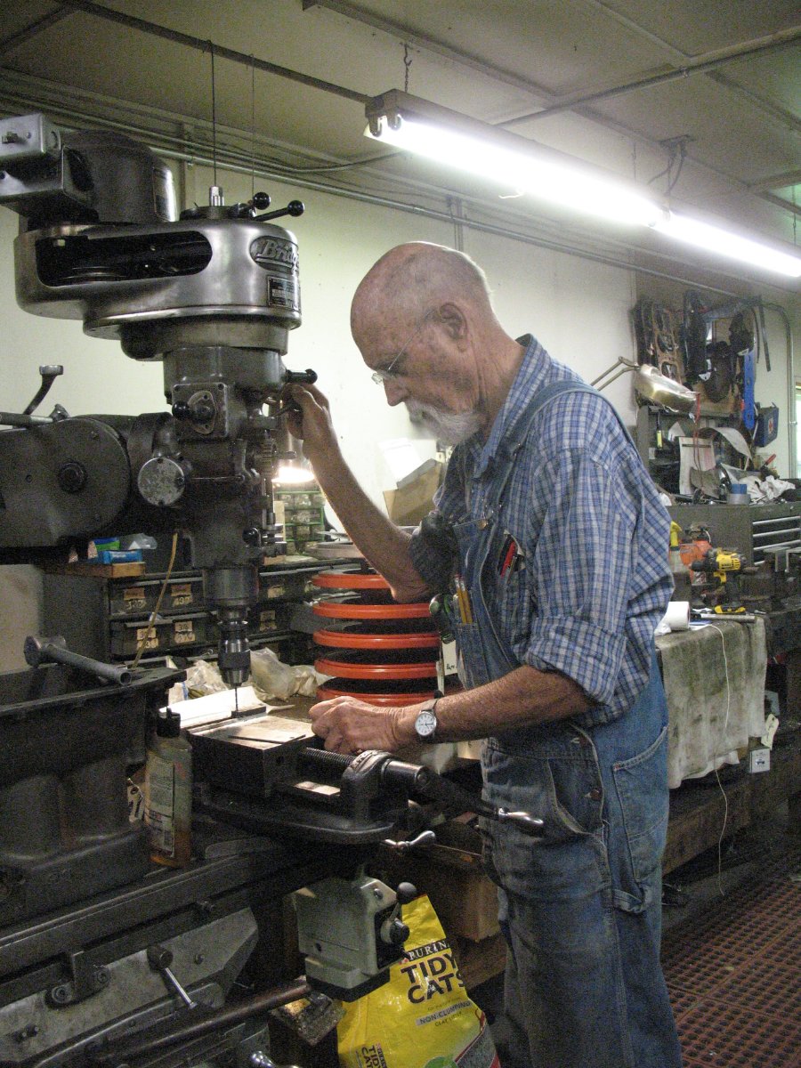

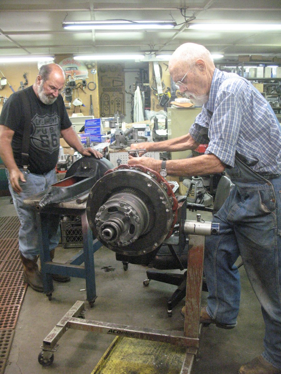

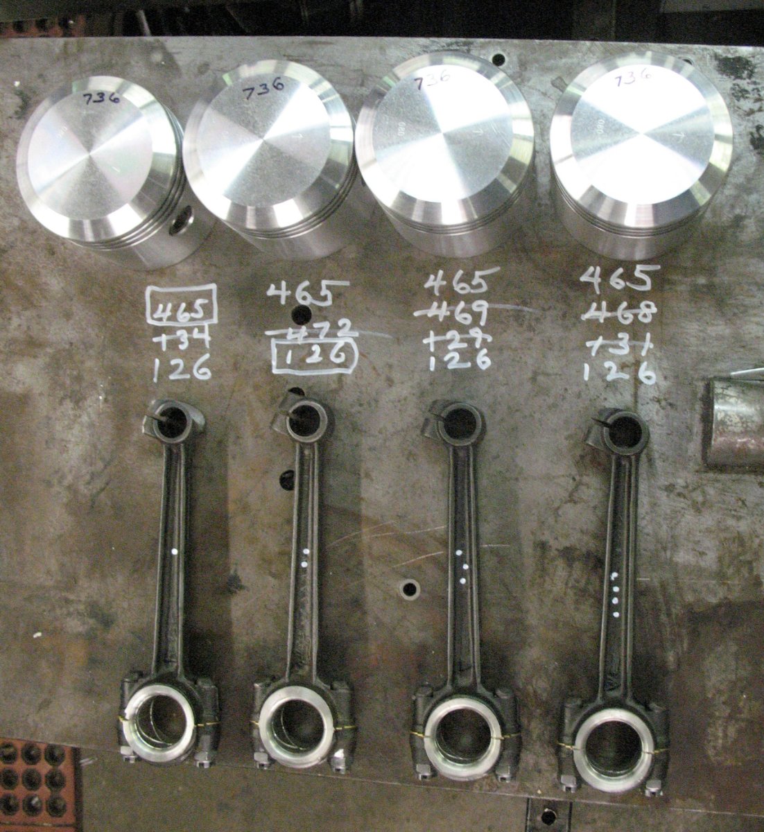

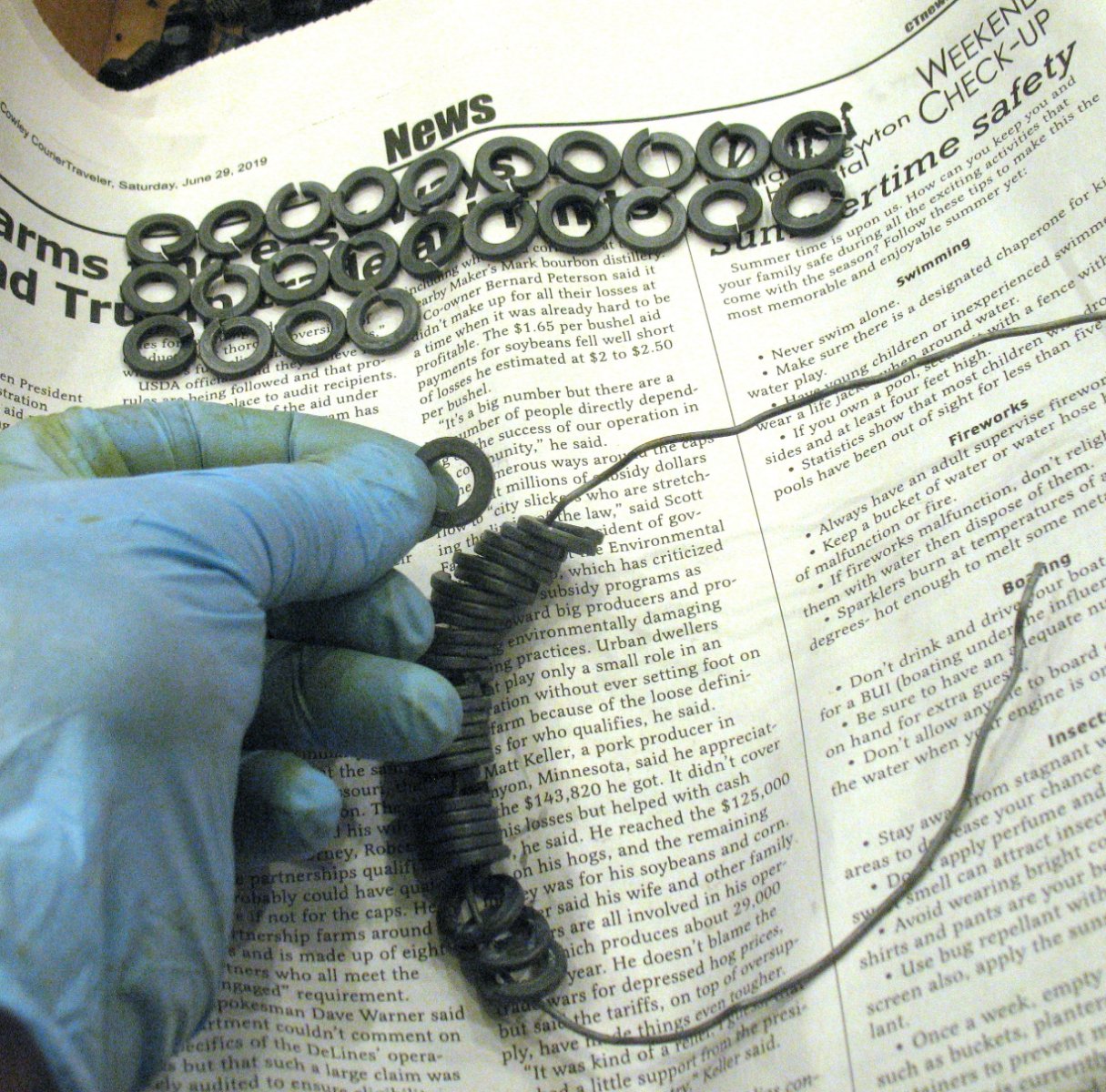

Another work day at Mike's. The main project of the day was balancing rods.
First step was getting total weights.
Then came weighing big ends and little ends separately.
At the end all big ends weigh the same, all little ends weigh the same, and all pistons weigh the same.

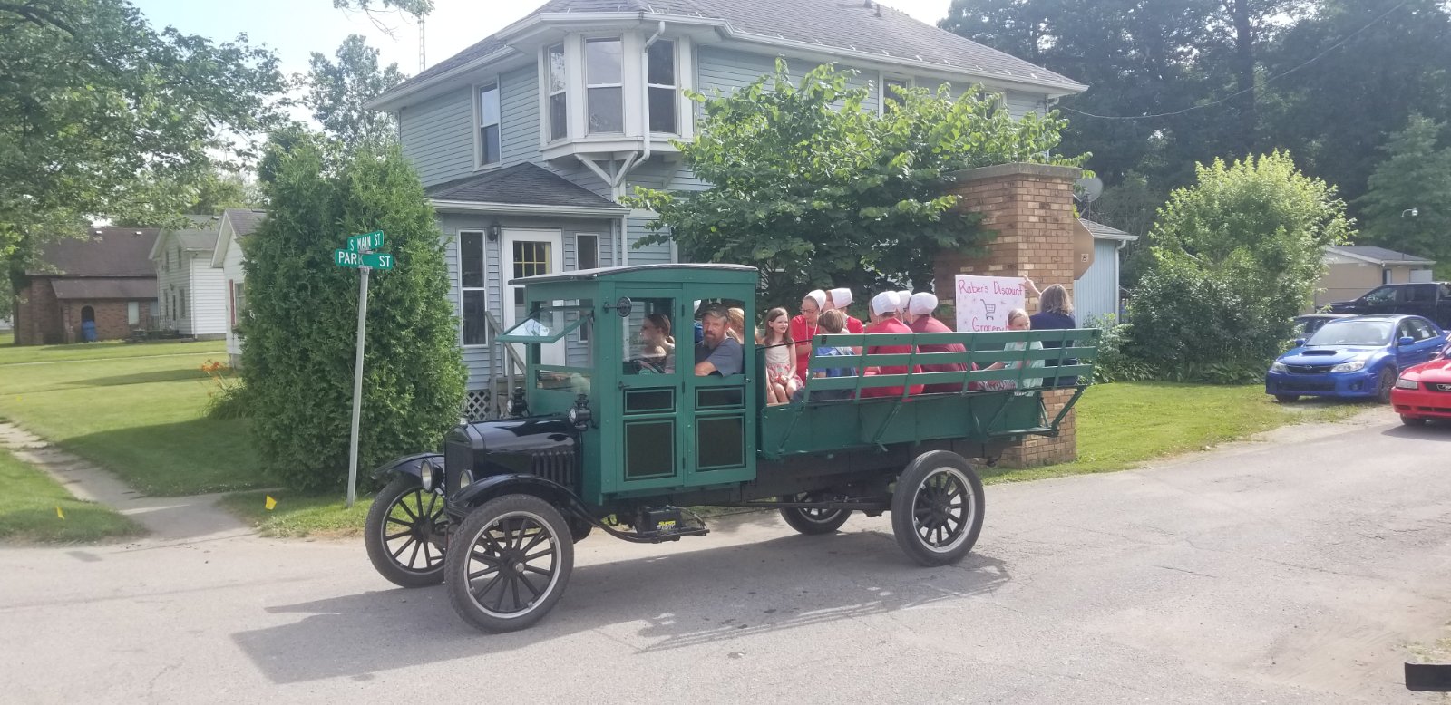

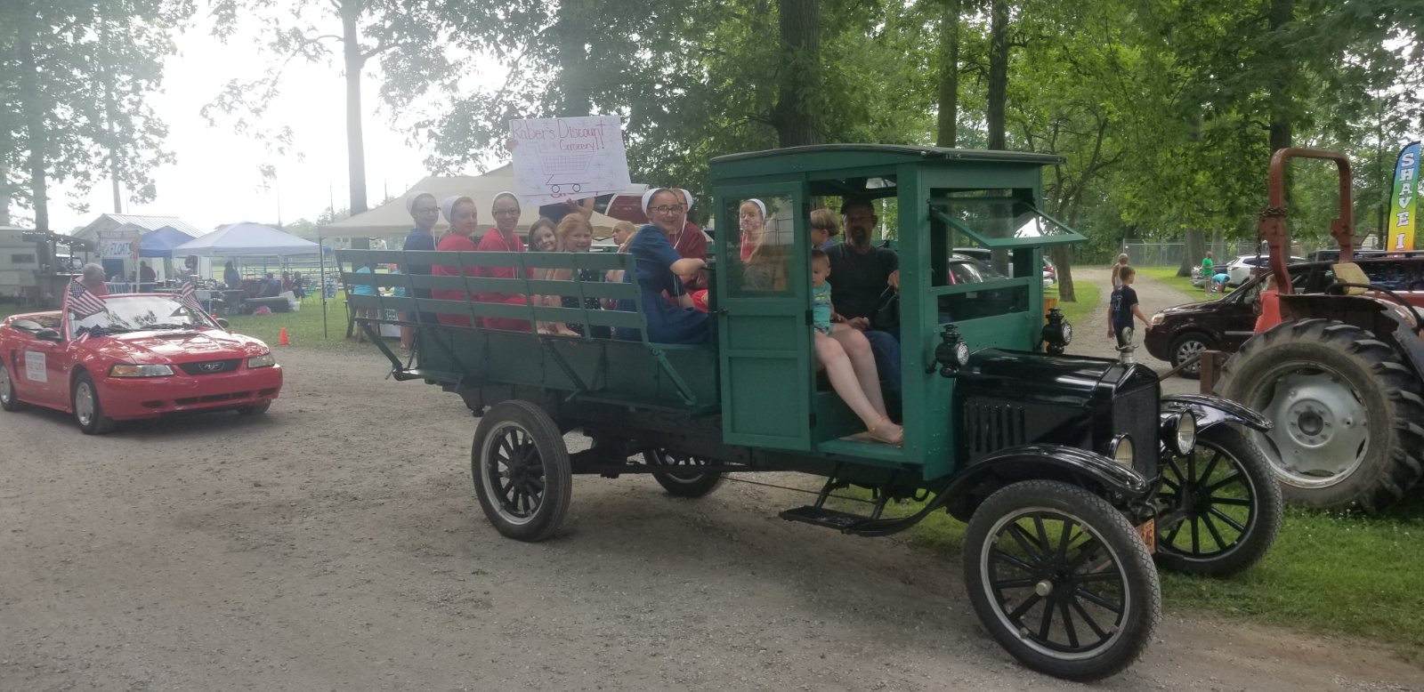

I gave her a bath for her date with 10 Amish girls in the parade tomorrow
Duey_C
- Posts: 1557
- First Name: Duane
- Last Name: Cooley
- Location: central MN
Holy XXXX. Dallas that's just gorgeous.
What? Did you tip your phone?
Beautiful.

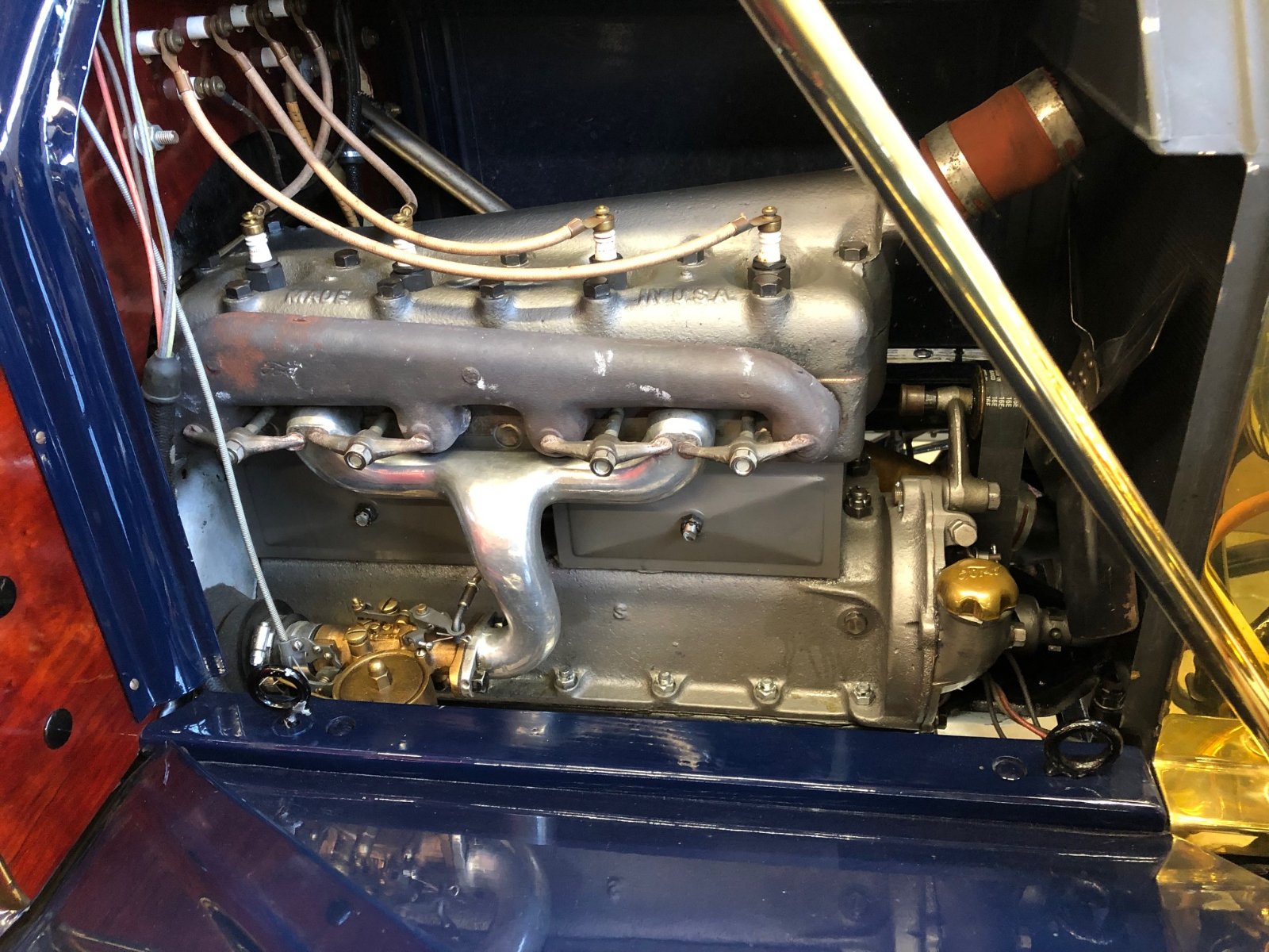

I’ve been doing a lot of small odd jobs on my Fordor. Today I got the battery installed, new wiring harnesses, finish rebuilding the starter, and put my headlights together. Tomorrow I’ll finish the steering column install. Waiting for the end of the bendix drive so I can get it running. It sounded real good in Joe Bell’s garage but I’m looking forward to hearing it run back in the car maybe take her for a short spin.
It’s been five years since the last time it was run. I also want to put a fuse on the yellow wire just for some additional protection!

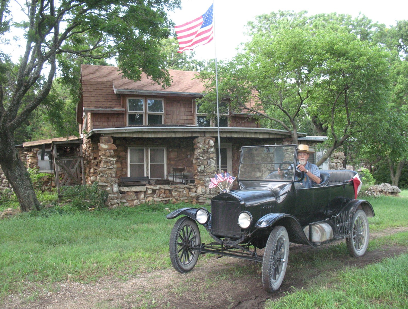

All I did to my touring today was take its picture and drive it to town for the band concert and fireworks show.
Decorated for the Glorious Fourth.
"Never mind the pictures. Let's go!"
The Arkansas City municipal band, now in its 148th year, played some great stuff, including Columbia the Gem of the Ocean, a Music Man medley, Ashokin Farewell, all the military service anthems, Washington Post, and of course the finale was Stars and Stripes Forever.
BOOM! Shorty took it pretty well, though she did become a lap dog a couple of times during the show.
Driving home. At least they're better than mag lights.

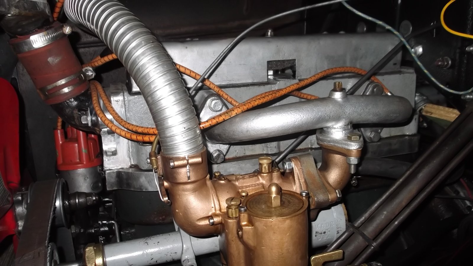

Had to go into work today, but decide to shake it up a little over here with a light traffic she cruised on the freeway like a dream.[image][/image]
Who's still makes these gaskets, I might be in the market for a solid copper one myself.

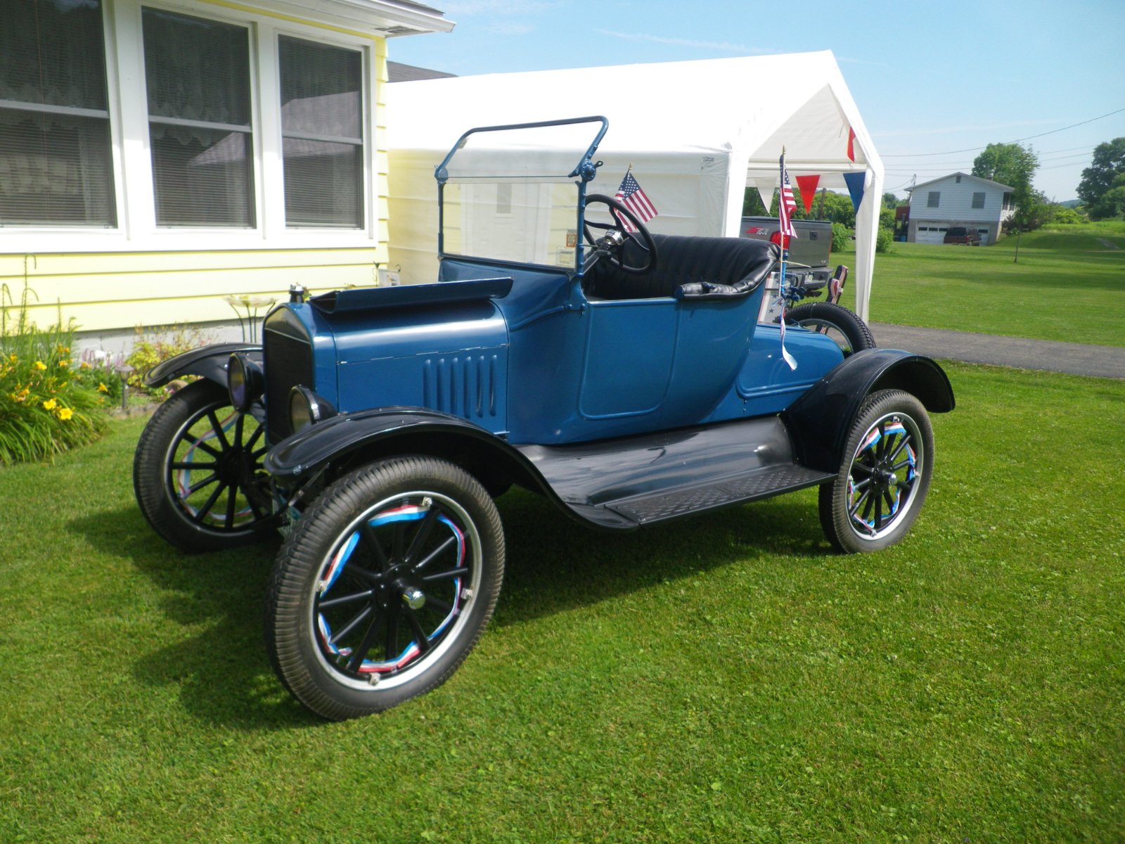

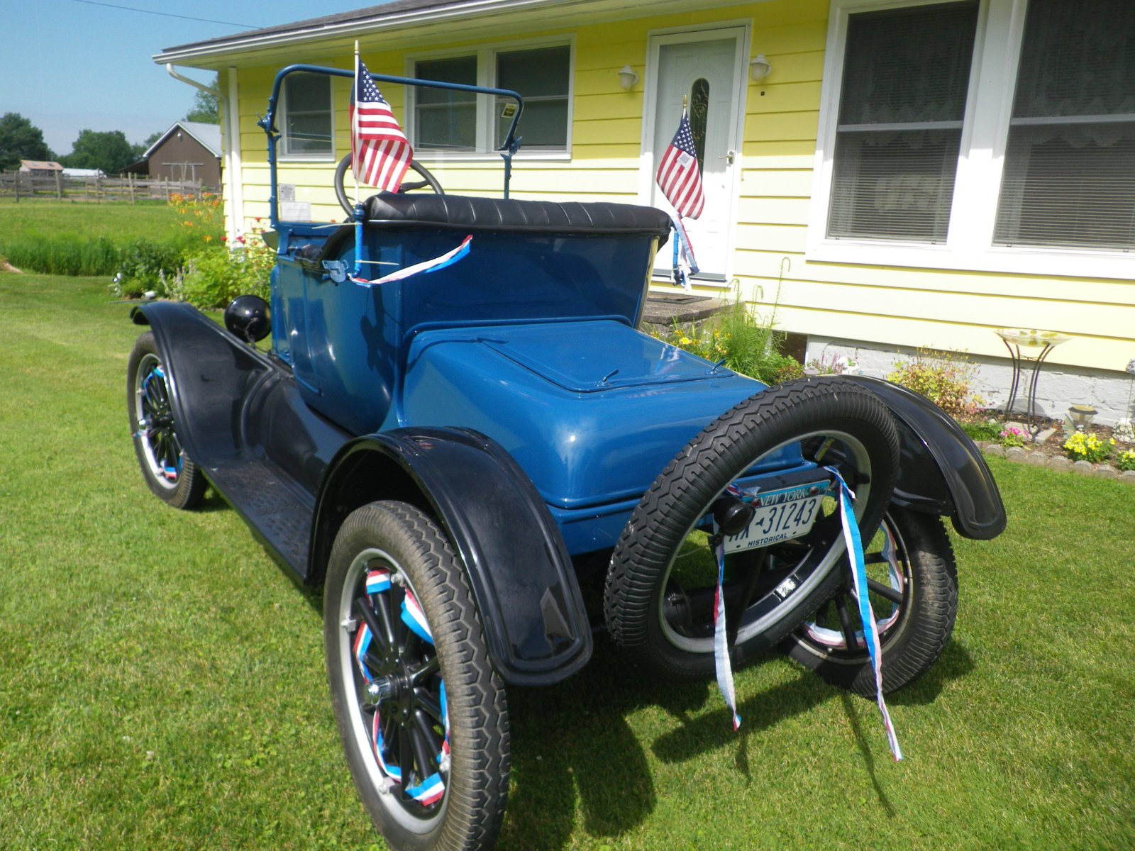

We dolled up the 21 and we to a family get to gather. We left so early we were the first ones there, the t was a hit.
It's good to see those Runabouts out and about. The blue color has been a favorite since the old AMT model cars and Testors paint days.
I need to revive mine someday.

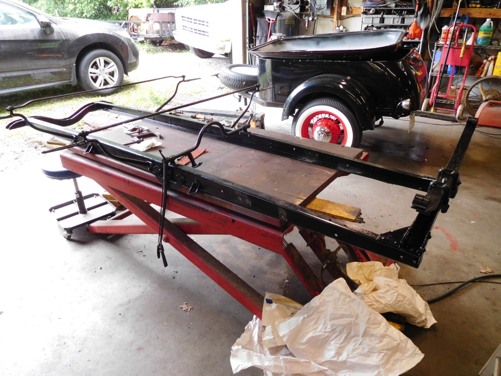

After being laid up all winter with back pain, I am now able to spend a few hours a day in my shop. Just started removing fenders from my 27 coup. Some time in the past, most bolts have been replaced with slotted round head bolts and square nuts. Have needed to use cut off wheels to remove them.

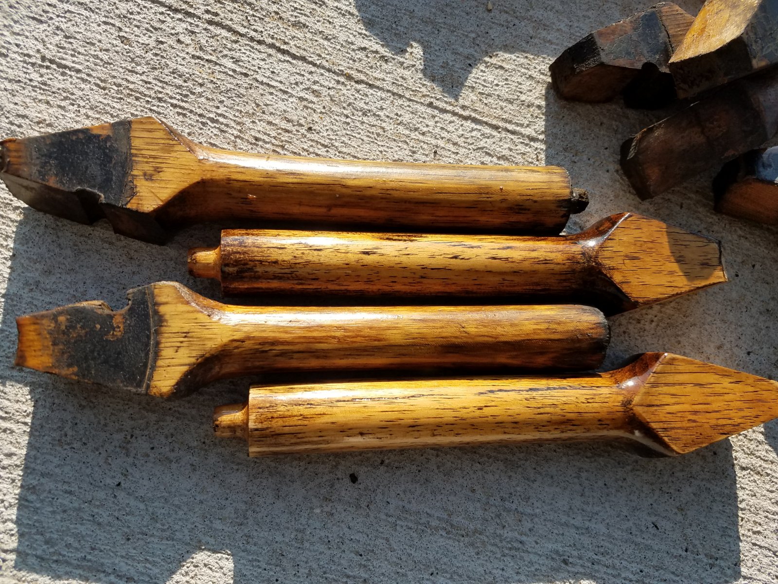

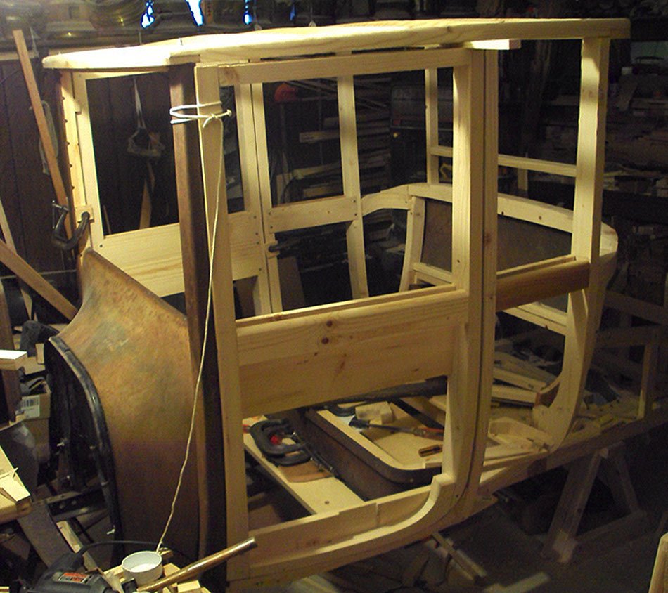

I plugged some screw holes Today. When I built this Coupe I used pine for the wood. I didn't plan to drive it this much. The pine was cheap and easy on the tools and my muscles. Now it's time to put better wood in the places where pine has let the screws strip out. A similar technique would work for old original wood where it fails.
I simply drilled the holes and pressed in harder dowels with glue. A punch expands the wood into the hole a bit. It should be good for several more years.
I have used ash and even oak in better cars but the pine worked fine for this one.

Dallas, how are you going to squeeze 10 Amish girls in that cab.

David , thats why I wanted the 8in1 bed. You can haul more girls
this was my view in my mirror. 13 people in the back and my daughter inlaw and grandson up front.

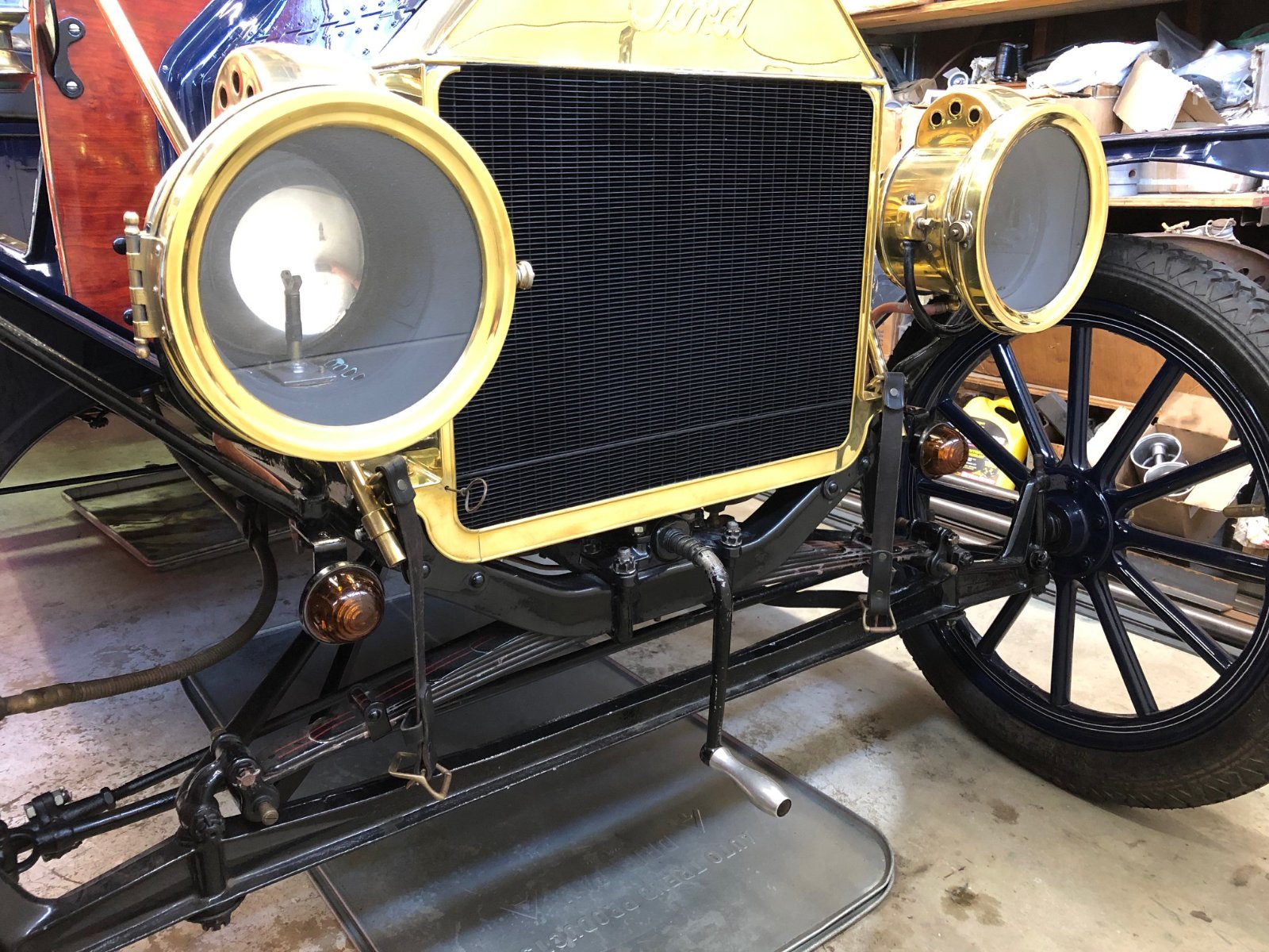

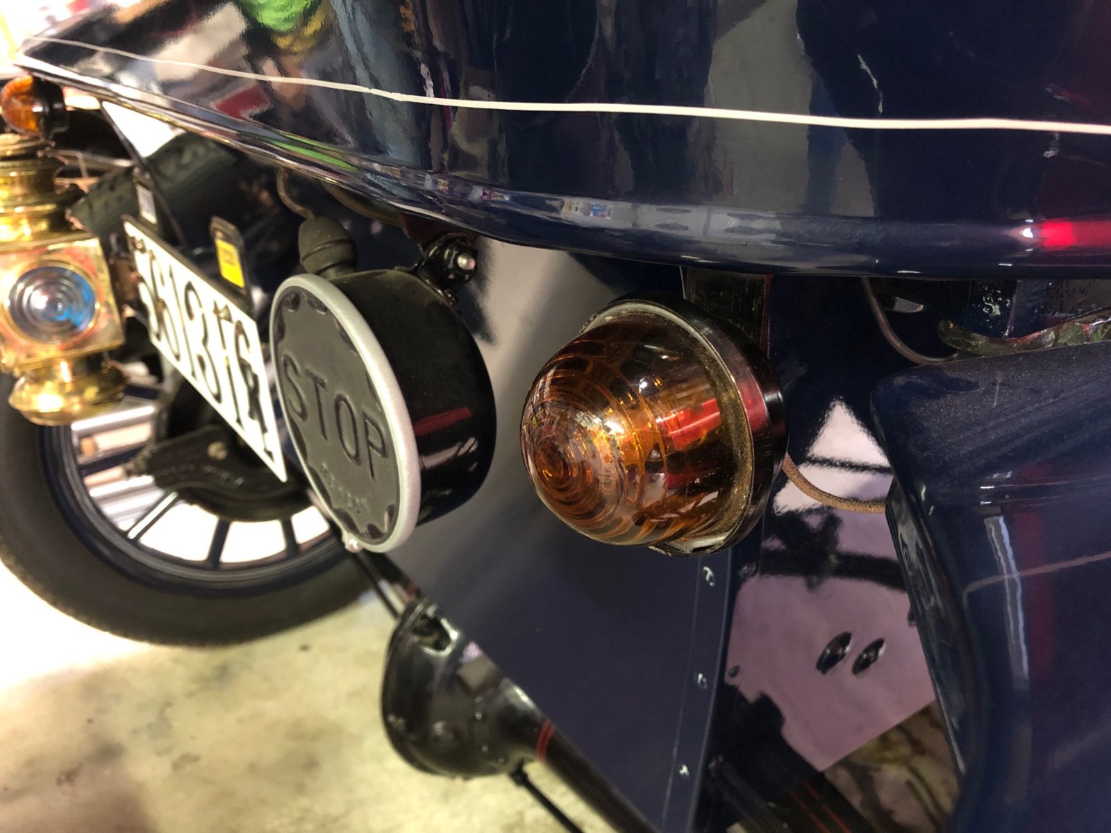

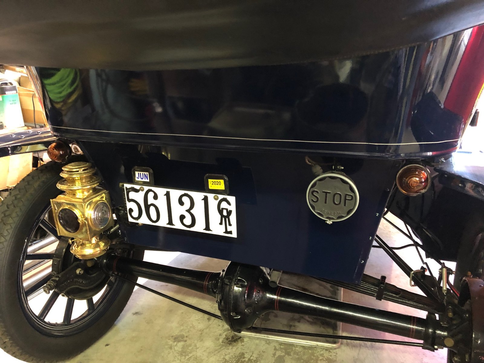

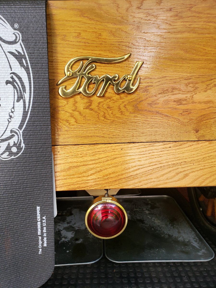

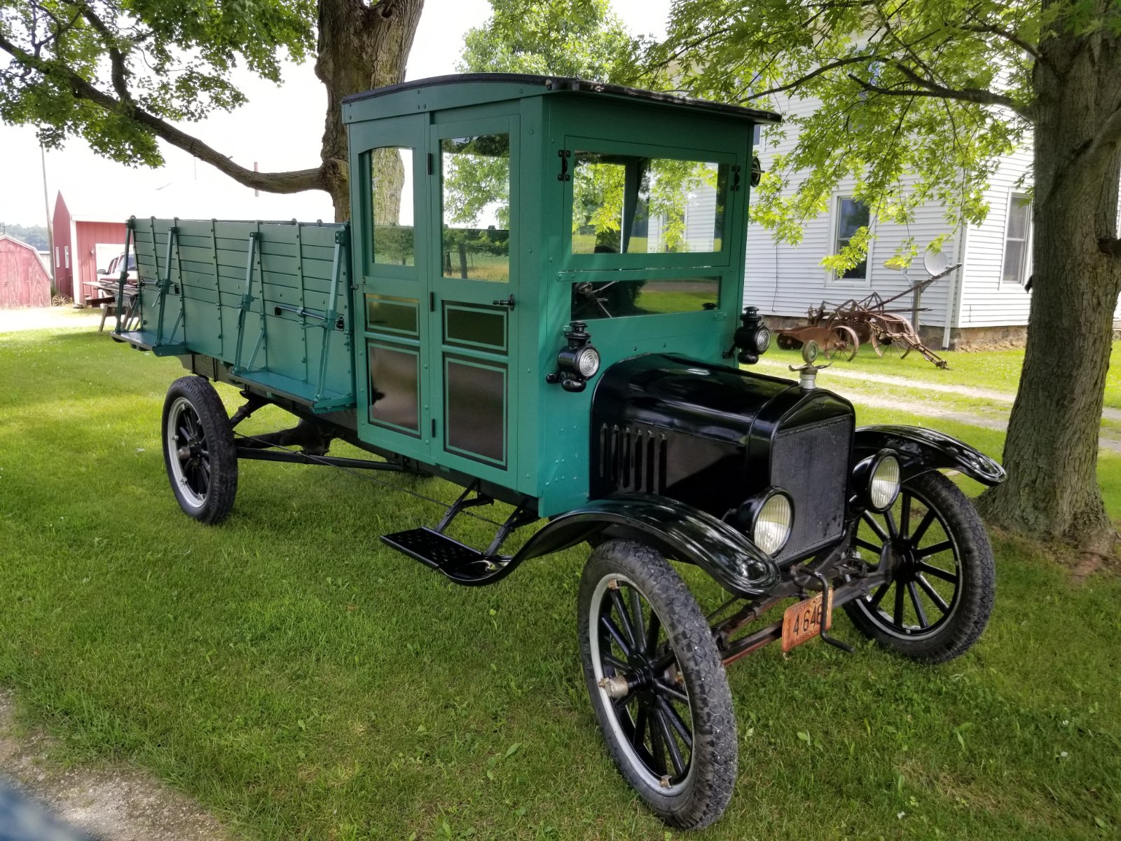

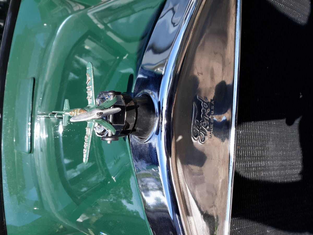

I mounted my Bob Scherzer radiator ornament. And followed that up with a starter button extension. I still need to install the modern rear axle seals before the Michigan Jamboree. I have a month, so I am pacing myself.
Grayling Michigan
1927 Fordor
1926 Huckster
1923 TT
1930 Fordor
1930 Tudor
1927 Fordor
1926 Huckster
1923 TT
1930 Fordor
1930 Tudor

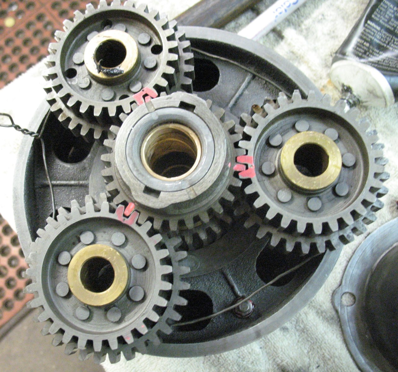

Another work day in Tulsa. It shouldn't have, but assembling the transmission took up most of the day.
Checking the new brake drum for balance.
Looks like it's ready. Looks can be deceiving.
The first hangup was .038" where there was supposed to be .017" - 022". That wasn't too bad. All it took was a change of washers.
Nobody will ever know what's in this 1915 unless I tell them.
A more difficult problem was excessive tail shaft runout and binding. We thought maybe the triple gears were standing too tall, so Mike faced the bushings. That wasn't it. Problem not solved. Eventually we figured out that the brake drum bushing was sticking out of the drum enough to cause the binding. A minute in the lathe fixed that, and curing the binding also fixed the runout.
Transmission assembled after a difficult day.

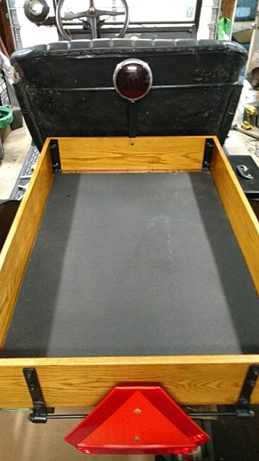

Dallas, Looking goo, do you have any photos from the out side, with the bed in the girl hauling mode?
Steve and Mike, looking great! Steve thank you for letting me stop by and Mike, what goes around comes around ha ha. Great meeting you both. jw
- Posts: 2837
- First Name: Dallas
- Last Name: Landers
- Location: N.E. Indiana

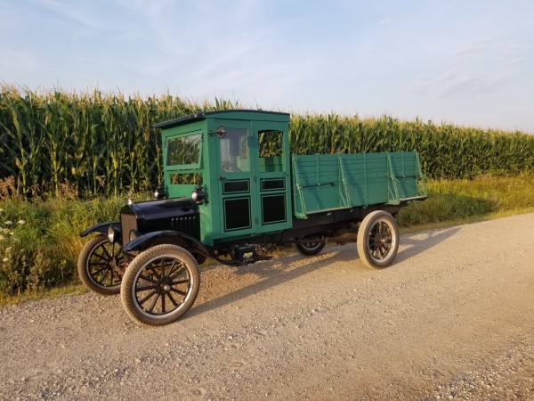

John, I just had these sent to me. Line up before parade. Can you tell its 86 degrees with high humidity?
There were complaints about how fast the parade was last year. This year the old girl led the parade in Chicago low and T low. No complaints from town folks this year

Dallas, the truck looks great. I see door hinges, but I bet you get in from the passenger side.

Steve uf your spry, you can step over the steering colum but its much easier to get in passenger door like a stock T.

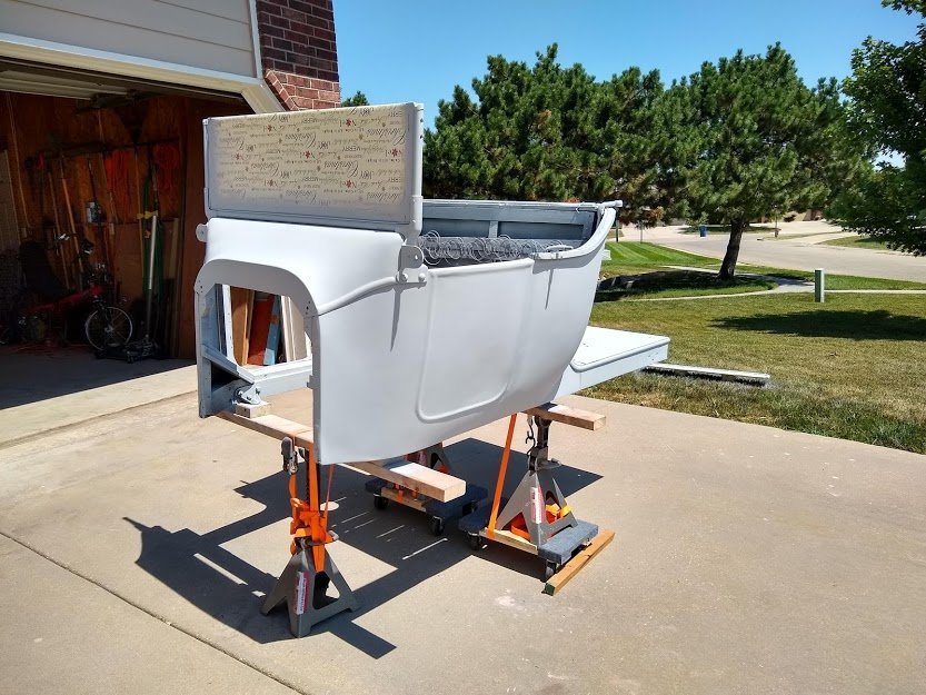

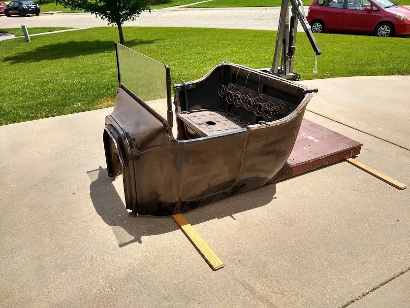

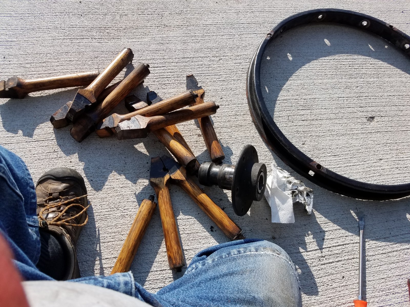

As of today my 15 runabout is officially a "frame off" restoration. My wife and two of my sons were "pallbearers" as we lifted the tub over the tank and off the frame. I plan on taking the frame to the powder coater this week. The goal for the rest of the month is get the body parts primed and sanded in preparation for getting them professionally painted. I'm planning on priming and painting the rest of the parts myself with Eastwood's extreme black chassis paint. It is good to be done with disassembling and moving on to refinishing and reassembling! Fun project so far.
Neal
Neal

Finally got the misses in the TT for a ride. We went to the next town for dinner. Of course we had to stop for icecream on the way home. The TT never missed a lick. Lots of thumbs up and smiles along the way. Its about 30 mile round trip on all back roads. No better way to spend sunday afternoon.

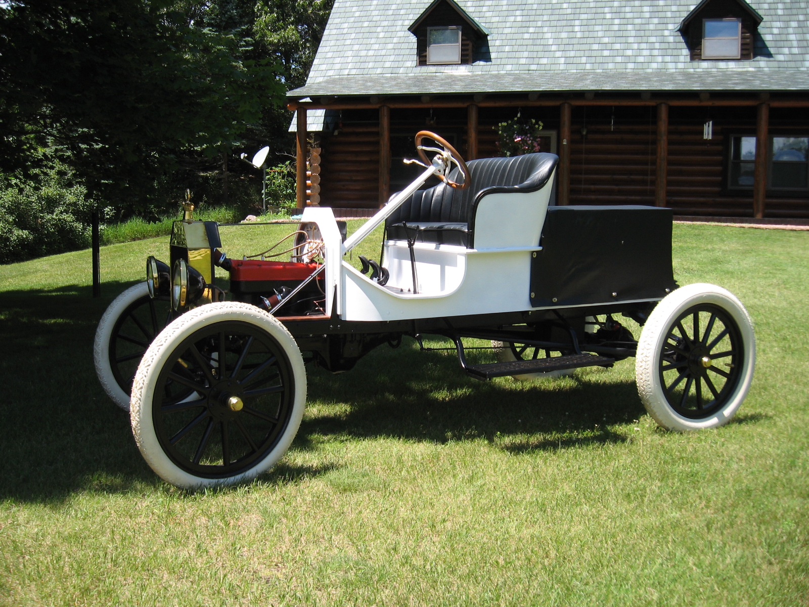

1912 Racer is painted and running.

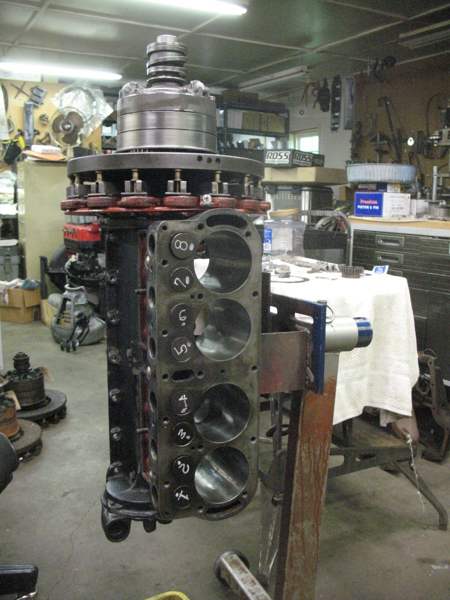

Monday was another work day at Mike's.
Heading down the home stretch on engine assembly.
Assembling rods and pistons.
Rings going on.
Drilling holes in rod bolts.
Mike is getting the pan straight. I'm tightening and pinning rod nuts.
Rings going on.

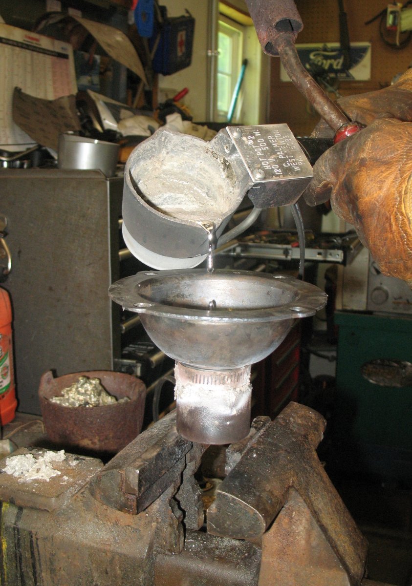

The front plate goes on.
Tinning the fourth main.
Pouring new Babbitt.
Cutting the new Babbitt to fit.
Loading up on the downhill side of a long day. I left home at 6 AM and got back at 8:50 PM.

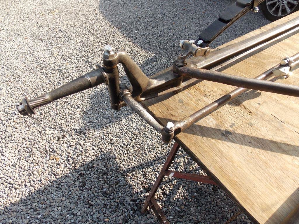

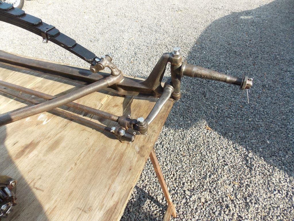

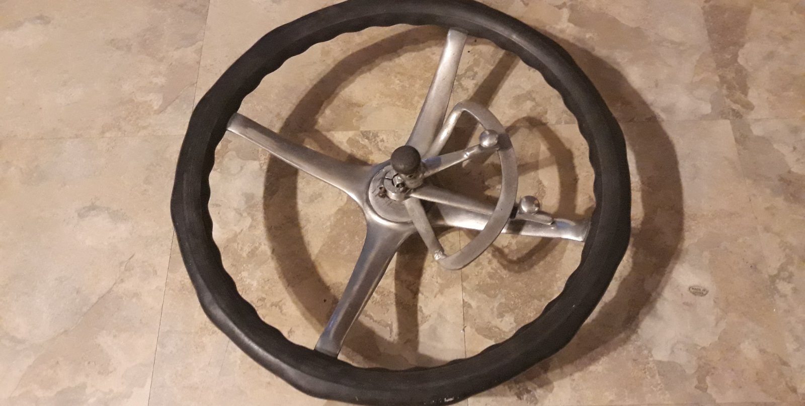

I started work on the steering for the speedster. As I am using a "different" setup a T steering or simple box won't work. The spark and gas need to transmit thru yes thru the box. It should look awesome when its done though.
No I don't know what the box originally was in and yes there will be welding and cutting to make everything work. Primarily with the plate at the base of the box so the rods can come out. The plate will also need to retain the quadrant so it doesn't rotate.

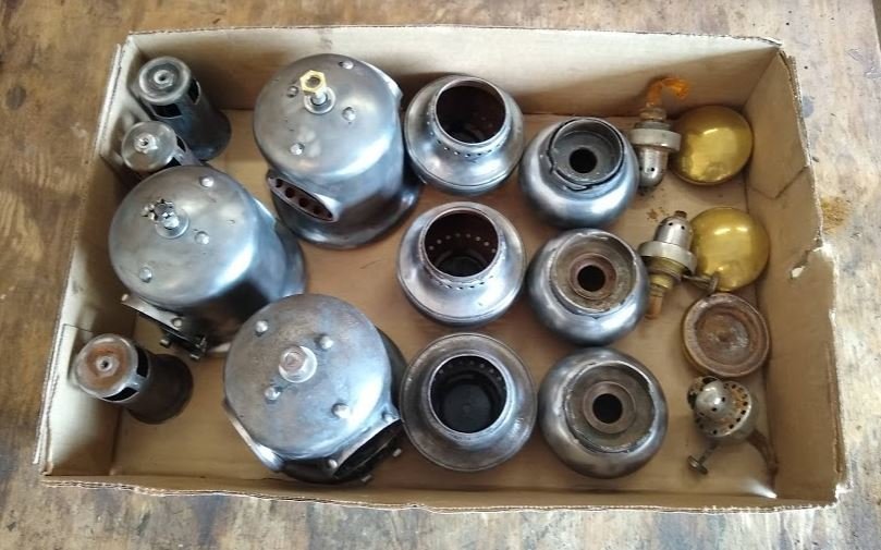

Since my '27 is laid up waiting for rebuilt coils, I decided to replace the commutator harness. One wire had been positioned poorly and was rubbing against the spark rod. I had bought a complete set of harnesses back in 2015, but had replaced only the lighting and horn harnesses. I have new harnesses for the rest of the car, but what is there looks OK.

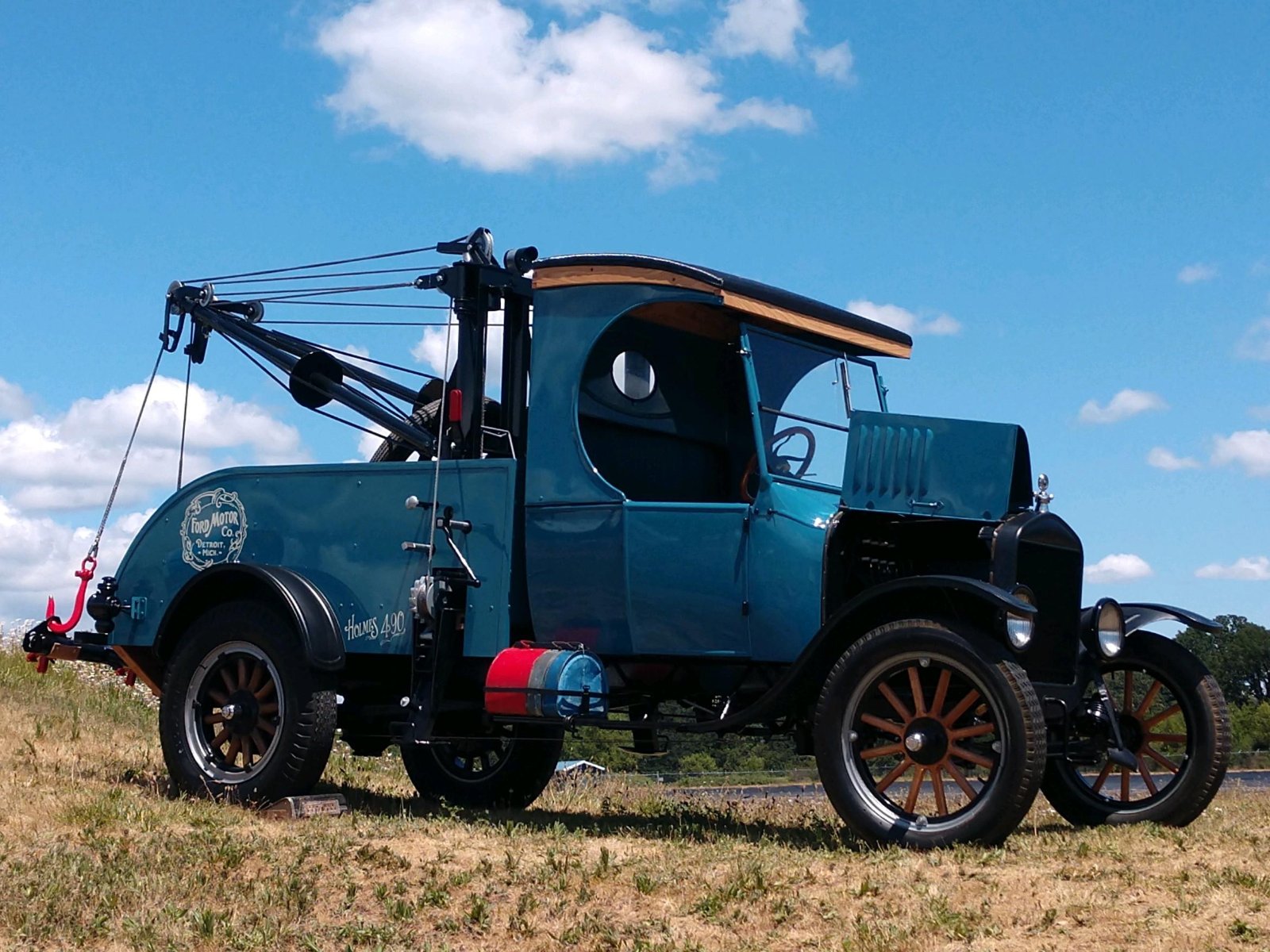

Thanks, we have been working on it for the last 5 years. The fenders are still in primer, but we didn't want to wait for another summer to get it out. Should be able to finish it all the way this winter

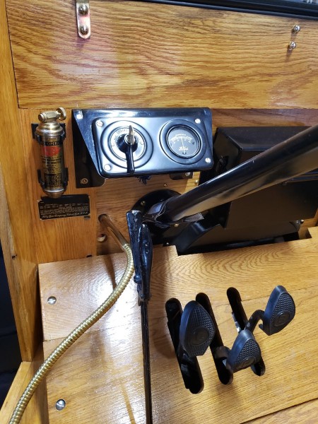

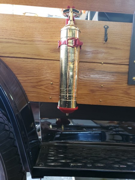

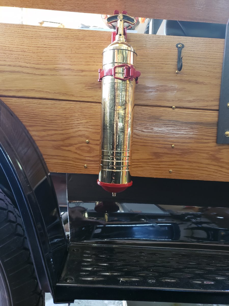

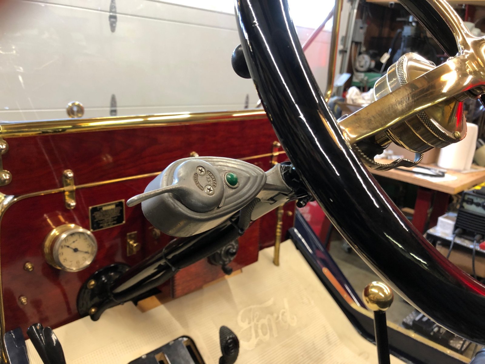

I added a couple of brass fire extinguishers and a brake light to the old Ford.
I found the small extinguisher in an antique shop. First time I've seen one like it so picked it up. A real conversation piece.

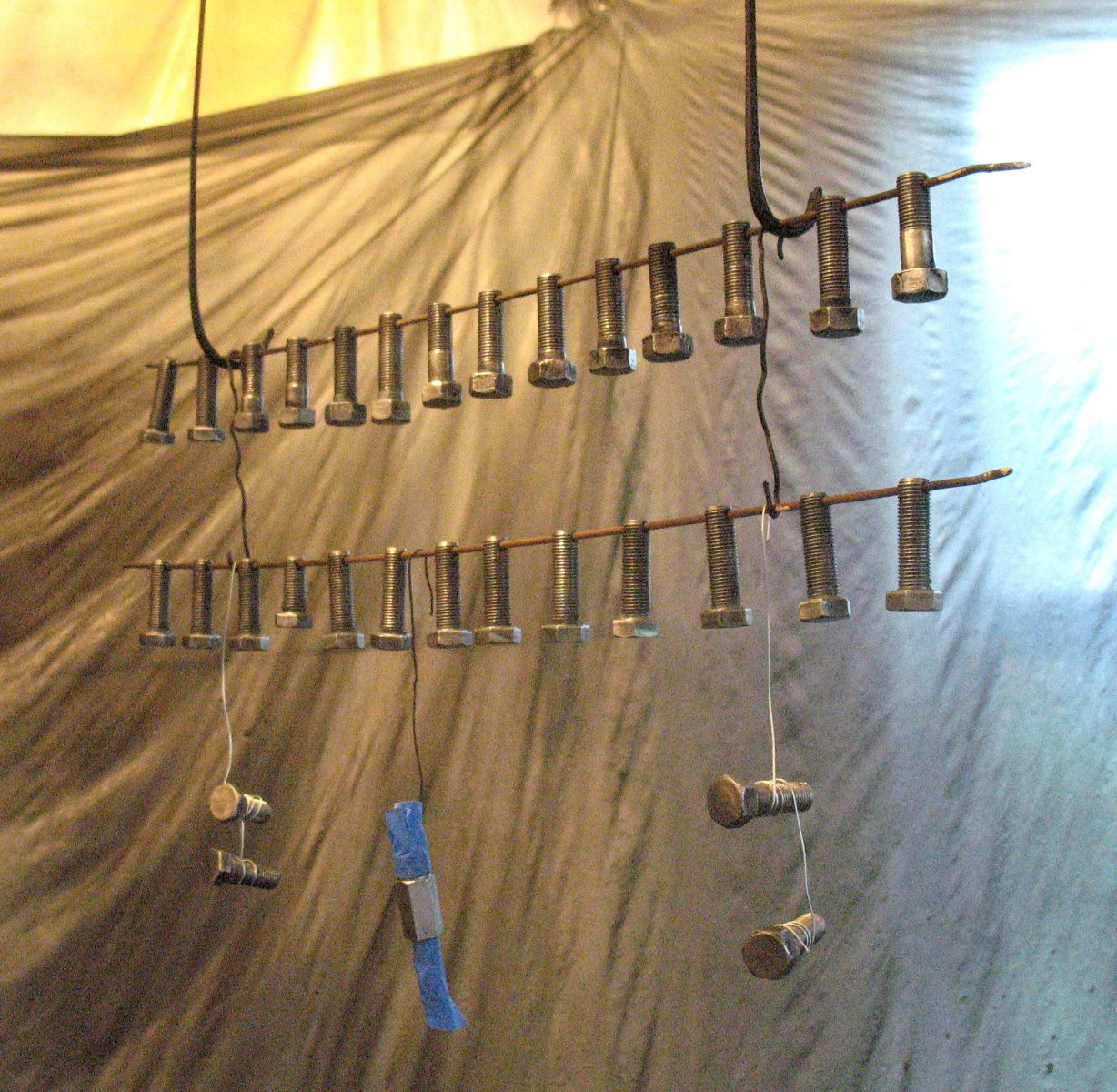

Today I got back to work on my fresh engine. Namely, painting hardware for it. This car is for go, not show, and I'm using lock washers instead of cotters on the engine. I strip off the cad plating (it won't hold paint), prep with phosphoric acid, dry, and paint. I did more than I need so I'll have some already done for the next project.
Black oxide lock washers are available and would eliminate the need to remove the plating. They aren't as easy to find as they used to be.

I wouldn't even try to find anything like that around here. Maybe when we had a real hardware store, but not now.
I hear you Steve. Perhaps my drawers of stuff I picked up over the years have given me a false sense of the market. I seldom have to go to the store. I did see several offered on line for those who do that.

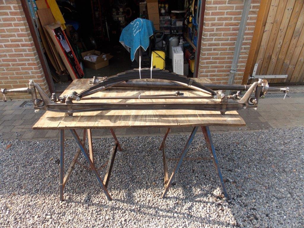

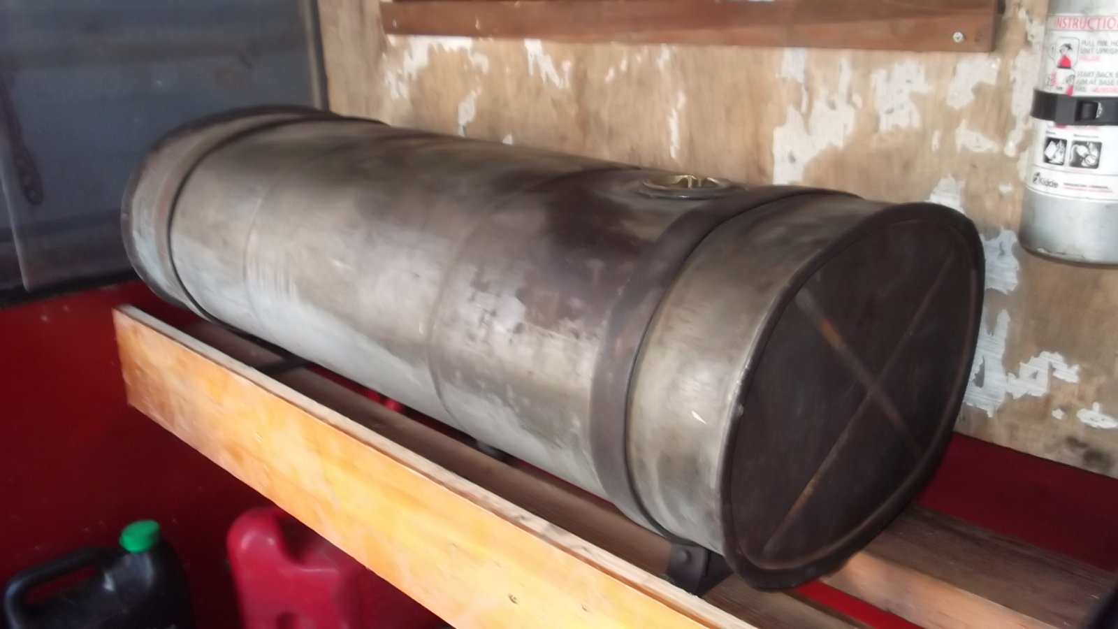

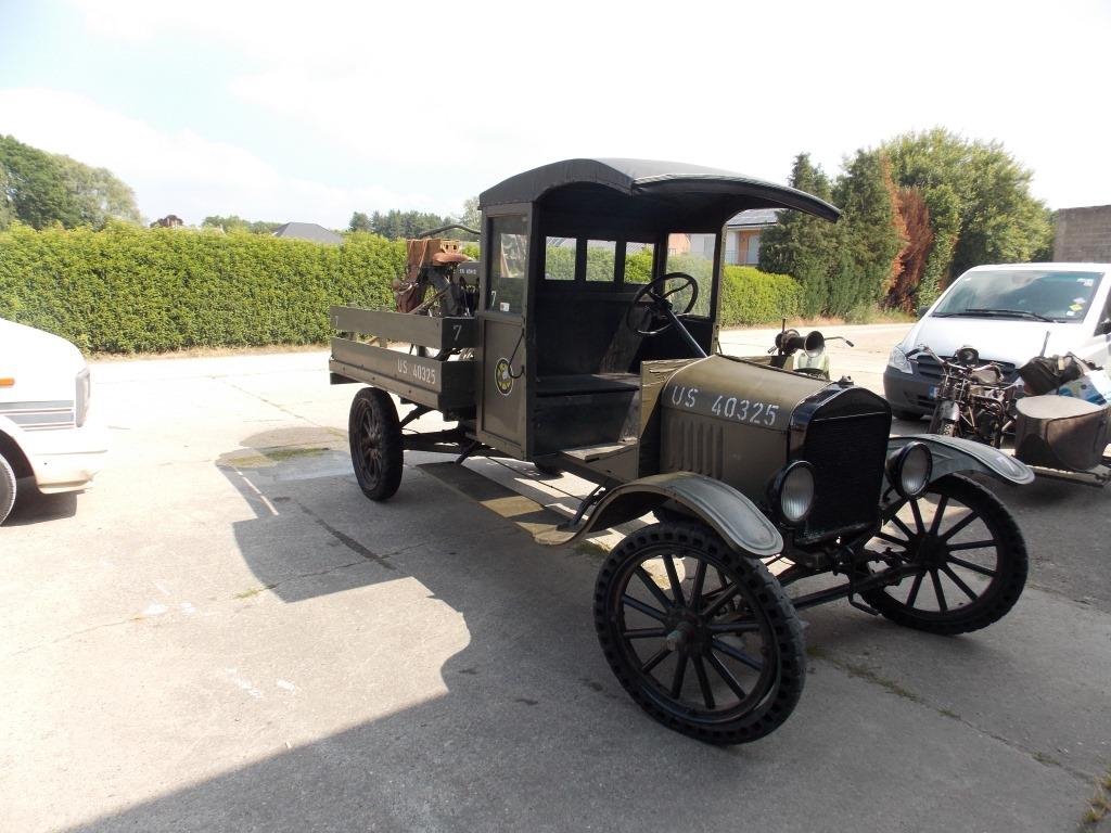

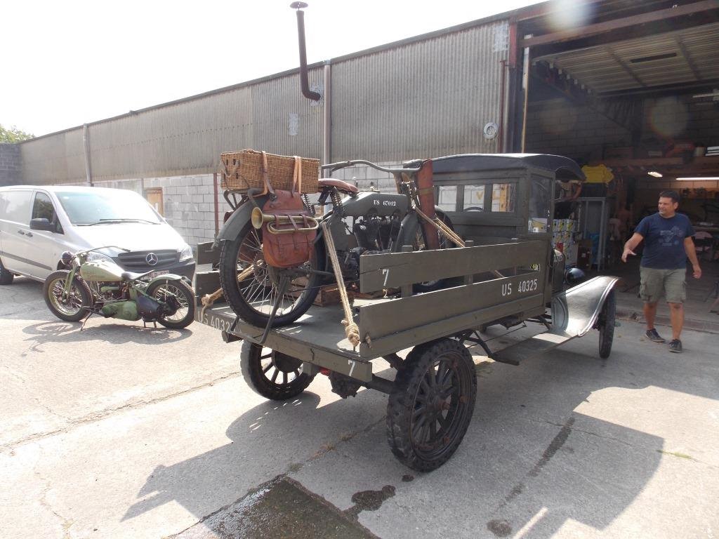

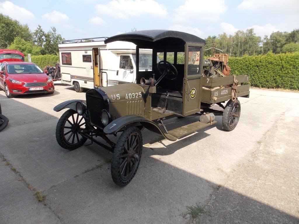

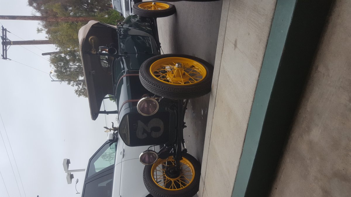

This morning I put this one "On the Road Again" after twenty or more years in storage and a complet overhaul.
There is one problem left. The four tires are plain rubber an are shot. They came nearly off the rims during the test drive.

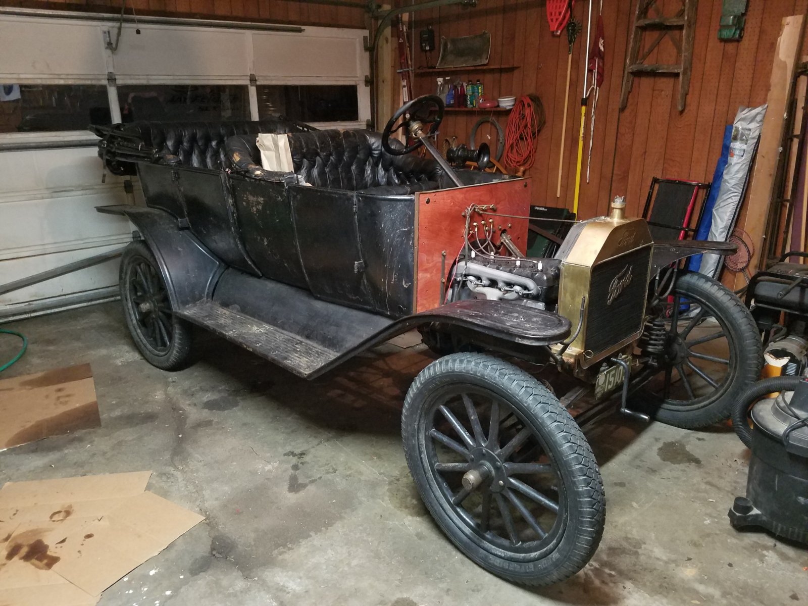

I have installed the new commutator harness. While looking at the harness that came with the car, I decided that Henry would not positioned the harness as it was on my '27. In another thread I asked if anyone knew for sure how it was originally routed? I got an answer and found that the T didn't have a very important clip. I ordered the part from Lang's and it probably will arrive today. I installed the coils and they buzz, but I won't start the engine until the new harness is properly installed. Hopefully then she will be good to go.

Andre, I love the truck. It's too bad the tires are in display-only condition.

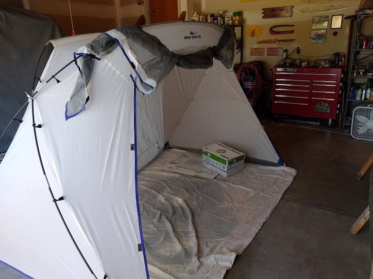

My painting-the-parts work on the runabout continues. Bake until well done.
Masking the engine for touch-up.

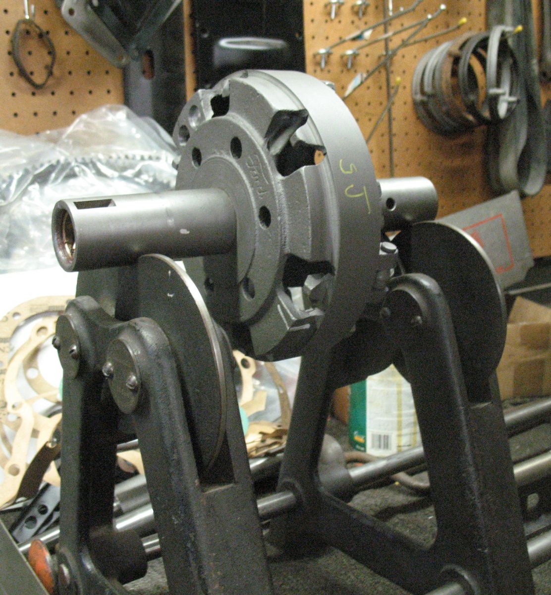

I see the previously posted pictures aren't back yet, but I'll try a new one.

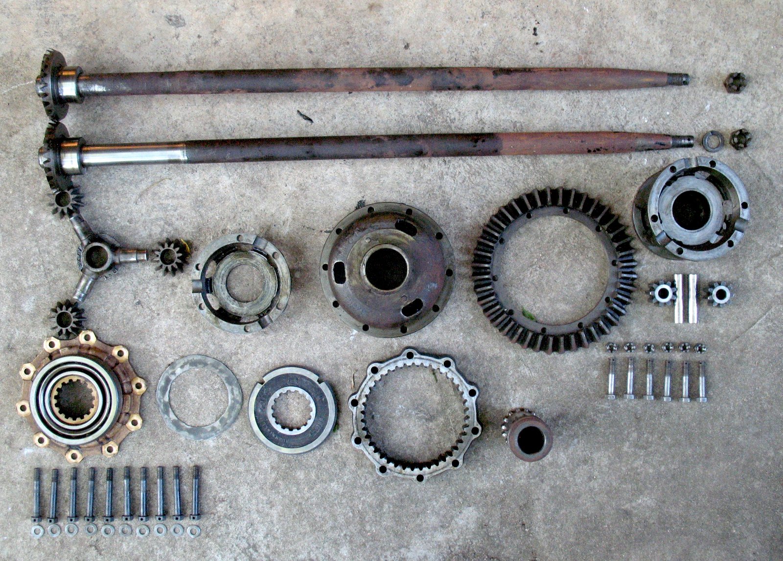

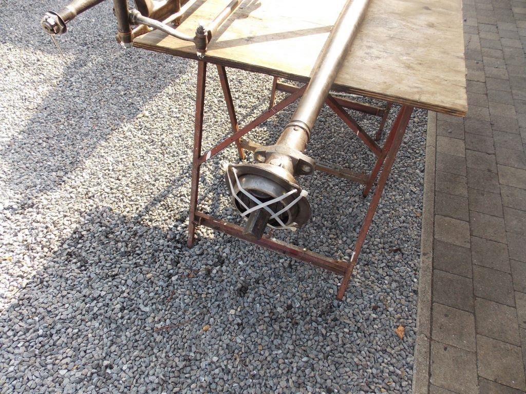

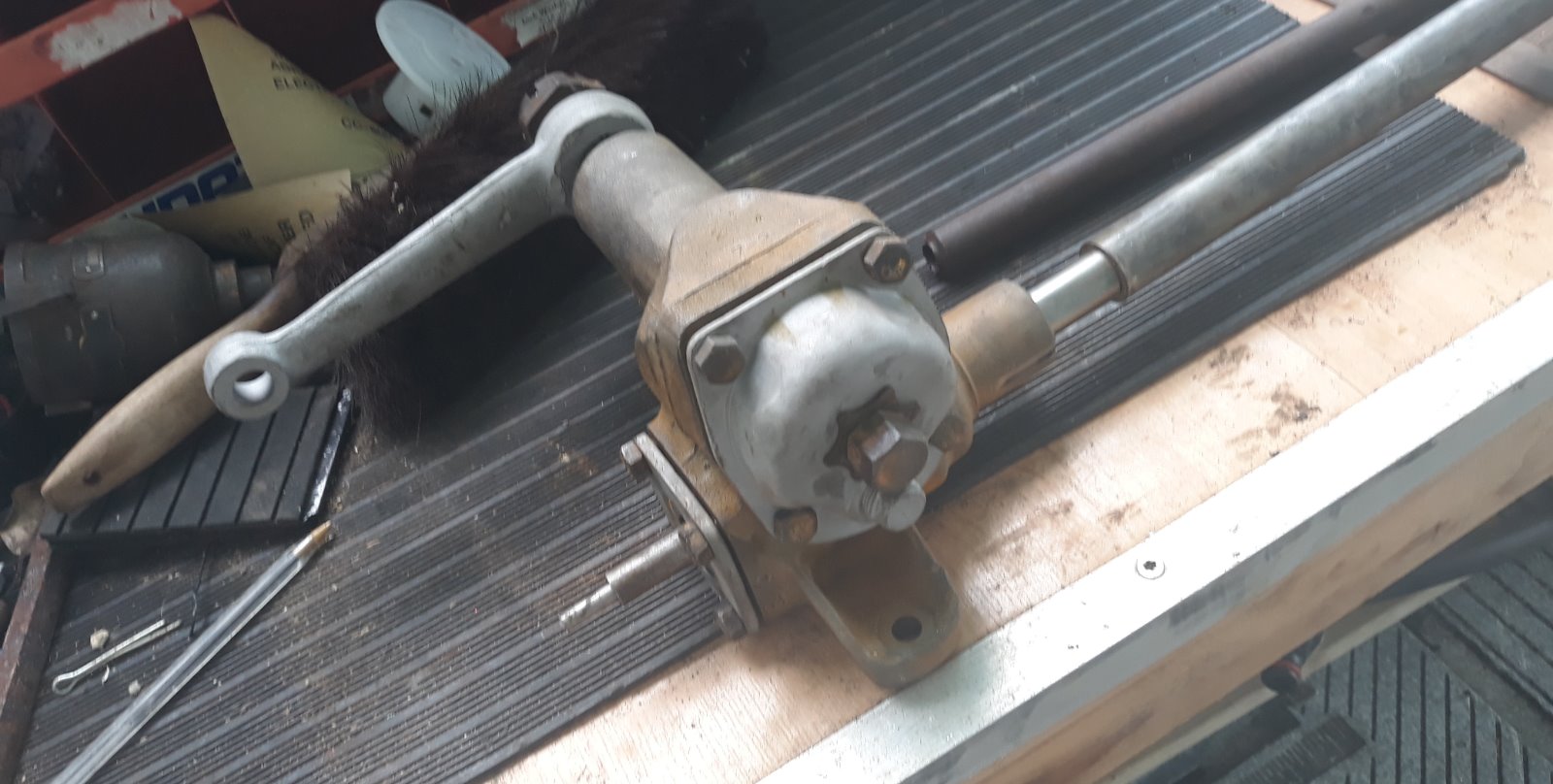

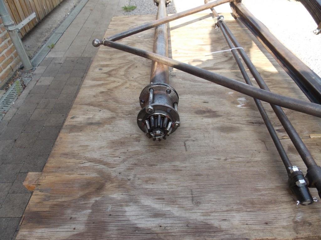

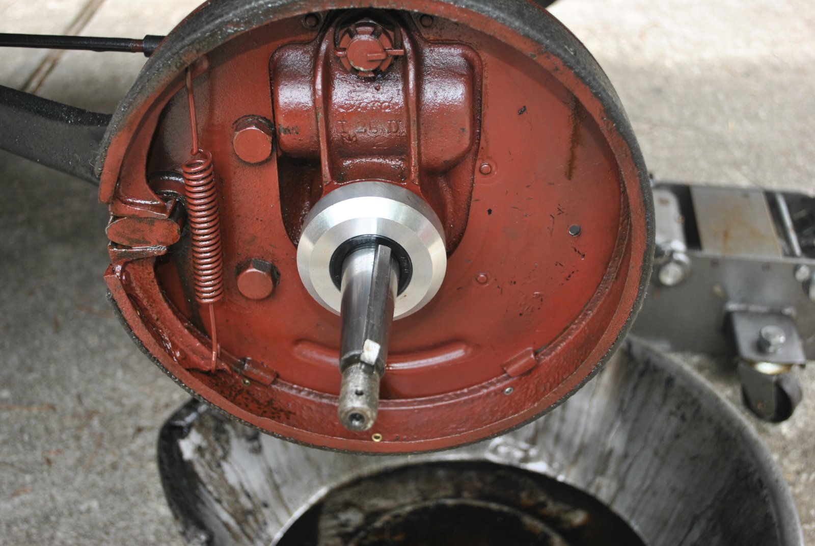

My latest project is taking apart this rear axle to see what I need to buy/replace so I can use it. Some parts have a little rust and will be enjoying a treacle bath.

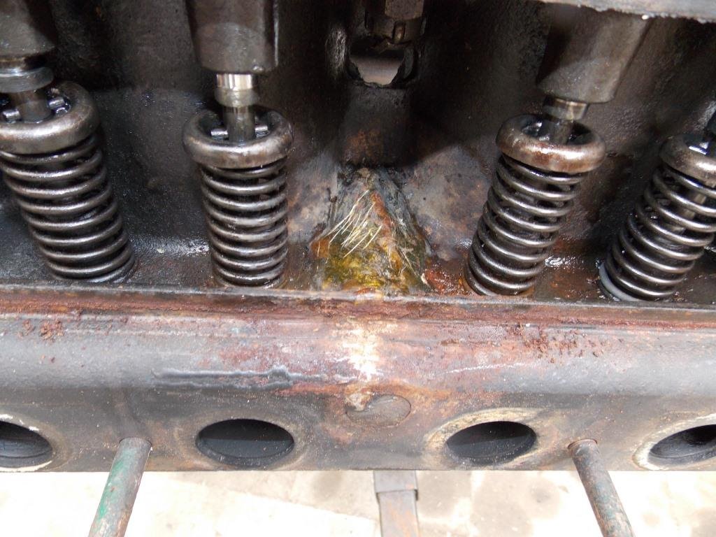

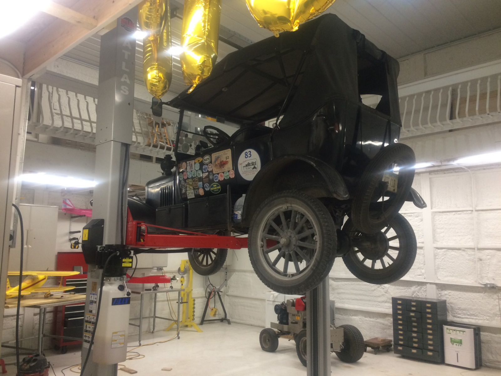

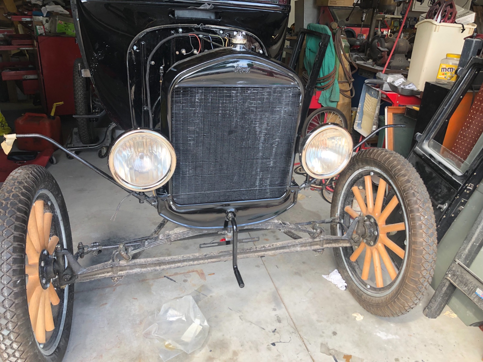

I installed my replacement engine block and turn signals.
This engine block replaced the '14 block with the leak I couldn't stop.
The turn signals use NOS Do-Ray 1129 clearance lights with heavy amber glass lenses and a good Yankee 960 turn signal switch. I like these a lot more than the plastic beehive lamps.... they're early to mid 40's era. Not 'year correct' for an '11, but I think they look good on the car.

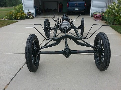

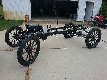

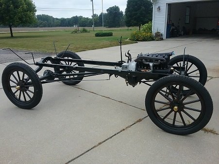

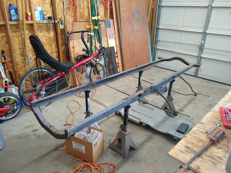

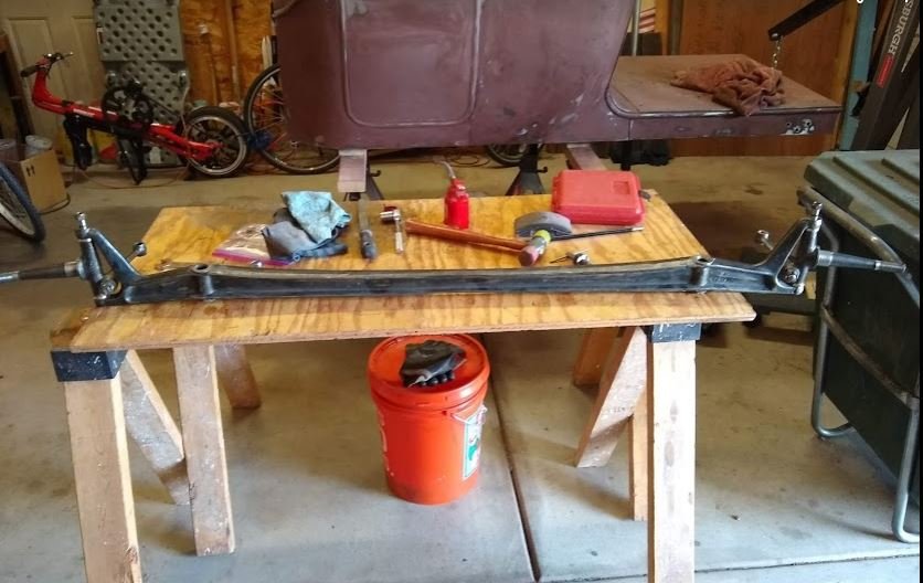

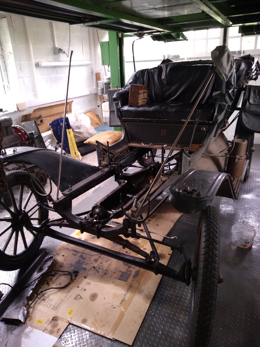

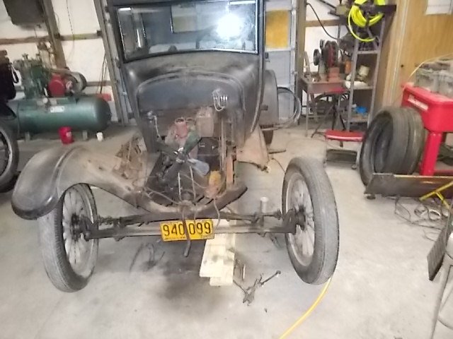

Finally got a rolling chassis on my 1910 project! After two years of replacing parts and rebuilding others, I'm starting to make some progress; my goal is to have her ready for the OCF next year.

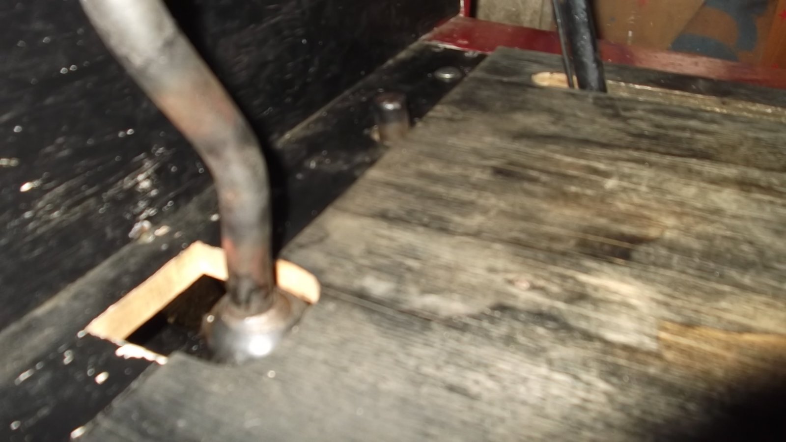

Something simple I have wanted to do for a while. My pickup bed is Oak, looks nice, and want to keep it that way, but always afraid of damaging the finish. I was driving by Tractor Supply and saw these rubber work mats out front. They had one that was 36" x 48", which was almost perfect (my inside dimensions ar 33.5" x 50").
I trimmed 3" off the long side to make it 33" x 48" and put it in. It has a little more weight than I would have liked, but it won't blow out from regular driving and at 1/2" thick, I could darn near just toss stuff in there with wild abandon.

This is probably the least exciting post here. I spent a good part of the afternoon laying on a creeper wiping off the underside of my old '13 from the last two tours. Then I came in for a beer!

Since my last posting this month, I've finally finished removing the paint from the last of the 15 runabout. The lamps were the last pieces. I also finished up the minor body work needed on the tub.
This weekend I also finished fitting my re-bushed spindle arms into the front axle. The specialty tools needed to do the bushing installation and reaming are expensive, but they really work.
My goal for the last 10 days of the month is to get all the body parts final primed, sanded and ready for paint.
Neal
Neal

At the risk of someone telling me I did it all wrong, I built a drill jig for repairing head bolt holes. I am building a similar one that fits the Heli Coil tap so the holes are straight when finished.

Chad
Your not wrong...your'e being careful...good for you...as an FYI, the head is drilled the same size as the heli-coil-sized tap drill...I use that for alignment.
You're wise to use a pilot to ensure square tapped holes

Another "Gary Tillstrom bendix oiler" made and painted. Getting ready to install on my T doodlebug when I install the starter. Hand cranking is cool, until it is 0 degrees outside at the Snowmobile meet. Some club members took pity on me and rebuilt a starter for me.
I made one of these for my '25 pickup a few years ago.

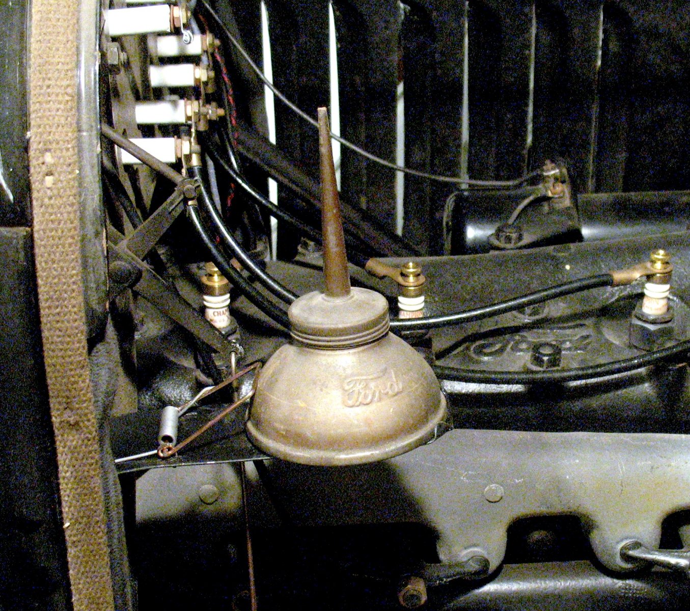

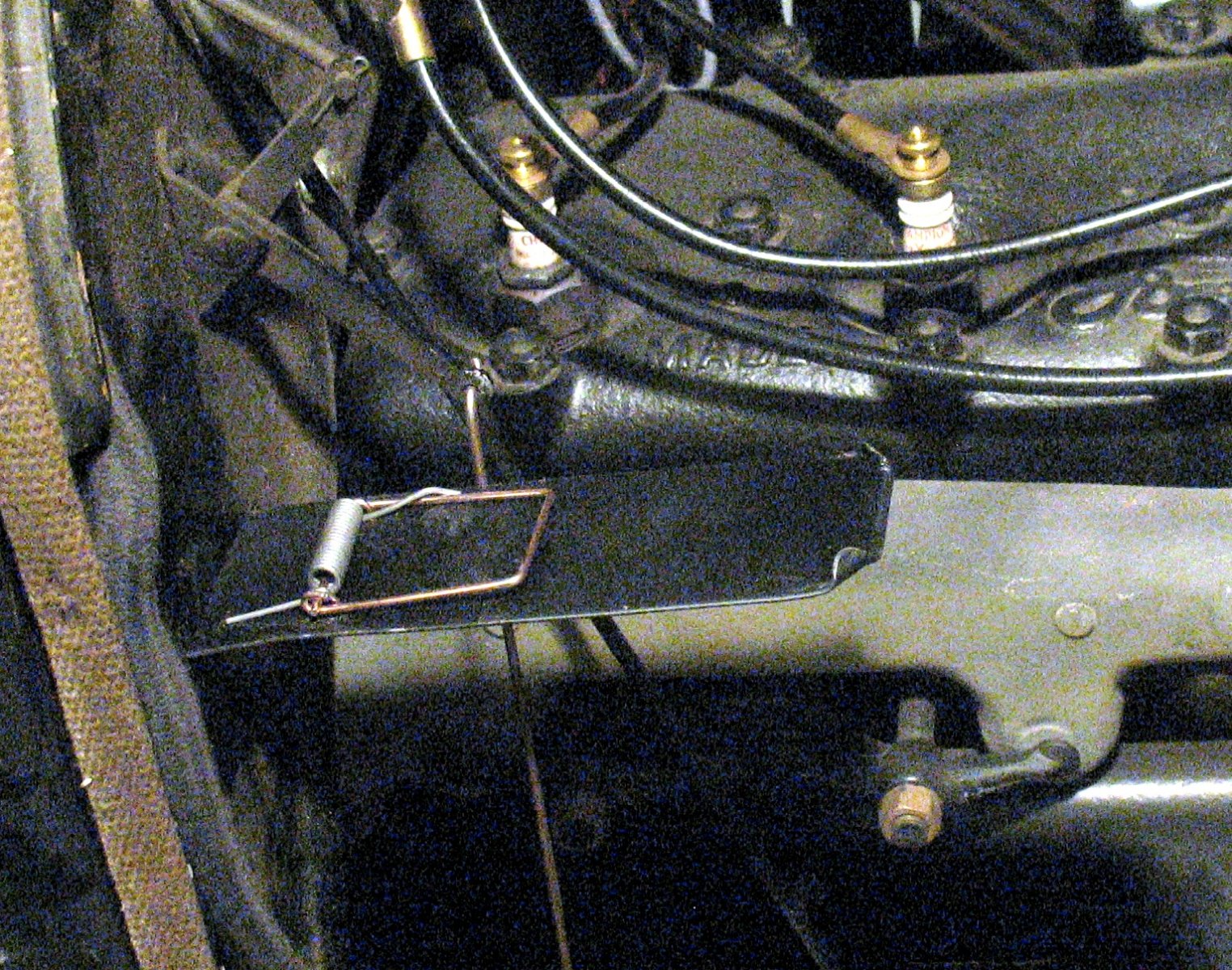

Today I finished up the little aftermarket accessory I started yesterday.
It starts with a 2" x 8" piece of 18 gauge sheet metal and a mouse trap.
Do some drilling, bending, painting, prying, more bending, and stick it on your firewall...
...and you have a place for your oil can to sit.

Yesterday I finished the rebuild of a front axle and a drive shaft (both need some paint)
Next it will be the rear axle and finishing the assembly of the engine with the burning magneto.
All for the same French Model T that came out of the "Den Hartog" sale in the Netherlands last year.
Andre
Belgium
a fine idea simple and easy to do.
Andre
Belgium

Andre, are those custom spindles on the axle or are they for the lower European cars mentioned in this thread below?
https://www.mtfca.com/phpBB3/viewtopic.php?f=2&t=541

I began building it. A month or so ago, I sold the '21 RPU which I have had for several years, so I need to build another. This one will be a '15 RPU.

David and Mark,
The parts on my photos came from a 1923 French Model T that was for sale last year in the "Den Hartog " museum In the Netherlands.
It is the second car from that sale I try to set on the road again. The first one was the Army Truck (photos earlier in this July post).
This car had an after production motor bloc, number 1,511,... With two bolt holes in the back of the engine where the transmission ears were bolt in.
Un fortunately the block had a crack from one side to the other at the water inlet.
André

Drove into town with my wife for supper. Spent 15 minutes or more in the parking lot telling about the truck and watching people enjoy it. Stopped at our Amish neighbors on the way home and got some eggs. What a great drive.

On the way home from breakfast I snapped a photo. Theres more than corn in Indiana! Just not here.

Disassembled front wheel to re-spoke, after staining new spokes to match. Turns out, the fellow I had, required 1/32" longer spokes.
. Four a standard Ford fellow, and waiting for it to get sandblasted. Somewhat local T guy is bringing me a spare wheel, so I can get Frank back on the road in the interim.
Dallas... Sure like that multi-use body/bed ya got there! I sent you a PM re: your Amish passengers from a week or so ago...
(Edit) ... Not sure why the first image double posted. I deleted the 2nd HTML code. ??
Also bottom pic... 2 spokes are 95 years old, 2 of the new set, stained to match. I wasn't about to give them up just to match my od fellow, hense the search for a Ford rim!

Crank that we're grinding for a 1927 Model T.

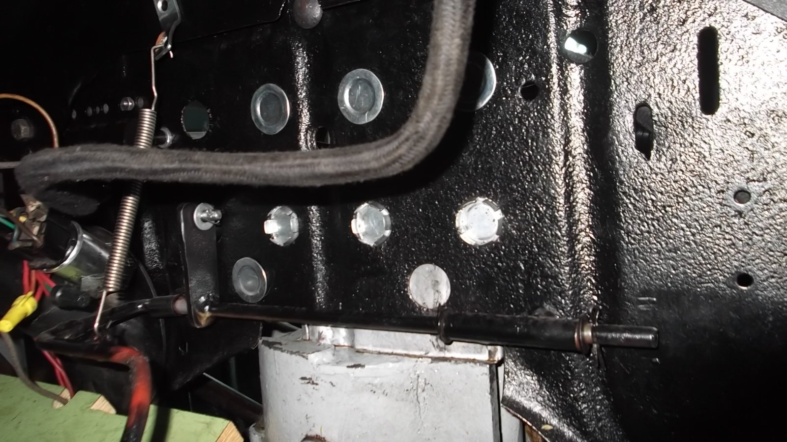

I got the commutator harness properly located and clipped in place, then it was time for a road test of the rebuilt coils and the new harness. The old girl ran just about the best that it ever has. The coils that I sent to Ron were not factory coils; the ones that I got back were original-style Ford-script units.
I'm going to have to get used to a very different buzzing sound! I won't do anything else to the T this month, the next project involves my Dodge Magnum RT.

Duey, you just have a thing for TT's!
I had to change oil in it as I have over 100 miles on the new engine. It needs a bath to. Cant wash it if your driving it!
