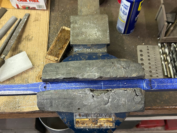

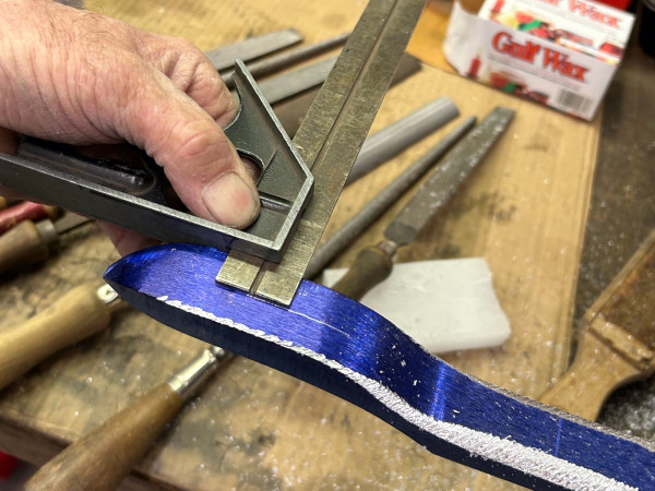

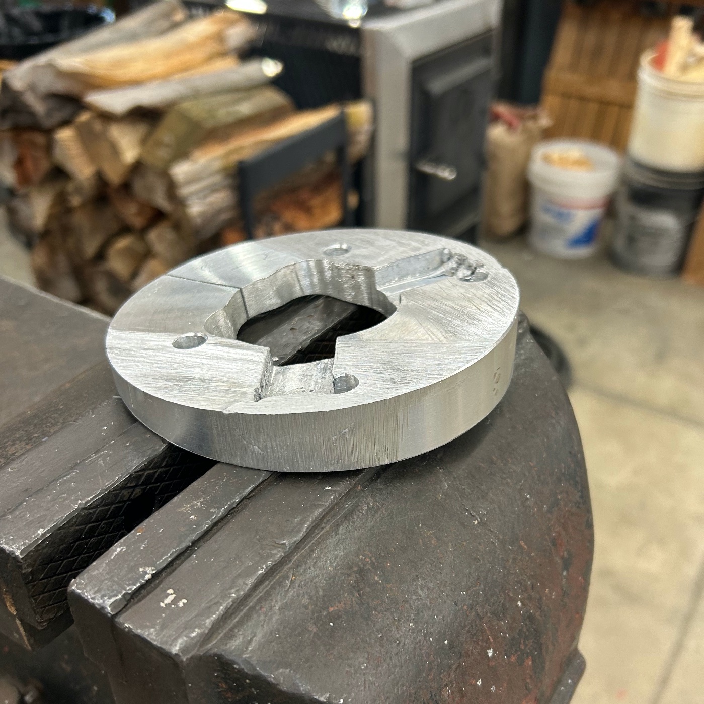

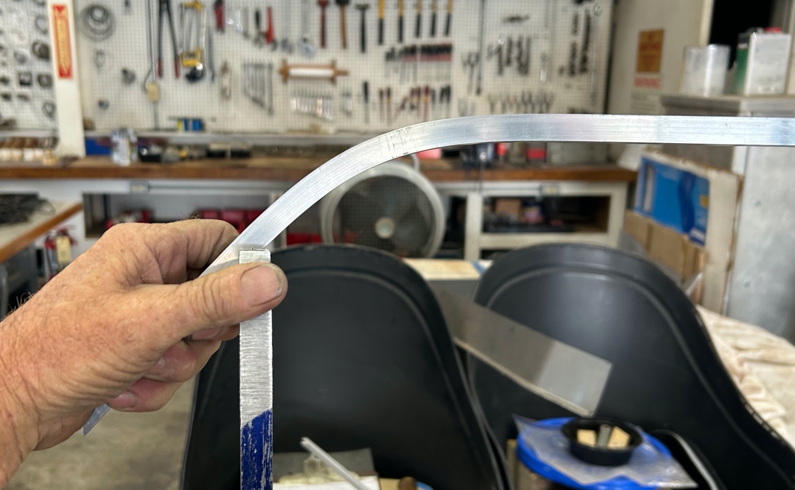

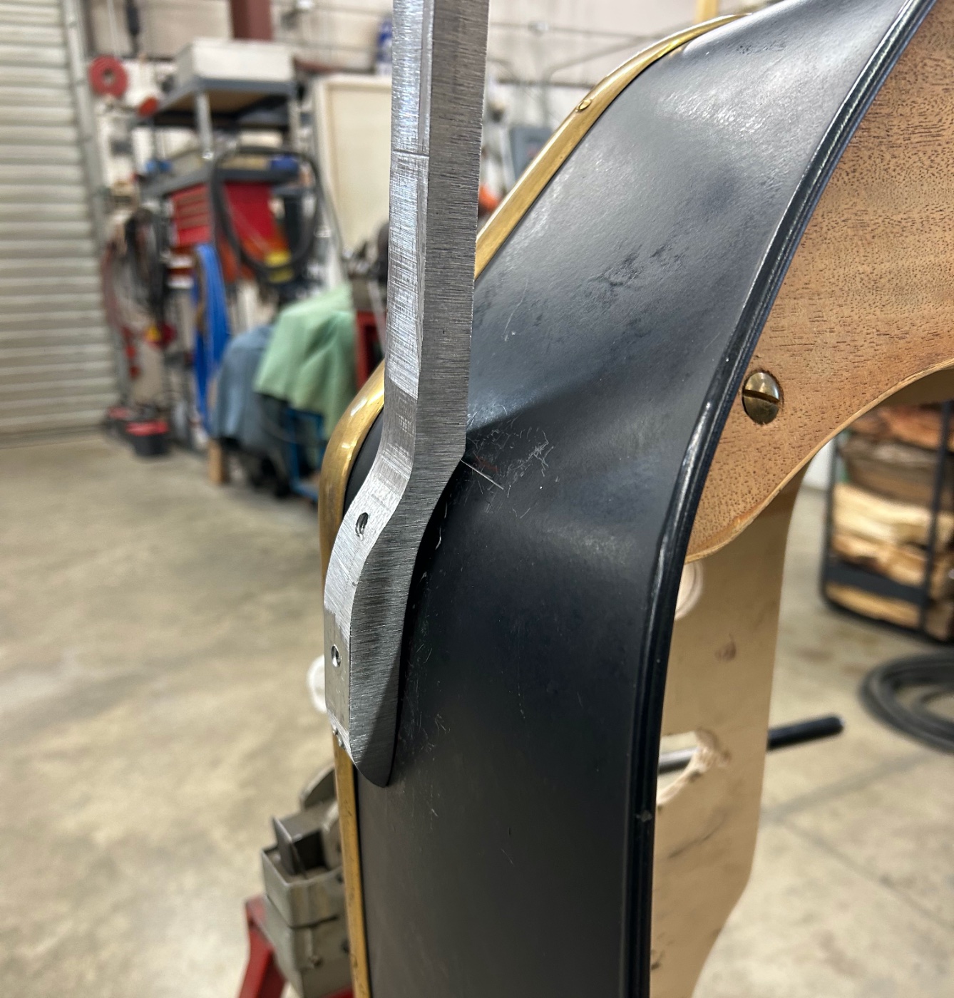

From years back.., keeping my word to assist in the parts that do not exist. Installing a Vega Steering Box, High angle wedge for the column drop, and custom billet aluminum windshield stanchions. Posting this to show others how to do it. The key in making these, you must use a variable speed metal capable band saw at half speed, canning wax as a lubricant, and patience.

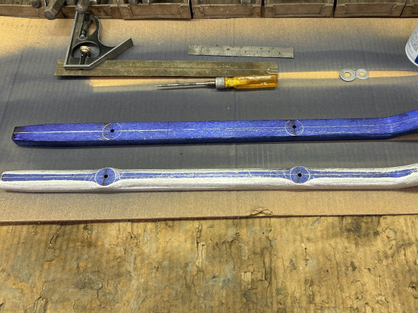

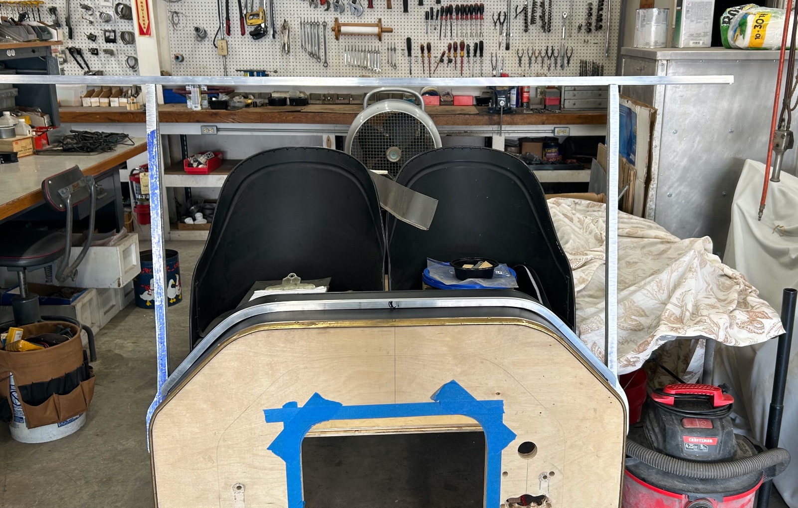

Well finally finished up the truing of the billet on a vertical belt sander using 40 grit. I drill completely thru the stanchions and then TIG up the holes for a full depth thread.., old school. Now making windshield/wind-wing templets and setting the style as we agree on the final design. Next will post pictures on how to carve the billet the easy way.
Stay tuned for more magic.

Is the aluminum piece on the cowl, tube or solid?

Billet T6061 aluminum (solid).

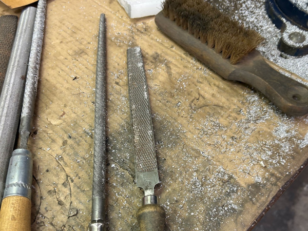

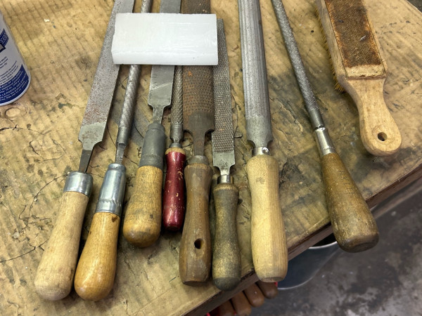

The key in a good job is quality material, T6061 billet, good files and rasp. When ever you are working any soft material use canners wax by means of rubbing your file. They never plug and clean up easy. Watch your pressure when cutting on the strokes. I use lay out dye for a good contrast.

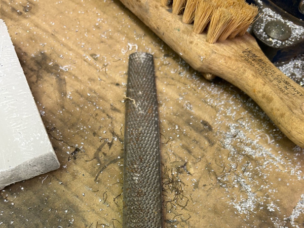

I have been using the same files for over 12 years. After 2 cups of coffee this morning.., one is in the rough.

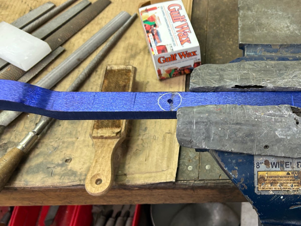

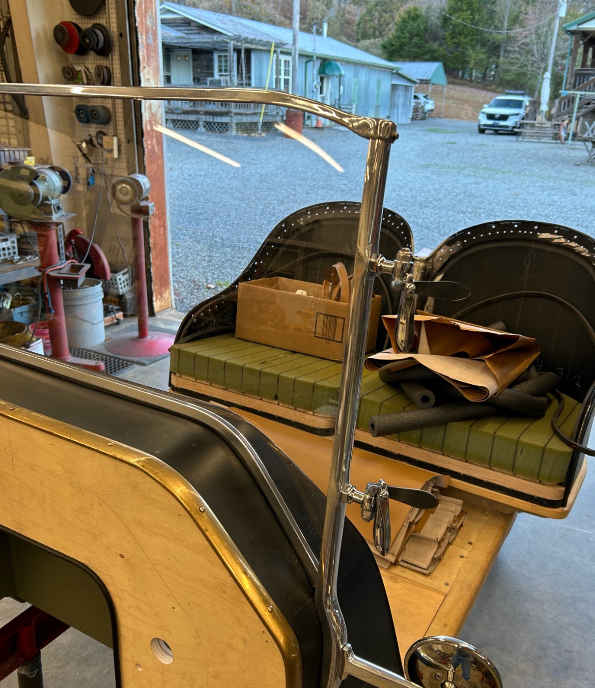

Well both frames are in shape today. Did some shopping for peep mirror mounts and they all look like flimsy crap...., Soooo I started making dagger style.

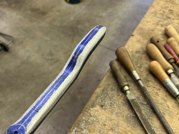

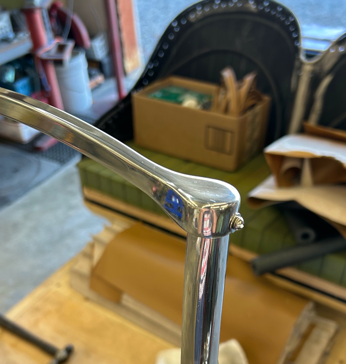

So after all the rough in with a rasp file, I come back with a conventional double bastard and then down to a single bastard file. Then I start with 80 grit, 120 grit, 240 grit, 320 grit all dry. As you can see depending on the cloth wheel weave and jewelers rouge used will determine your sheen. We are going for a German Nickel appearance. Pretty close!

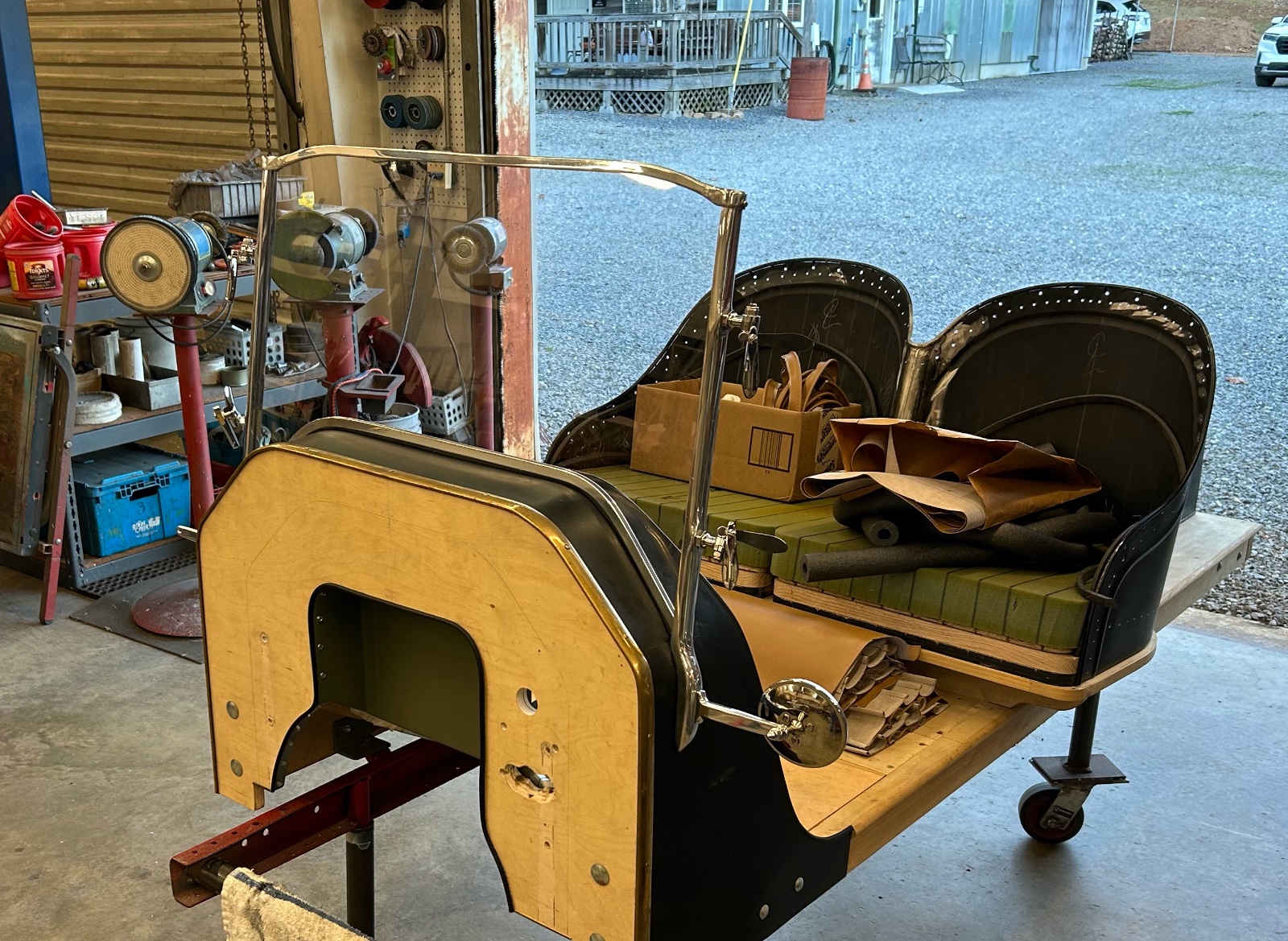

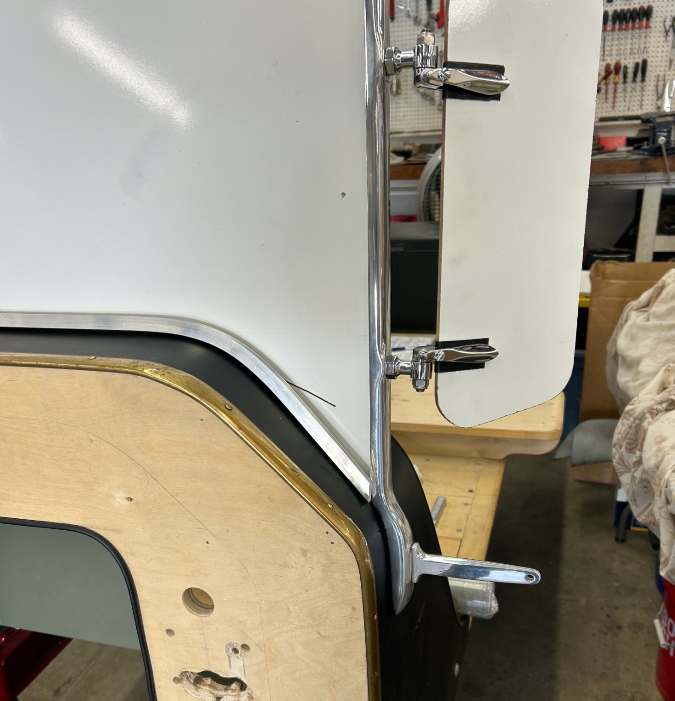

All what is left for the windshield is upper and lower channels with retainers/cut and polish the glass. Started the pull back pleated seat wrap for back and cushions.

All what is left is polishing the edges of the wing wings and it is ready for collection. Will be back after painting to install the upholstery.
