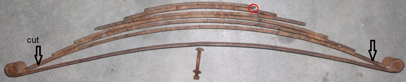

I took two leaves out of the back spring on my speedster, the ones with just the one bend at the top so there was no problems with the nesting of the rest. I replaced them both, because the car rode like a sloppy jalopy, flopping around like crazy.

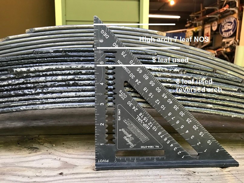

Re-arching the front spring gives about 1" drop, 1926-27 spindles about 3/4 in, a drop front axles vary so what's yours? A 1926-27 front spring has a lower arch. So answer you question about how man leaves - you need to do some calculations based on what you are using or using some other parts. Removing leaves adds another issue for the front spring clip to hold the spring leaves in position within the cross member.
Since you re-arched then yo need to trim the ends of the leaf above the main https://www.mtfca.com/discus/messages/8 ... 1261098993 --

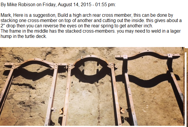

This is a good discussion on various ways to lower the rear.
https://www.mtfca.com/discus/messages/5 ... 1439594997

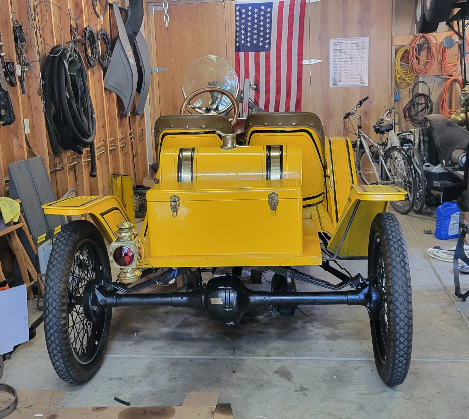

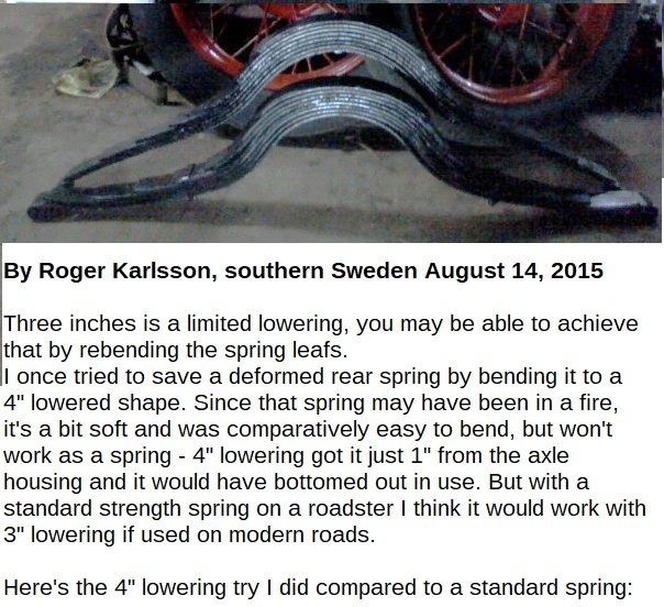

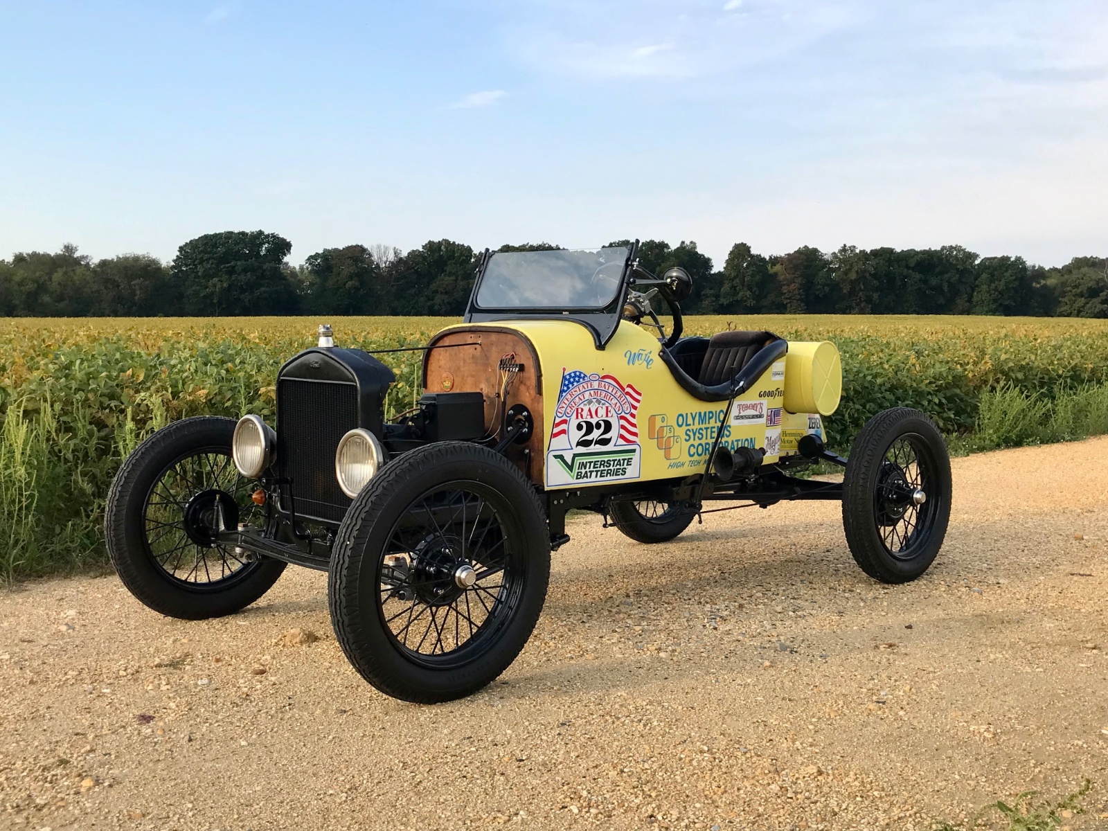

If you bend a leaf spring as shown on the rear of the yellow car above, the bent leaves cannot slide on one another. For that reason, I would not use this method.

I would not remove ANY leaves. I did that with my Speedster and nearly got in a bad accident. The reduced leaf rear spring caused the rear end to hop violently as I hit a small bump while braking. The car came around sideways and only missed hitting a Ford Mustang, (who had cut me off btw
), due the Mustang driver seeing this odd, yellow car side-hopping its way towards him. He nailed the gas and got out of my way. After that, I put both springs back to stock design.

Because of the multiple bends in most of the rear spring leaves, you can only remove those on top that have.just the one bend. Taking out other leavs will upset the stack, and compromise how the spring works.

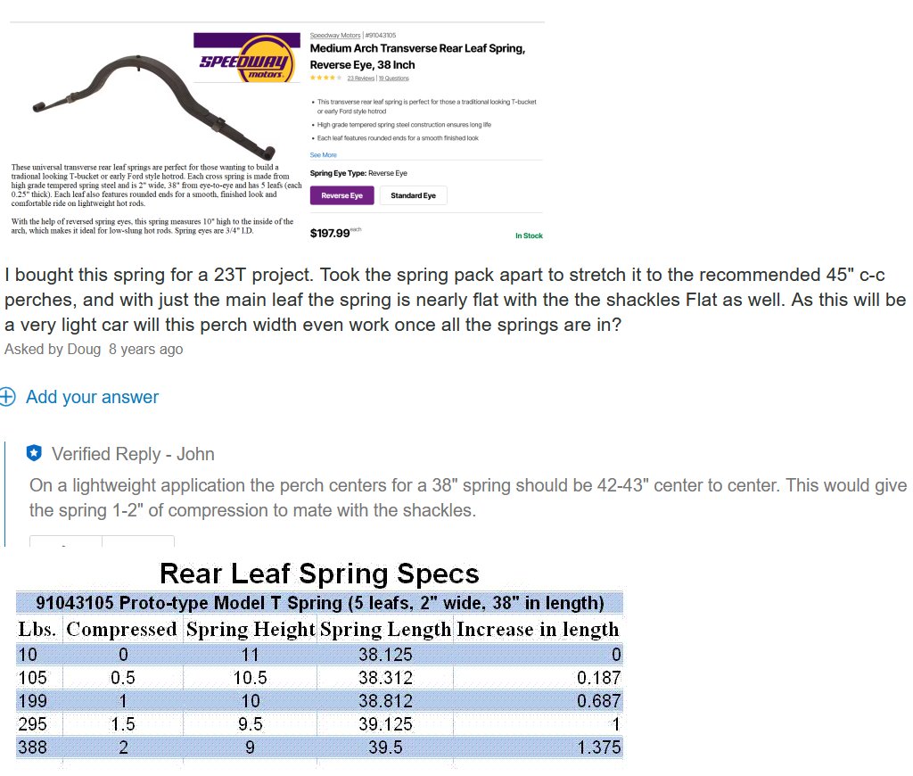

You will have to have the eyes of your existing rear main lief inverted by revering the arch. No one is doing Model T' springs anymore.
This may be a long shot, but Speedway has a medium arch 2in reverse eye spring. the arch is 10" (note the spec say 11") but should give a 1" drop if it works. You may need to ask them for your application. The price for the entire spring is about what a single main lief would cost & they ship free. You would need to make up the difference in thickness in fitting & clamping in the rear cross member

I picked up one of the Speedway springs @ a swap meet hoping it would work! Found it to be about 5" to short. It is designed to be used with
the weld on spring mounts on a modern rear end.

If the " V" Involves 2 or more leaves, it will lock them together, making the spring very stiff. It also concentrates road forces at the V point, instead of the forces being applied along the free length of the spring. I would not use that method to lower a car.

No doubt the V is a result of some help with heat. I wonder if anything has ever been done to re-temper/ re-rate those modifications?
- Posts: 8705
Re: How many spring leaves??
The V bends are made using heat. It's a very poor practice for several reasons. As previously mentioned, if the bend involves 2 or more leaves, it will jam the leaves and prevent them sliding on one another, which they must do for the spring to flex. Another issue is the right angle or near right angle bend in the leaf or leaves. You will NEVER see any such thing in any stock leaf spring. Besides the jamming/locking issue, the sharp bend concentrates forces at the bend. The jamming effect aggravates this. Leaf springs are made the way they are for good reasons. There are ways to modify a leaf spring without destroying its function and creating hazards.
