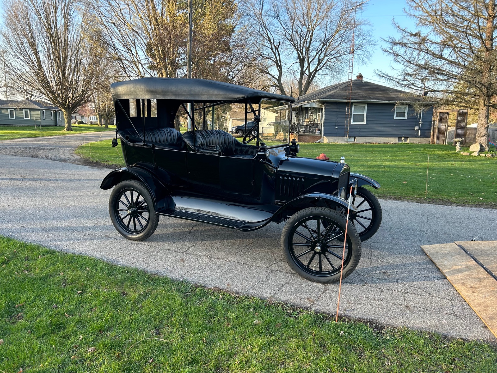

Here is a late 17 model probably and 18 model year. This is for reference only.
Posts: 4380
Re: 1917 model t
Post by Wayne Sheldon » Thu Oct 30, 2025 5:36 am
Mark E, I don't know whos car that is? However, it is beautiful, and from what can be seen in that photo a very right looking 1917/'18. It appears to have the proper non-demountable "rounded" felloe wheels (changed somewhere around 1918 to the "square felloe" wheels. I couldn't be sure whether the top sockets were the earlier oval type or the later square type. That is another detail that changed "around" 1918. I suspect that both the wheels and the top had a longer than usual crossover time than most changes. But that is a factor that is still being debated.
I also couldn't tell if it has the earlier or later style horn button (and companion light switches?)?

Post by Model T Mark » Thu Oct 30, 2025 8:15 am
It my sons has the combo horn switch and the rectangular sockets. It has a dec of 17 casting date. It was last year’s stynoski winner. It was from Texas and was a car that had been burned in a barn fire.
