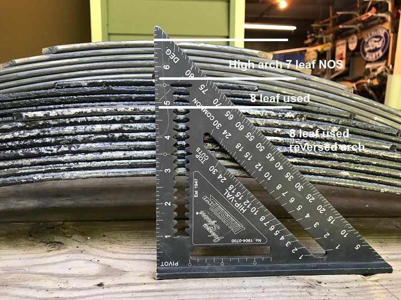

The front end drop for a speedsters is between 4-7 inches. That determination is how much clearance is needed for the oil pan or sump.frontyboy wrote: ↑Thu Oct 30, 2025 12:12 amBuilding a 1914 speedster with a brass vee radiator and a dropped front axle. How many leaves can you remove from the front spring and still be safe? The bottom spring leave has been dearched some not sure how much..
For the rear spring how many leaves can be removed safely to lower the frame without Zeeing or cutting the frame. I'm using a 13/14 riveted rear end.
Any thoughts would be appreciated.
tnx
frontyboy
Re-arching the front spring gives about 1" drop, 1926-27 spindles about 3/4 in, a drop front axles vary so what's yours? A 1926-27 front spring has a lower arch. So answer you question about how man leaves - you need to do some calculations based on what you are using or using some other parts. Removing leaves adds another issue for the front spring clip to hold the spring leaves in position within the cross member.

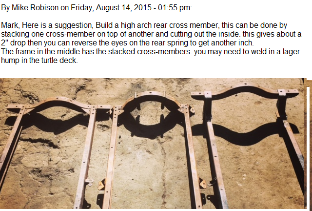

This is a good discussion on various ways to lower the rear.
https://www.mtfca.com/discus/messages/5 ... 1439594997

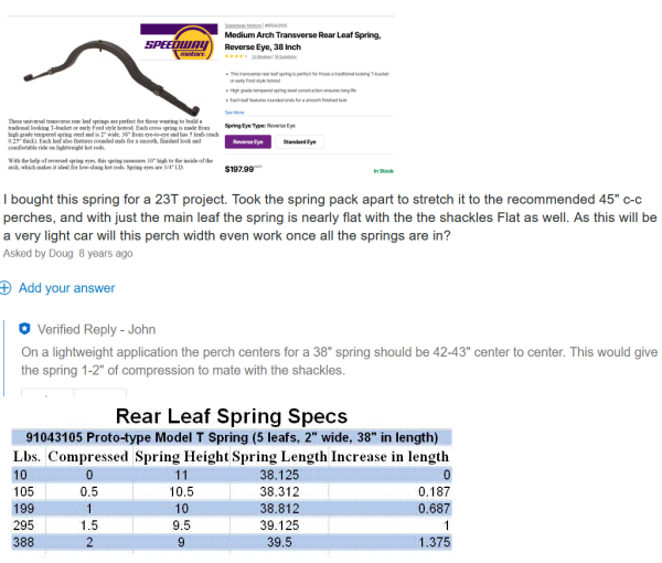

You will have to have the eyes of your existing rear main lief inverted by revering the arch. No one is doing Model T' springs anymore.
This may be a long shot, but Speedway has a medium arch 2in reverse eye spring. the arch is 10" (note the spec say 11") but should give a 1" drop if it works. You may need to ask them for your application. The price for the entire spring is about what a single main lief would cost & they ship free. You would need to make up the difference in thickness in fitting & clamping in the rear cross member
