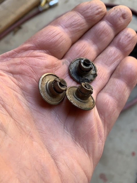

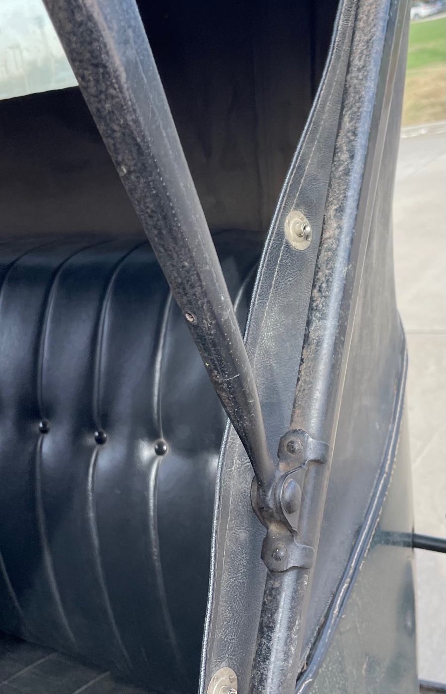

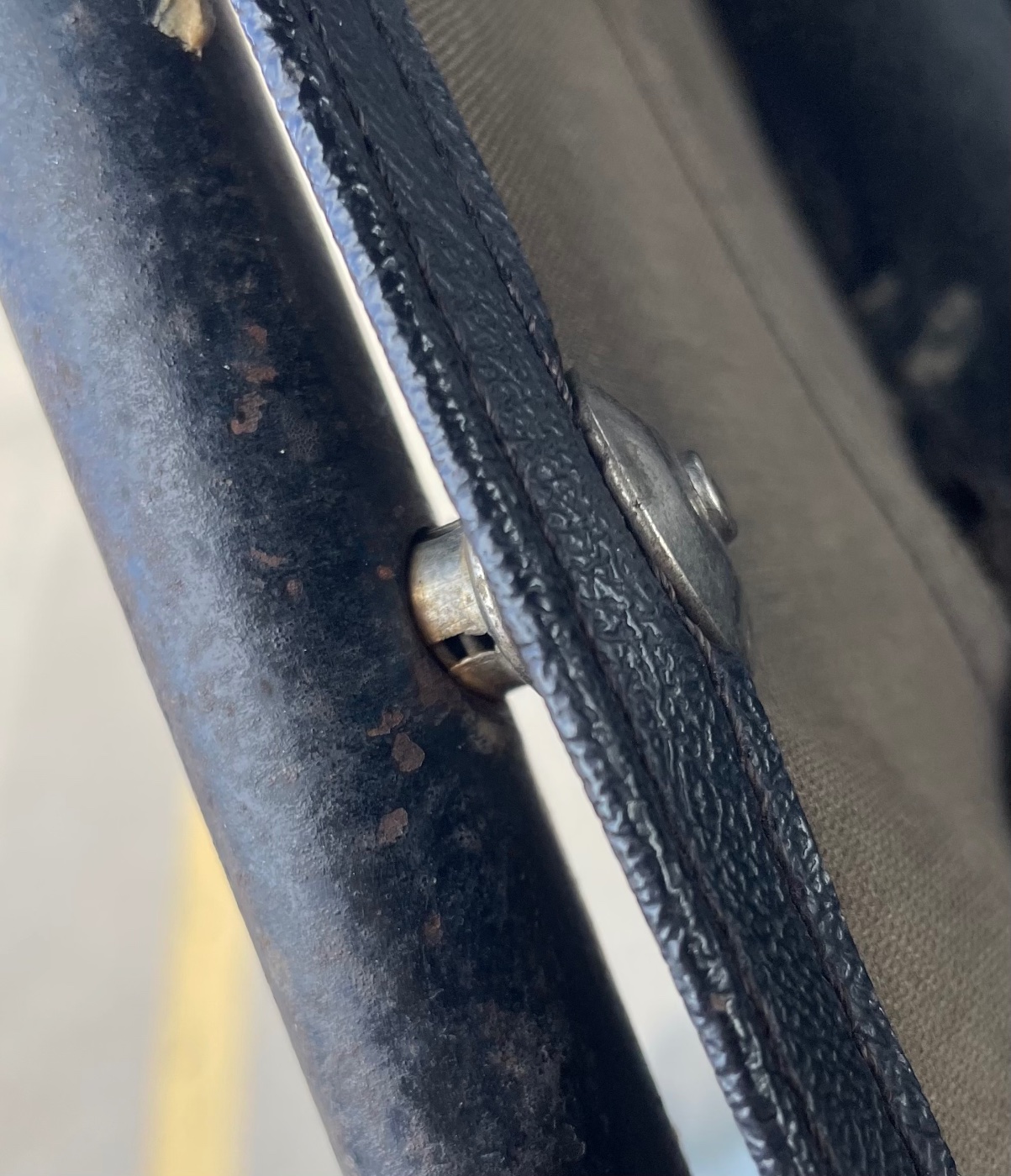

I’m missing a few of the inserts for these top snaps that go into the rear top bow on my touring. Any idea on what these are called and where to get replacements?

This is the correct fastener for the Improved cars (26-27).
If you're looking for the "receiving" part (socket), then this will work: https://www.modeltford.com/item/SNAP-R.aspx.
The problem is that this part does not allow for the thickness of the side curtains, so the fastener on the top won't close properly into the socket if side curtains are used.
The original socket has an extension to hold the fastener outward, the same thickness as the side curtain fabric so the fastener will close properly. I don't know where the original type socket can be had. If anyone has a couple, I need them :)

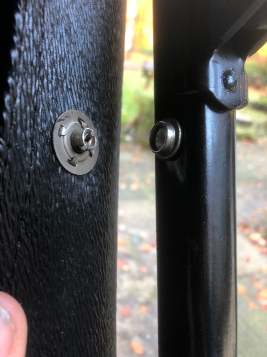

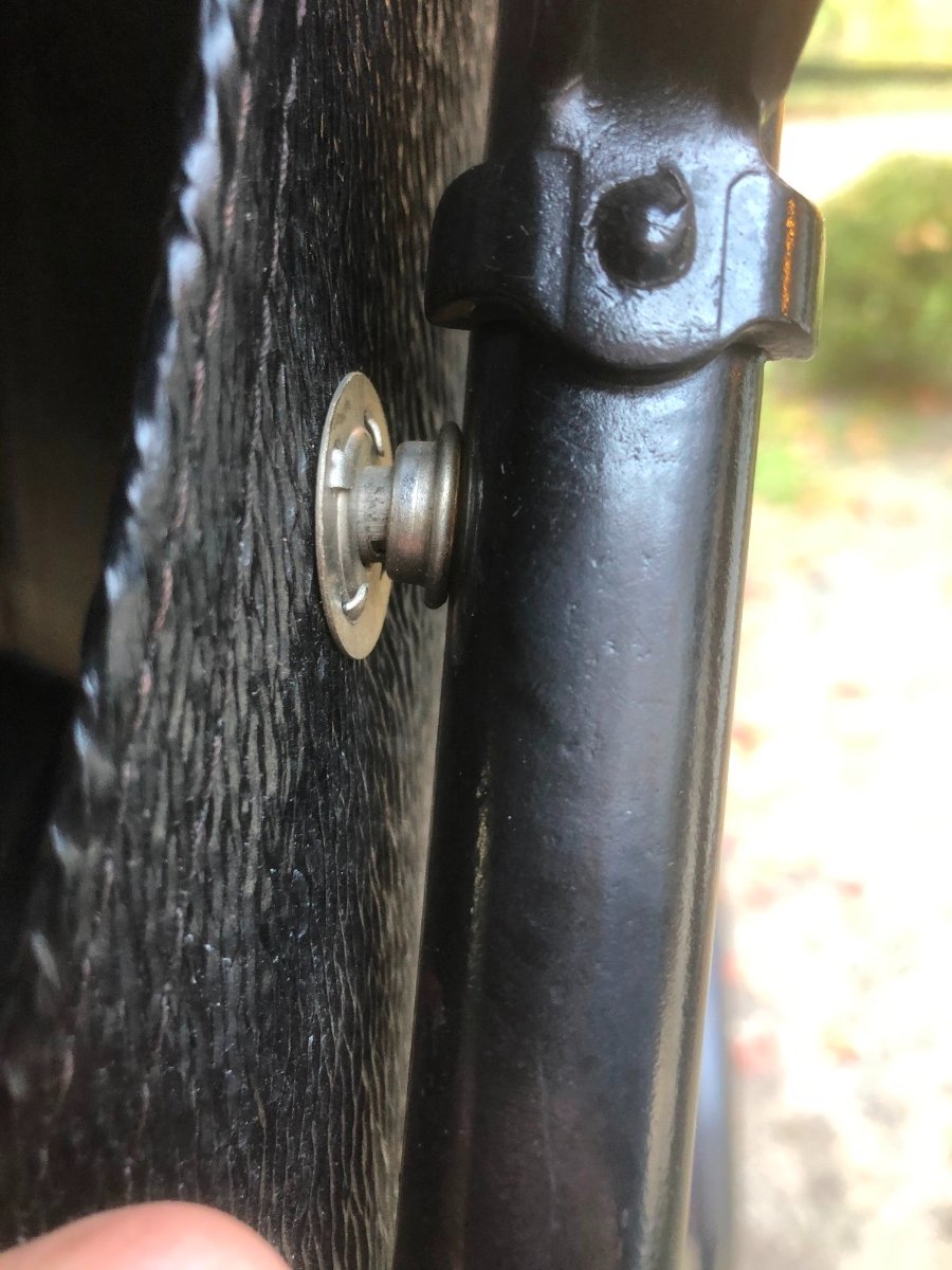

Here is the fastener. In the closed position, you can see the area that the side curtain would occupy.
If you need the "male" fastener, Mike at Classtique sells them. The first one with the ring requires a special tool for installation which he also sells.

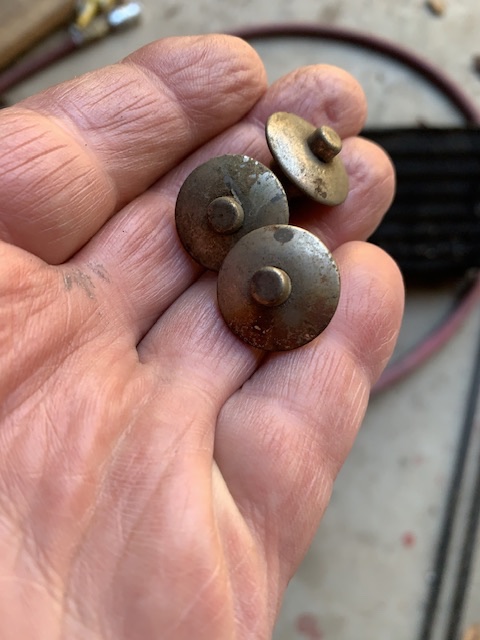

Found these in some of my stuff.

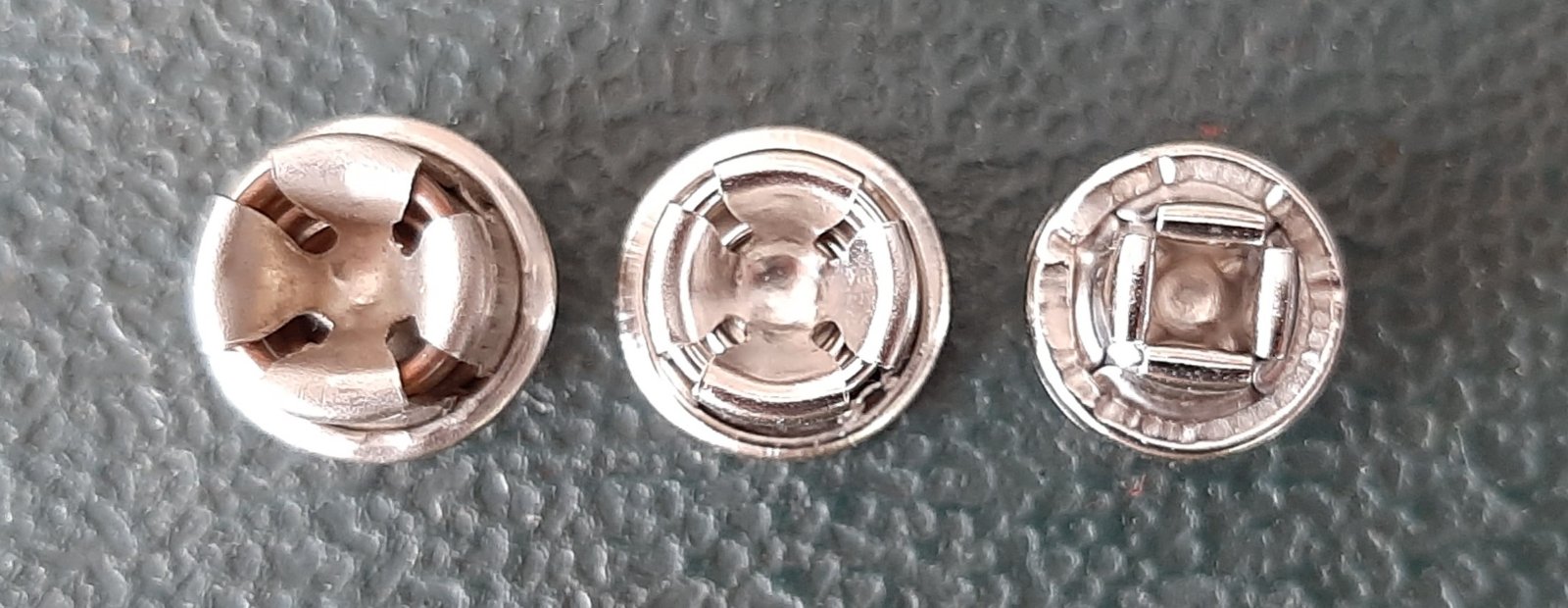

Post by Eric Sole » Fri Nov 07, 2025 5:49 pm

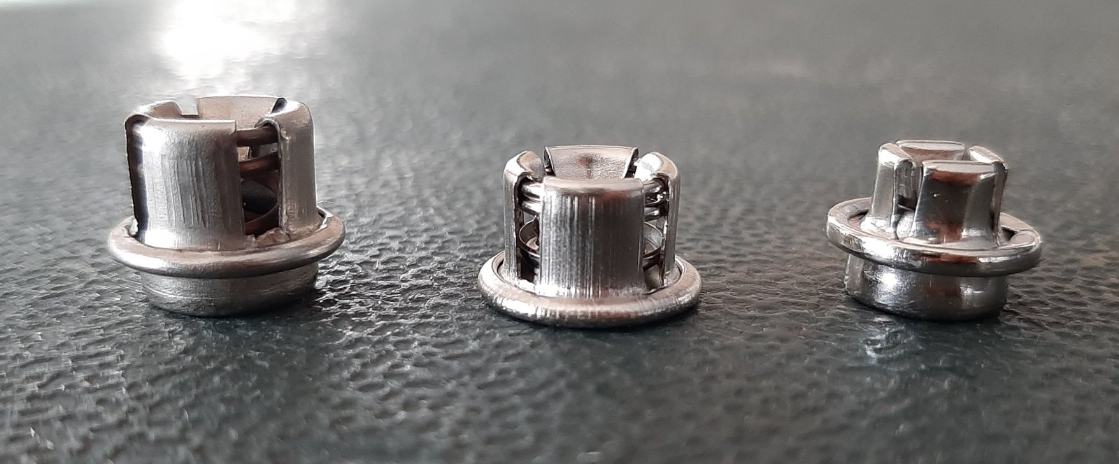

Thomas, I mistakenly understood from somewhere on the Forum that the Model A upper windshield snaps would work as a substitute for the receptacles with the collar for side curtains, so I ordered 6 to replace the ones on my car, but no dice. The inside diameter is about 0.75mm too small for the fastener to fit into, and of course, the base is too small as you pointed out.
These pics show (left to right)
-the proper receptacle with collar (not available from suppliers).
-the receptacle without the collar (available), which I understand is for the Touring cars to hold the side curtains to the body.
-the snap for Model A upper windshield.
