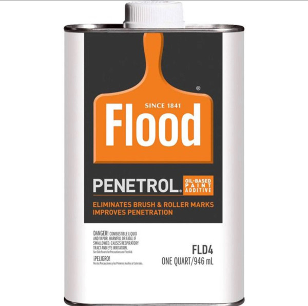

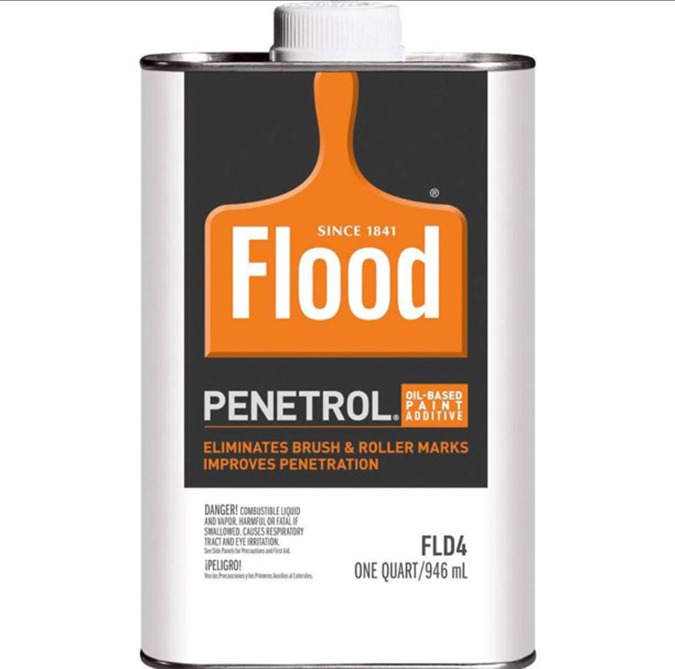

Here is what some of the the railroad museums have been using to restore old paint that is “chaulked-out” and deteriorated. It brings back the color and a nice gloss/semi-gloss. Plus it adds a layer of protection over bare metal and rust. They just brush it on straight out of the can. I would bet that if the two products were tested side by side, they might be extremely similar…
The Penetrol is only $13 to $18 for a quart depending on where you buy it. It’s available at many hardware & home improvement stores.
