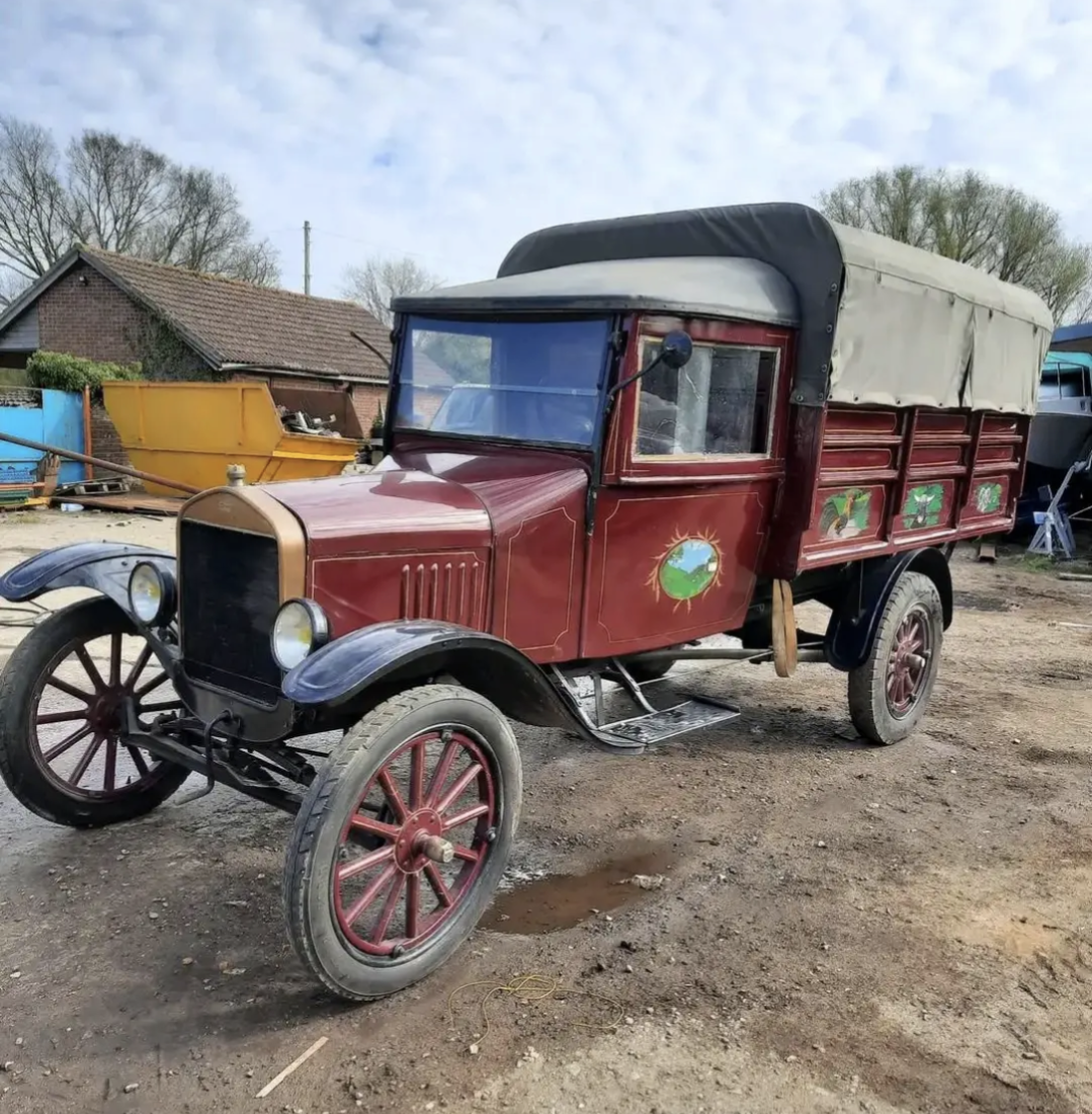

Mine has a Ruckstell and an overdrive - can get her up to about 45mph but more comfortable at 30 mph.
The thing is, the combination of overdrive and Ruckstell gives some good combined gear ratios when the Ruckstell is engaged (underdrive) and over drive high is selected, especially when I am carrying a load, so don't write off the Ruckstell ! It also gives me 8 forward gears that sound great when you work through them, even if you are swinging levers like a madman :-)
Check out the drawings in the Gallery section where Martynn has put up some useful TT rear end exploded diagrams.

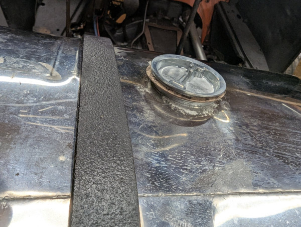

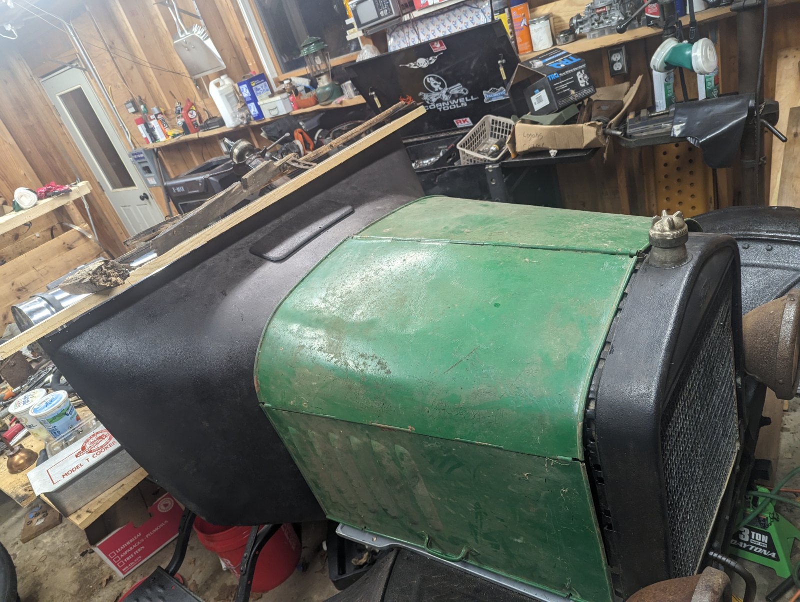

Good news, I picked up a hood and stainless steel tank from a fellow in Vermont. The hood will require a bit of tin knocking to fit, and one minor hinge weld, but should prove satisfactory.
The tank... Is going to require me moving beaucoup detritus out of the way.

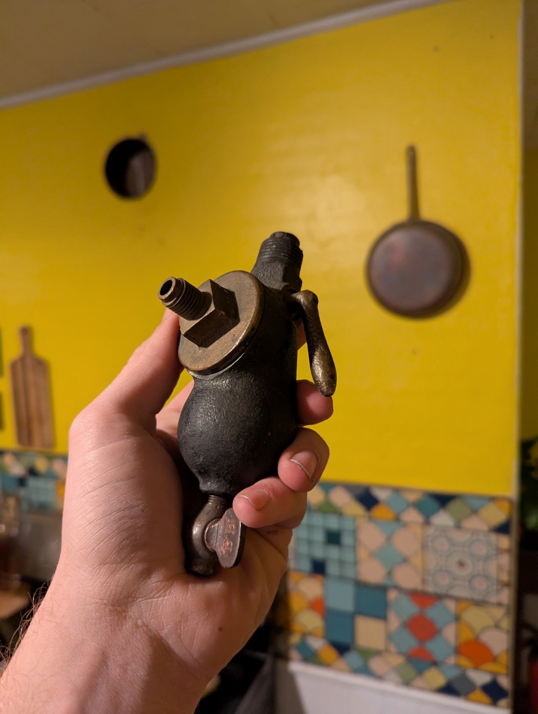

Courtesy of Varmint here on the forums, I now have a fuel sediment bulb! By my untrained and amateur eye, I suspect it'll clean up nicely.
My collection of reference material is slowly growing as well. Picked up an original 1927 owners manual off marketplace locally.

Well, one step forward, two steps back, as such things go.
My original gas tank bands are too small for the stainless tank. I reckon I can splice a small band extension in easily enough..
On top of that, the new made gas cap from Langs is slightly oversized, and as of right now, I'm uncertain as to how best to measure and find the correct cap. Thoughts on this would be appreciated. Perhaps I ordered the wrong cap? Or the bung weldment is for a different model?
But on the plus side, new electrical components have arrived! Im particular, new (shiny) guts for the headlights, and new distributor cables. Going to paint the cable holders, and make a pair of anti chafing inserts to protect the new wires.
Also, as a minor score, found a set of pull-a-part champion Xs locally for a pretty reasonable price.

I'm not sure exactly how your tank sits. If it is like mine, "standard", you might fabricate some riser blocks to go between the frame and tank strap ends. Use longer bolts as necessary.
Good Luck

Does the stainless tank have metric threads? I'd guess your fitment problems are related to the tank, not the T parts.
The sediment bulb screws in just fine, so it's not likely a metric/ standard problem. Unless of course, there's a thread pitch that's close to interchangeable with the bulbs NPT threads.

The in-line fuel filter can be ditched with a new stainless steel tank. They are notorious for restricting flow on gravity feed systems like the T. Yours even appears to be fitted backwards to my eye. Usually the fuel is fed into the canister and then through the paper filter, before heading to the carby.
