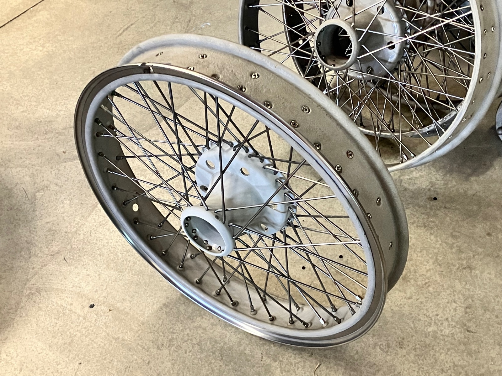

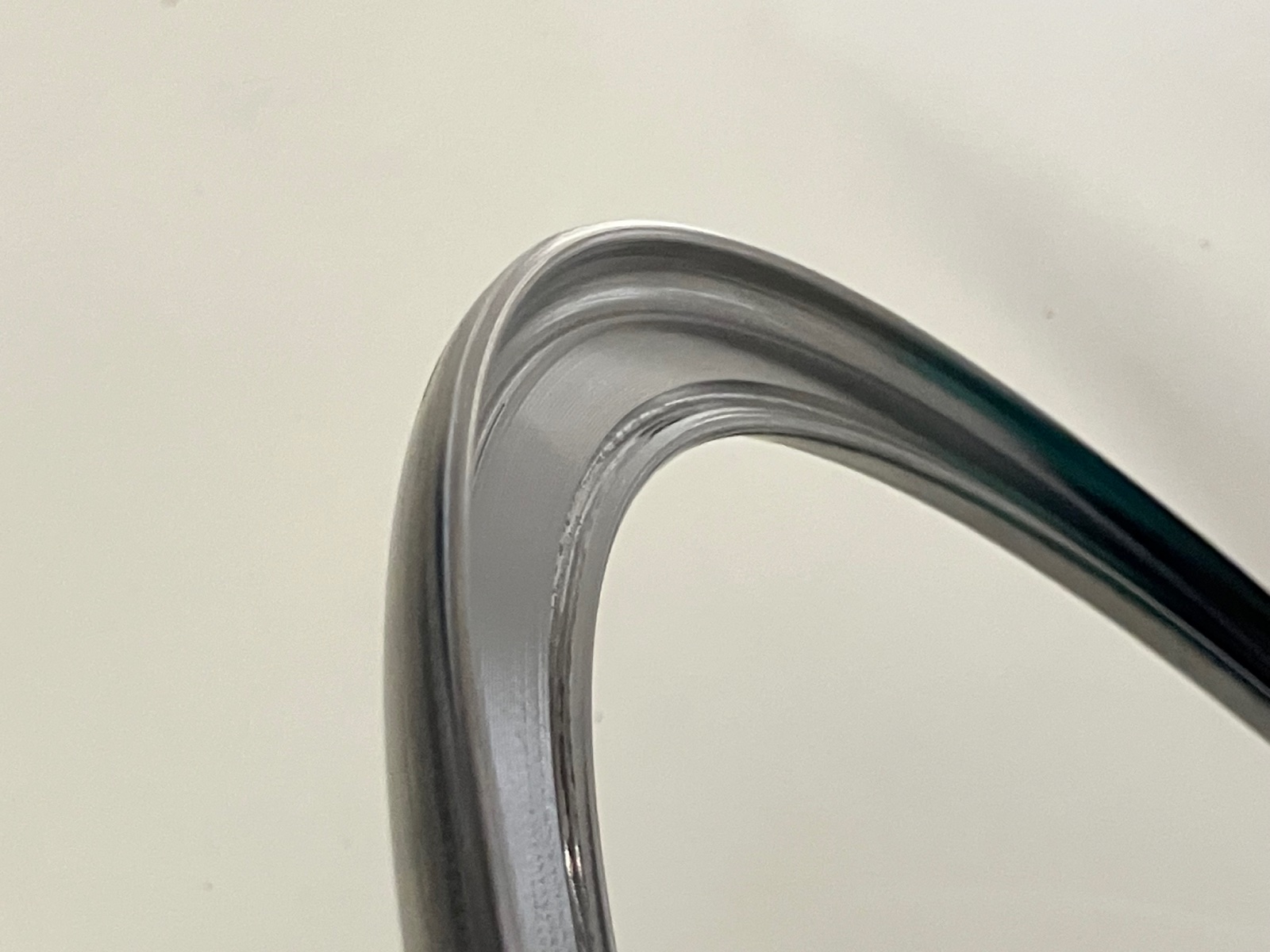

So, there are a few rim manufacturers out there that will roll new lock ring rims, but only 1 of them makes the actual lock rings. They are a custom hot rolled steel profile that gets rolled to mate up to each rim diameter. 2 profiles are traditionally available, “heavy” for the larger cars, and “light” for our more nimble autos.

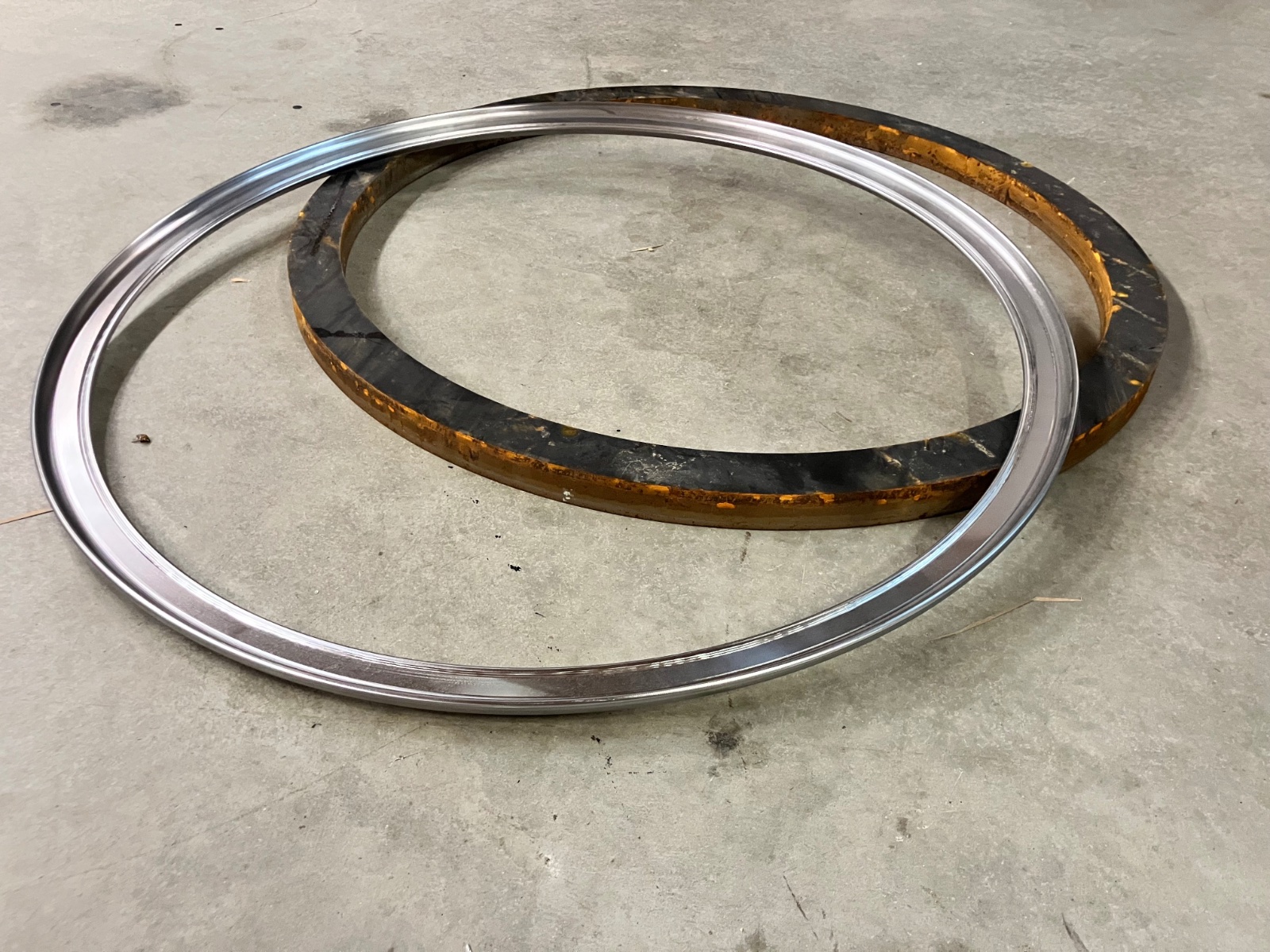

As my luck would have it, I tear down a set of wheels that were in need of “light” lock rings, confidently contact the manufacturer, and am told “no longer available”. Uh oh! Some of you already know that I have a tendency to do things the hard way, so I started planning. I need a lathe that can swing 26”… nope! I need a mill that has 26” of X and Y travel… nope! But wait…! I have a mill with a rotating table! And turns out I had about 1/2” to spare inside the machine. It wasn’t easy, but the first one is done!

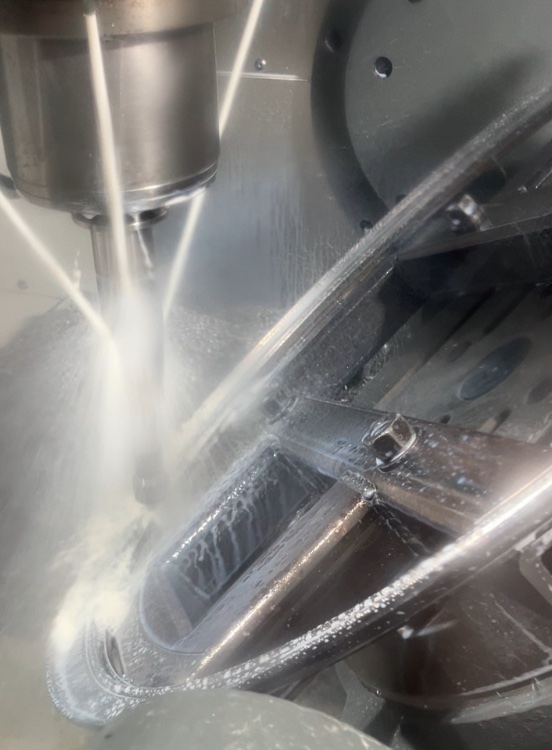

Made a fixture to cantilever out from the table to almost twice its diameter. Material is welded to fixture as there is no room for clamps. Programming was a nightmare as the machine is not technically large enough, so had to use extra long/short tools holders and creative tilt angles to gain access to the part.
Part is made in 1 operation complete. This is the tool that severs the part from the base material, leaving only a few thousands of material holding the part on. 3/16” endmill in 10” long holder and operating within about 1/4” of the max machine travels. Pop the part loose with a screw driver and a couple minutes with a grinder to finish
