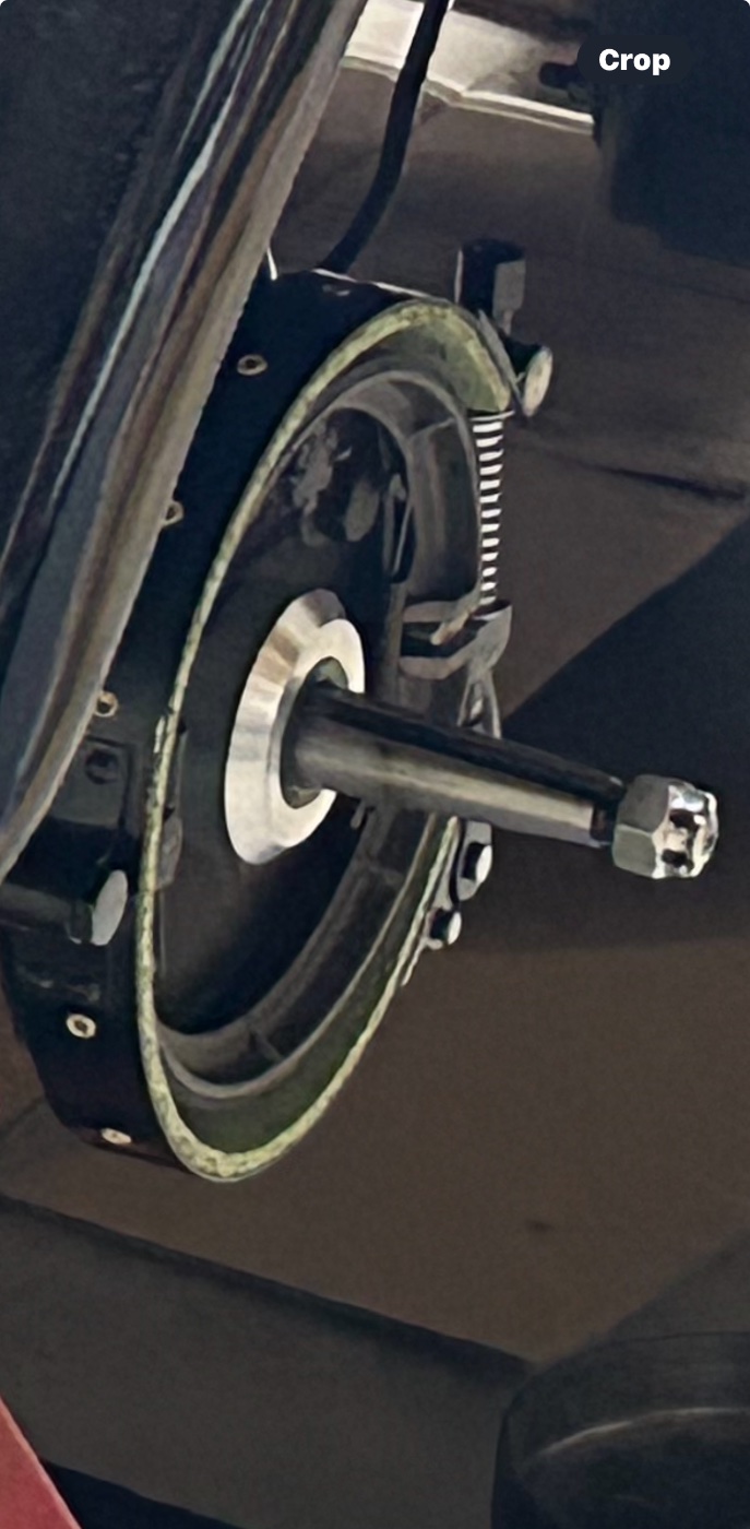

My first time installing AC brakes. I need to know the size of the extra long mounting bolts to attach the fixed portion of the brakes to the backing plates. From limited research it seems originally only one long bolt was provided for each side. However it appears from Larry Skidmore's ad photo, two were provided. One for the radius rod, one that pivots the parking brake. I would think both would be necessary. The brakes are original if that makes a difference. Any help appreciated.

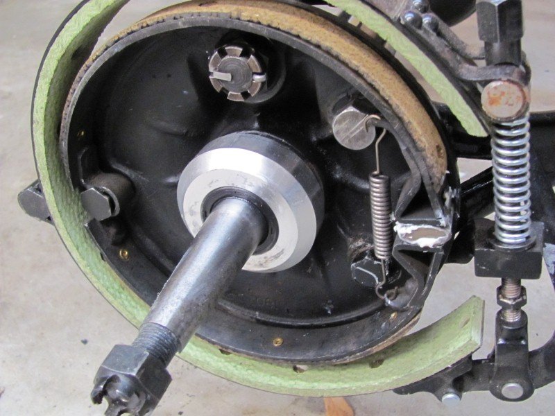

Take the length of the original and add the thickness of the casting. I used lock washers and modern nuts when I installed mine years ago. Also, you want nonthreaded shank to make up most of the length for better fit and support.

If I recall correctly, the stock pivot bolt for the parking brake has a thinner than normal head. Make sure that the new bolt head isn't too thick.

A couple of the pivot bolts (inner and outer brakes if both are used!), the shank is supposed to seat inside the casting! If it doesn't, it is a stress point that can become a fracture and brake failure.
It sometimes takes a bit of finagling to get the shank the right length to properly seat. But I never had much trouble finding a bolt close to the perfect length that with just a bit of trimming (sometimes the underside of the head) worked out perfectly. I often had to find the perfect shank and then waste about three inches of thread.
