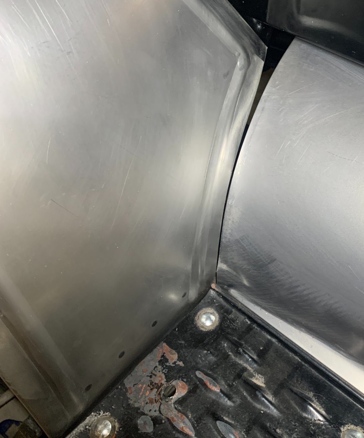

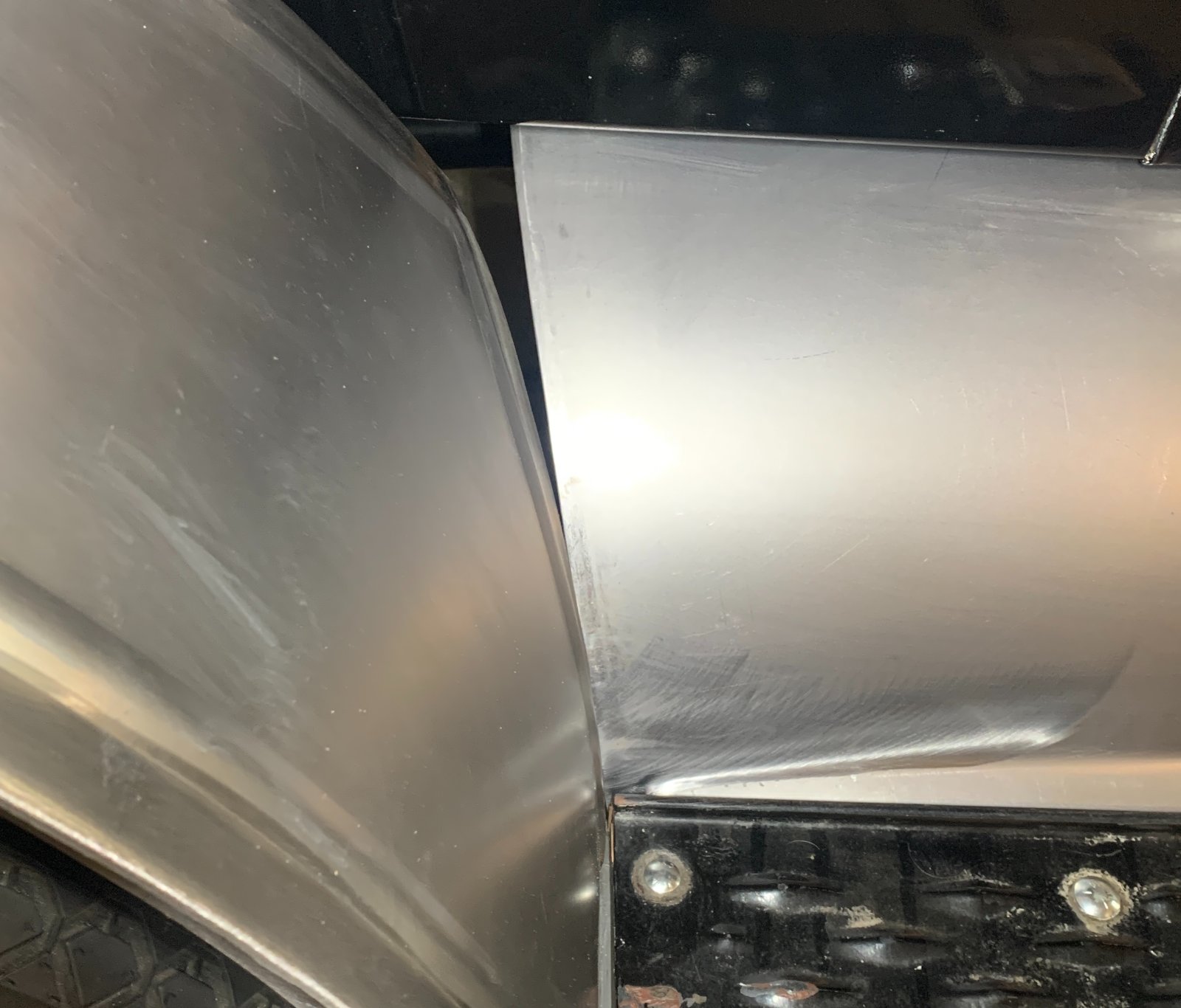

Has anyone been successful at mating the apron and rear fender of Rootlieb parts? I wanted to connect them with the standard bracket but they just don't line up correctly.

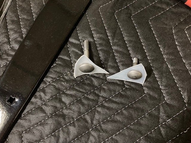

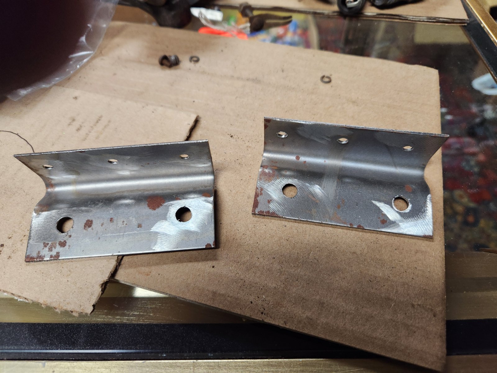

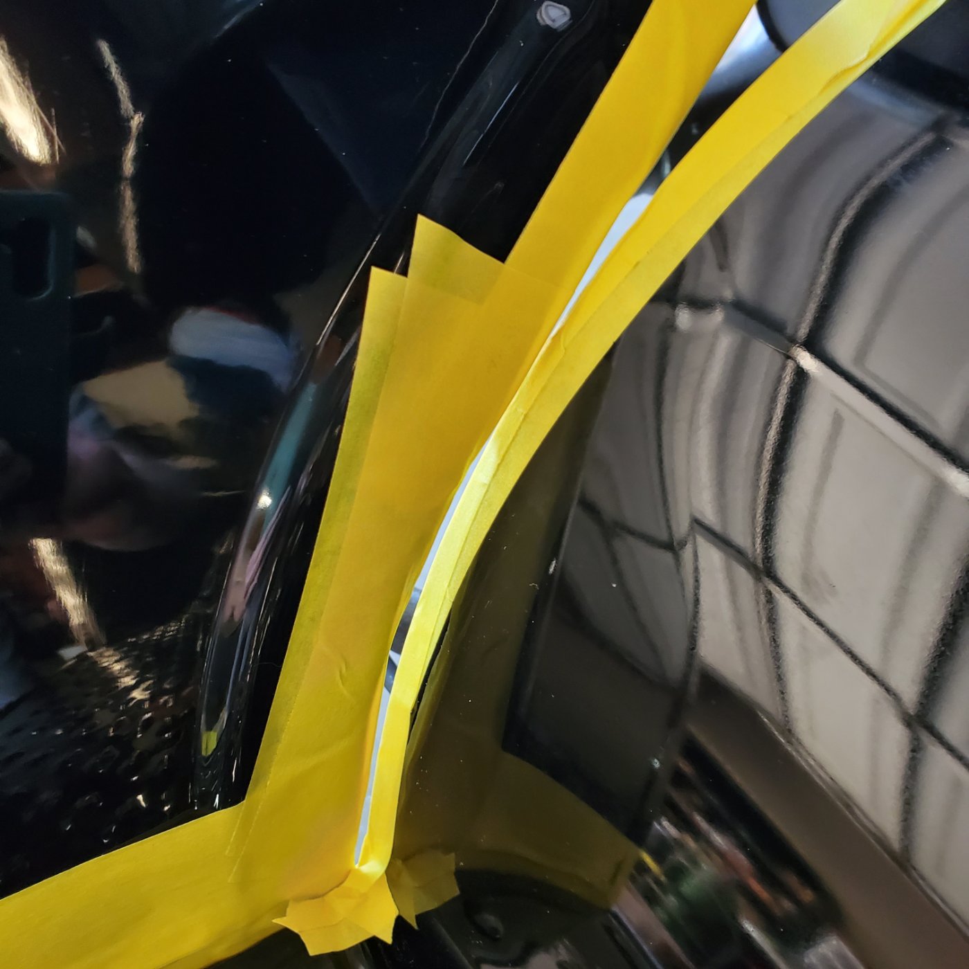

I've seen riveted butterfly shaped pieces of sheet metal installed on what appear to be original cars. Ive seen them installed on both the front and rear spaces between the fender skirts and the edges of the splash aprons to close gaps and prevent rattles. Without them you need some gaps otherwise they will rub together causing wear and rattles as you drive. The gaps you pictured look about right to me.
Here's mine The tape prevents scraping during installation.

yours does look a lot like mine. and that was kind of what I was looking for. I think I can get the arch of the two parts to match but your fender and mine both curve toward the back of the car and that is what makes using the bracket tough. I don't really understand why the fender curves back? It takes a lot of pressure to pull it forward, and then it makes the top of the fender tilt.
I'm going to keep playing with it to see what I can do. I would still like to see if anyone responds with the success of bracketing the two together.

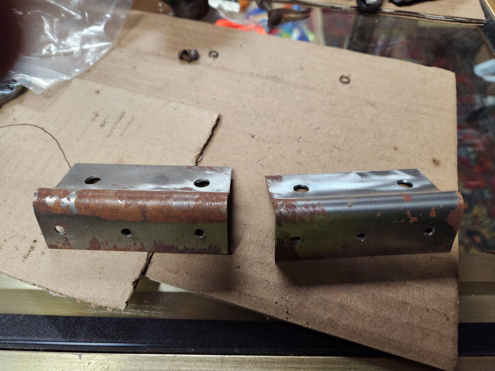

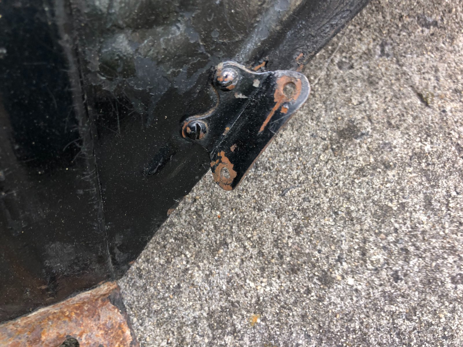

Speaking of butterly brackets, here is one type that is on a set of original rear 12 Roadster fenders. I doubt the bracket is original, but it looks like it might be of use for my current project.
- Posts: 7330
Re: Rootlieb apron to fender mate
Bob's brackets look like new reproductions. The originals with which I am familiar are of somewhat heavier gauge, and they are a bit more complicated than they seem at first glance. Because they mount to a curved splash panel, the two hole side of the bracket needs to be curved to match that curvature. It's not a lot, but if you just drill and bolt up, it will pull a distortion into the splash panel, with varying results to the finished look. That two hole side of the bracket needs "adjusting" to get a correct fit.

Greg, the bracket in your photo is the same as those off my 1912 roadster. The fenders were trash but I saved the brackets. They may have been factory installed.

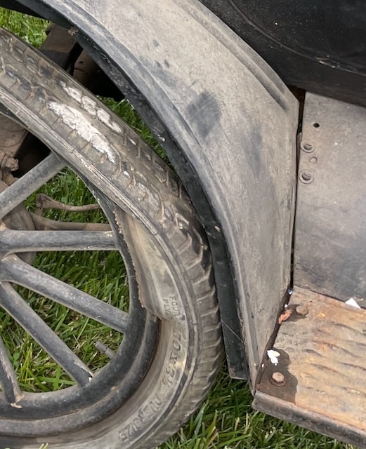

Think the early Ts didn't have any fender to apron braces, but around 1915 or so Ford added an internal bracket.
This photo is an original '15 touring, with some repairs over the years.

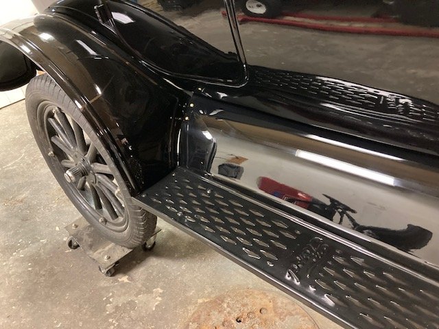

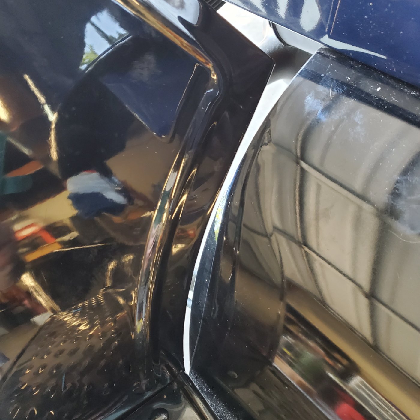

Had to smile when I opened your post this morning; just spent the last 3 days rolling around under my 25 touring installing panels. In addition to the good advice you have received I would add my process started with installing the front fenders first, then the aprons and running boards and the rear fender was last. Bolts just snugged and then the aligning, re-installing and patiently getting it all close starts. I paint my car panels and then assemble so I use plastic lids cut up for the bolts to go through to try to protect panels. I also needed to adjust the thickness of the repo running board blocks to get the aprons and boards to mesh correctly. Lots of patience needed.

The front and rear fenders are original, the splash aprons and running boards are reproductions. The brackets on the rear fenders are pictured in the Ford Service Manual, figure #5 on page 1.

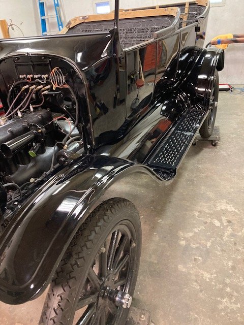

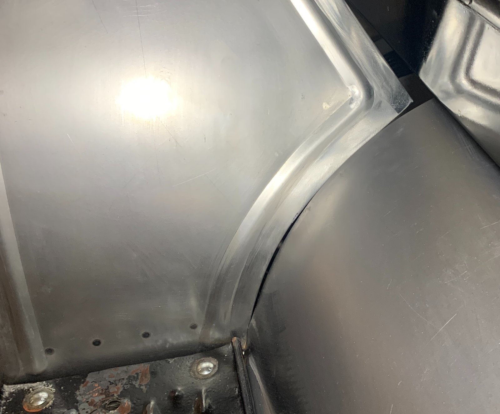

Chris, another pic showing final alignment. The brackets on my rear fenders were part of the original construction of the car. This is a late July 25 Touring.

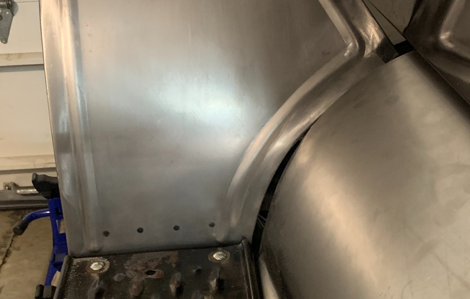

OK, here is where I am now...can anyone explain why a fender is designed with a curve to mate up to a straight edge of an apron?...
