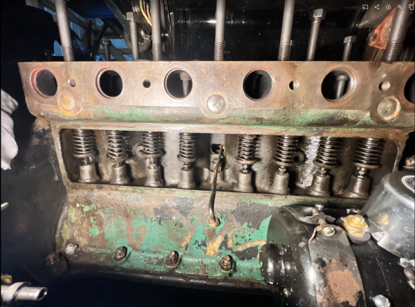

So while I was running the engine to test out the bands I noticed my head gaskets started leaking a lot more than I've ever noticed from the rear and was slowly making its way up to the front. Tried tighting the head bolts up to 55ft lbs, after being warm. That didn't work, so pulled the head and welcomed my next fun mini-project!
Valves, springs, retainers, pins... some pitting on the cylinders. Nothing I really wanted to see, but can't just leave it as it is.
Wish I had the funds to continue pumping money into her, but unfortunately I have exhausted my budget for a new block. Maybe in the distant future this can happen, but for now I just want to get her running again and do the best I can with the resources available.

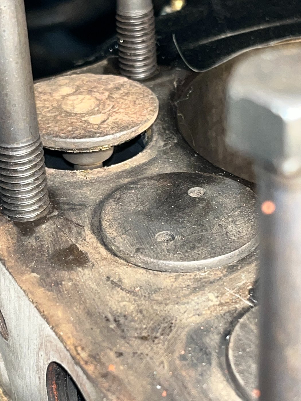

Cleaned up the valves, the 4 exhaust valves I might replace... just depends on how well new ones will seat. I now know there is a risk of making it worse by doing this... wont know until I try first. Definitely will replace the springs, seats, and pins while she is opened up.
Here's a few pictures of the block (noticed number 7 valve is hanging by half of a pin)
Number 1 valve (beveled top)
Number 8 valve, can see a little of the back edge is deteriorated
Something I have noticed is a few of the valves have a bevel on the top while most are flat.
These are all Ford stamped (on underside of head) cast iron 2-piece valves

Post by TXGOAT2 » Tue Feb 24, 2026 5:18 pm
I'd want to replace the two worst looking valves. They're in bad shape and may be in danger of the heads coming off the stems, which could be a disaster. The valves do not have to match one another.

Post by TXGOAT2 » Tue Feb 24, 2026 5:22 pm
The crank case on the passenger side looks to have what may be chalk markings on the cast iron underneath the paint. There's a good chance those are factory markings. It might be interesting to find out what they mean, if anyone knows.

Post by fireheadman » Wed Feb 25, 2026 1:03 pm
for sure on the 2 to replace... got a couple extras for just in case.
I'll have to look more closely at/for this... I've never heard or seen of markings like this. I know the block was swapped in back in the late 70's (maybe in the 60's).

Post by Jerry VanOoteghem » Thu Feb 26, 2026 10:15 am
Appears as if a past pressure washing blew some paint off.
