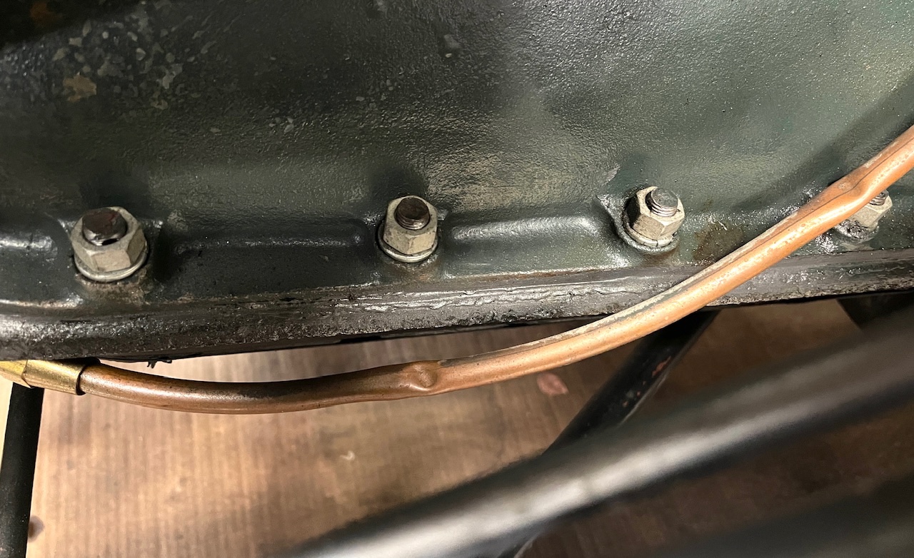

I installed an outside HV oil line on my 16 when I had to replace a cracked drum. Fast forward cranked it up and I got smoking engine. Was not before. Anyone one seen this? I removed the line and plugged the fittings, smoke gone. I plan to install a needle valve to reduce flow. Any input? Dan

- Posts: 3990
Re: High volume outside oil line
Put two partial restrictive crimps in the copper line, using blunt clamp end Vice-Grips , to slow oil flow.
Stopped the excessive fouling of #1 plug.
