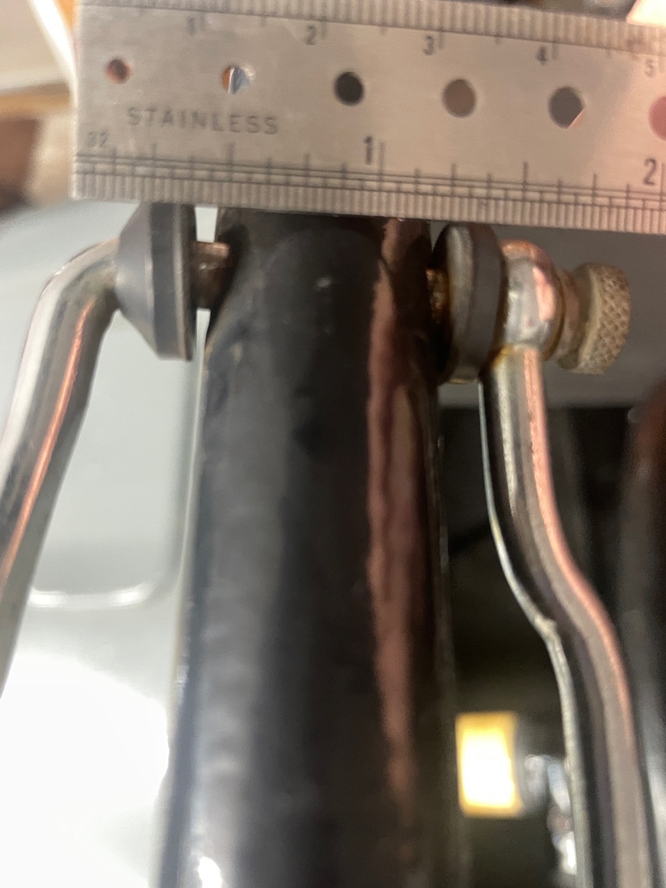

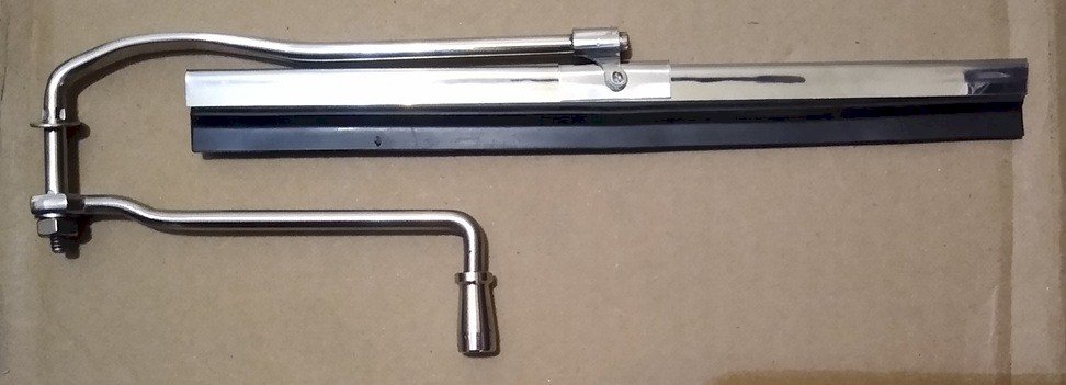

I bought what was available, knowing that it is not a direct fit. Has anyone extended the shank to work on a Coupe?

Vern, I assume by "extending the shaft" that you are referring to an electric or vacuum wiper motor, as if you were using the original hand wiper, this should not be necessary. I haven't done it but before I bought my vacuum wiper motor, I looked at some electric ones and found at least one that had interchangeable shafts of different lengths, but I do not remember the brand. I, eventually, found a Trico vacuum motor on EBAY that "fit like a glove", had the right shaft length, and even had a knob for manual operation like the original Trico motors that Ford offered as accessories.

The original Ford hand wiper came in two shaft lengths - open and closed cars.

Got the stainless one from Lang’s or Speedway Motors, shaft is 1 1/2” from right angle. Was bit long for 26-27 open car windshield frame, so added rubber washers. Might fit your closed car as is.

Sorry for confusion. This is for the improved Coupe, by hand. At the time of purchase, I was told it would not fit my car but no other option was available. Also, I have a reproduction aluminum windshield frame that does not yet have the hole drilled, nor the bracket yet.

I extended the shank on one for my '26 Tudor. It was years ago but I think I most have welded a new piece onto it.

Be sure to set up some sort of guide when drilling the windscreen frame. The hole .needs to be perpendicular to the glass. On my Henrietta it was way off so the wiper was less than efficient. I had to hand file the hole oversize and square on. I fitted a custom bronze bushing and sealed it both ends with black RTV to keep water out of the screen frame.
