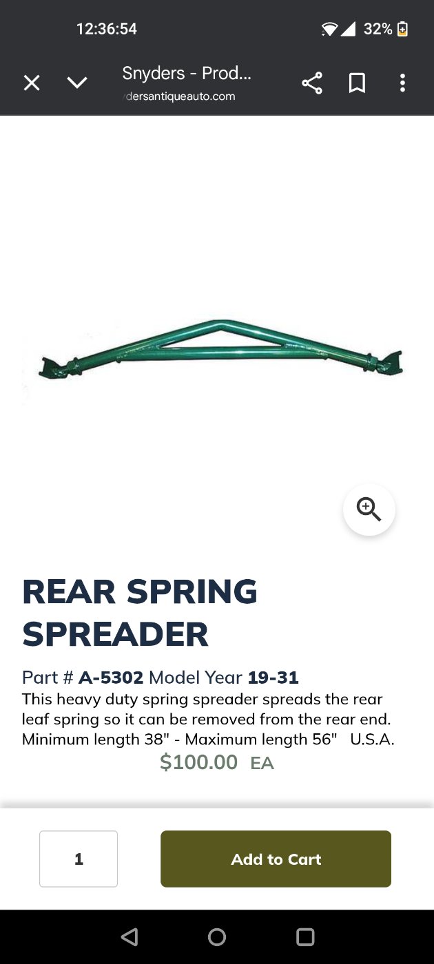

I need to do some more shenanigans on my rear suspension again. This time though I don't have access to the tools and shop i was able to borrow and hence can't replicate the janky definitely not OSHA approved method for spreading the springs. Would this model a spreader from Snyder's work on my 17 t? It's up there in my price range but I am no fabricator and I pay the price for lacking that skill.

You don't need a spreader on a model T. Actually makes the job harder.
Using jacks & 2x4's under the leaf ends & Lifting against the body's weight will lengthen the spring to install the shackles.

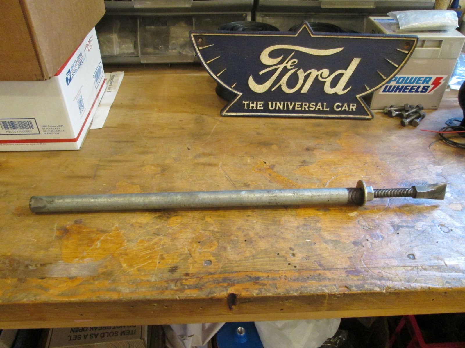

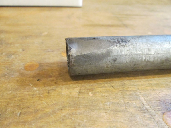

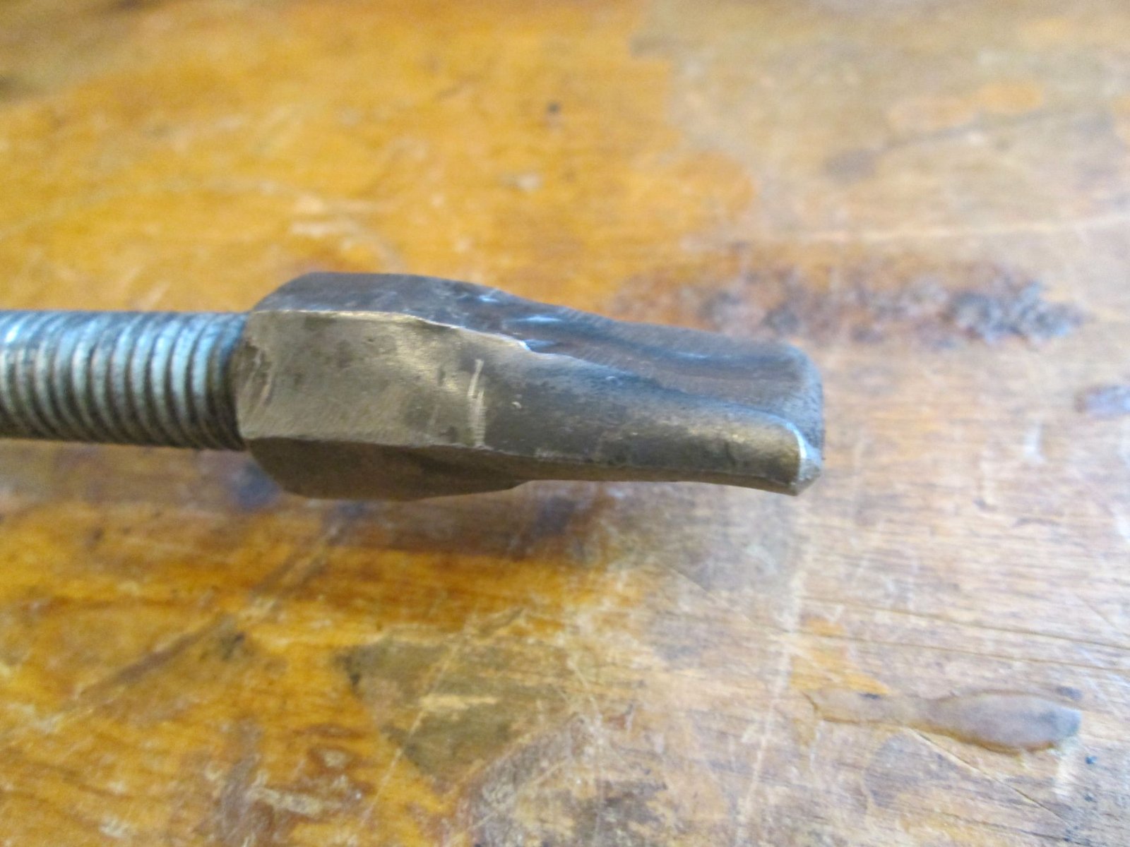

I made one out of a 16" piece of 1/2" iron pipe, a 6" piece of 1/2" all thread, a couple 1/2" nuts & flat washers & a 1/2" coupler - grind down one end of the pipe just enough to go over one of the punkin bolts, heat up and flatten one end of the 1/2" coupler, insert the flattened coupler under the spring eye, insert all thread into the pipe, thread out the nuts until snug then wrench away to the desired length to insert the opposite shackle - I attach one shackle first then use the tool for the other side - I'll take a photo later.

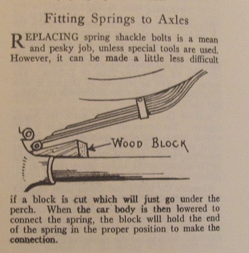

A spreader is not needed. The Ford Service Manual will show how to do it with wood blocks.

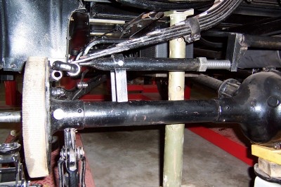

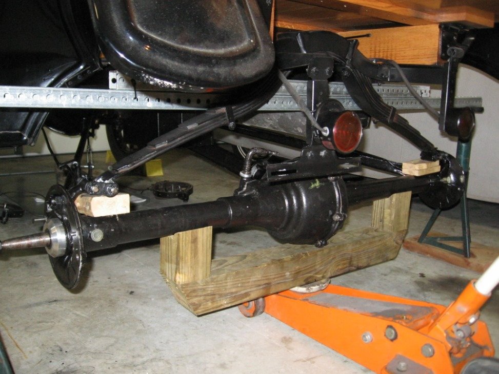

Post by DanTreace » Mon Dec 01, 2025 5:53 pm
Have used the taper wedge block method in the past.
IMG_2164 (509x518) (491x500).jpg (130.17 KiB) Viewed 1394 times
But years ago got a custom made spreader from a retired guy who made some very nice Model T tools and replacement parts, spreader has sliding tubing over a large threaded rod to expand and contract the tubing on each end. Welded hump portion to clear the pumpkin and alignment stays, works so well it's the go to tool.

Post by RajoRacer » Mon Dec 01, 2025 6:23 pm
Here's my homemade contraption.
Posts: 4406

Usually, I think I mostly just use the block of wood method to fit the rear spring together. Usually, they go together so quick and easy that way that there is nothing gained by even considering any other method. I have often just used a quarter inch thick scrap of wood a couple inches long to do the job.
One time, the quarter inch thick scrap of wood crushed and split under the weight of the spring and car. I had to waste a couple minutes to find another scrap and reset everything (no big deal).
