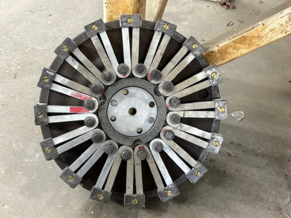

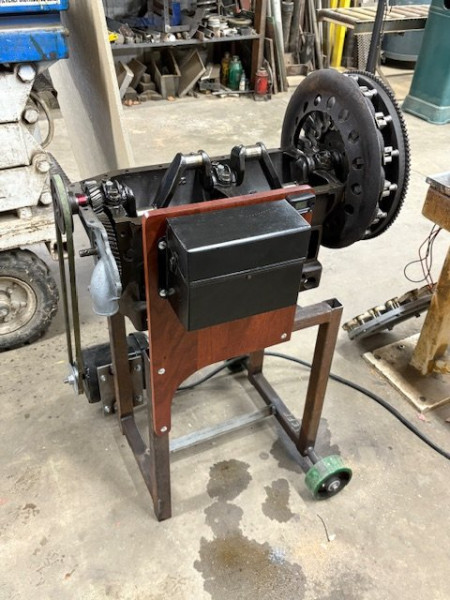

Interesting project - coil/magneto/flywheel tester
I'm still having fun playing with rare earth magnet replacements for model t magnetos, just for giggles. They work well but it is hard to quantify outputs and I'm not crazy enough to build another engine every time I make a modification. I hit on the idea of using a defective engine block/crank/cam and driving it with a variable speed motor. Kevin Prus made one available to me and I set about modifying the front of the crank to accept a belt pulley and modifying the rear by drilling and tapping for a 7/8" stud for quick attachment of the flywheel. I built a stand and inverted the engine block and bolted it upside down on the stand and drilled the main caps for oil cups. I mounted a three phase motor and drive it with a VFD which is easily adjusted with a ten turn potentiometer. Speed is indicated by a magnetic pickup tachometer with the magnet glued to one of the rod throws and the pickup attached through a hole drilled in the side of the engine block. By installing the cam I am able to fix a timer to the front cover and I have installed a coil box to the contraption so I can operate four coils and spark plugs along with monitoring voltage. Now to add a spark plug attachment that will allow me to pressurize the plugs and vary the regulator to see where they fail while watching through a window. I'm looking for a suitable AC voltmeter in the 0-50 volt range that has an antique look to it - any ideas appreciated. It is still in a rudimentary stage but I have already been intrigued by what it has revealed. Some guards are in order as the crank whizzing around at 1500 rpm is rather intimidating as is the open v-belt. Best toy I've gotten for Christmas for over sixty years!

Re: Interesting project - coil/magneto/flywheel tester
My plan is to wire two 1156 sockets in series so I can select one or two with a double throw switch to vary the load and check at speed or bypass them to operate the coils and plugs. Parts on order - will advise.
The lower setting on my VFD is 10 cps which nets 240 rpm. Below that the motor torque sort of disappears. What would you think cranking speed would be?
Here is the comparison between Ford book(column 1) observed Ford flywheel and magnets @.030 gap (column 2) Neodymium high temperature magnets @.070 cap (column 3) samarium cobalt magnets @.130 gap (column 4)
RPM--------------------1--------------------2---------------------3-------------------4
200-------------------5.0------------------4.8-------------------5.0----------------6.25
400-------------------9.8------------------9.5------------------10.1---------------12.5
600-----------------14.4------------------14.4-----------------15.1---------------18.9
800-----------------18.8------------------18.8-----------------20.2---------------25.0
1000-----------------22.8------------------23.1----------------25.1---------------30.8
1200-----------------26.2------------------27.0----------------30.0---------------36.7
1500-----------------31.6 est.------------32.7---------------- 36.7---------------45.2
Still playing with various size magnets and gaps. Not sure what the optimal output would be. Flywheel weight reduction would be in the seven to nine pound range. Your mileage may vary!
I had my guys help me reprogram the VFD today and checked the voltage with the stock magneto/flywheel arrangement and it yielded 1.0 volts @ 40 RPM and 1.5 volts @60 RPM still maintaining the .025 volts per RPM.

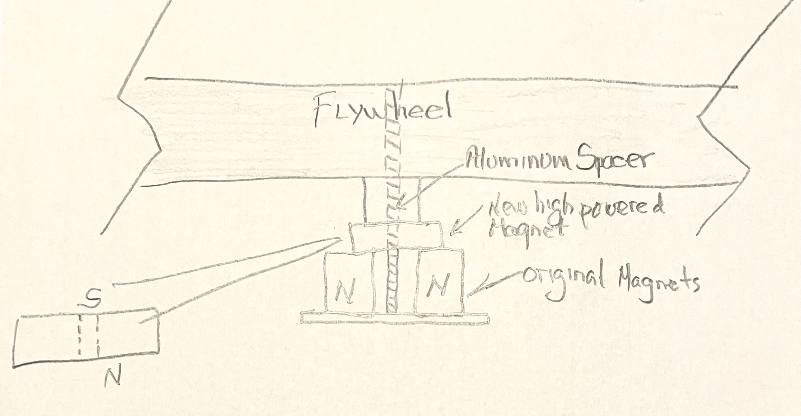

Here is what I did with mine as I didn’t have time to experiment before putting my engine together. I bought 1/4” thick magnets, and 1/2” thick spacers to make the total distance match stock. My goal was not to reduce weight but to create a mag that wouldn’t lose its charge over time. Works well.
I also used shims to adjust the gap as the new magnets are brittle and can break. Ray
I also had the whole assembly dynamically balanced when I was done. It was about 38 grams out. Ray
How does adding brittle little magnets keep the magnets from loosing their charge?Rayboy wrote: ↑Thu Dec 04, 2025 11:20 amHere is what I did with mine as I didn’t have time to experiment before putting my engine together. I bought 1/4” thick magnets, and 1/2” thick spacers to make the total distance match stock. My goal was not to reduce weight but to create a mag that wouldn’t lose its charge over time. Works well.IMG_1718.jpeg
Magnets don't loose their charge over time unless DC voltage is introduced. Am I missing something?
In trying to re-invent the wheel, you have added serious potential failures.
A better understanding of the system would be preferred to blind experimentation.
Jerry, All the new high strength magnets are brittle when struck. It’s the materials they are made from. Using the normal method of striking to adjust the height risks cracking / breaking the magnet. That’s why I used shims instead of striking. They won’t break/crack unless struck and are extremely strong unless hit. Appreciate the comment. Ray

- Posts: 6815
Since the vast majority of donut rare earth magnets are axially magnetized (and not diametrically magnetized), it appears that Ray's creation works in spite of the improvements rather than due to them and is a testament to the robustness of the original design. If diametrically magnetized magnets were in fact purchased, then my hat is off to him for his ability to get those suckers to stay in alignment while tightening them.
FWIW, the coil is going to fire on the waveform when it reaches 1.3A (or wherever you set your coils). 3V hand cranking, 28V at road speed, 75V with rare earth magnets, or lightening from the Lord Almighty. It's simply a science project and if you bought your T to advance the cause of science, by all means, have fun, and it sounds like you guys are, so good for you, but I suspect that Elon's not losing sleep over it nor interested in buying it. I just don't view it as an improvement, because the other 15,000,000 Model Ts all ran fine as produced. Personally, it is my desire to simply experience automobiling as it was in 1920. But that's just me and there seem to be damn few people these days like me who are satisfied with JUST an antique car if this Forum is any indication. People like myself will be gone in due time and there will be no one left to pee in anyone's cornflakes over this sort of stuff, so be patient.

Wow.
When I went to engineering school I learned and understood Faraday's principle.
I have studied and writtten about the magnet and pole relationships of the Model T magneto and how it relates coil power and subsedquent ignition timing
I understand rare earth magnets and Curie temperature, but rare earth magnets come in all sorts of sizes and shapes.
Can someone show me a diagram depicting the magnetic North/South pole orientation with the respect to the physical shapes of the magnets shown in the above implementations?
Ron Patterson
Ron Patterson

Ron, I have always appreciated your posts and articles. Thanks! The magnets I used are poled on the flat sides. When I inserted them next to the original magnets I put then n to n and s to s. That way they enhance the magnetic strength of the pole. The other advantage is they don’t loose strength over time like the originals do. They will also prevent the old magnets from losing strength. My idea for this design is to build a mag that doesn’t loose magnetic strength over time but keeps the same power without a ton of added expense. Let’s all do what we enjoy and have fun doing it. Ray
