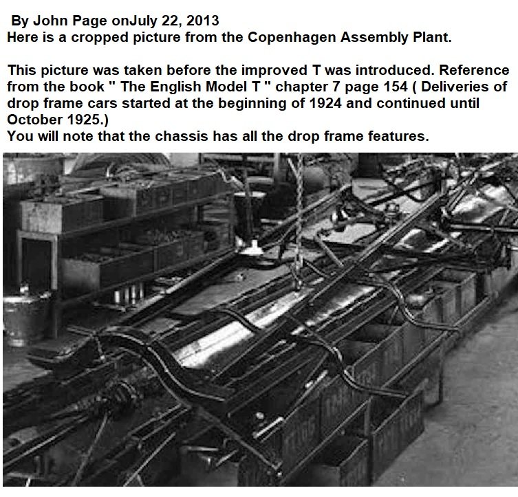

To lower a Model T it takes a higher (not lower) rear crossmember.
That is what was done (and more) on European Model T Fords
They were called "Drop Frame" cars and had a bunch of special parts.
See
https://www.mtfca.com/discus/messages/3 ... 75948.html

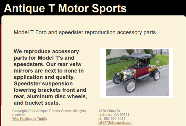

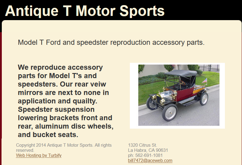

Antique Motor Sports out of La Habra CA used to sell polished aluminum disk wheels.
Looks like they have an eBay store now.
Maybe this is who you saw at the old swap meet?
https://www.antiquetmotorsports.com/products
Posts: 6609
Re: Rear crossmember question
Post by TRDxB2 » Fri Dec 05, 2025 1:46 am
KBurket wrote:
Fri Dec 05, 2025 12:31 am
Here is some more info on Antique Motorsporst & link to their eBay sight https://www.ebay.com/str/antique-t-motor-sports-llc
It doesn't look like they have them available nor a rear cross memeber.
This image is from the link that KBurket provided https://www.antiquetmotorsports.com/products

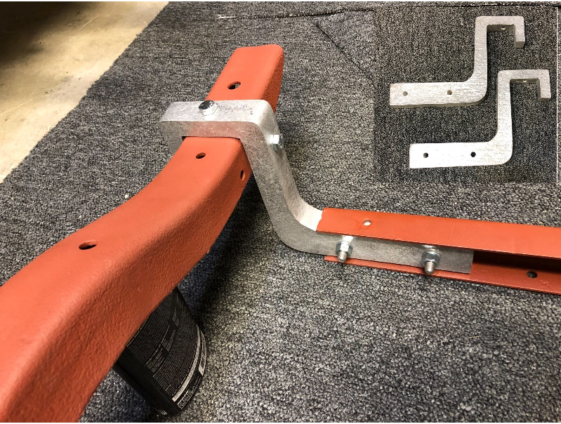

As I recall they offered the Z-Bracket individually or already welded to a rear cross member.
The Z brackets are available but a different design (material & attachment method)

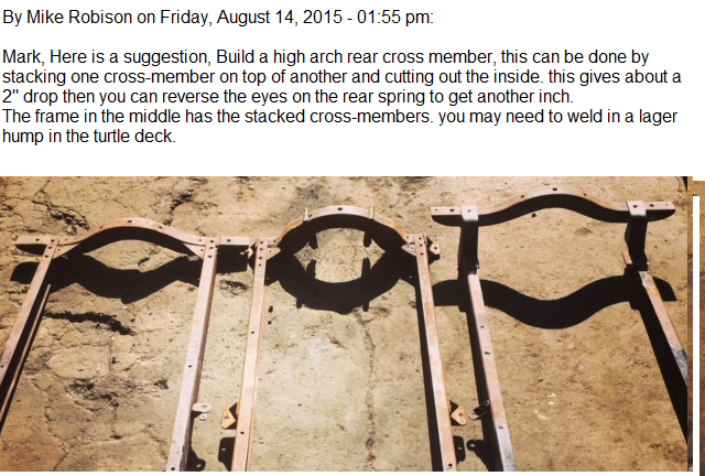

There are several methods to drop the rear axle. The one that involves a high arch is to cut a section of one cross member, cutout a section of the one on the frame and then weld in the cutout piece (the middle example)
I did see that there exists a high arch rear cross member see my next post

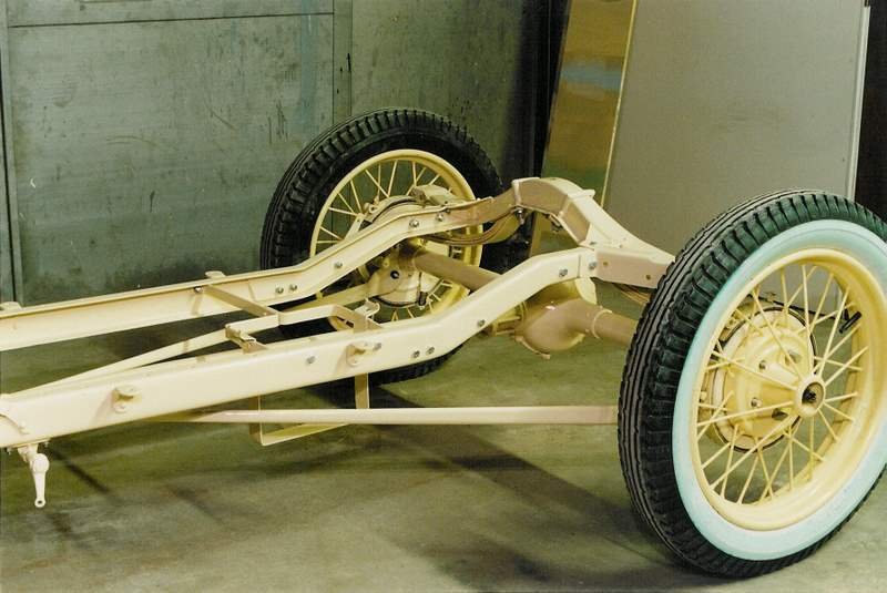

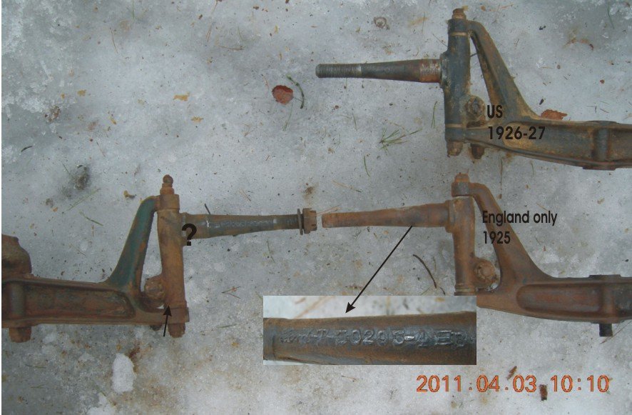

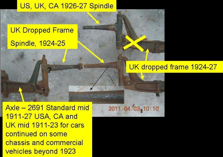

Here is a discussion about European chassis that were dropped via different front spindles & rear crossmember https://www.mtfca.com/discus/messages/3 ... 75948.html
For the front https://www.mtfca.com/discus/messages/1 ... 02362.html

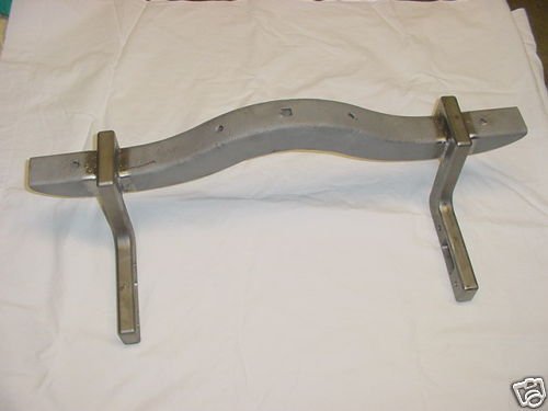

Rootleib made the dropped rear cross members. They are on page 39 of their catalog and are listed as part # 823.
Not sure if they still offer them.

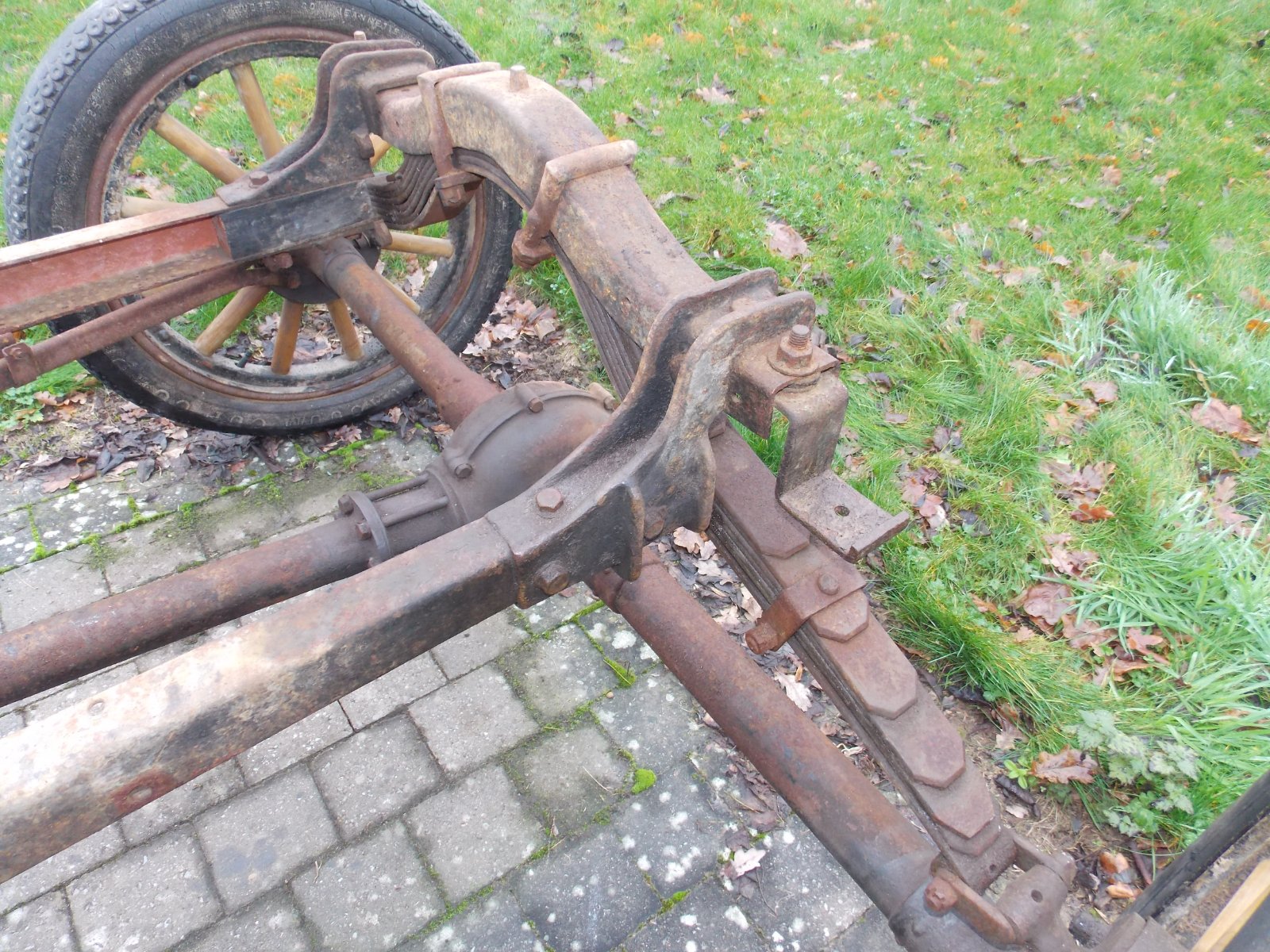

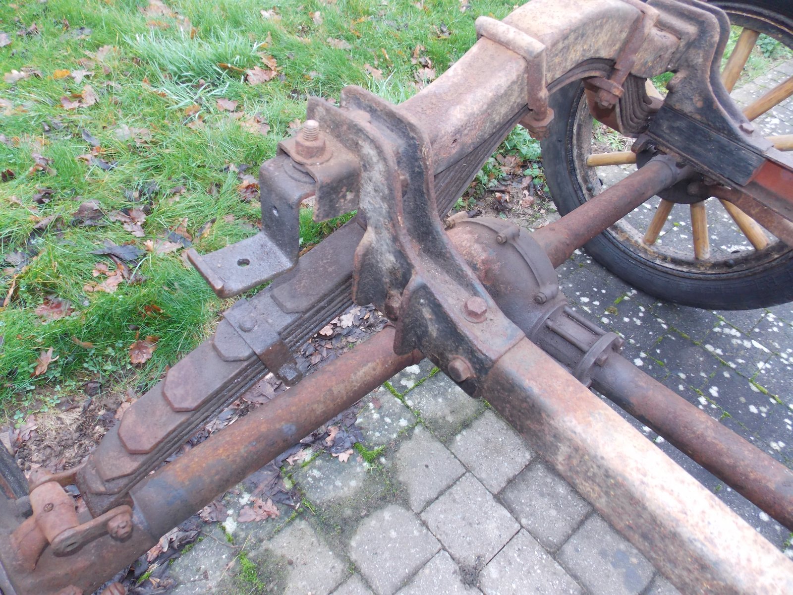

This I found three years ago.
Maybe an Idea to do it your self.
Andre
Belgium

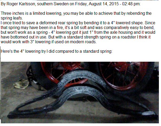

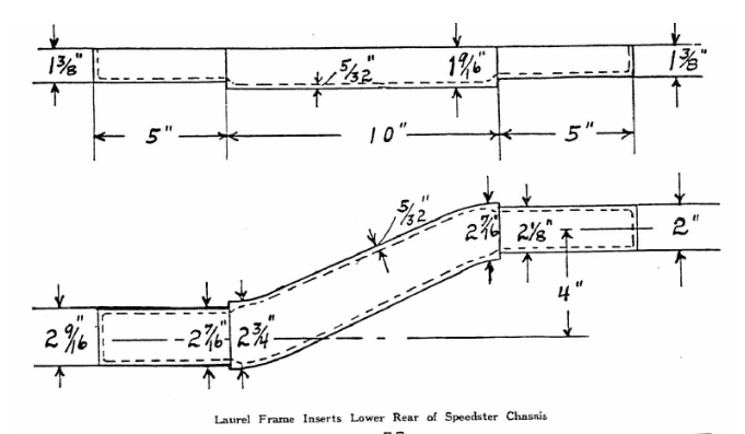

Rear axle drop methods
Lots of ideas here
TimKnappOnLowering.pdf
(1.76 MiB) Downloaded 53 times

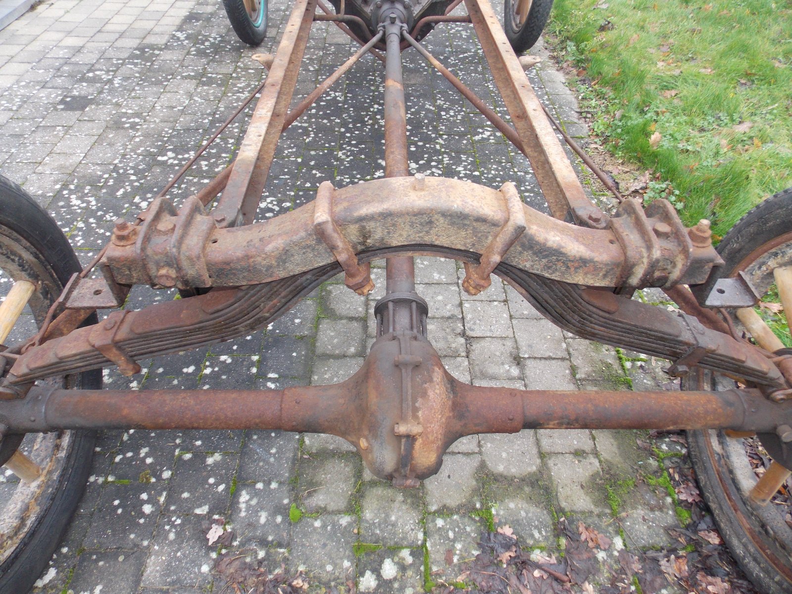

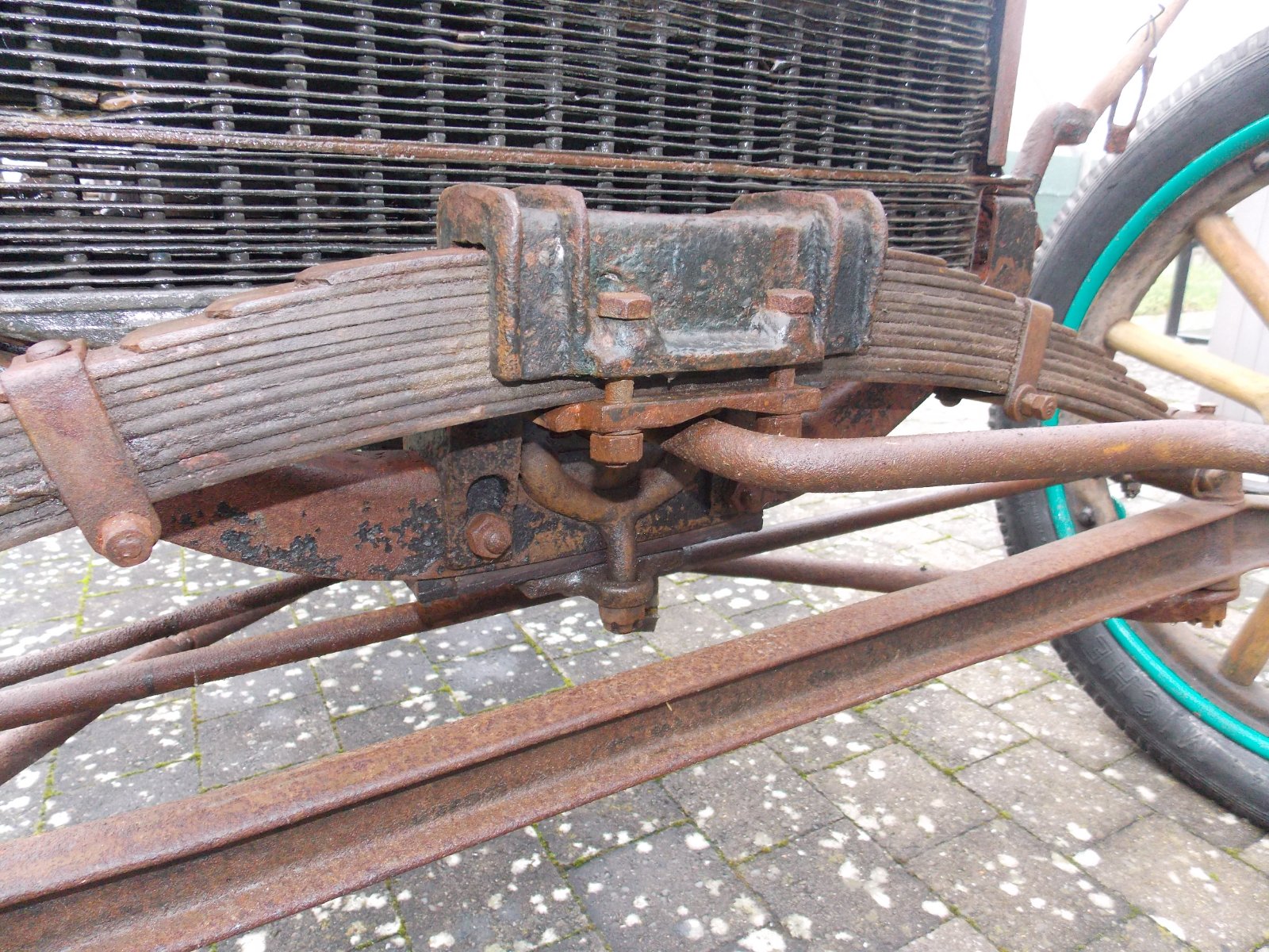

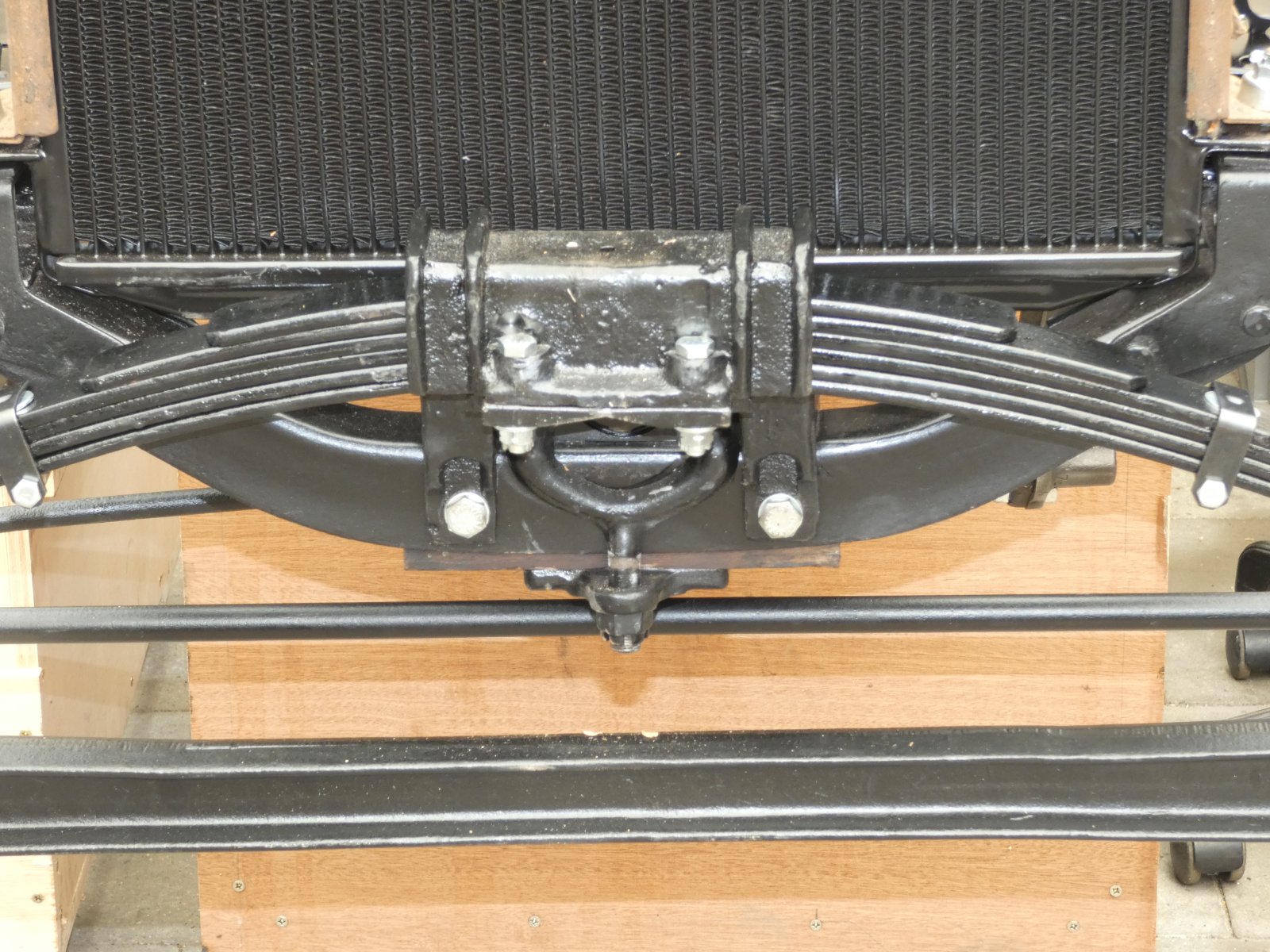

Wow! there are 12 leaves in that front spring!
Posts: 8701
Post by TXGOAT2 » Fri Dec 05, 2025 6:47 pm
12 leaves looks crazy, but there may be method to the madness. If the leaves have low temper, or rate, it may take 12 of them to get the correct ride height. The stack of 12 leaves would have higher than normal inter-leaf friction, which can provide compression damping and some rebound damping if it is not excessive. Or maybe somebody wanted really high roll stiffness. Shocks would be a better solution, if only to save weight and allow easy adjustment. I wonder if they are stock Ford width... ?

Post by AndreFordT » Sat Dec 06, 2025 12:20 am

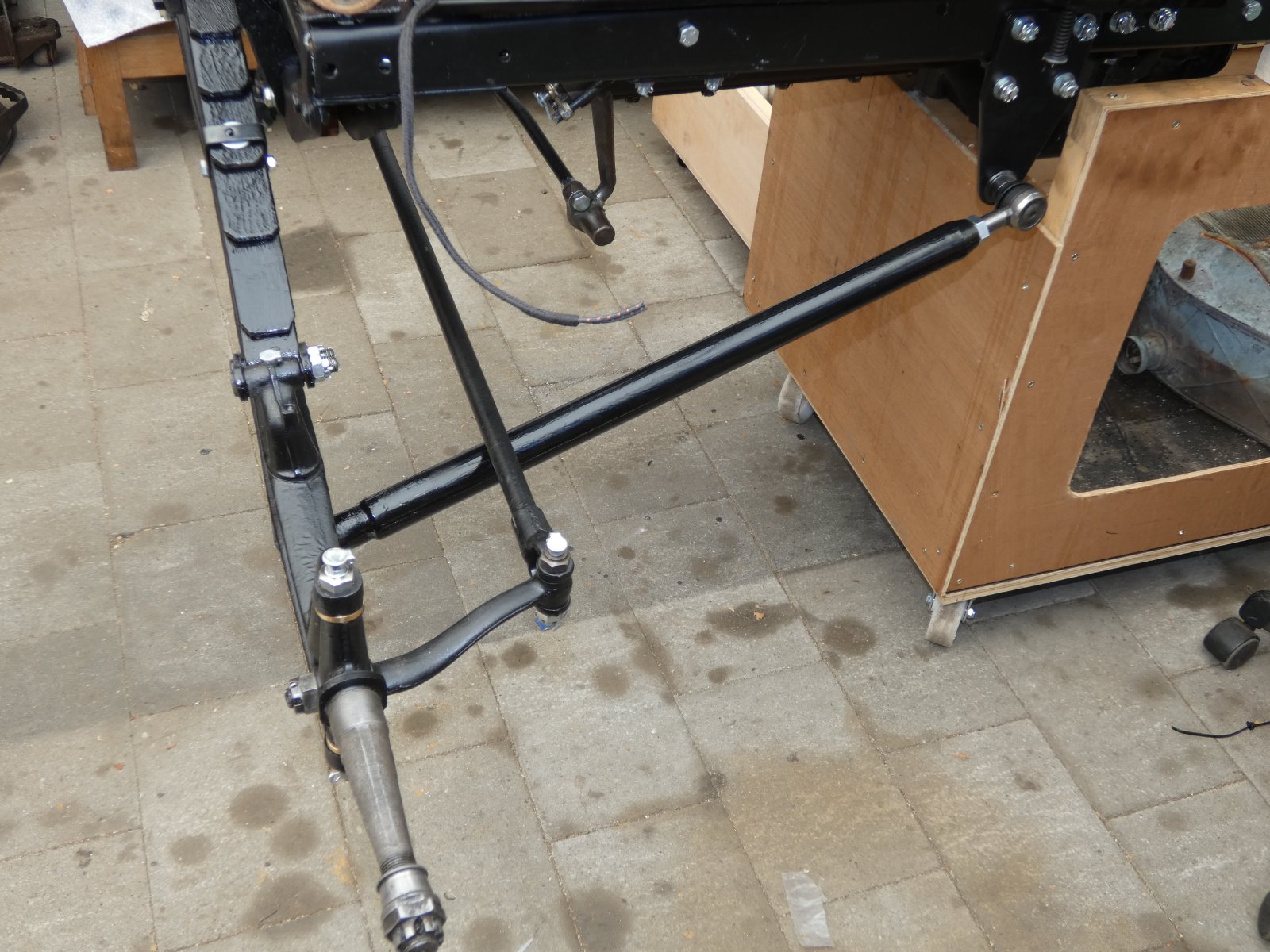

It was indeed not a stock wide front spring.
Here is what it became after rebuild.
The front spring was replaced by a spring assembly with original spring leafs.
On the photos you can count 6 leafs but one small leaf is hidden by the support on the top and one short leaf at the bottom is added to fill up the support.
Note also the way the suspension was stablilized with two adjustable rods to the back. The original V- rod was to short because of the new place of the front axle.
Andre
