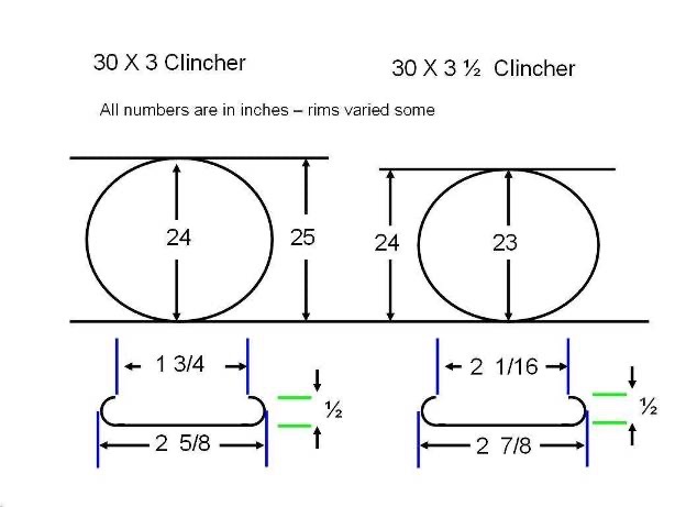

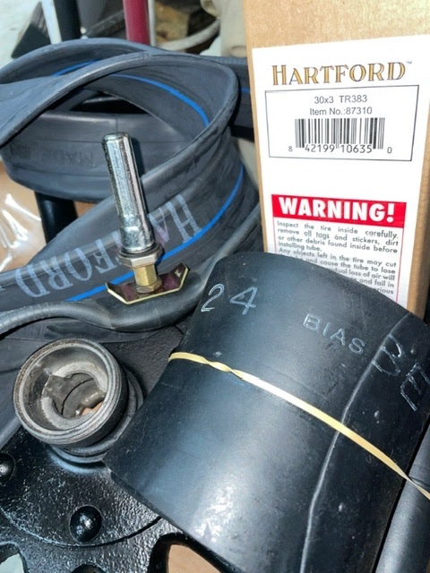

IMO, don't think that can work to stuff a 23" dia flap and the smaller 23” tube in the 30x3 tire casing that is made to fit 24" clincher rim.
30 x 3 1/2 clincher tires and tubes and flaps go on the 23” rim.
Got these from Coker, right size 24” dia. 30x3 brass stem tube, and proper 24" flap to go into the 30x3 tire clincher 24" front rim.

Re: Tube Size Question
Dan, did you have any problems cutting off the rubber stem on those Hartfords? I haven't tried it yet. I see you have an incorrect bridge washer. I wonder why that company can't make them as original?
