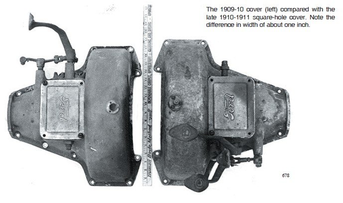

Some early cars used a slightly different size / shape oil pan / hoggs head cover bolt pattern.
It also may or may not clear the teeth on the flywheel die to a slightly different shape.
Anything is possible, how much do you want to change / how hard do you want to work?
The amount of work needed and value of the original early parts is why most of the time it is just swapped for a later engine.
