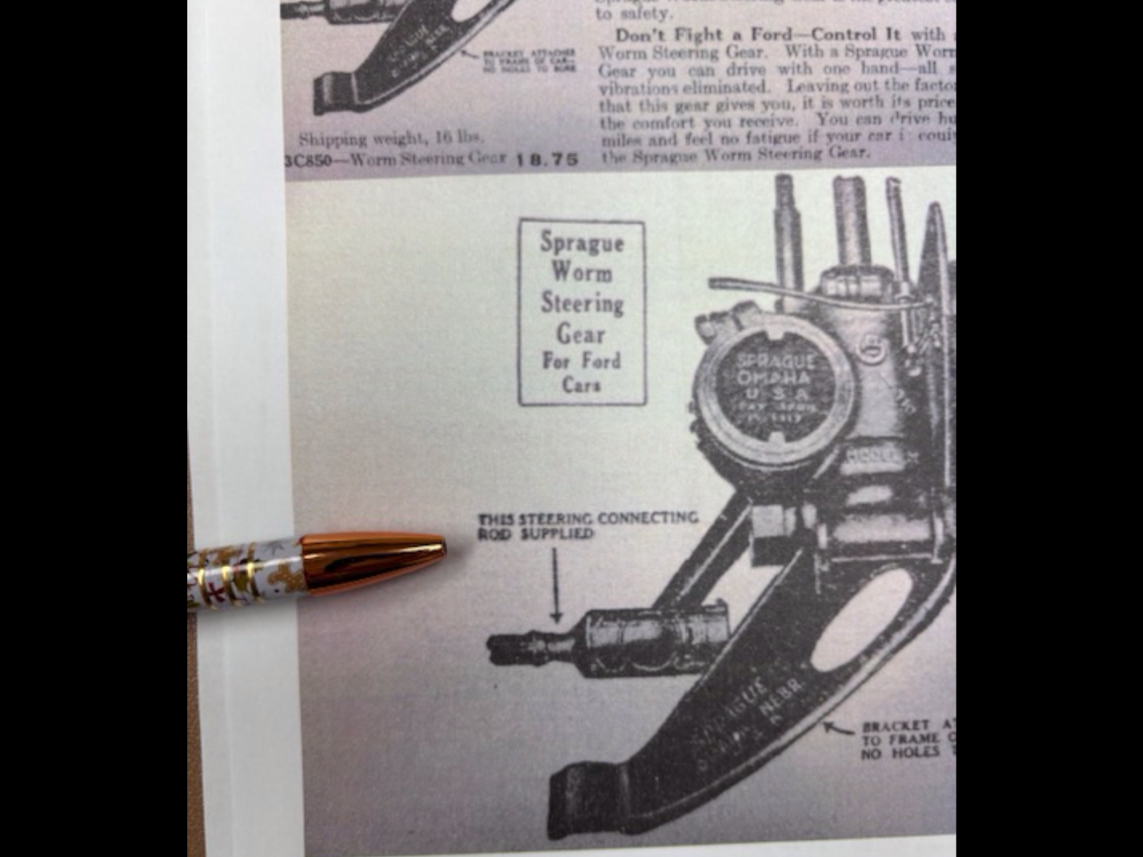

I bought it a long time ago from Max Edmonds, the price was reasonable…..It came with a Model A drag link but it is slightly bent…..I wonder if Sprague provided a drag link and wonder what is looks like?……

Edit, oops, there was a special rod!Drag link is a model T factory part.

I too would appreciate at least seeing an original and proper factory made spring loaded rod. Indeed, one could likely make a Model A one work, but being a purist at heart, an original would be pretty cool to use. -Dusty

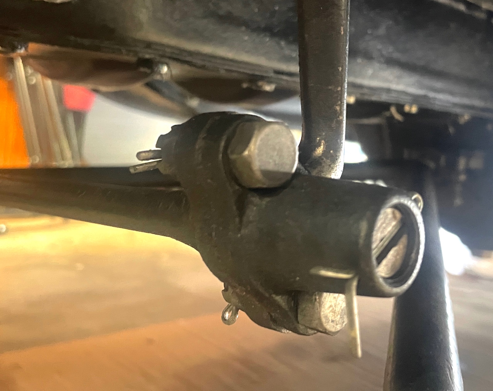

This is close up of the Sprague drag link spring loaded piece on the pitman arm.
FYI, Dennis Fleming has a center door with this accessory steering gear, have seen the car in his T barn.
Or you can use an APCO spring loaded cap to take up wear too.

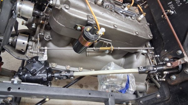

A year or so ago Hank Lee sold a Vega Box kit - everything needed (had to make you own support bracket with the instructions). Maybe he has one left
https://mtfca.com/phpBB3/viewtopic.php? ... box#p16404
Vega Box on Mark's Doodle Bug
