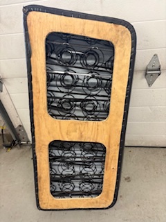

If the original owner used a wood frame, that could be the cause. Or put plywood over the spring? Or stuffed the spring coils with upholstery foam, some may do that for extra support to worn coil springs.
The '26-'27 front cushion is only the spring frame, covered with the upholstery.
The cushion then fits into the metal body seat frame. Have seen some use a wood base, but not original.
Perhaps your spring may be incorrect for the '26-'27.

You are correct, the last owner used plywood on the bottom beneath of the springs, this in itself adds will add 1/2” of height.
Looks like I need to take the seat apart and see what is on the top side of the spring package

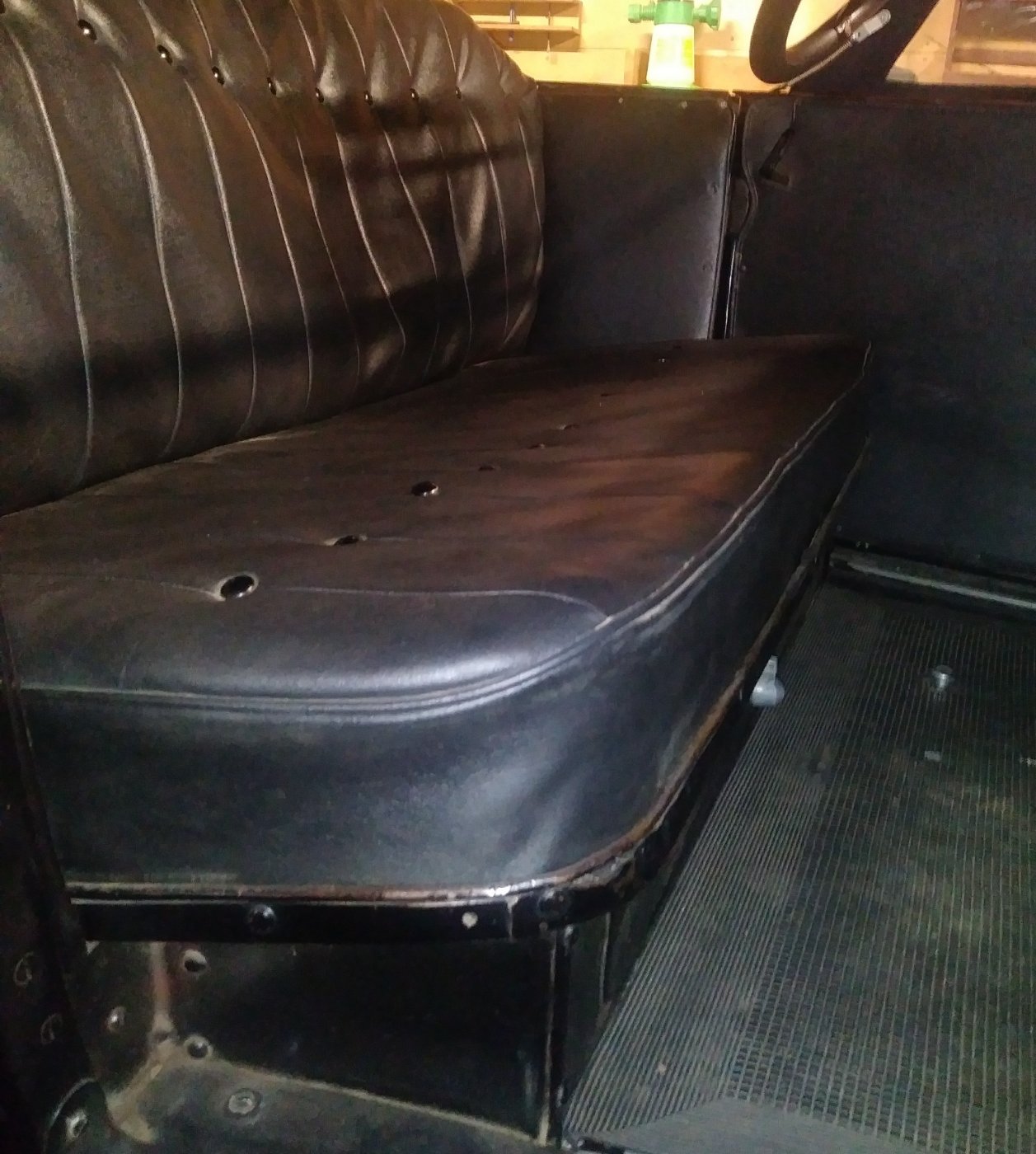

Re: 26 touring seat height
[image][image][/image][/image]
JohnM
- Posts: 746
- Last Name: Michaelree
- Location: st louis
- Board Member Since: 2010
Dave, your seat upholstery looks to be well done with more padding than most. It's a shame to take it apart, but the comfort from extra padding is pointless if you can't sit in it and drive.
Here is a picture of my front seat. It is showing some wear but you can see the difference in height.
What a shame to have to "fix" that, looks like a really nice comfortable seat.
The plywood underneath does not belong and the padding is overstuffed.
Sometimes switching the steering wheel from 17" to 16" will help get under the steering wheel but it won't raise the roof.
If the seat was "customized" is the roof still where it belongs?
It should have a curve to it and not be flat front to back
