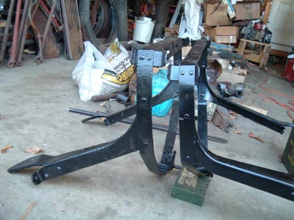

Post by Original Smith » Fri Dec 19, 2025 11:21 am
I've been driving my 25 pickup for years with the spare in the bed. I've had a restored running board tire carrier hanging in the garage for a long time, and finally decided to use it. It is the one pictured above. They even used a genuine Ford tire carrier in the middle, and have two straps that attach the whole unit beneath the body. The first strap goes to the front body bolt, and the rear goes to the rear starter switch bolt. Some day I'll get around to posting a photo.

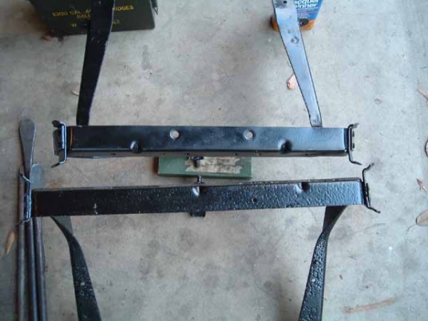

Post by DanTreace » Fri Dec 19, 2025 8:47 pm
The shiny painted carrier is the ‘25 version for the split rim 21” tires. Note shorter top arms.
The pitted is ‘24-‘25 version for clincher rim 30” tires.
Posts: 5441
Re: 1917 spare tire mount
Post by RajoRacer » Fri Dec 19, 2025 9:34 pm
Note regarding the 21" carrier shown above - the top bar was double hole stamped to receive either LHD or RHD tail lamp wiring.
