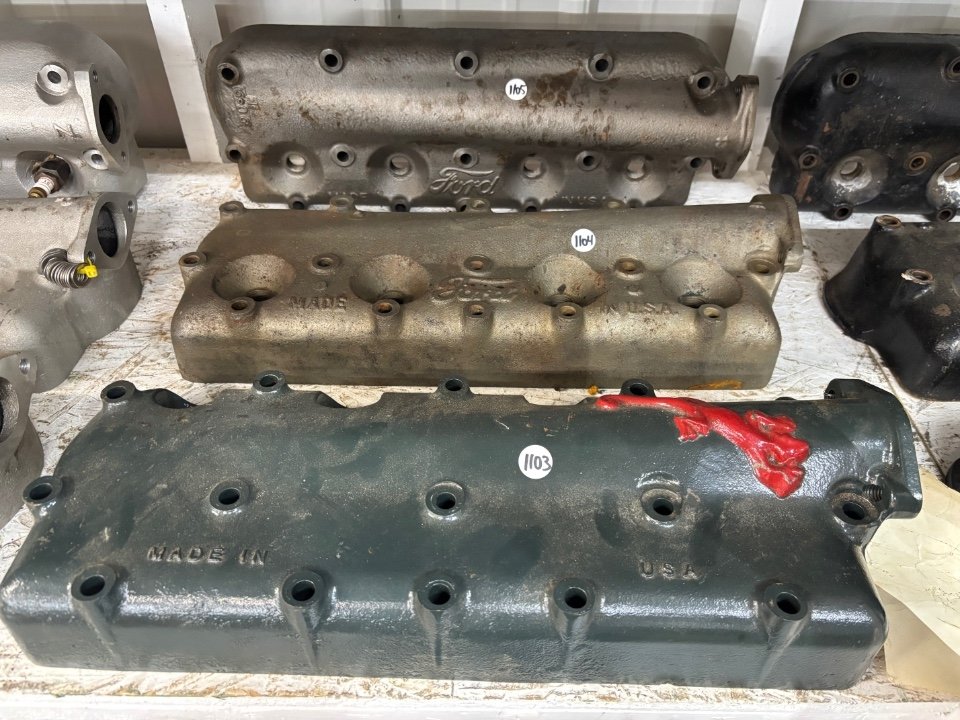

There's a LIZARD cast iron head for sale on EBAY, if anyone has $1,300.00 burning a hole in their pocket.

That is the one from the Cipriano auction in November, I think it went for less than $200
The aluminum head that you can just see the front edge of in the photo to the left of the Lizard head is for sale in someone elses listing for $375.

Same head cleaned a little.

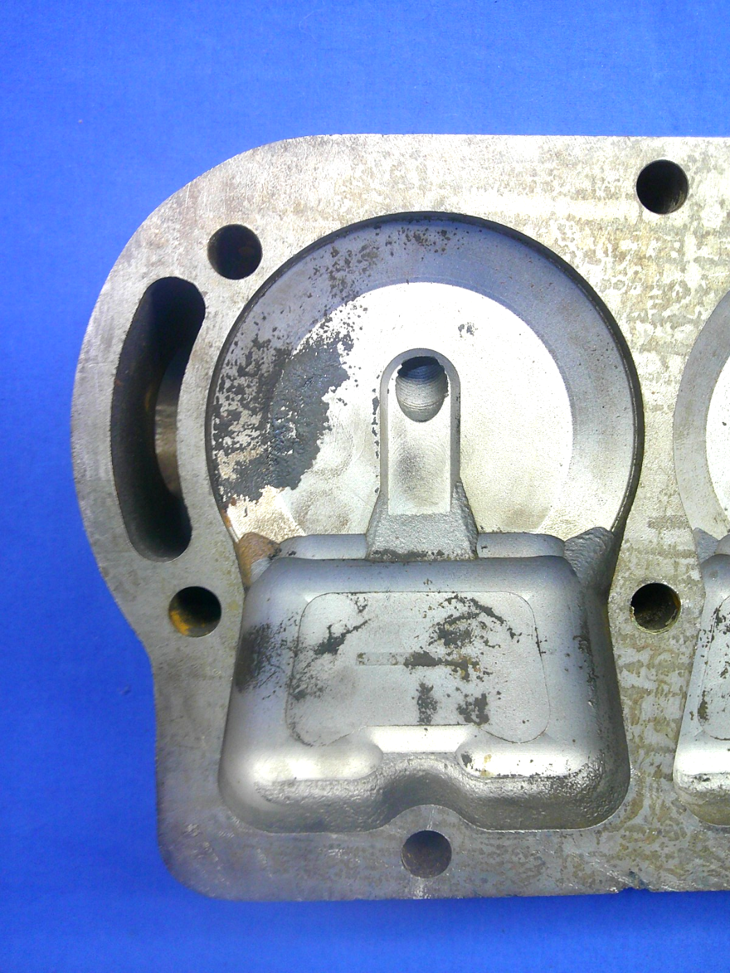

Yes, was mistaken as been years ago, here is pic off eBay site showing plug over piston, and weird flame groove to valve side.

Right. I think the ping that some folks hear is the sound of the expanding combustion gases being trapped in the valve chamber, then having to rebound back towards the combustion dome, where the initial fire began.DanTreace wrote: ↑Sat Dec 20, 2025 9:32 amDan,

I witnessed a test using a freshly rebuilt engine. It was dyno'd with a "Z" head, a Reeder head, and a Lizard head. The first two performed as expected. At a higher rpm & load, the engine with the Lizard head attached, let out a hell of a clatter and all the dyno numbers dropped off severely. The engine's owner was scared that the motor had somehow been damaged. One of the other heads went back on and all was well again. There were no signs of piston clearance issues on the Lizard head.

I think is best to have the plug located in the vicinity of the exhaust valve, which allows the advancing flame front to move toward the cooler part of the combustion chamber, preventing detonation of the "end gas". The pressure rise in the combustion chamber is fairly uniform regardless of the location of the plug, UNLESS detonation occurs.
