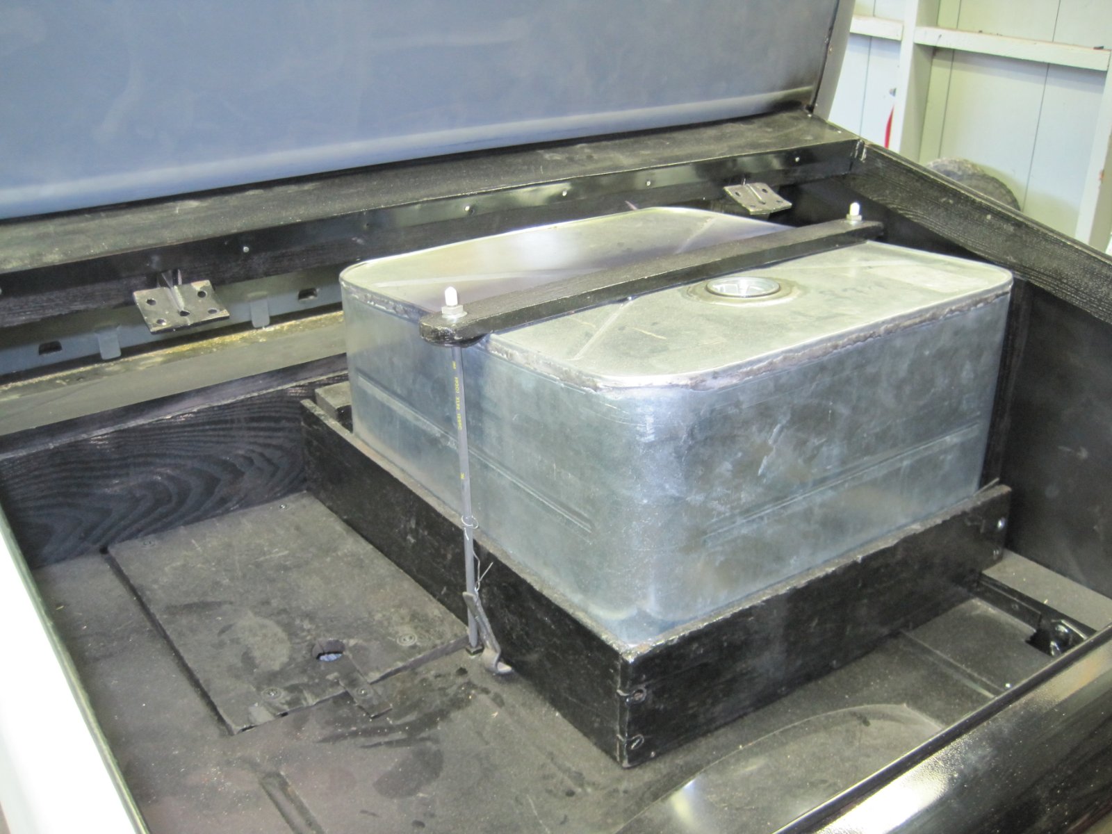

Re: 23 coupe gas tank
Look in the turtle deck (trunk) to see if there is a cut out in the floor for the sediment bulb and fuel line to hang down through so the fuel line can be run forward to the engine. There also may be signs of a bracket to hold the tank in place.
NOTE: this is a photo of a '22 Coupe fuel tank in the turtle deck and is posted just to give you an idea of where the square tanks were placed.

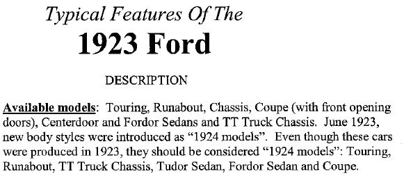

Through the 20's Ford was still buying closed bodies from outside makers so there are sometimes not hard fast answers.
Henry was never worried about model and year changeovers. He was trying to produce enough cars to keep up with demand.
Often the line is very blurry and unclear through the production of Model T's.
There are many examples of parts being on cars earlier and later than they "belong".
I believe Henry was the first to use the slogan "If it fits, It ships".
Perhaps some pictures of the under seat and trunk areas of your car can help find the clues to what type gas tank it is supposed to have?
Here is what the MTFCI judging standards have to say on the subject: Mike

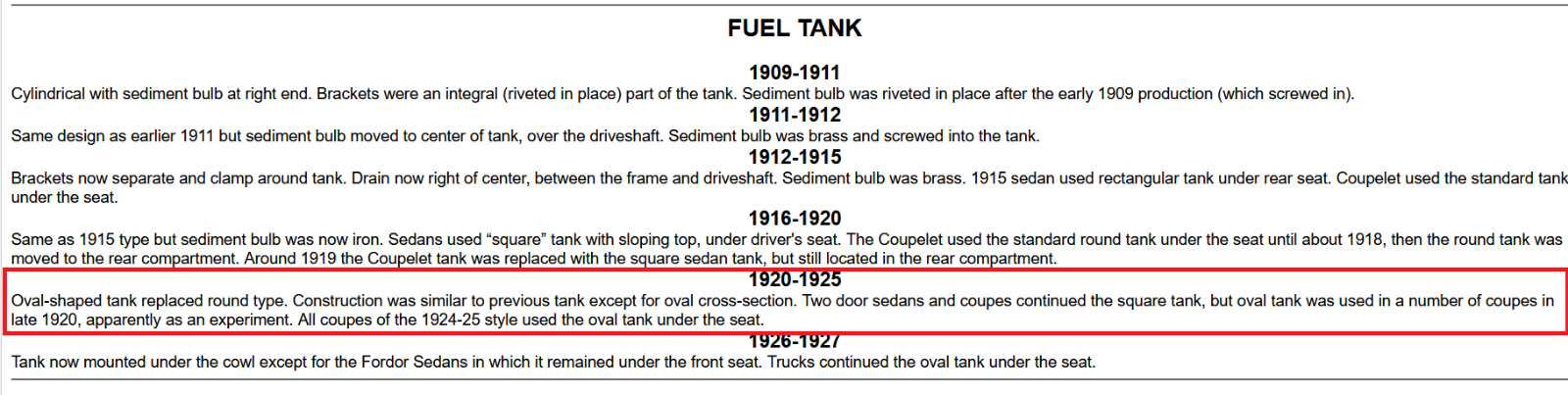

- Posts: 6577
From the MTFCA Encyclopedia by model year for the 1923
FUEL TANK: Elliptical, under the front seat. Mounting brackets clamped to the tank. Outlet was between the center and the right side, between the frame rails. The Sedan continued the square tank under the drivers seat. The Coupe used the sedan tank located in the turtle deck until the new bodies (1924 models), which used the standard oval tank under the seat.
General
1920-1925
Oval-shaped tank replaced round type. Construction was similar to previous tank except for oval cross-section. Two door sedans and coupes continued the square tank, but oval tank was used in a number of coupes in late 1920, apparently as an experiment. All coupes of the 1924-25 style used the oval tank under the seat.
General
1920-1925
My 23 coupes gas tank is in the rear compartment exactly like Perry's 22 shown above. I believe my 23 was made early in 23 Jan Feb ish.
